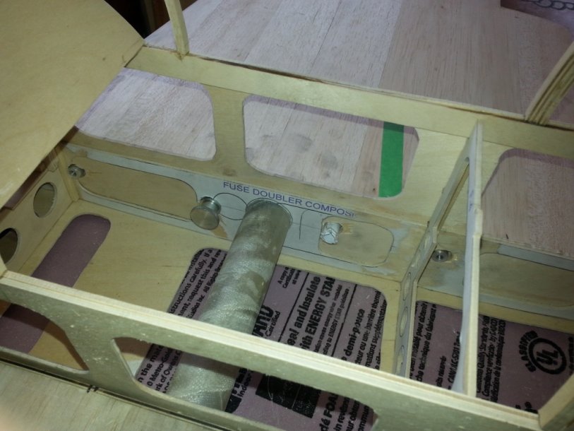

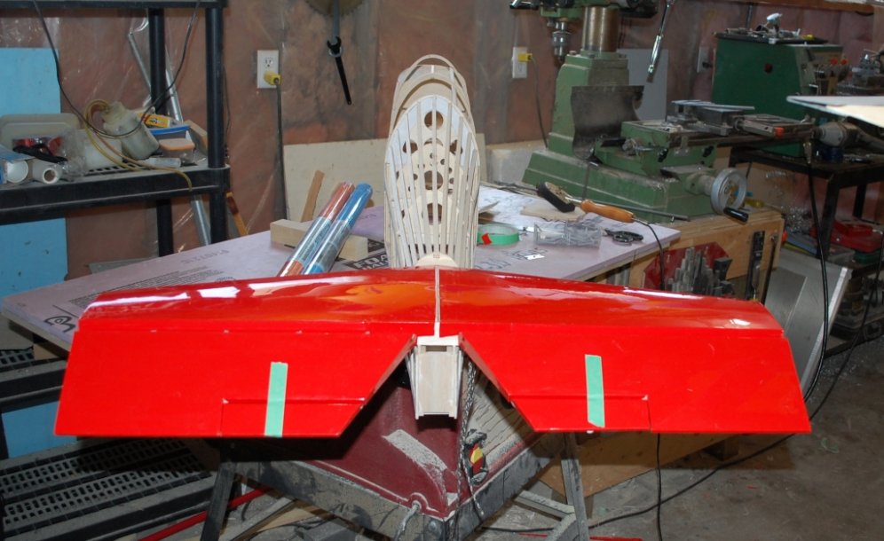

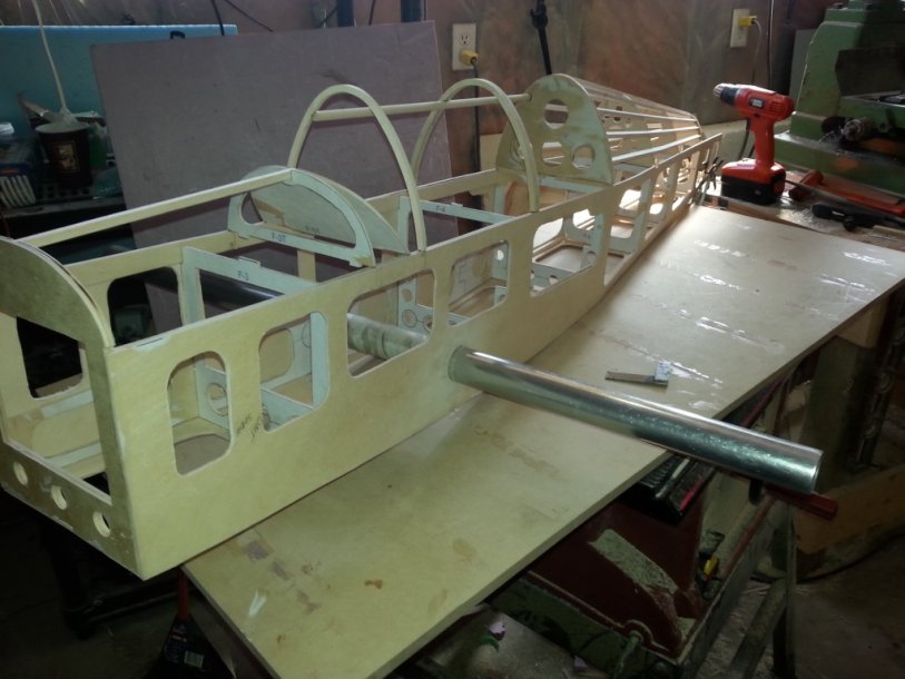

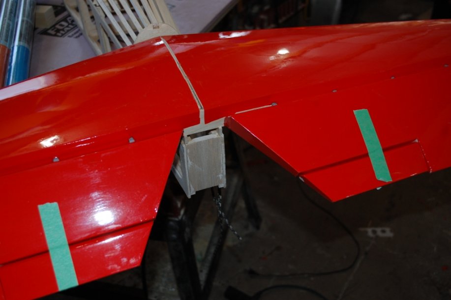

finally fitted the wing tube socket in the fuse, , so far no issues

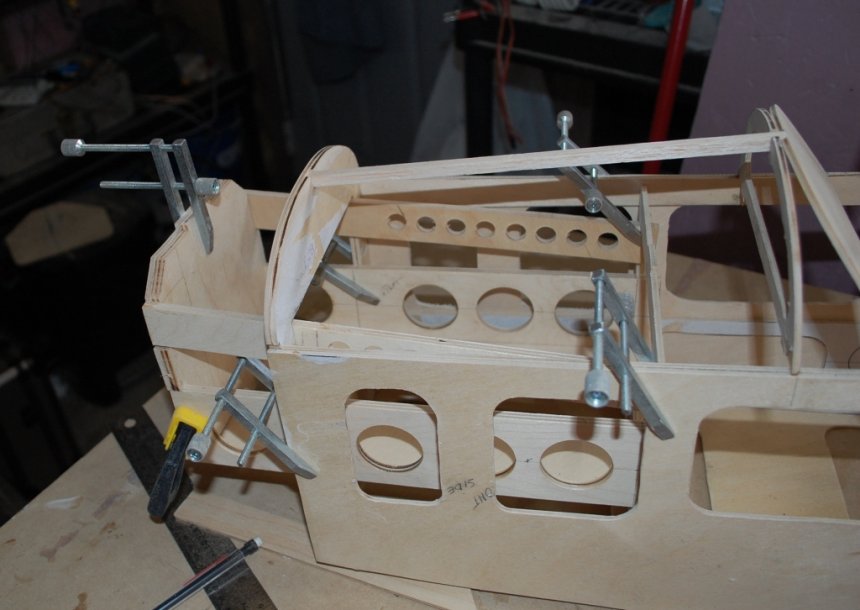

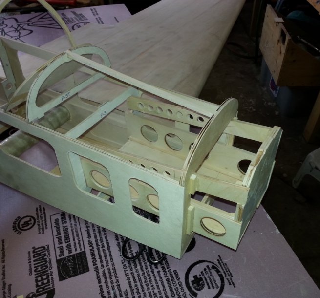

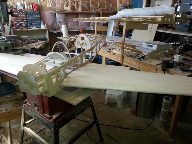

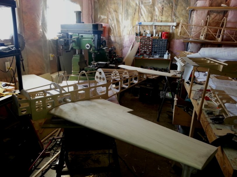

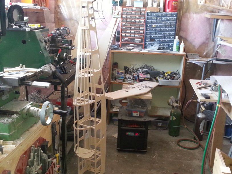

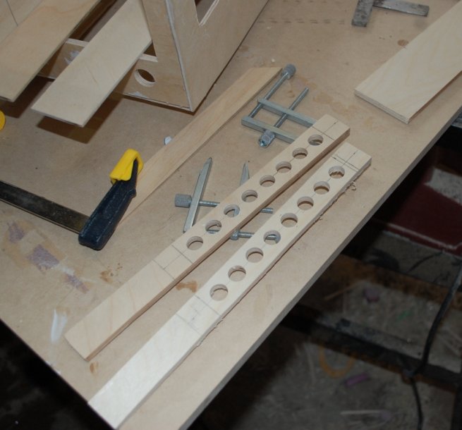

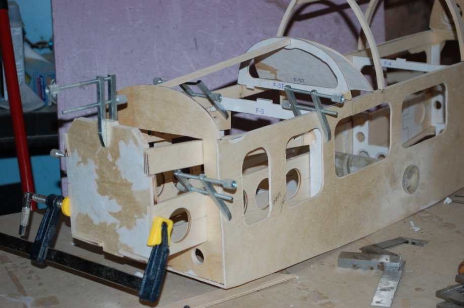

working on the engine box, you will notice a bit of overkill for the electric motor but later in the summer I will replace the electric motor with a twin cylinder 4 stroke boxer 111 cc engine, better be safe

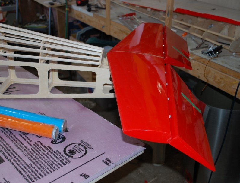

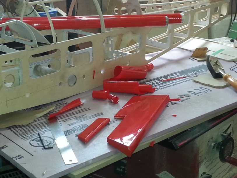

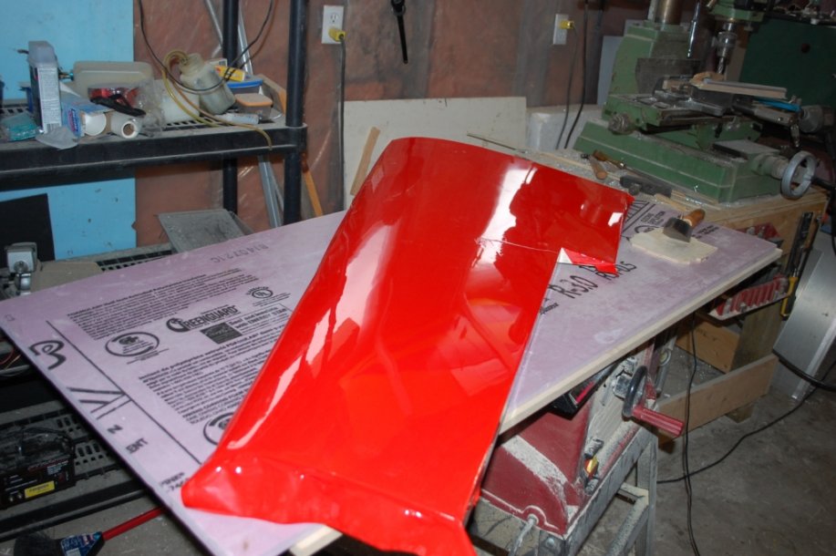

its starting to look like christmas LOL Remember the colors used on this one are not scale , I reserve the scale colors for the 50%

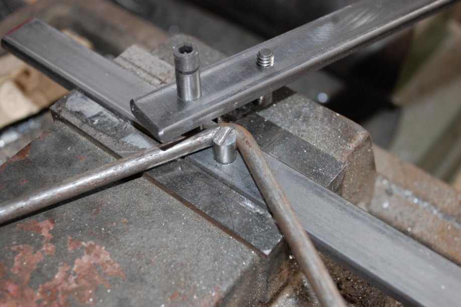

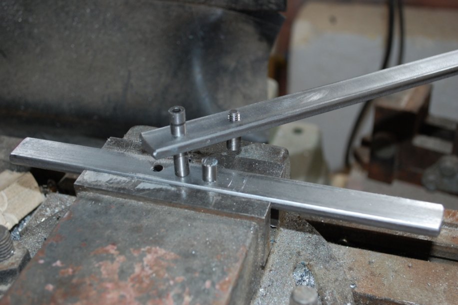

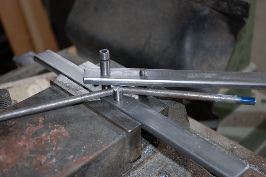

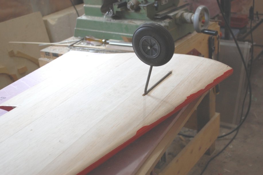

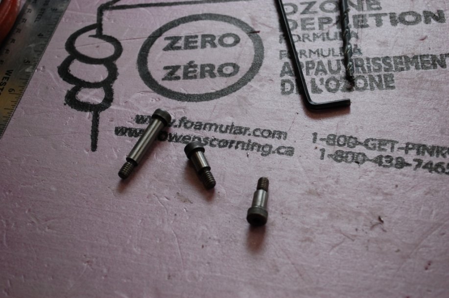

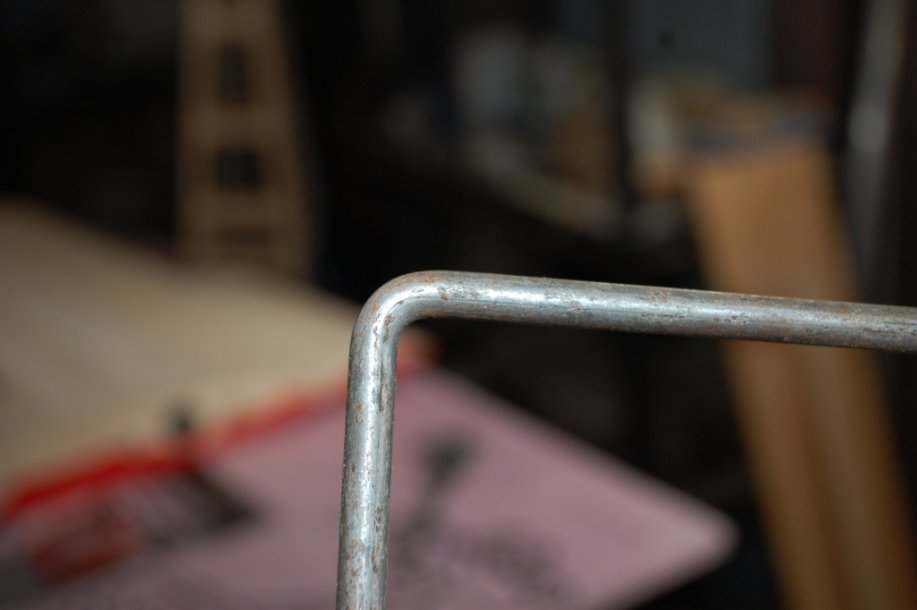

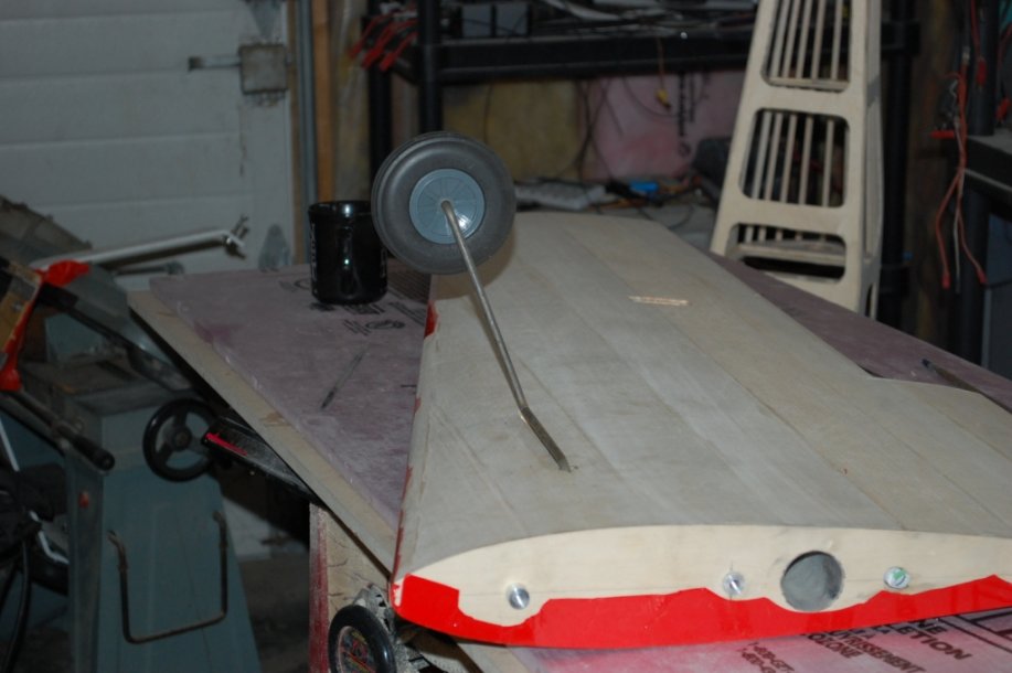

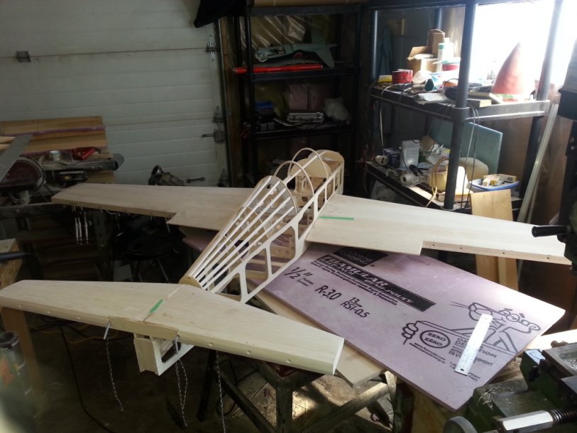

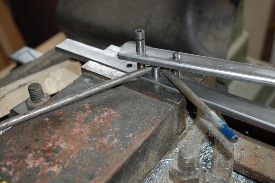

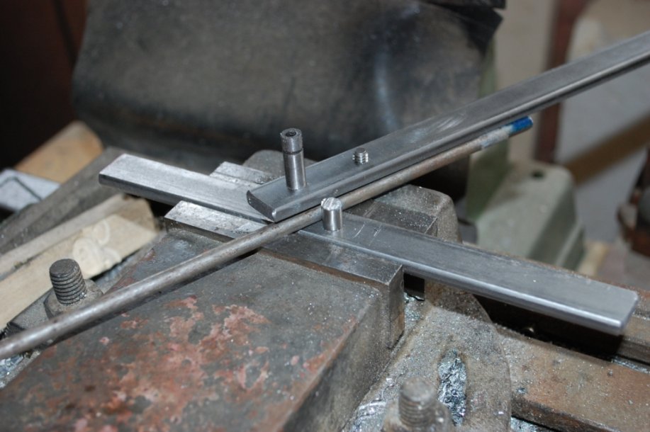

half covered the top of one of the wing panel, and made a bending jig for the 1/4" piano wire for the landing gear

OK guys, I need help, after posting what I made to bend the landing gear, that went perfectly for the trial run using mild steel, but guess what, the tool I made will not cut it for the 1/4" Piano wire, so any suggestions
