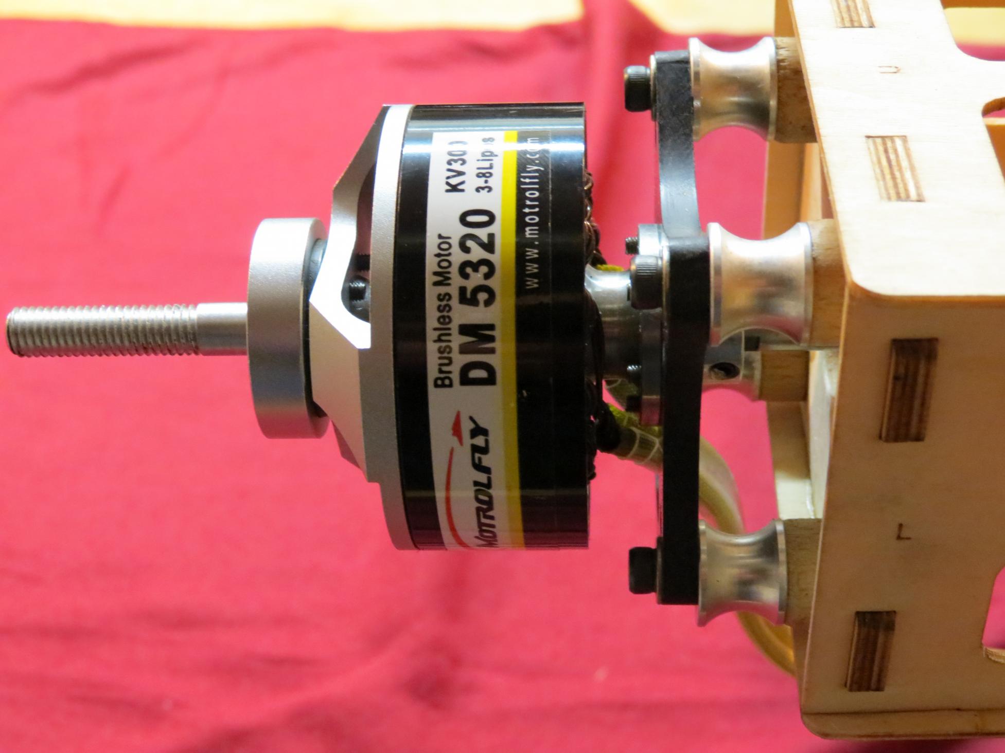

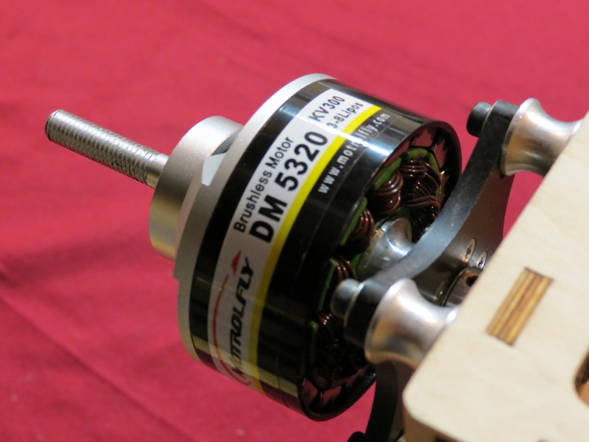

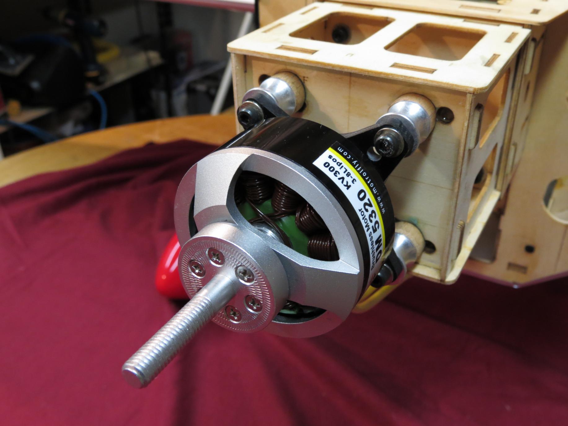

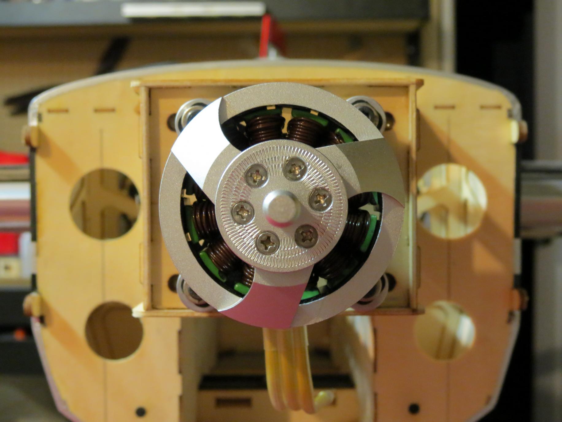

Motrolfly 5320 - You can plan for any size of prop by buying the correct Kv, and Ken will custom wind if necessary.
Ice 100
BEC Pro
1258TG Savox Servos (Align 610)
I have found that the Motrolfly motors from Ken at Subsonicplanes.com run cooler than my Hackers and have fewer issues. When I have had issues Ken has taken care of me very fast and for free (even return shipping to Canada). Ken has even upgraded a motor that I bought used for free. Hacker on the other hand has helped me out, but it takes time and they charge for it (always shipping and sometimes parts). Note that with the Hackers you will be using it outside of it's parameters since they set the watt ratings ridiculously low. They handle it pretty well, but it's how they get around the warranty in my experience.

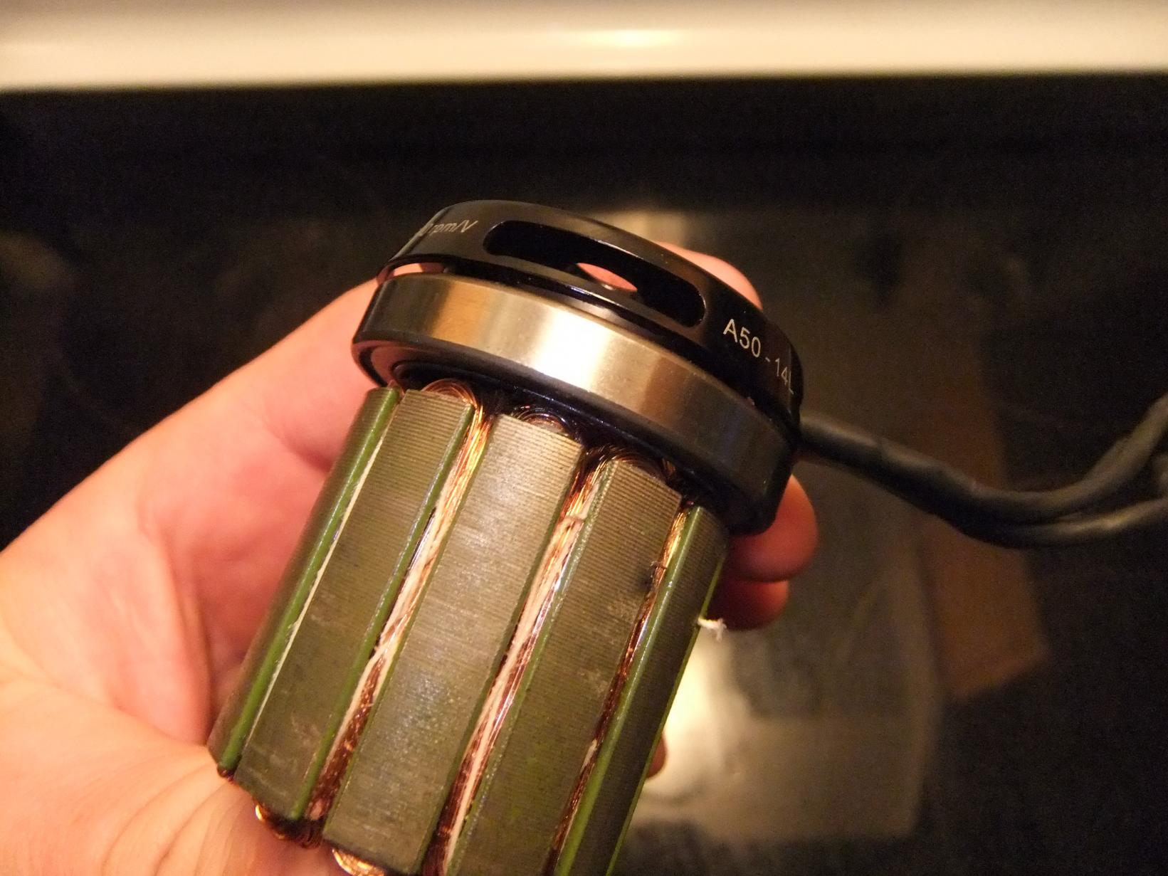

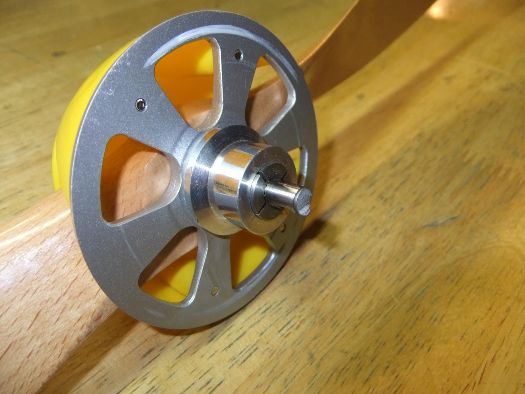

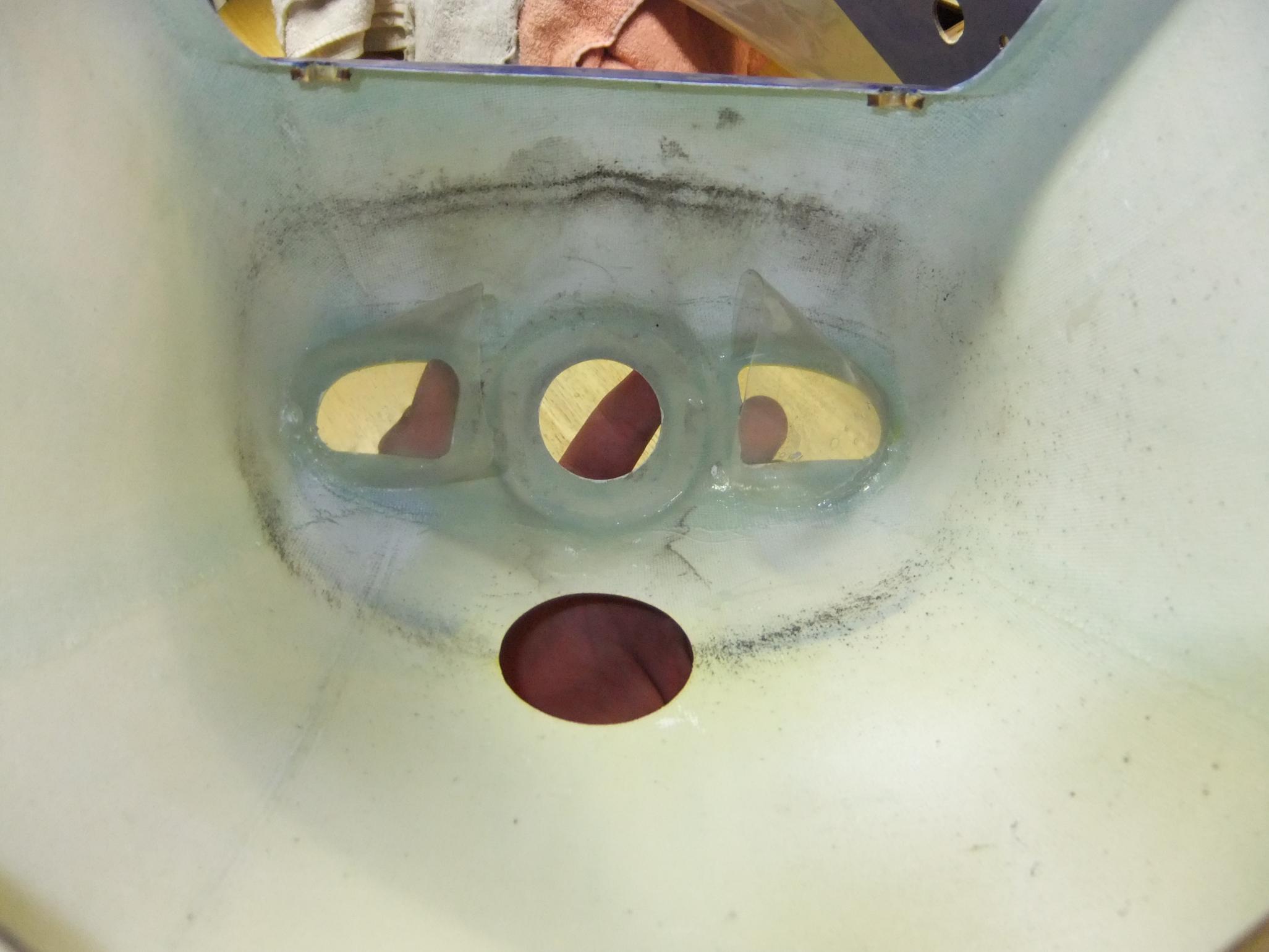

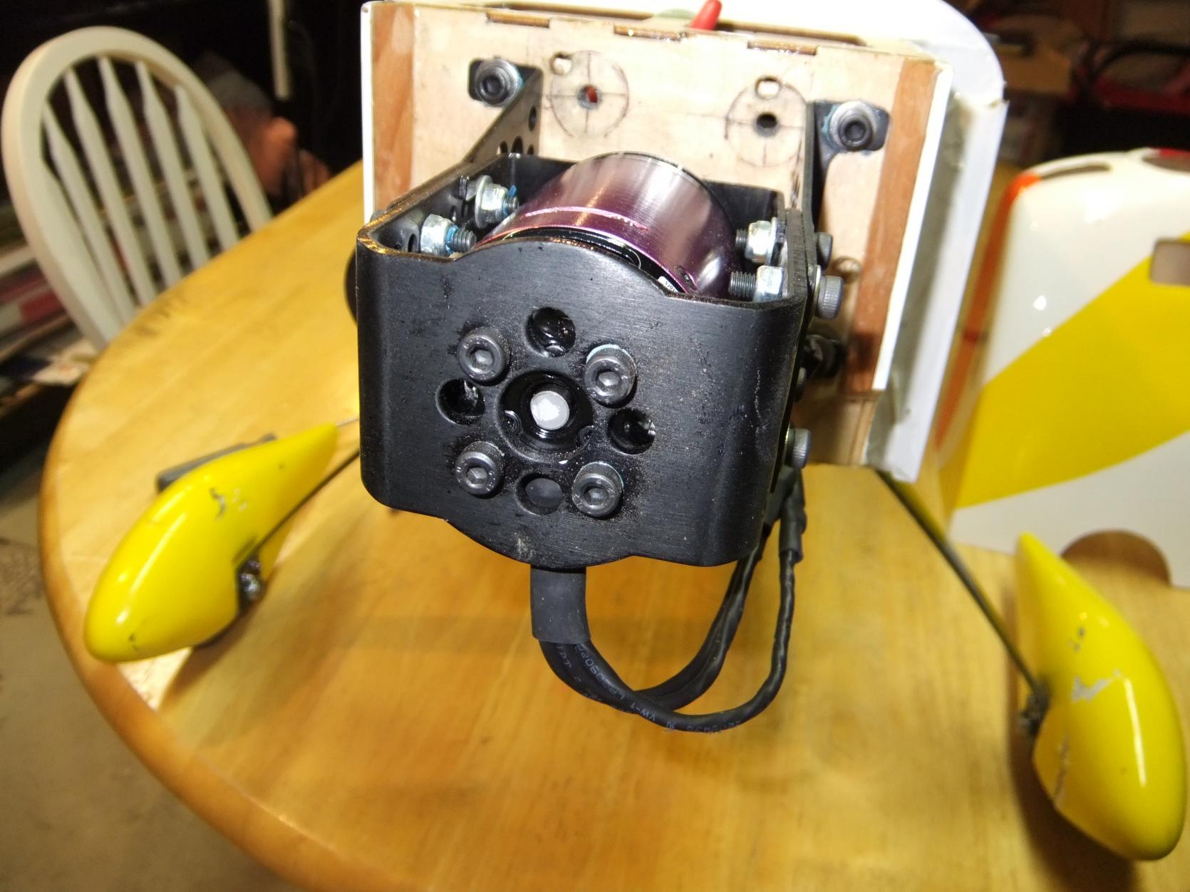

Here's some pics of my latest 5320, and my last two Hacker A50-14L's.
The first Hacker apparently had an old design defect that allowed the big main bearing to come into contact with the windings if flown hard. When it happened it sprayed molten metal from the windings out of the cooling vents and into my cowling. It fried the esc too. Hacker warrantied the motor, but would not warranty the second one that I bought at the same time (less than 5 flights on both). Instead they told me that I had to wait until it failed...risking my airframe and frying another esc (plus more shipping since I had already sent it back with the failed motor). After some complaining they sold me a new design motor "at cost" (about 15-20% off retail) to replace the defective brand new motor that I had just bought. So I ended up buying 3 motors to get 2 good ones, plus all of the international shipping fees.
The second set of Hacker photos are what happened 2 minutes into the maiden of the updated motor. The prop ejected on the very first knife edge spin. Needles to say it never went back into an airframe and both of my new "updated" motors are still sitting in a drawer. I might use on on Bigfoot since it may not see such violent maneuvers. On the other hand I don't want to stick them in an airframe that I value.
