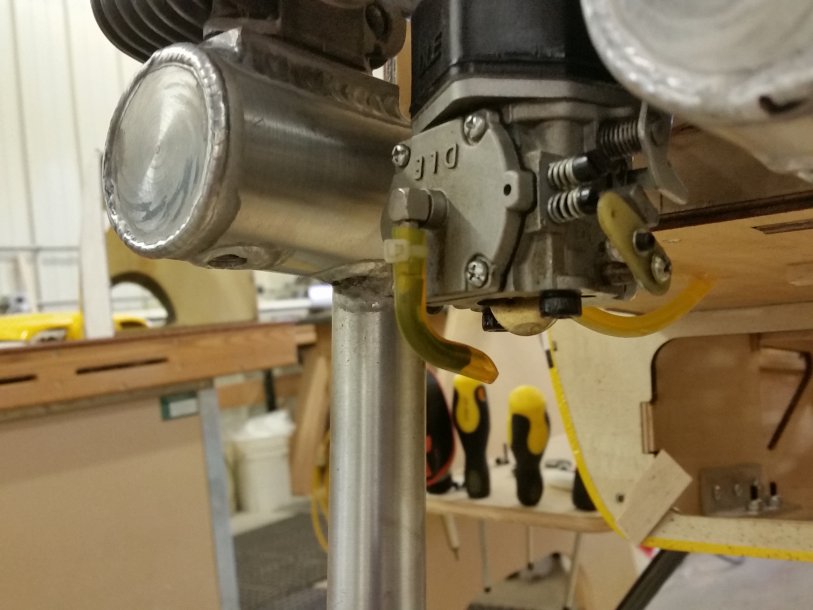

Cool, I was trying to find a pic of the little vent line, worst case if you do have any issues with it sounding different in KE or in negative G flight I'll take a pic of my GP176. It had an issue and the little vent tube completely cured it.

well I'm doing some maintenance today and forgot that this carburetor had one so I'll post a picture for your reference anyway....
