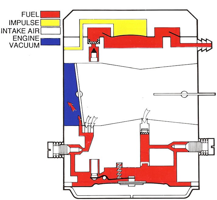

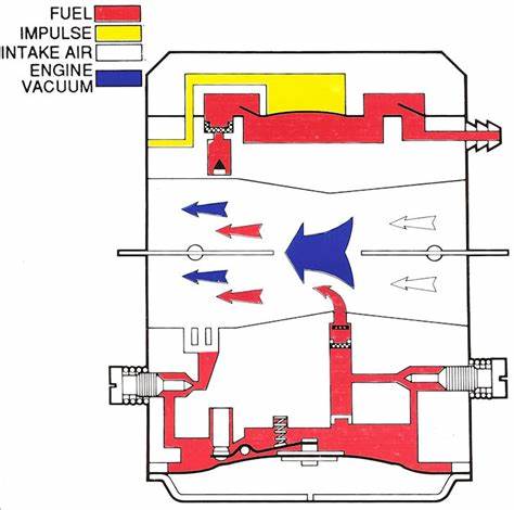

    This all makes sense to me with my issue as well. At one point with the cowl off I witnessed a loss of prime from the carb as it sat untouched. Maybe 1/2" of air from the carb inlet visible through the tubing. I'm guessing if the HS flapper check valve is not seating like it should, allowing air to be introduced through siphoning and thus loosing prime?
    I used the same style neoprene looking (black) gasket DA used, and not the tan fiber one. Is there a big difference?

  8. 49dimes
    49dimes Damn I'm hungry
    Yes you can lose prime through the HS check. As far as the gasket material used the black is for our engines ( higher rpm and gasoline fuel) the tan for lower rpm engines running "heavy fuels". Thanks for posting up that video. Will answer a lot of questions guys have. You da Man :attaboy:. The "flow diagrams" are nice too!
