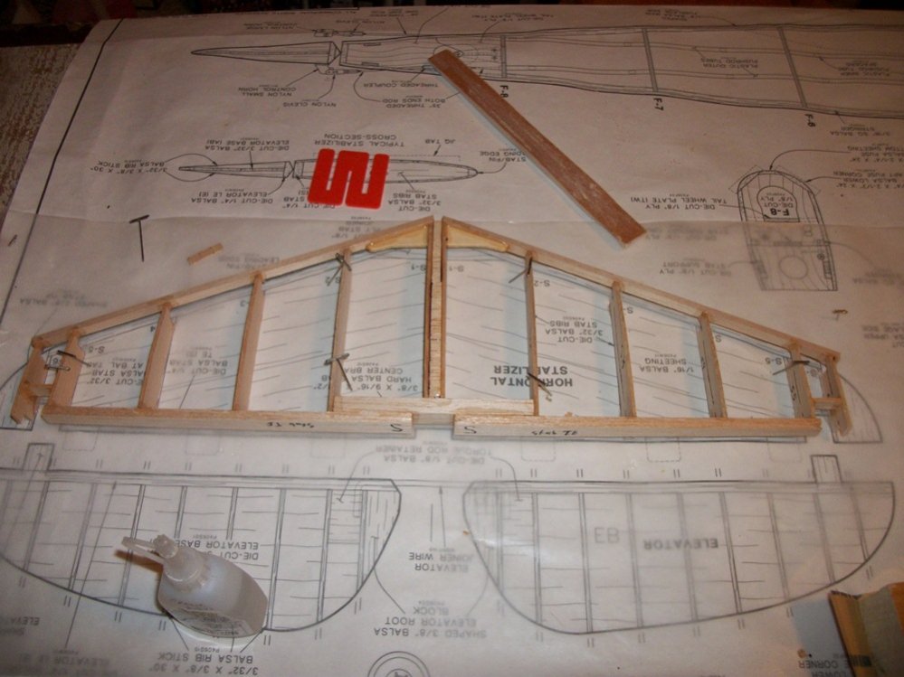

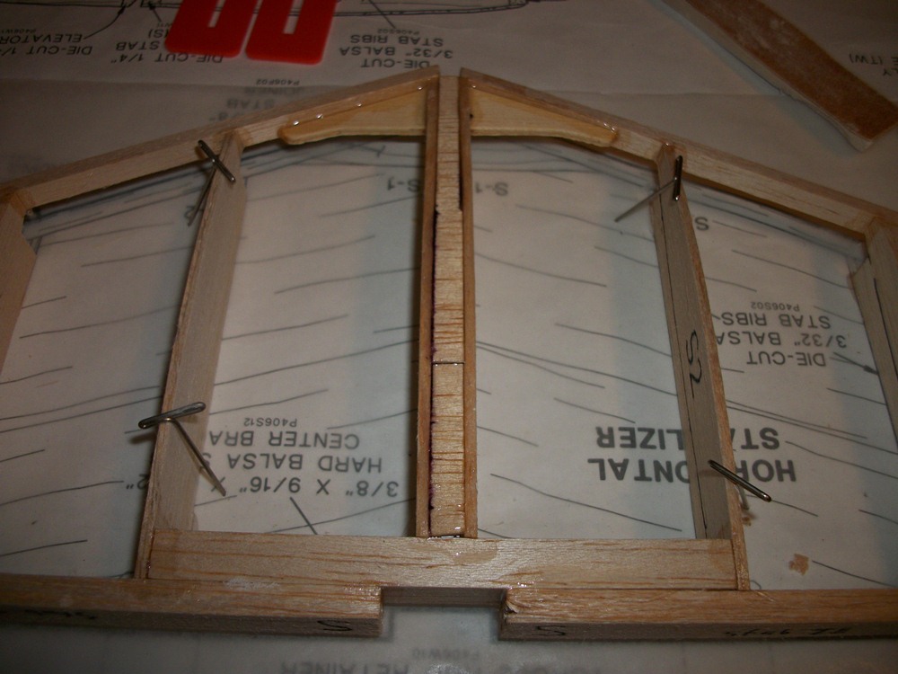

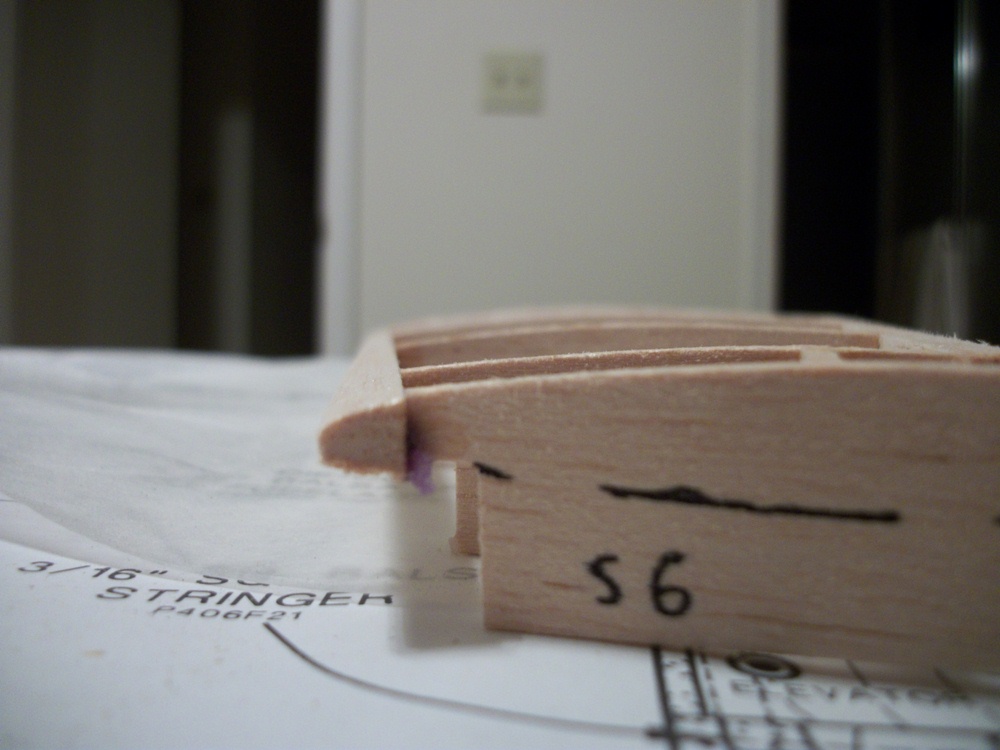

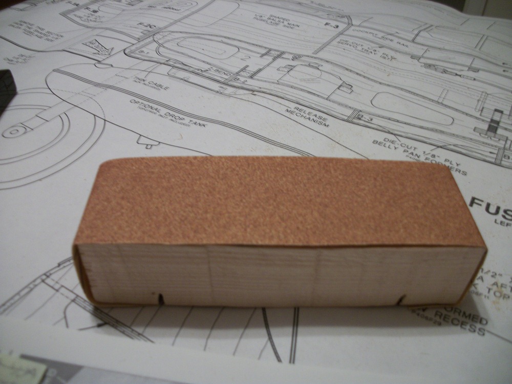

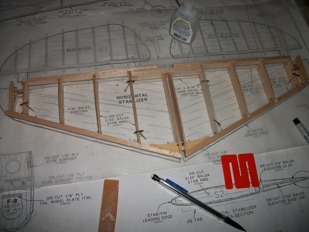

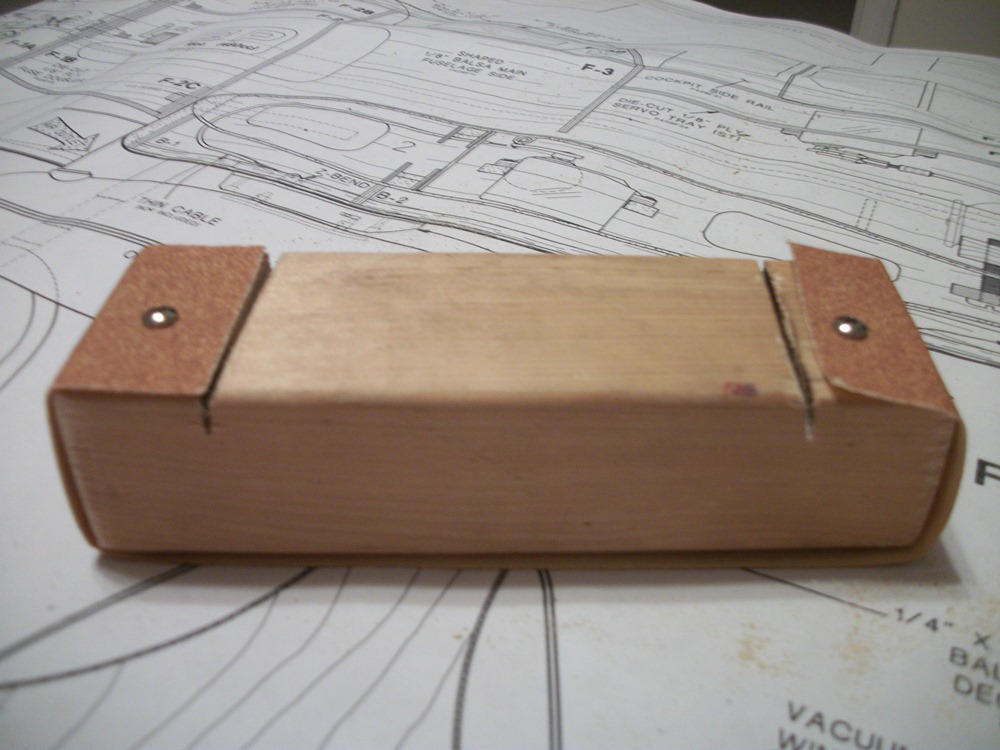

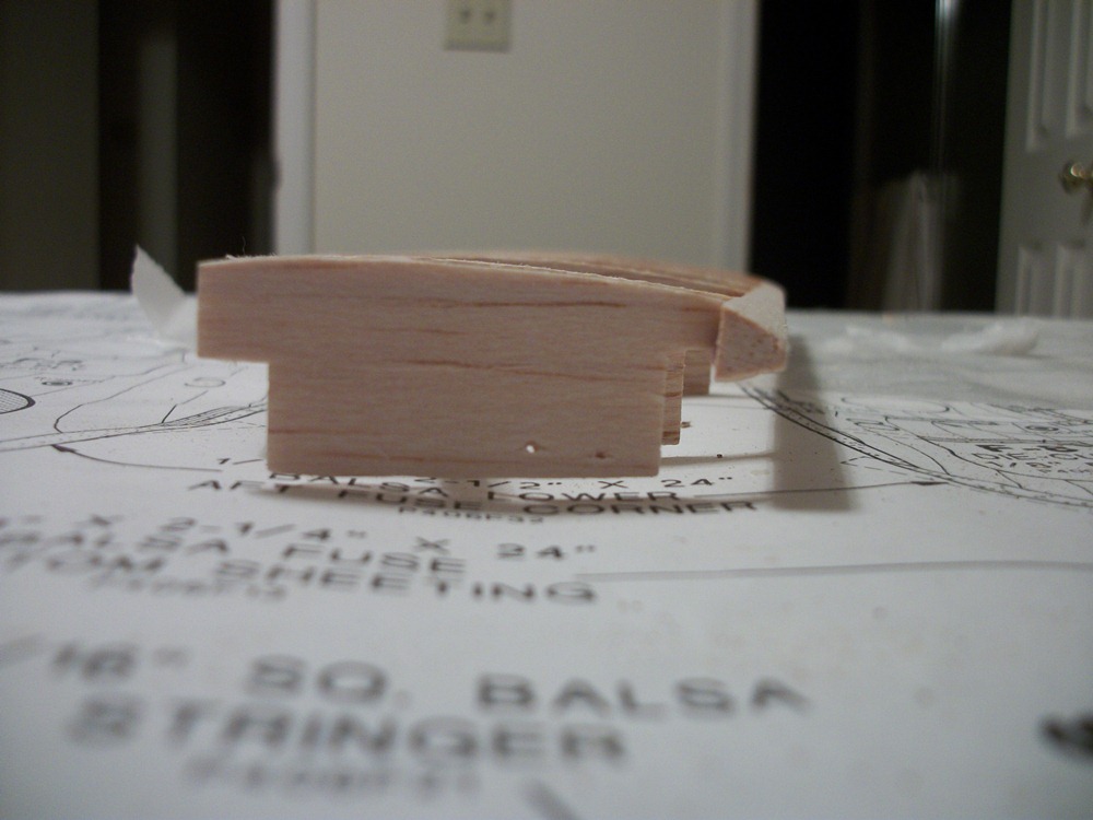

Spent about 30 minutes Saturday night sanding the top of the stab. Main focus was the transition of the LE to the ribs being smooth. Also spent time on the TE and any rough glue joints. Here are some pics of the stab halves being completed, joined, middle sheeting between both S1 ribs, a home brewed sanding block, and the end result of the LE sanding.
Next step is to make the sheeting and apply it to the top.

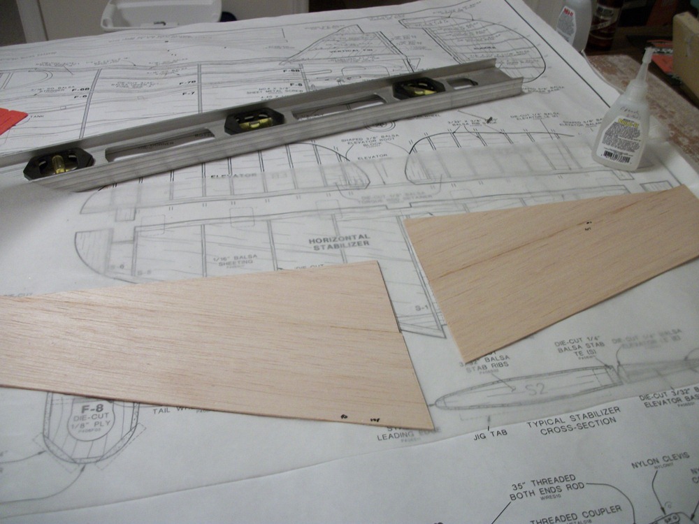

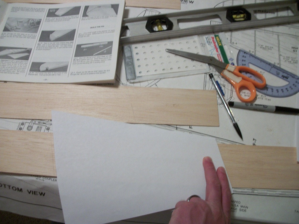

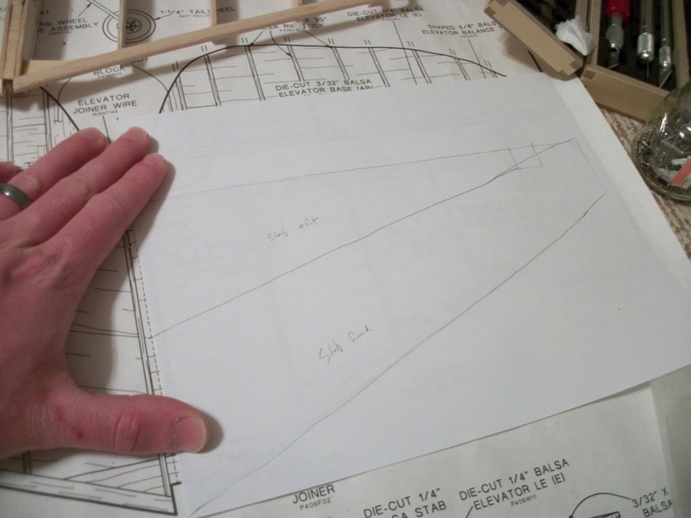

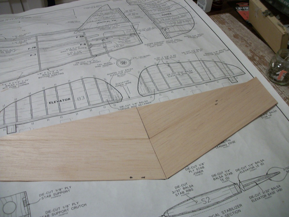

Got about another hour of work on the plane this weekend. Only involved creating templates for the stab sheeting, cutting the sheeting, and gluing some of the sheeting together.
Test fitting the edges
top quarters glued to make halves
rcdude07
Top half is sheeted! Soaked a section for 5-10 minutes in water, than used medium CA to put on with. Water acts as a little accelerant to CA so the window is small to get it on good and flat to the ribs, TE, and LE.

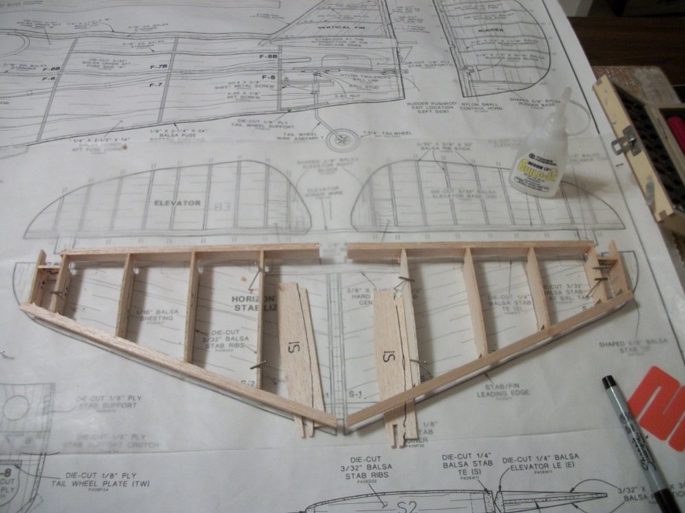

Got back to the building table yesterday (Easter Sunday) afternoon. Son chose to take a 3 hour nap, so this gave me plenty of time to work.
Got the bottom half of the stab sheeted. No new/different techniques here when compared to the work I did for the top half.
Next steps will be trimming/sanding the sheeting overage down.
