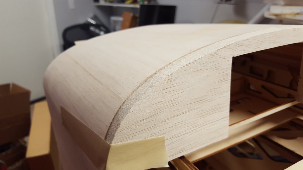

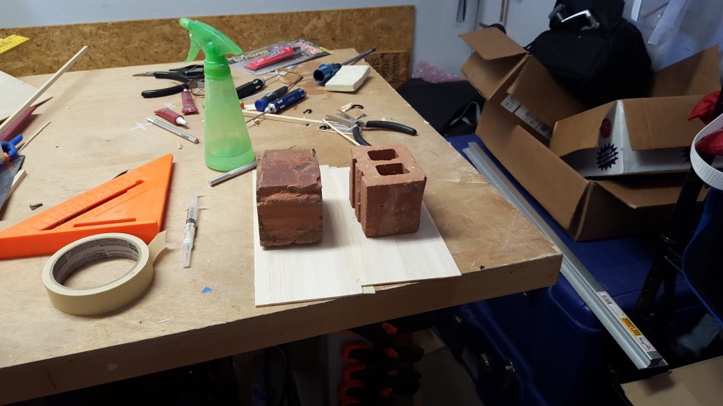

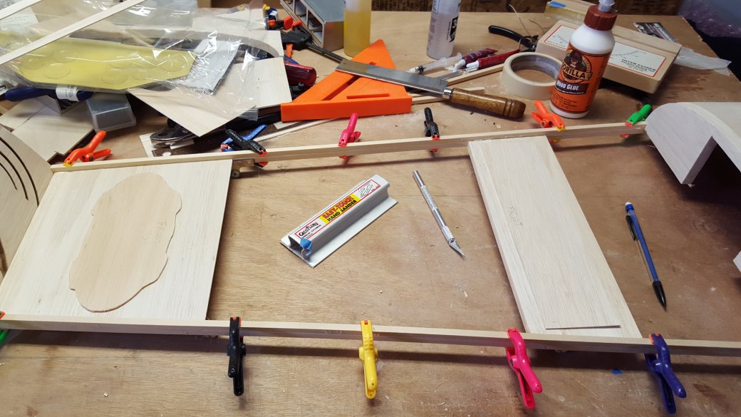

I was going to do this last night but since my 600N actually sold, I spent last night prepping it for shipping.

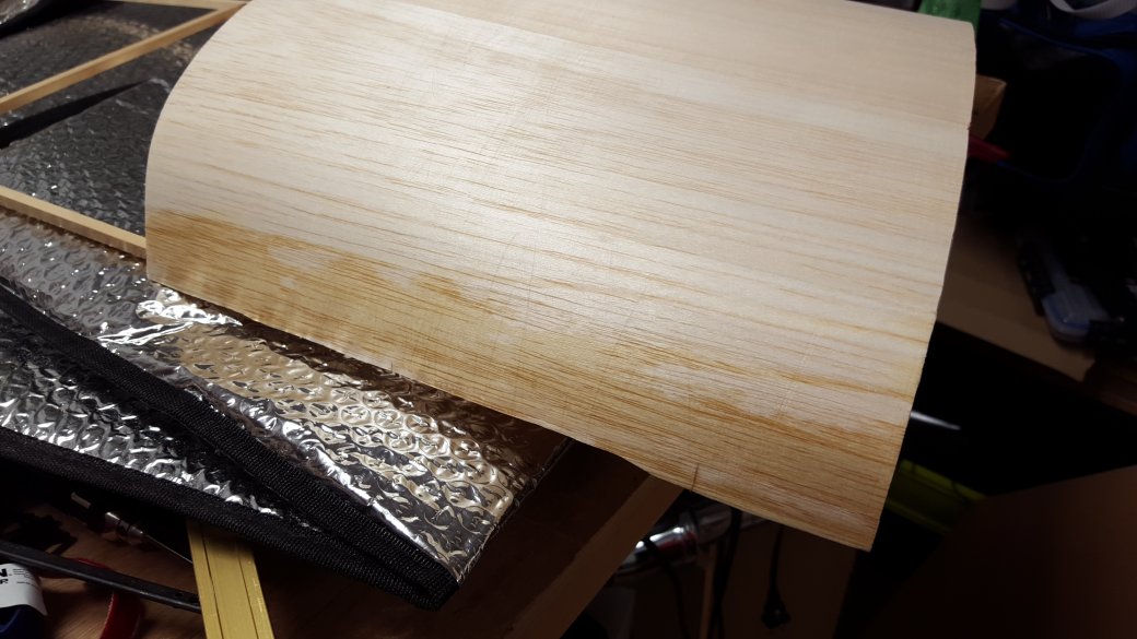

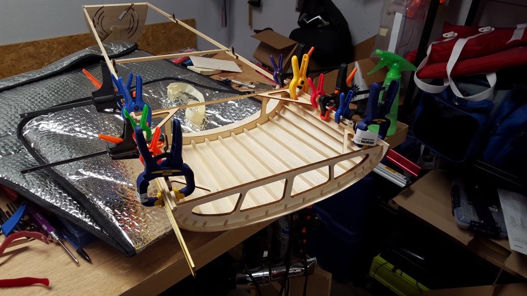

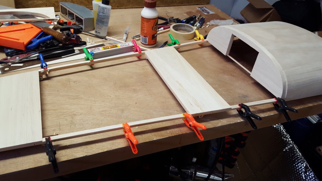

Anyways, I can attest that 50:50 Ammonia:Water makes balsa very pliable. I still needed a good number of clamps to ensure a nice and straight bond though.

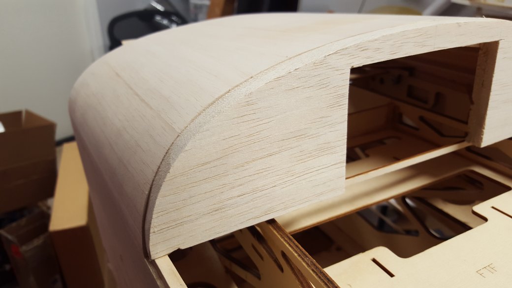

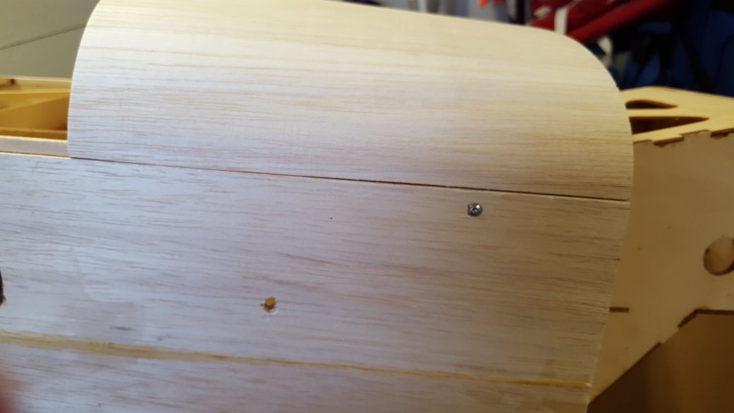

So far today I've got the hatch sheeting cut and sanded down but of course I managed to knock off the backplate in the process so I had to reglue it.

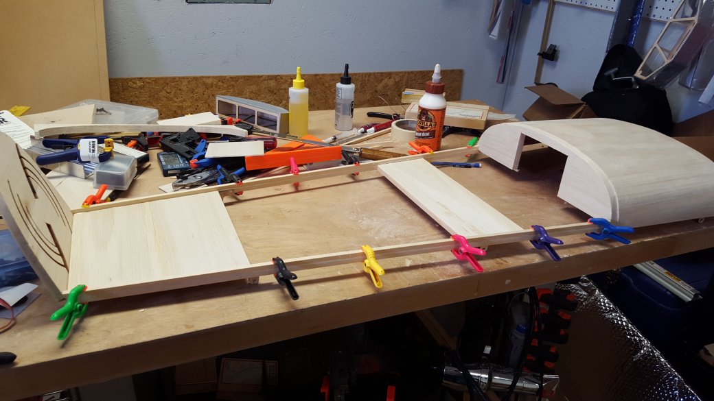

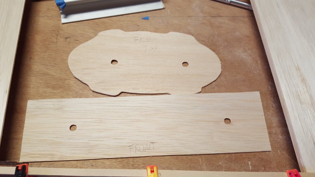

After that, I glued together some 3/32" balsa for the cockpit floors. I'm not going to do a full length floor and just do something to sit the pilot and dash to sit on. I may continue on from where the dash will go to the front but I haven't made up my mind. I want to be able to glue the pilot back in if he should ever come undone.

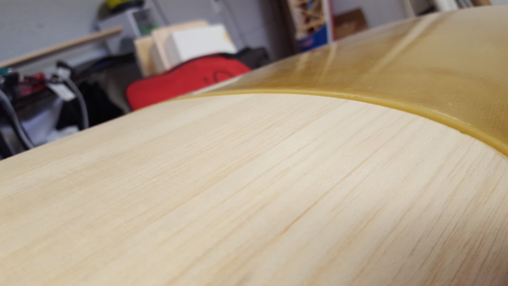

Next up for today was the 1/2" balsa to support the canopy. I'm hoping the curve is OK to save sanding filler later where the canopy meets the fiberglassed portion of the hatch.

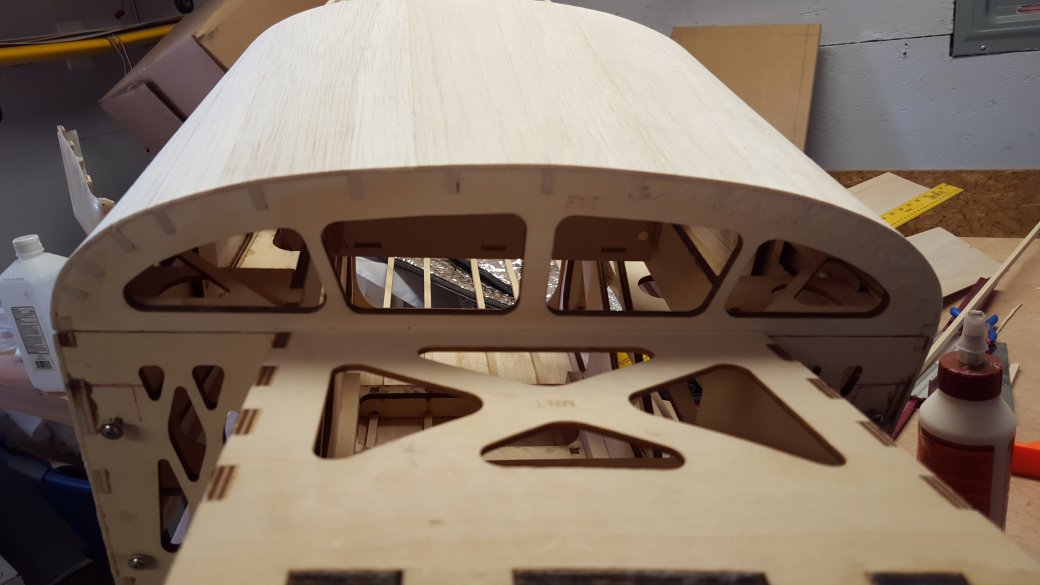

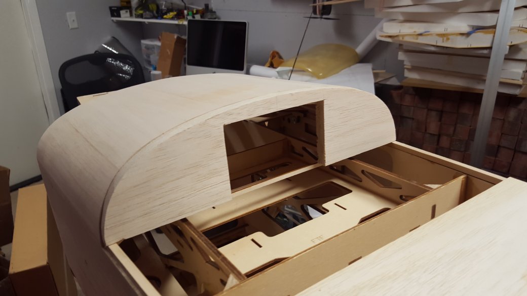

I wanted to check how much the cowling rises above the hatch and it's about where I want it. I can enlarge the holes for mounting the lower cowl piece to raise it up or down.

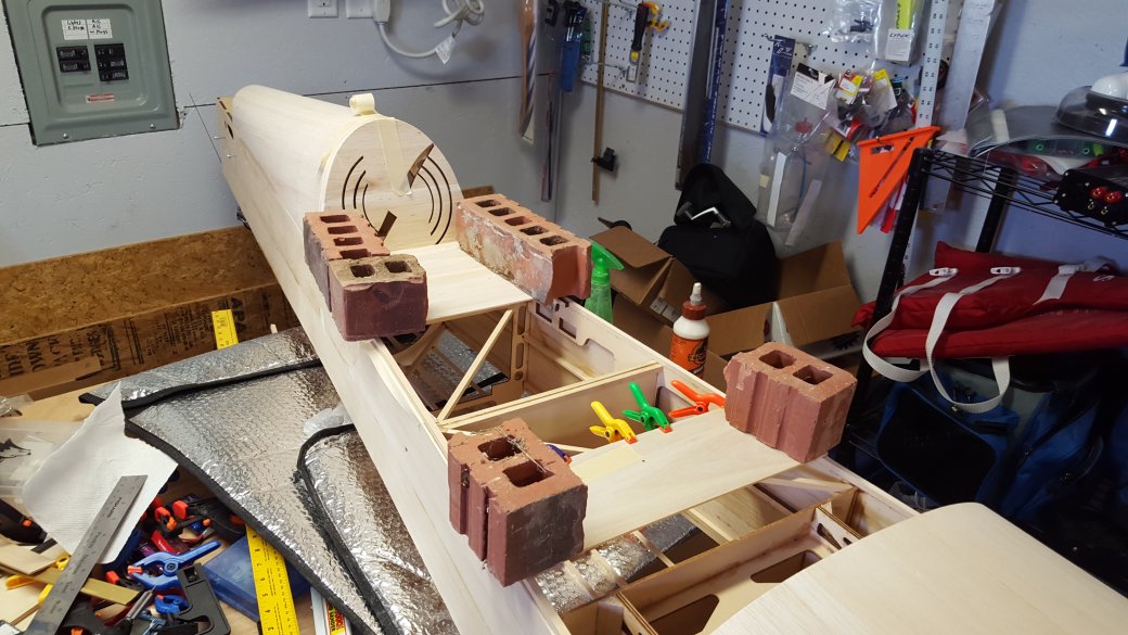

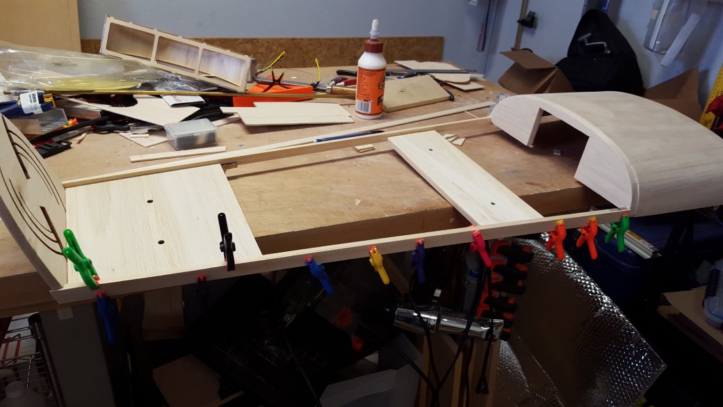

Following that, I glued some strips of 3/32" balsa to level off the tops of the 1/4" spruce with the floor. After letting the glue cure a little, I glued another piece of 1/4" spruce on top of that.

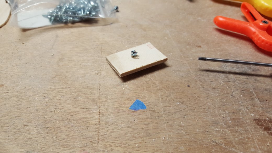

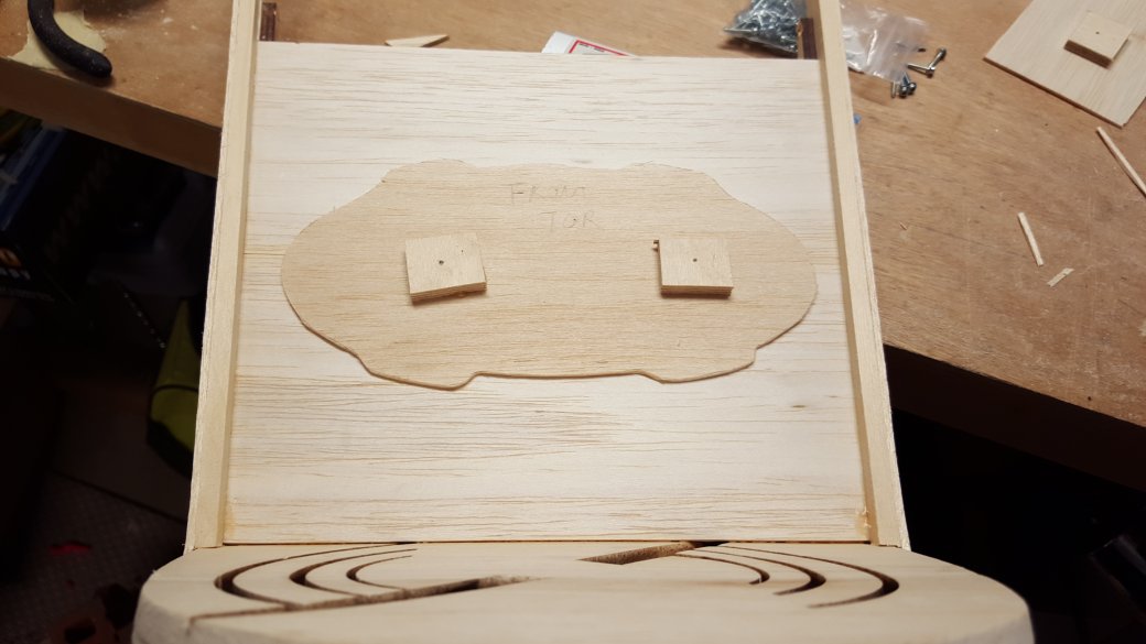

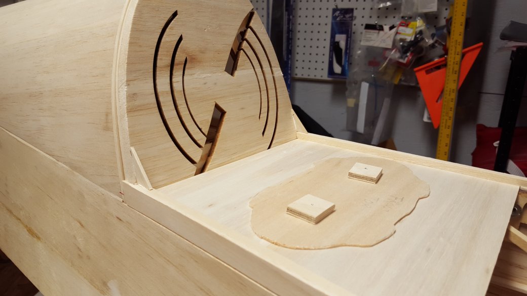

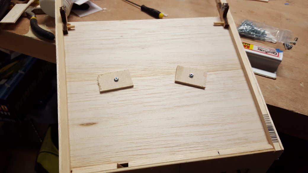

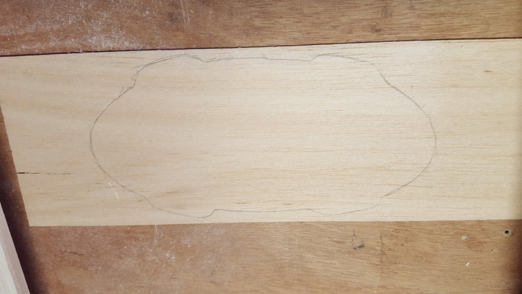

While that cured, I started to work on tracing the bottom of my pilot figure and instrument panel. When I put down the stone paint, I want to keep from applying paint where the pilot and panel go so I have a flat surface to glue to. I just used some pieces of 1/16" balsa I had leftover. I then cut some holes in both the templates and the floors with a piece of sharpened brass. I glued on some lite ply blocks to one side of the 1/16" balsa. I'll be able to tighten and sandwich this down but I'll also be able to move it around if I need to before I paint. More pics will come later.
Lastly, I glued on a strip of 3/32" balsa to sides of the hatch frame. I just did one side and I will do the other later.

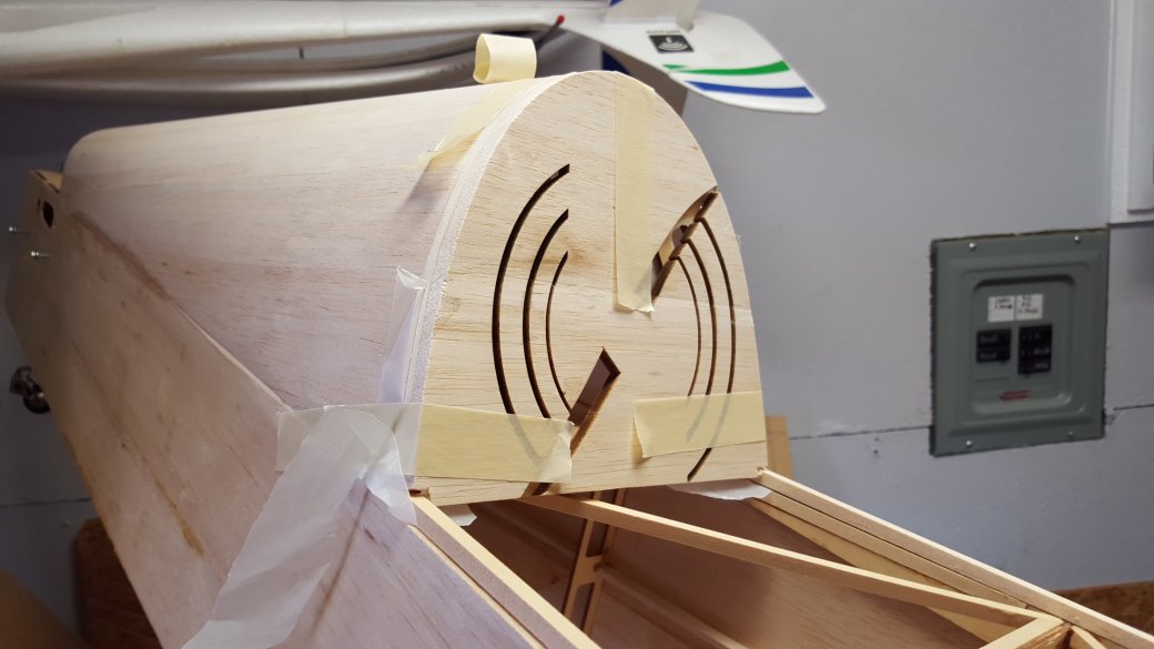

Last little bit showing the method I'm using to effectively mask off the area where the pilot and dash will go.
I also added some balsa to help reinforce the backplate.
