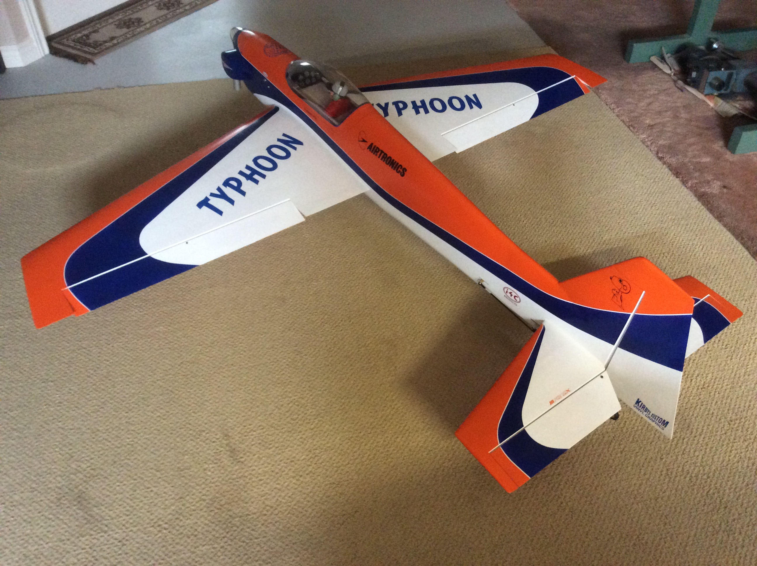

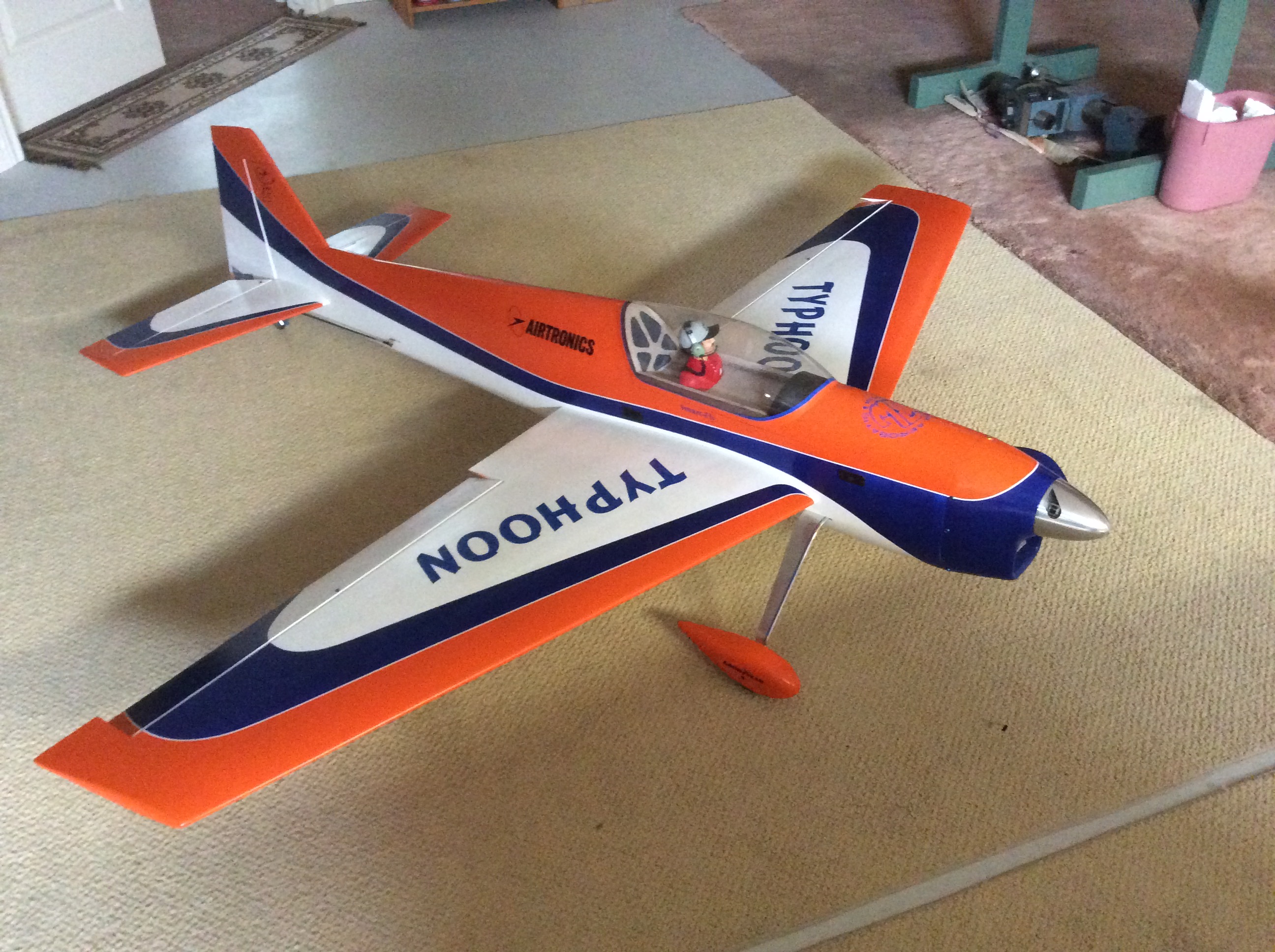

    Well if you like coveral and dope then I think you may like this. This is a scratch built from my Own design an 80 inch wing span pattern plane. Covered and painted with Stits. And the plane weight is 16 lbs wet ready to take off, it has a 3W-42 in it and fly’s great. Not totally unlimited but good enough to play around on a weekend.
    2500712A-4682-445A-AE4B-83623ADC2AF1.jpeg 9B8DCFAA-848B-4FB7-919D-BBD0055FA07F.jpeg
    49dimes, dhal22 and pawnshopmike like this.
  8. Now thats my kind of airplane. I love it.
    Snoopy1 likes this.
