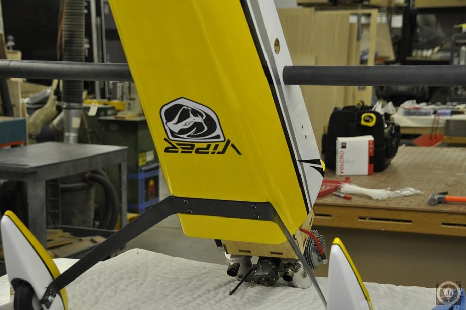

OK, lets start some building!!!! After spending too much time on GSN this morning I had to work late but did make some progress.

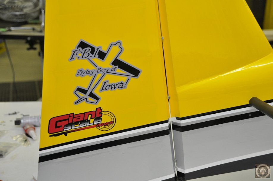

I had a couple more stickers that I had ordered ahead when I built my last plane so I put those on. Now the plane really feels at home in the shop with the highly coveted FBI sticker installed! The Viper logo on the belly looks cool when doing low nose up torque rolls so it's kind of become a signature of mine. Thanks to Eric at B&E for working with me on the graphics that I designed, he does all my custom work:way_to_go:
Terryscustom

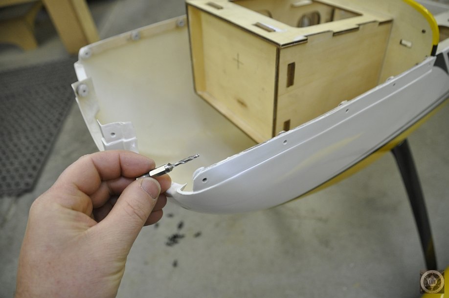

First thing I like to do is use a tap and go through all of the blind nuts to clean out any paint residue or other gunk that may damage the threads of the assembly screws. I always run the screws in once as well before trying to install any part. This saves a lot of aggravation when you just start the screw and it locks up.

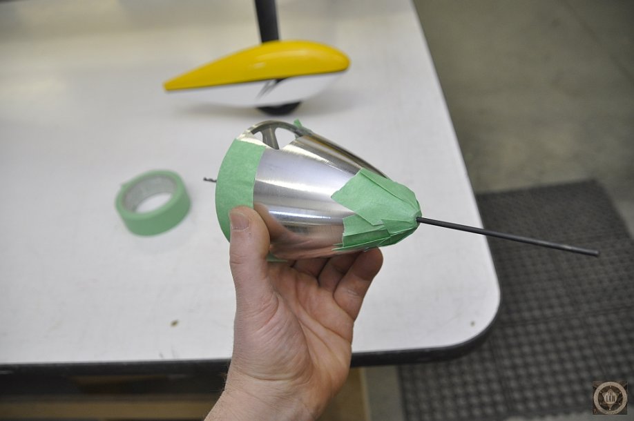

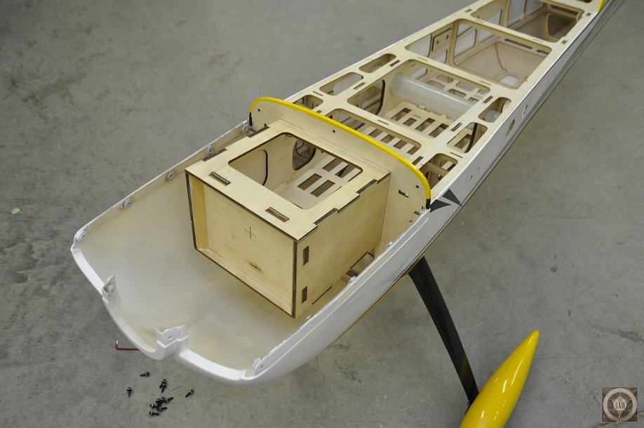

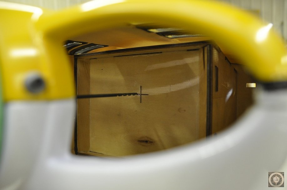

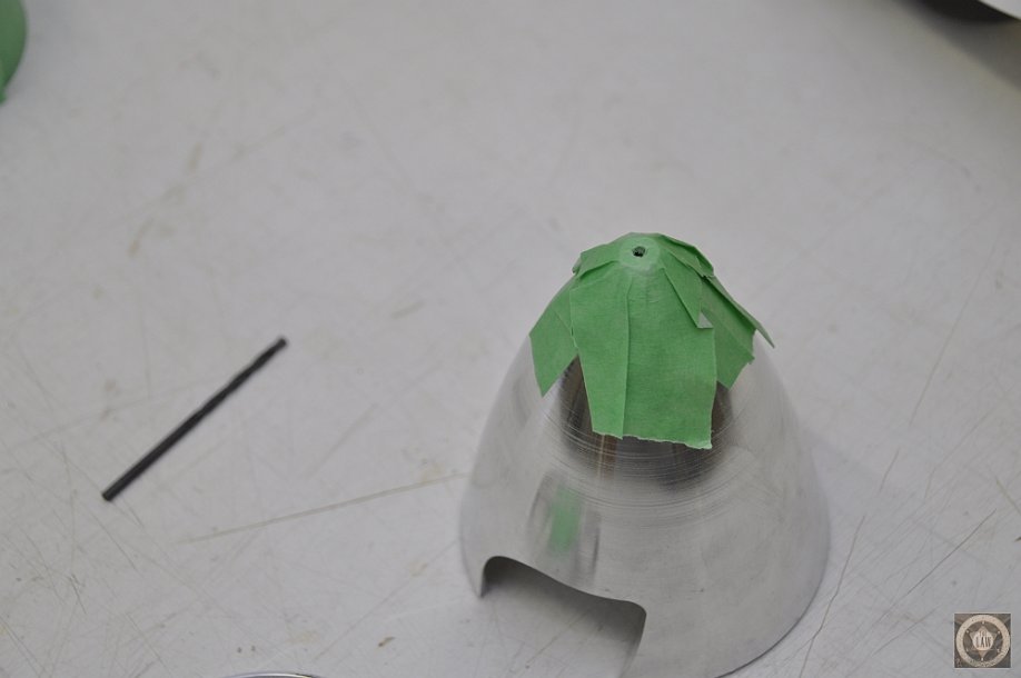

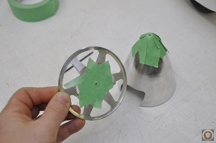

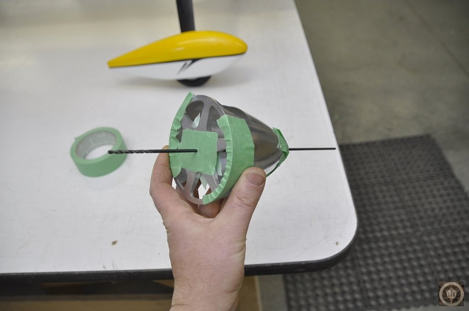

Now since this is a prototype the cross hairs in the firewall is known to be off so I'm going to show a redneck way of checking for center. What I do is install about four layers of masking tape on both sides of the spinner back plate, then repeat on the front of the spinner cone. Use a pin to poke a hole in dead center of each pc. of tape. Enlarge the hole with a center punch and slide in a section of piano wire or a long drill bit. Install the cowl and hold the spinner in place, then you can poke in the wire to check for center!
This gets you in the ballpark and really close to home base. If using piano wire sharpen the end so you can poke a mark in the firewall.

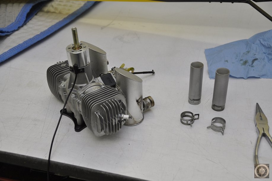

Now it's time to mount my engine. I have a nearly broken in DLE120 that is running extremely well and it came out of the yellow scratch build prototype. This engine has had amazing power on the 25.5lb. plane it was on so it will be more than adequate power on this plane. I have run it with the Falcon 28x9 and 29x9 and it can rip them both at WOT.......perfect:devil-dance:

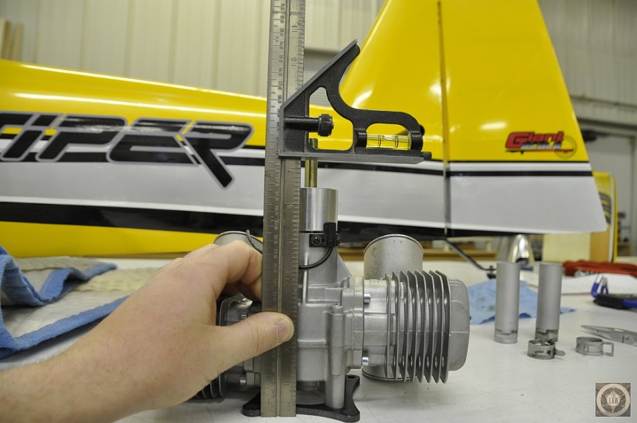

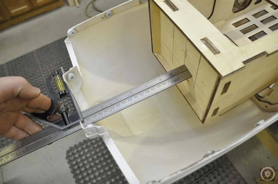

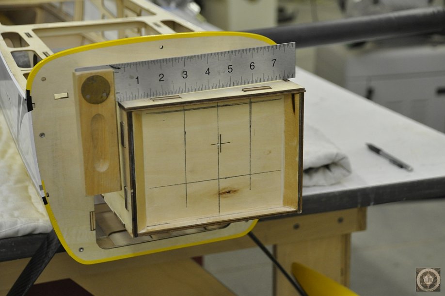

First I measured the back plate and used a square to draw some lines to locate the centers. To measure standoffs is simple. Install the cowl and use an adjustable square. Hold it flat against the face and extend the ruler to the firewall. Lock the square at that dimension. How hold it next to your engine and measure the difference. Add whatever you like for spinner / cowl gap and that is your standoff length!!!! Easy!!
