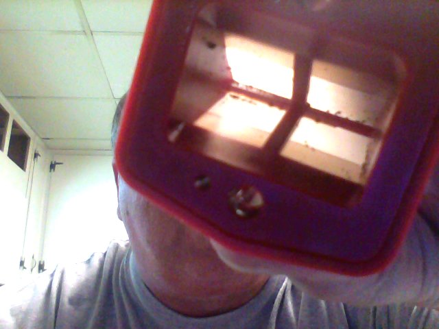

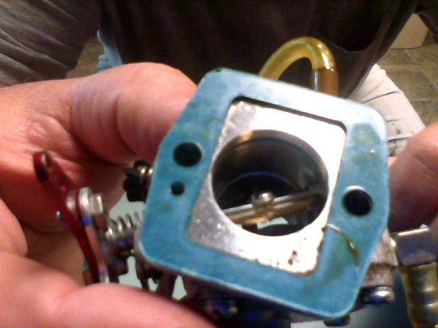

Just a couple of pics to show what can happen to carbs and reeds even when the engine is not running. I'm going to run an air filter now. This was a caused by a dead stick landing in soft sandy dirt. Thankfully none of it reached the crank case. But boy if I had not disassembled and inspected and just did the "wash down" in place??? The carb plate picture is poor. It does not show all the hard particles of sand covering the entire surface.
View attachment 25374 View attachment 25375
Wow your carb really sucks....Lol
It's amazing what can get in and cause all kind of headaches. All it takes is a piece of dirt in the wrong place to cause problems.
