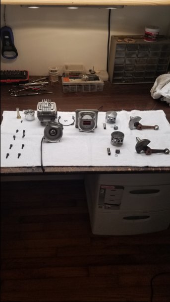

  4. Well it turns out there really was a problem with my DA 60. The mechanic said there was something like a calcium build up in the carb that was causing fuel flow problems. They were able to replicate the problem and get it running.
    Unfortunately in trying to resolve the midrange burble, it got too hot when I tried leaning out the low end. So I got to buy a new piston for it among a few other parts.
    I have to be honest. I'm somewhat debating selling it and get something a little smaller and doing epowah.
    The guy at DA said the best way to prevent this was to store with fuel in the tank and flip the prop every couple of weeks to get some fuel into the carb to keep it wet. This might be hard to do considering A) I'll have to have reminders to do it and B) I store the plane vertically on a wall to save space in my shop.
