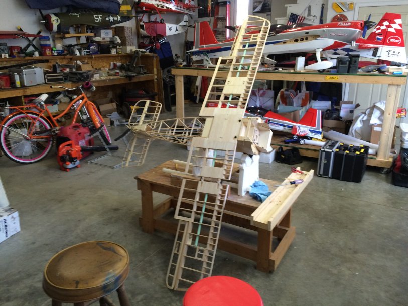

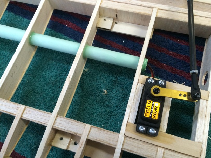

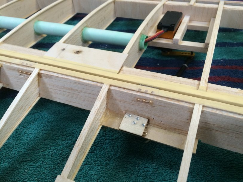

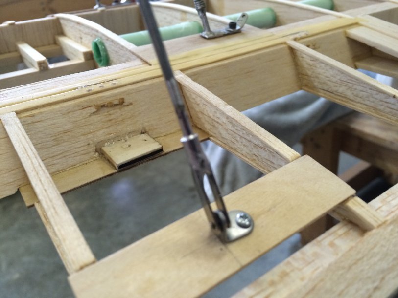

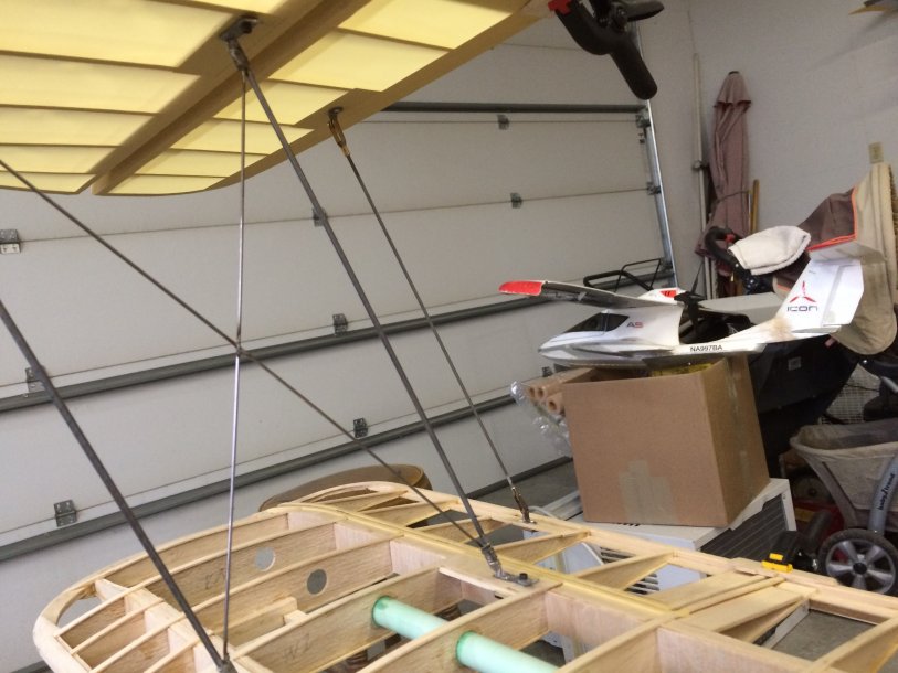

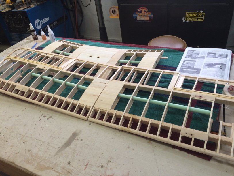

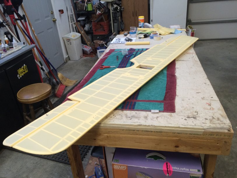

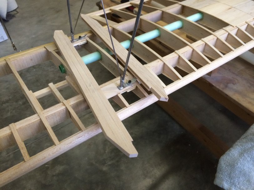

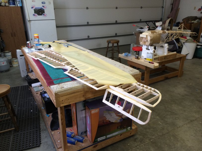

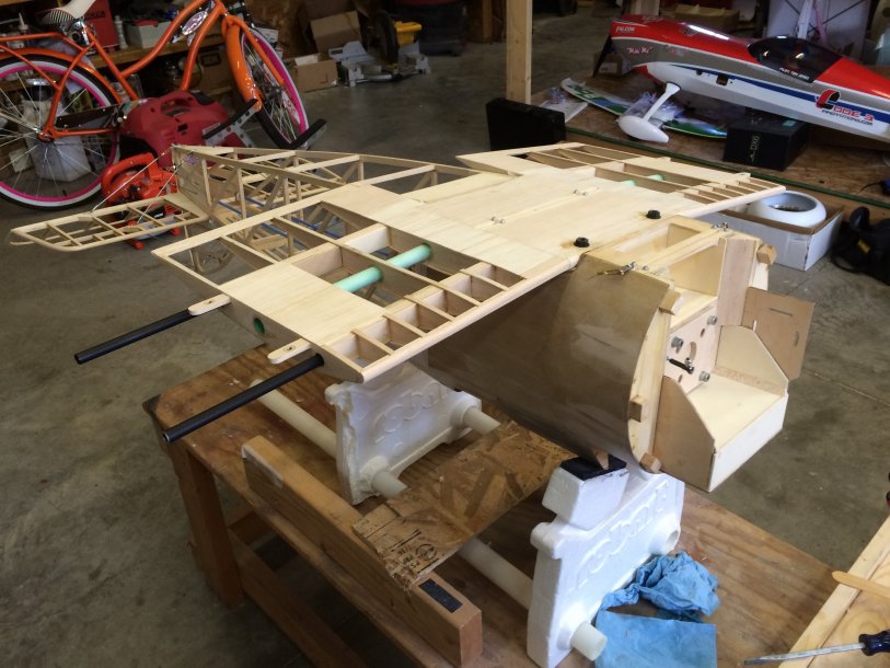

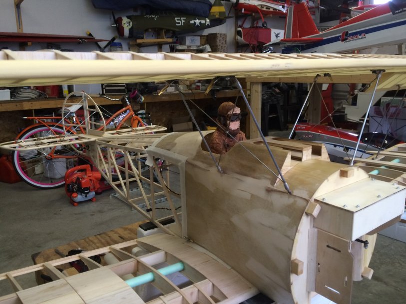

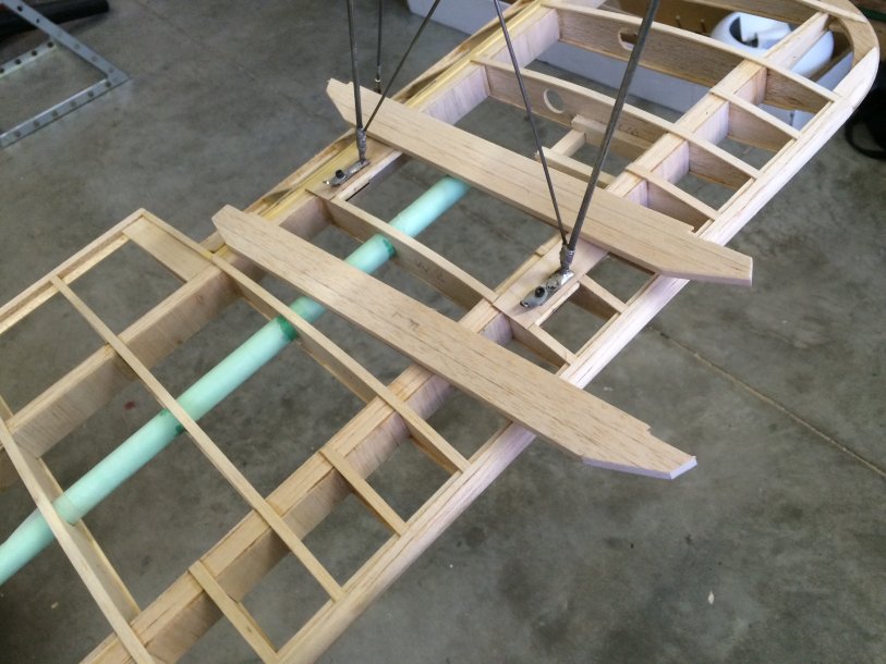

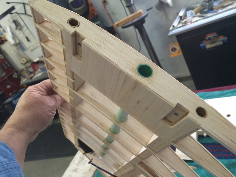

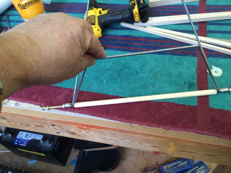

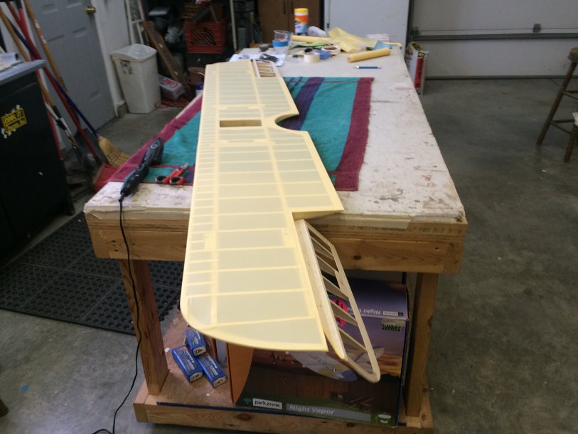

I stuck with it today. I usually louse interest when I get to the piddly stuff. Made up some paper tubes for the wiring in the lower wing. I'll have to take the outboard wing sections off to transport so I don't want extensions to fall inside the wing. The holes were to small to be fishing for wires. Also started caping the blind nuts on the lower wing. Wings are close to being ready for covering.

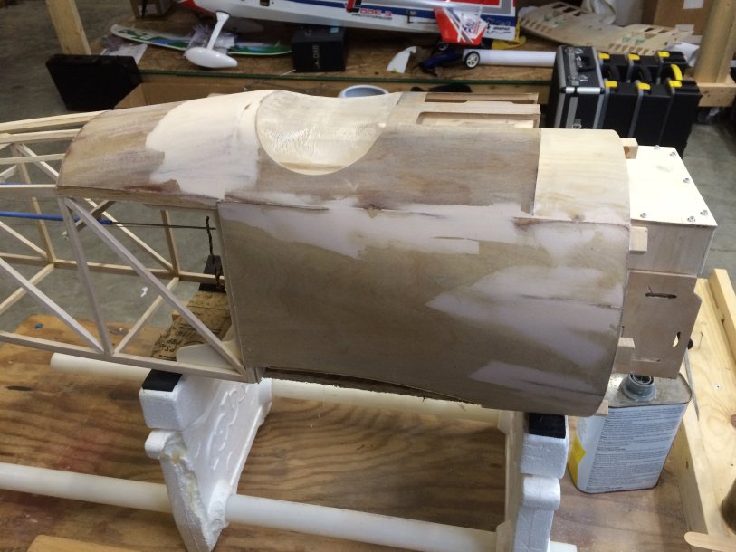

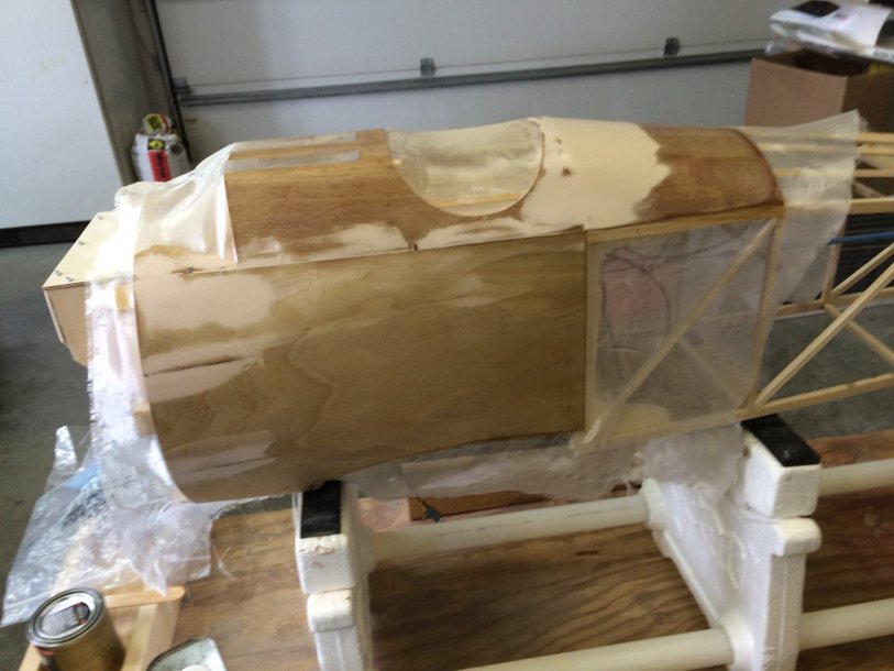

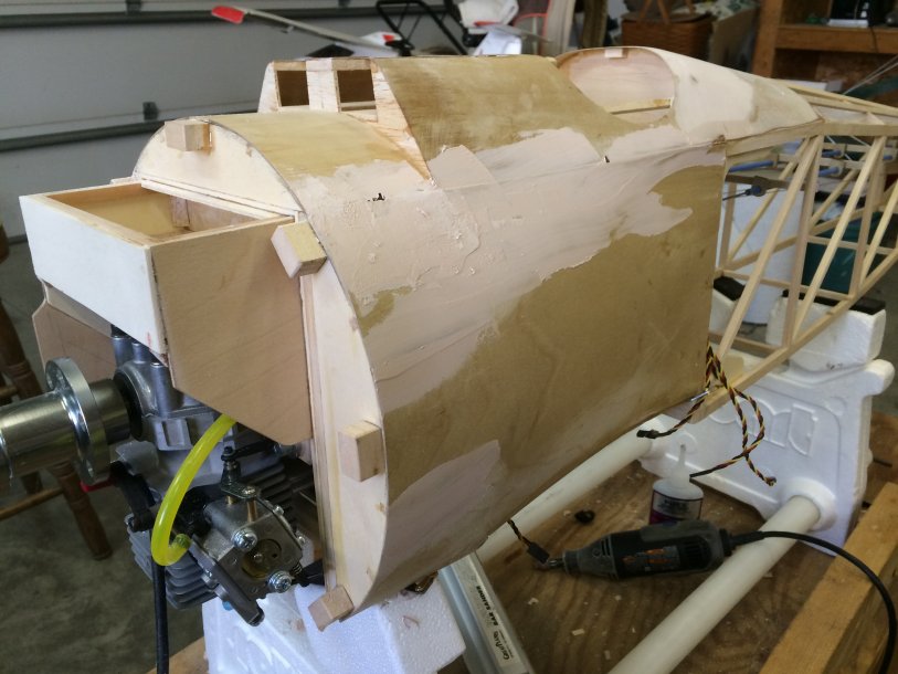

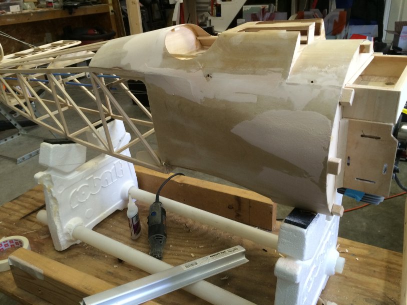

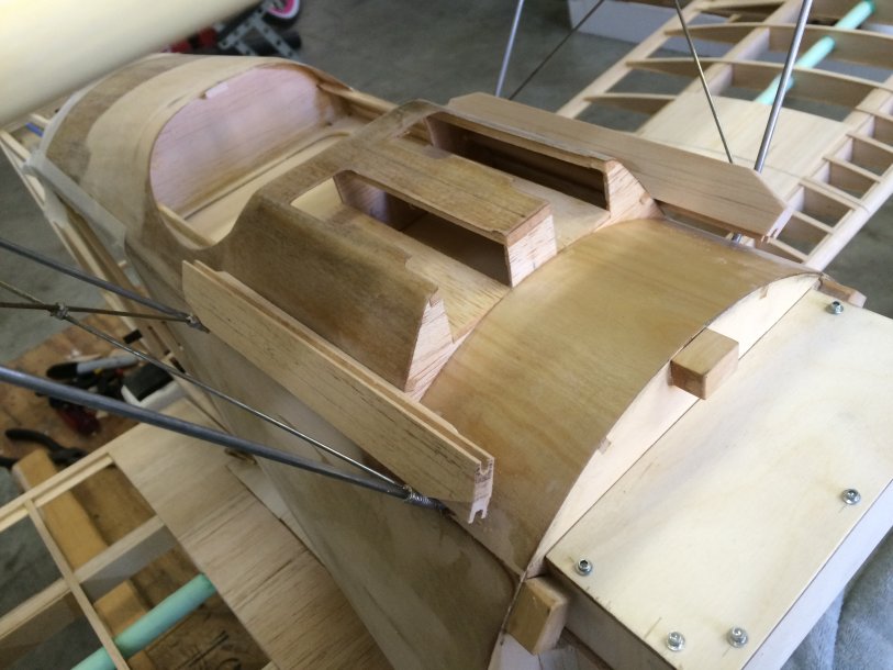

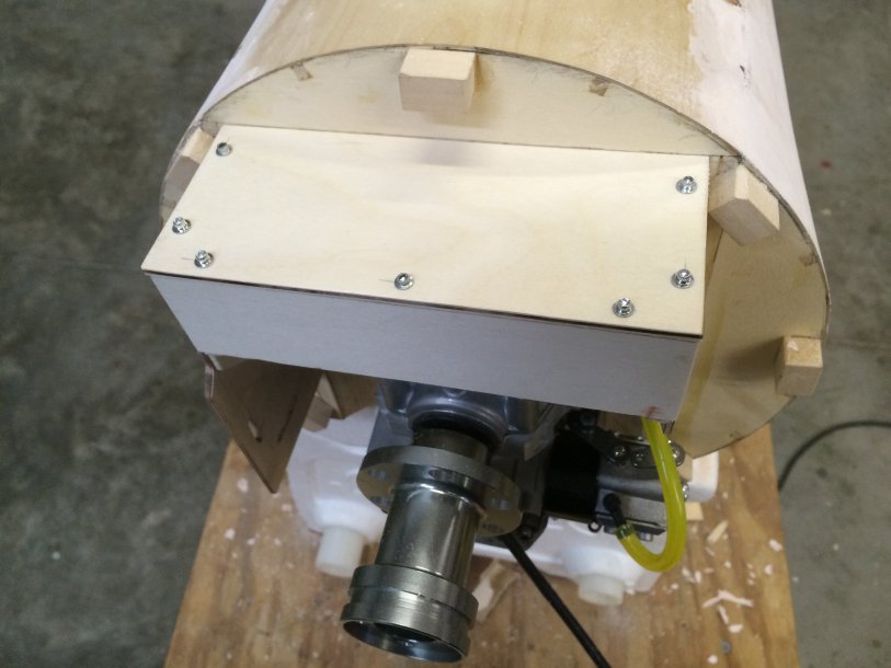

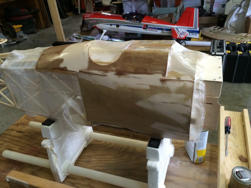

Going to fiberglass and paint the front section of the fuse so I'm prepping the cracks with some putty. Also made up and mounted the cover for the battery box.

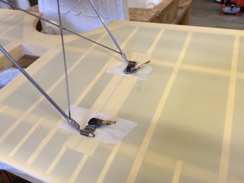

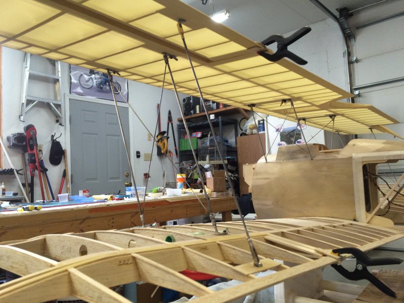

I'm back and forth about putting stitching on the wings. It would add to the cost and its close to flying season. Besides, no one can see it at 60mph.

 Keep up the great work on your Camel Tom.
