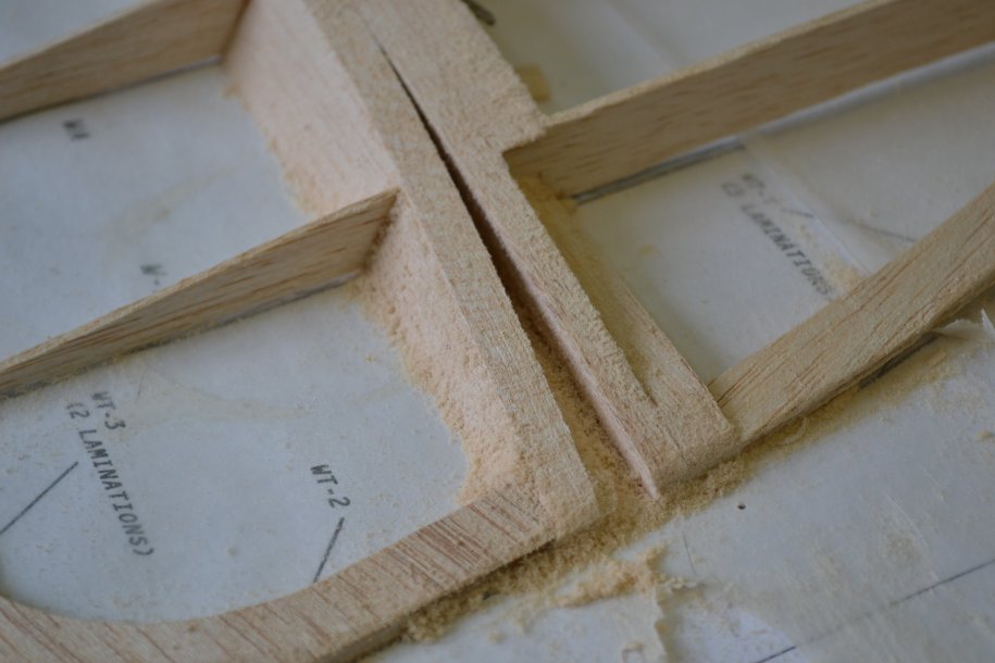

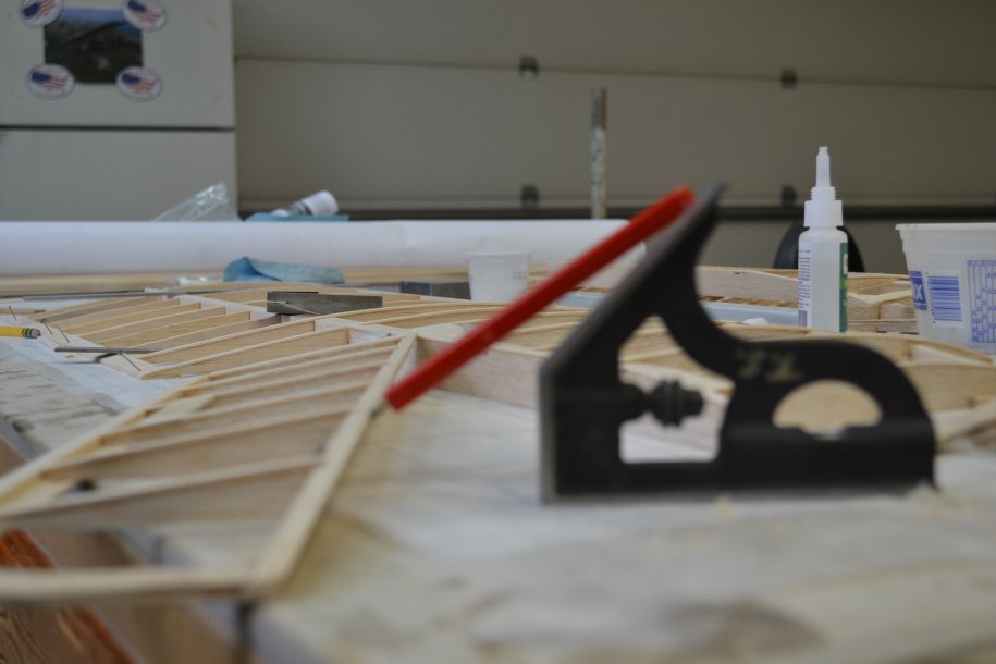

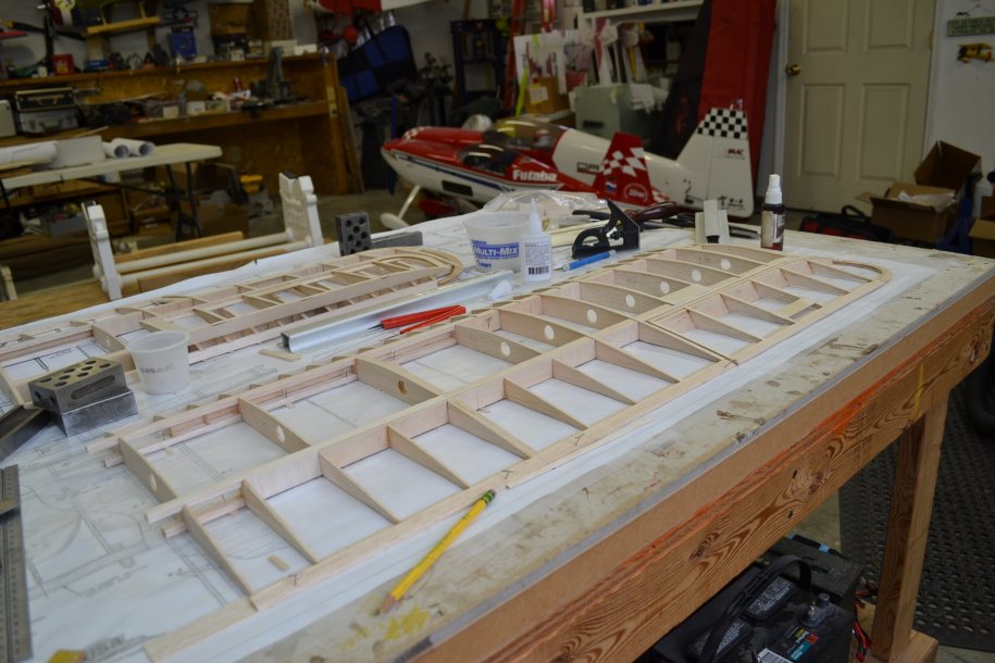

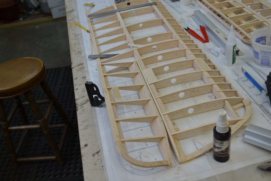

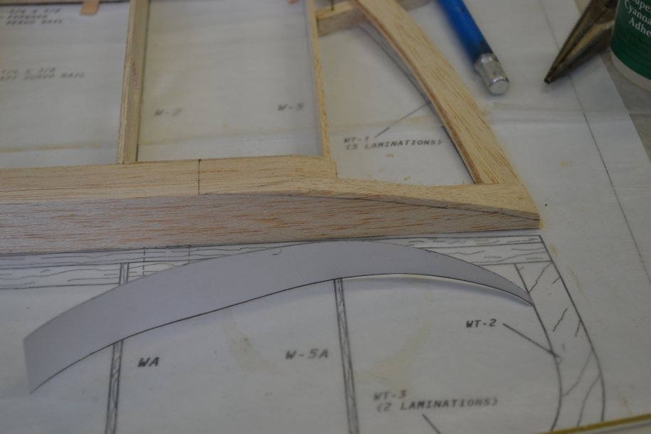

I sanded the spars down to match the ribs. Then I made a paper templet to match the wing tips to the other side.
DSC_0085.JPG DSC_0086.JPG DSC_0087.JPG DSC_0088.JPG DSC_0089.JPG DSC_0090.JPG DSC_0091.JPG

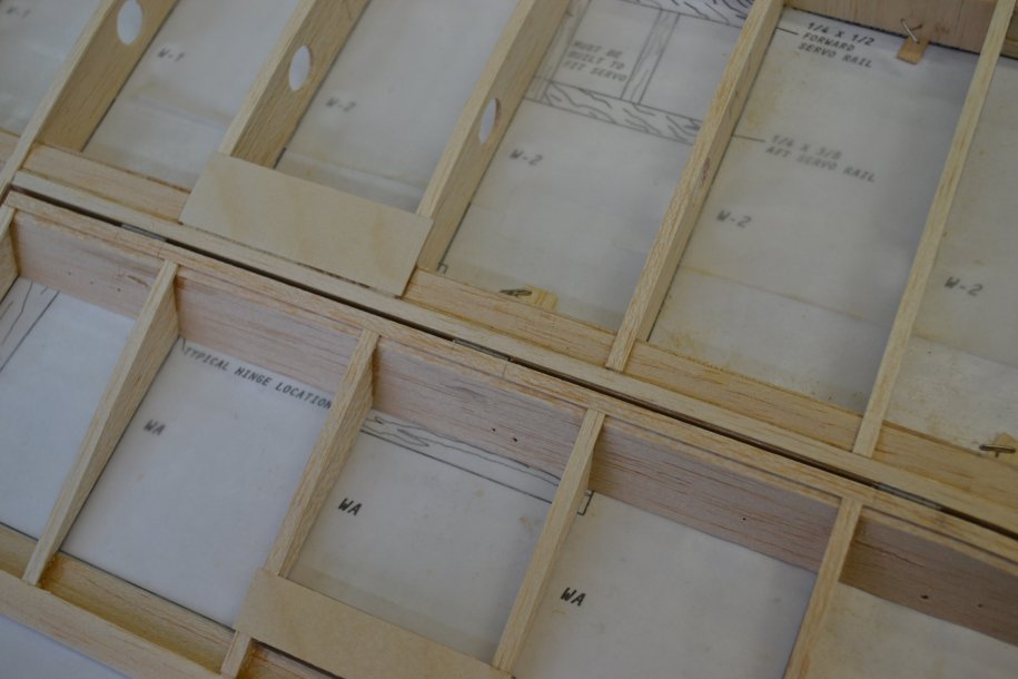

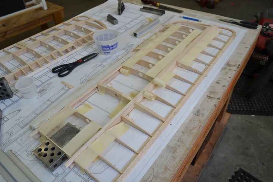

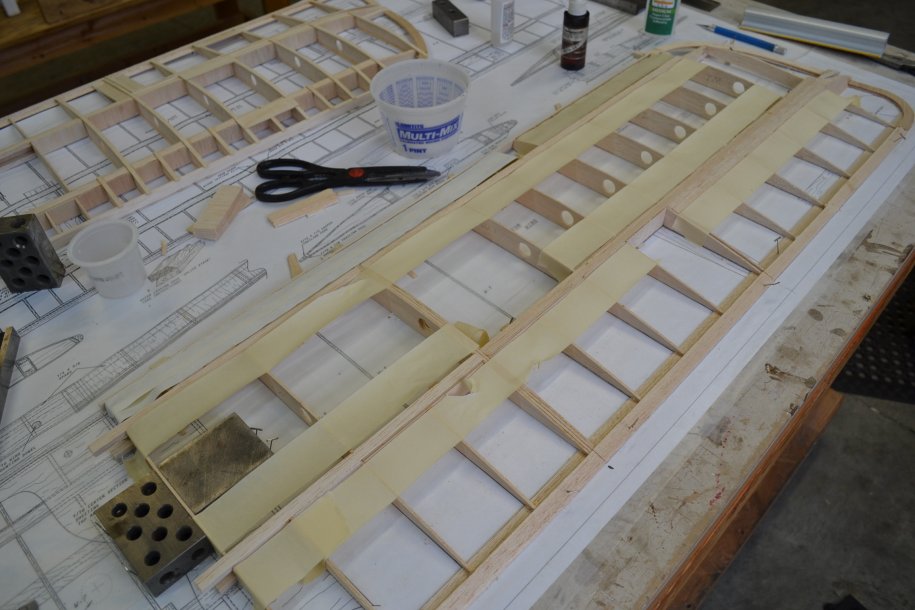

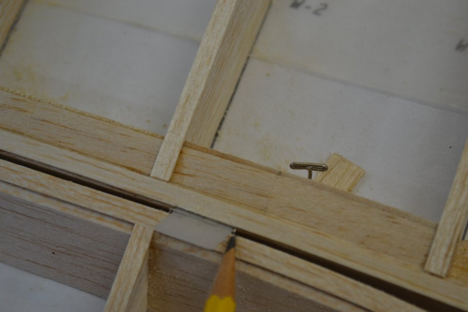

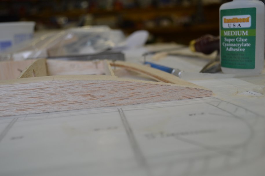

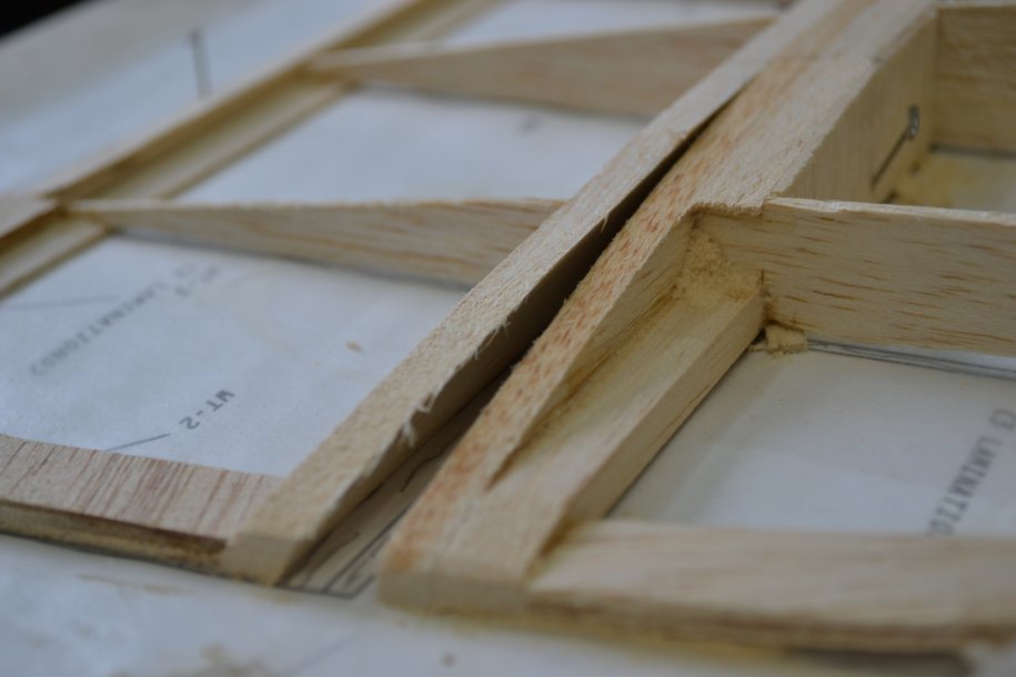

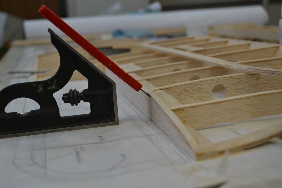

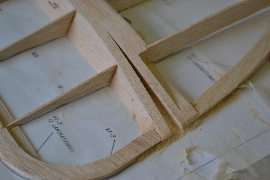

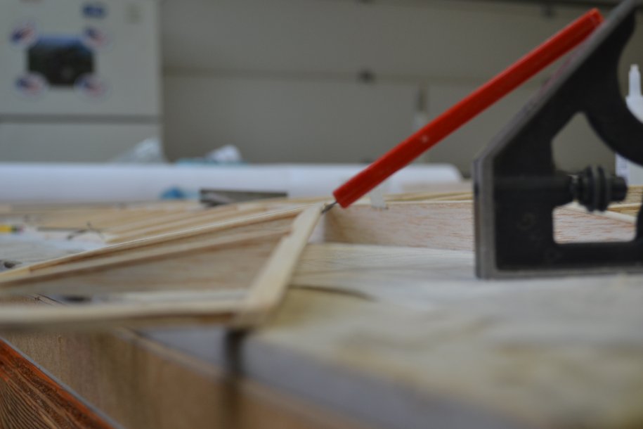

Some pictures of me hinging the the last aileron...
On the wing side I just try and angle the hinge slot at a 45*. On the aileron side I just try and split the difference in the wood, since there is an angle clearance on the aileron.
Also put as many rib caps on the top as I could without interfering with future work. I'll get some cap strips on the bottom before I put this section on the pegs till I can do more work on them.
