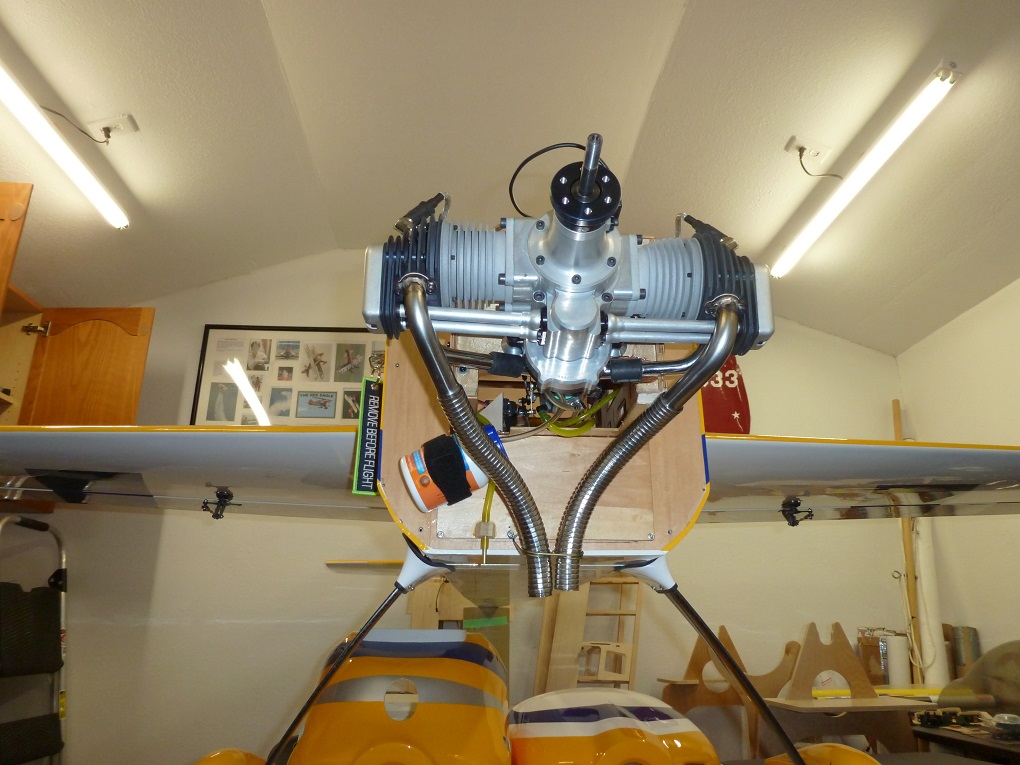

The flange and header has been brazed and bolted in, there is not enough room to run them into a Y (comfortably anyway) so this one will be a dually. The cowl outlet has been cut and cowl shimmed, I figured it was easier to shim the cowl than the engine.

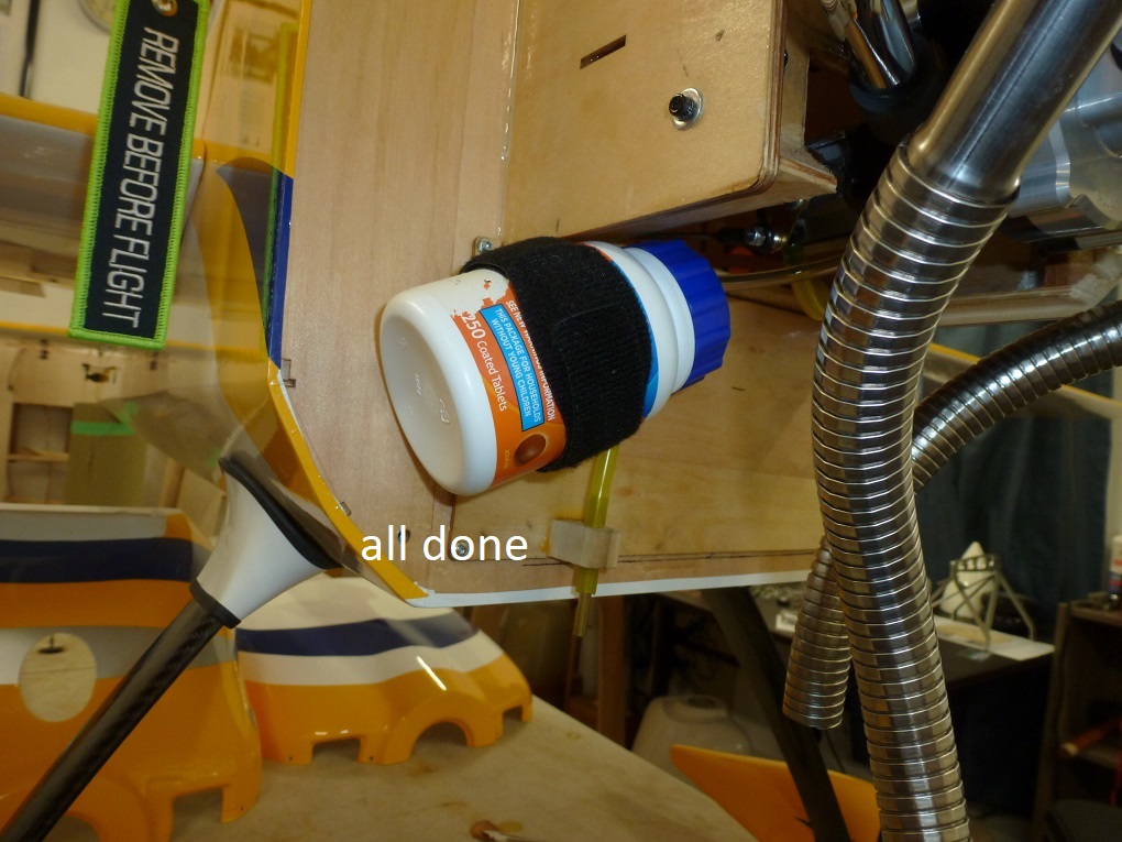

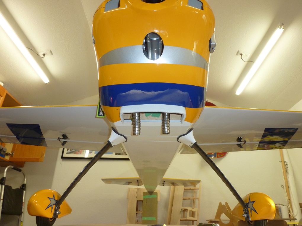

Added a lip to the exit area but I don't know if I gave it enough slope to the rear. I still need to brace the exhaust and add the crankcase oil catch bottle, both of which I'll pick up in the morning when I go to get drywall. Also need to drill the prop, cut the spinner, and close up that hideous hole on the cowl. I may just get this beast out one day this week to fire it up, maybe....

As long as it is 45 degrees or more you are ok. But best of all is that you ran the lip down the sides that is the correct way to do it. I cannot belive how many times I have seen people build the deflector with out the sides they just do not realize how much of the deflector is lost because of not putting in the sides great job.

And then made the exhaust support. lol It's just wire wrapped around and screwed to the firewall but has worked well in other models. KISS method, right? And a little silicon will be added around the wire/pipes later for vibration.
