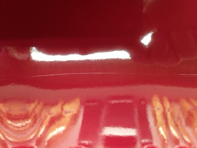

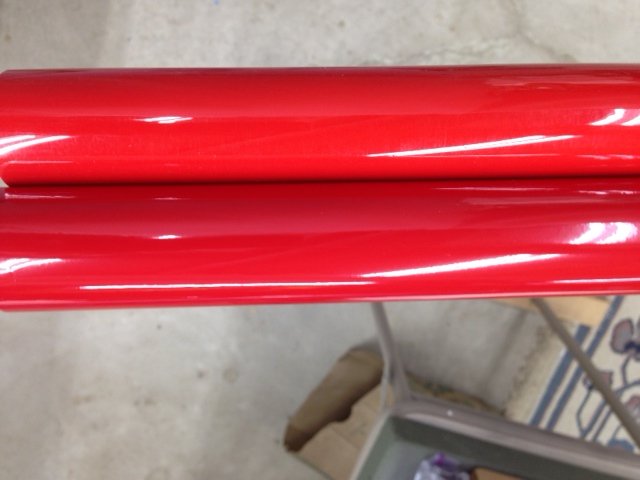

I went ahead and covered my recent Monocoupe project with Monokote but not without problems. Most of the plane is covered with Missile Red all bought from from Tower. This seemed to be newer stock and it stuck to itself quite well and the shrink rate was what I would call normal. I used parts of (7 or 8) rolls and each roll was a slightly different color than the others but I was able to make it all work. Two rolls were noticably lighter in color and none of these rolls were even close to the same covering color purchased a few years ago. All were much darker than previous. Each roll had a noticable scratch about 1/3 the way into the roll and for most of the length of the roll but I was able to cut around this for usable sized pieces to complete the project. I am contacting Great Planes about this scratch issue that has to be coming from the equipment used to mfg. or package the covering. My original trim color was to be Maroon but the roll of covering I bought was apparently from the period where they had the sticking and shrinking problems as it would do neither very well and in fact it even expanded when heated rather than shrinking so I abandoned that color and switched to Black for trim. I bought a new roll of black Monokote but found it had the appearance of being sanded or scuffed at random in places all over the covering along with the fore mentioned scratches. All the scratches or scuffs were lengthwise along the covering which made that roll completely unuseable. At this point, I gave up and switched to Ultracote for the black trim. It seems to stick to Monokote well so it will have to do.

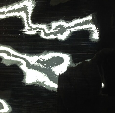

I like Monokote also. I didn't have any trouble with the white, yellow or blue. But the metallic platinum was as you described. Scratches and swirl marks in the finish. Thankfully I was only cutting checkers so I was able to work around it

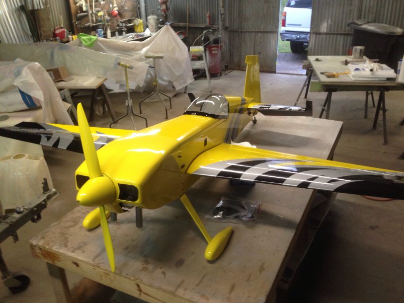

Just used Hobby King Yellow and black on this 35% Panzel

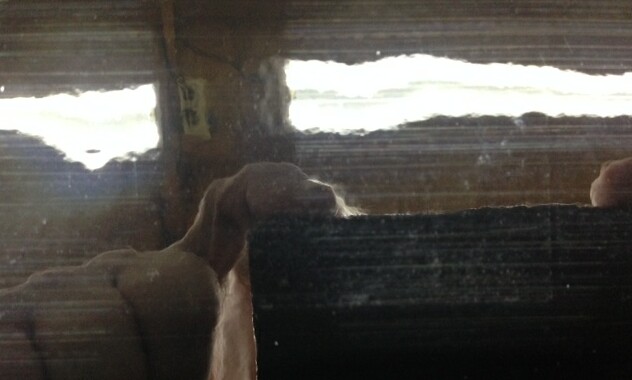

I believe that getting good Monokote material is just the luck of the draw. Note my comments that the red I used all worked just fine with regards to shrink and adhesion .... but every roll had scratches and every roll was a slightly different color.
Here are some photos that show an example of the scratches and the different shades of red. Click on the files for a better view. Its hard to get a good photo of the surfaces but the scratches are clearly visible and they are all the full length of the rolls.
