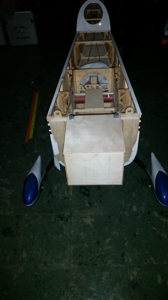

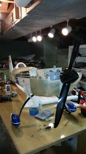

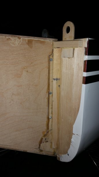

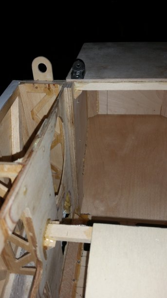

20141117_155234.jpg 20141117_155241.jpg 20141117_155255.jpg 20141117_155330.jpg 20141117_155321.jpg Fresh new wood.

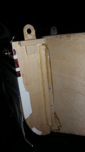

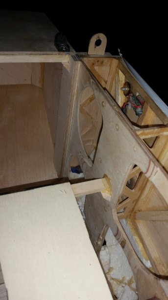

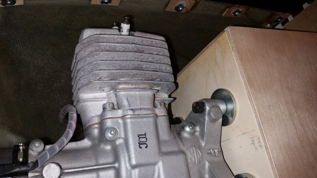

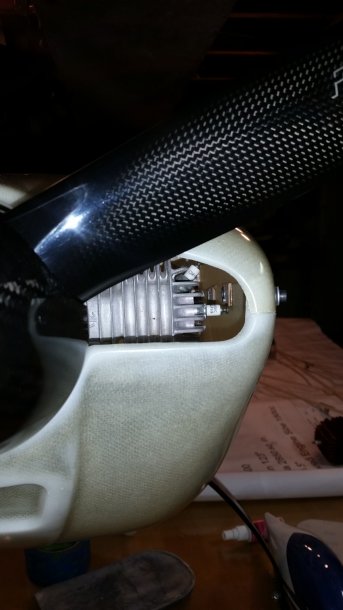

Power will be a 2004 model 3W 106 TOC twin spark!! It'll have a pair of 6V RCExl ignitions on it for spark. I just got the engine today, and decided that this would go on this airplane. So, I had the firewall marked via the plans. Knocked 4 holes in the firewall and installed the blind nuts.
Will have a few y harnesses to make for the ignitions, so nothing new there. I will regulate 2S LiPo via a CC BEC. Been using them for years as throttle servo regulators, just add in a signal wire on the male side.
Not much more to report on as far as progress, as I sheeted the hatch on my D300. Slow progress, but progress is progress! :)
