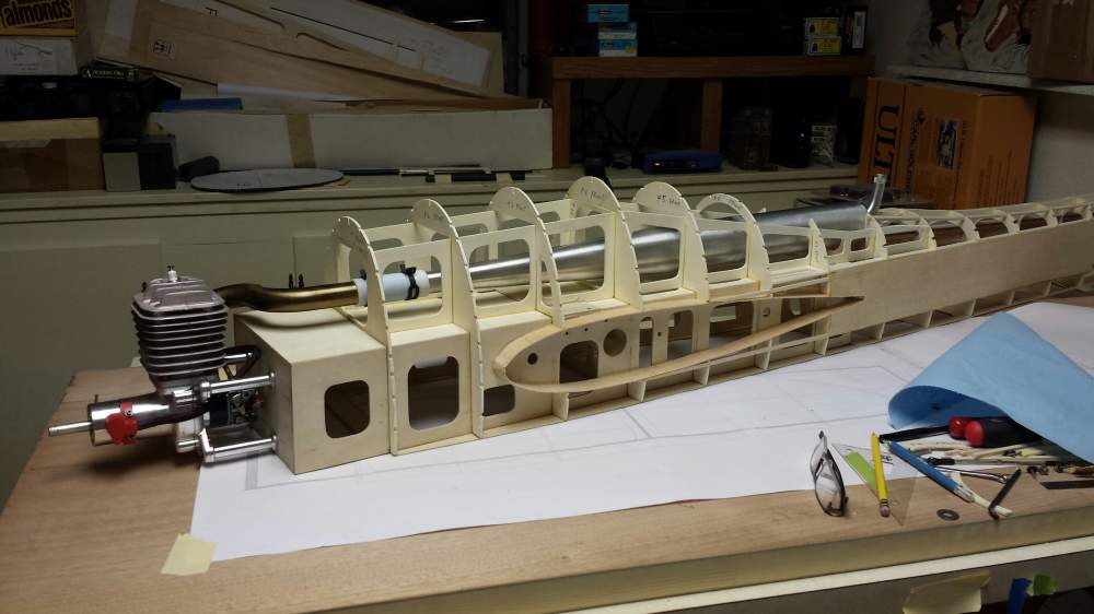

All of my DA50'S were mounted like this one in my scratch build.
This has been my normal method of mounting engines to a firewall. Haven't had any issues so it must be right....right? yellow-smiley-confused-emoticon.gifI do take the necessary time to make sure my firewalls are trued and straight though. Can't see they would be any different than a flat piece of stock or plate than just the simple firewall it self. Just too much B.S. and extra weight if you ask me. LOL
