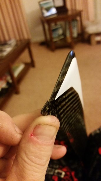

  2. Found this when I opened up a brand new pack of main blades. Haven't heard anything back from the vendor I purchased from. But I know who I can talk to to make this right. ;) Or I'll just fix it and fly the jeepers out of them.

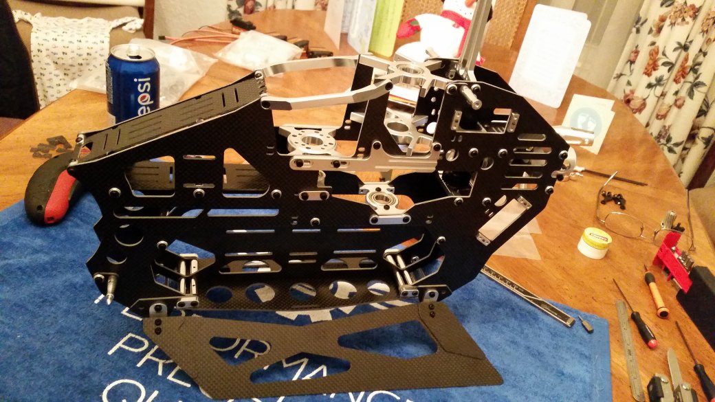

    I got started on the build last nite. It is a really straight forward assembly. So easy, a baby could do it. Well, figuritevly speaking..... a little over 3 hours, and the main frame is 95% done. Just need to mate the main shaft and main gears together to the frame. :)
