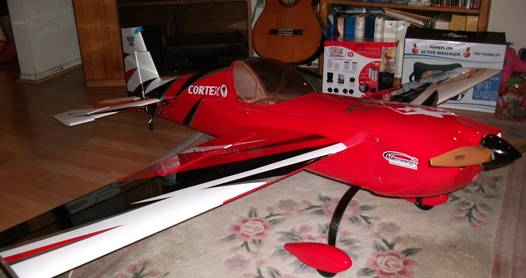

Finished today, maiden sometime this week. Looks incredible, the red really pops. Build was pretty straightforward, nice kit, ever thing seems to fit great. Looks like it will balance with the 6S 6200 in the middle of the tray.
