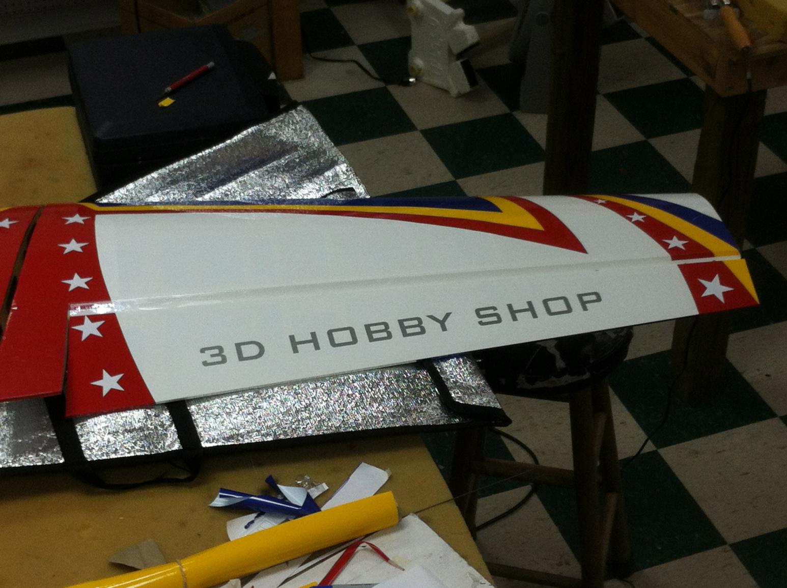

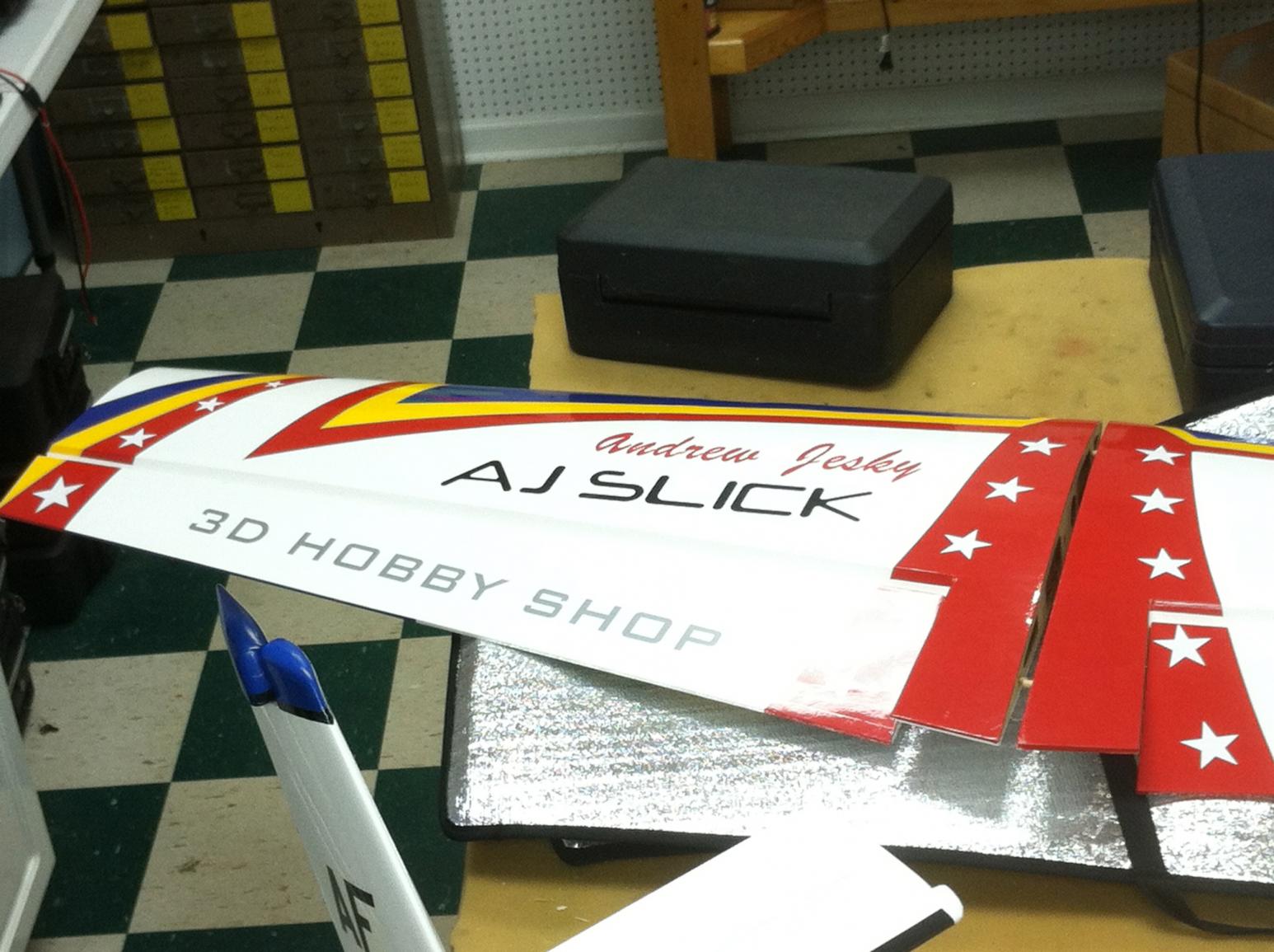

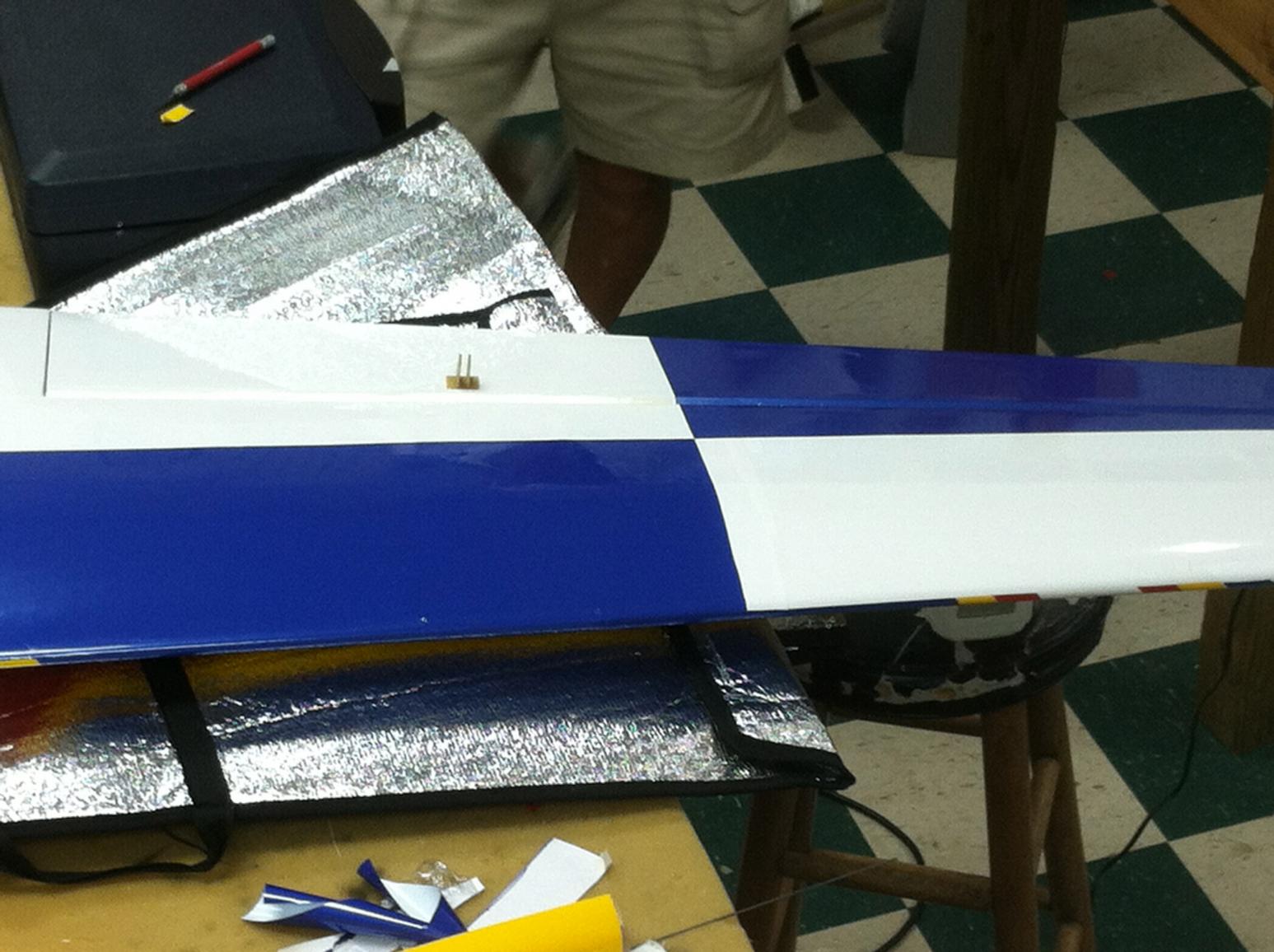

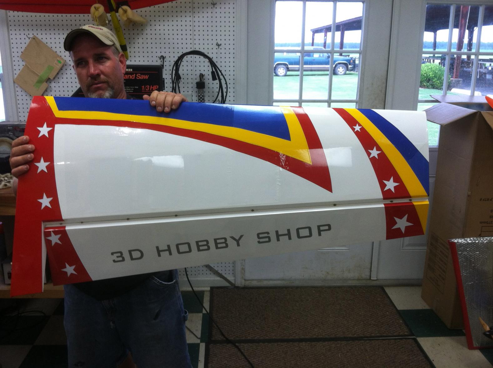

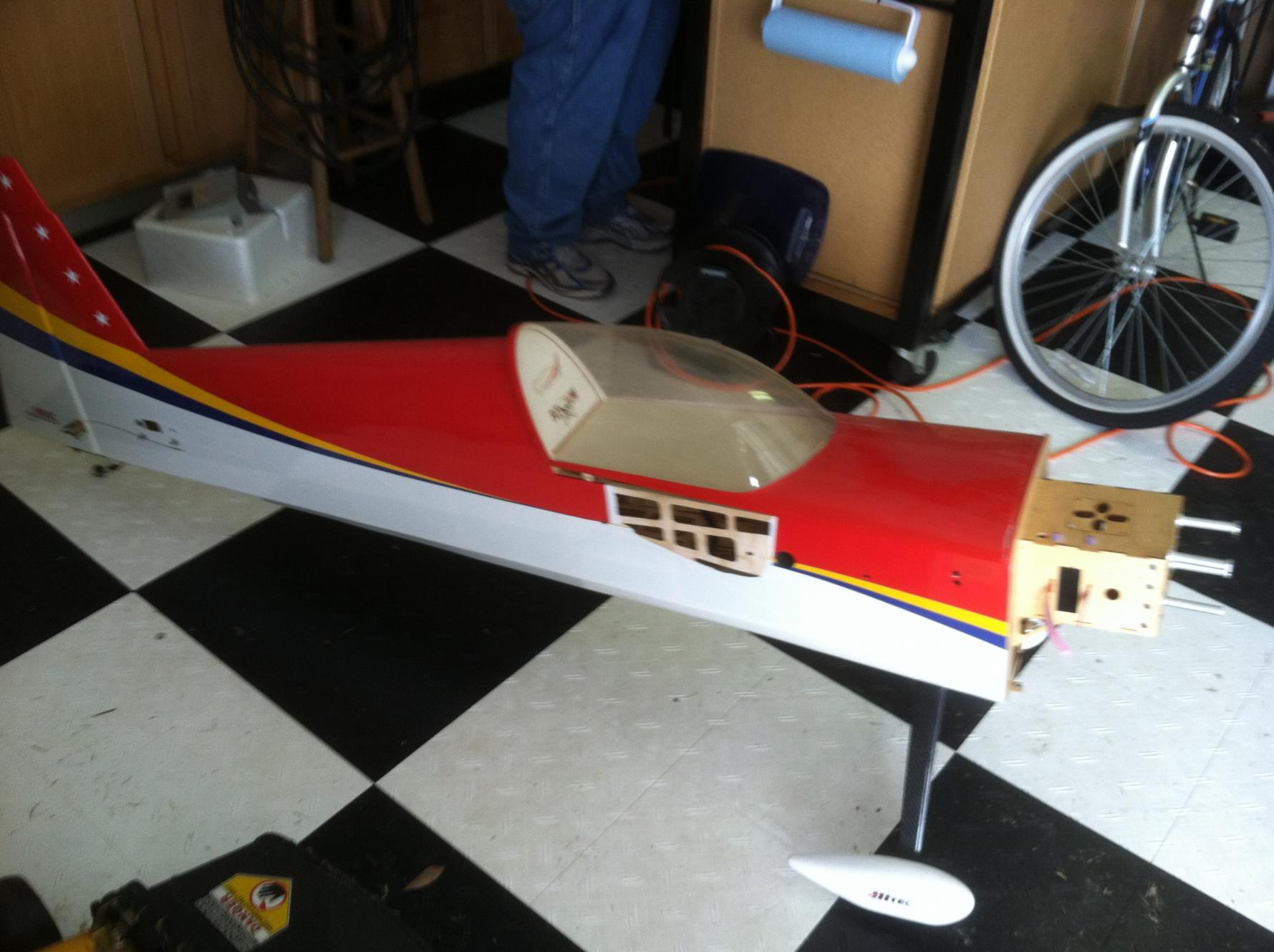

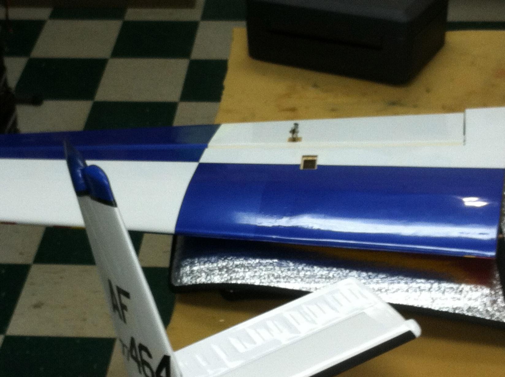

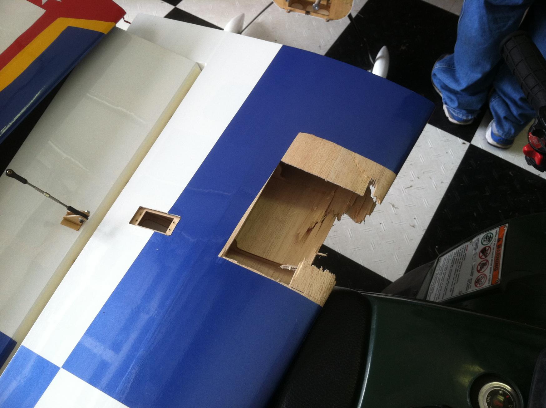

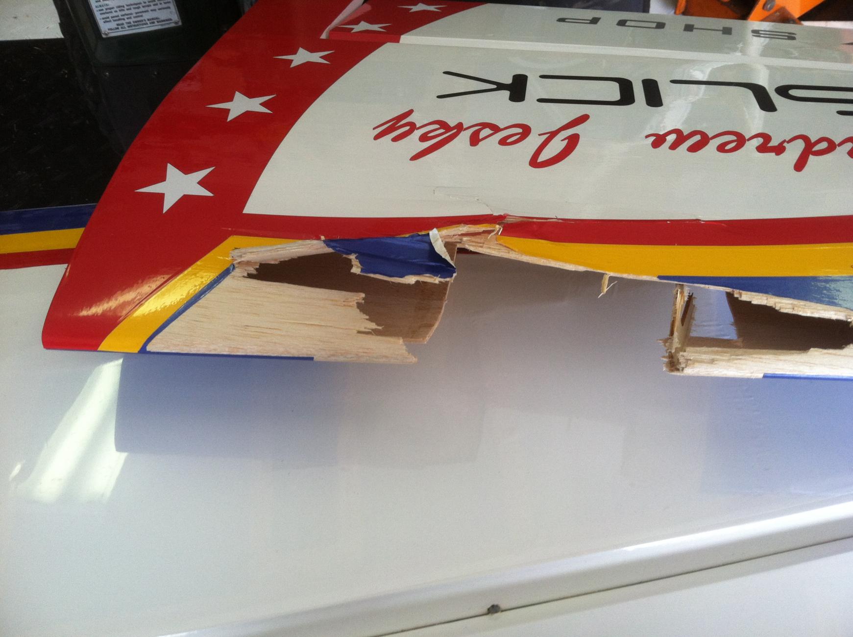

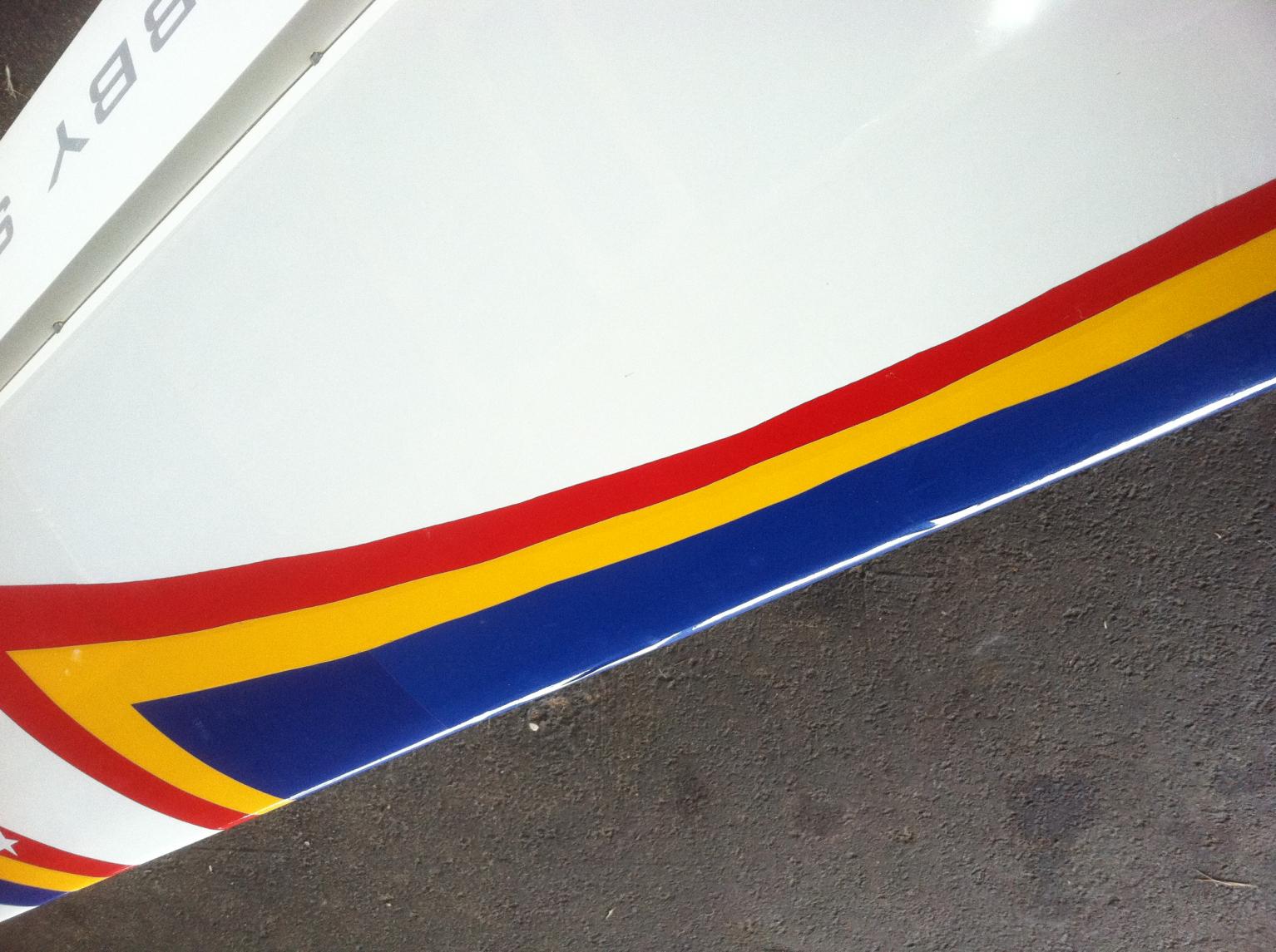

I bought an 89 slick with some damage to the wings and side of fuse from an unfortunate introduction to a deer feeder during a landing from what i was told. It was fairly new at the time. Took me several months of working on it a little at the time with supervision from some of my more experienced builder buddies. Was a major learning curve and I recommend it for anyone.Here are some pics i took along the way.

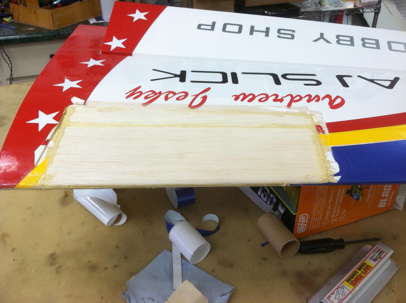

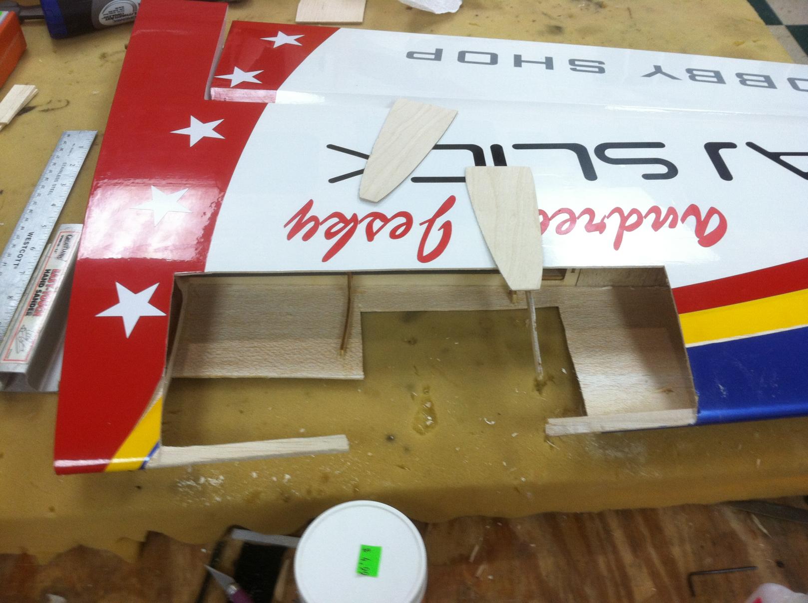

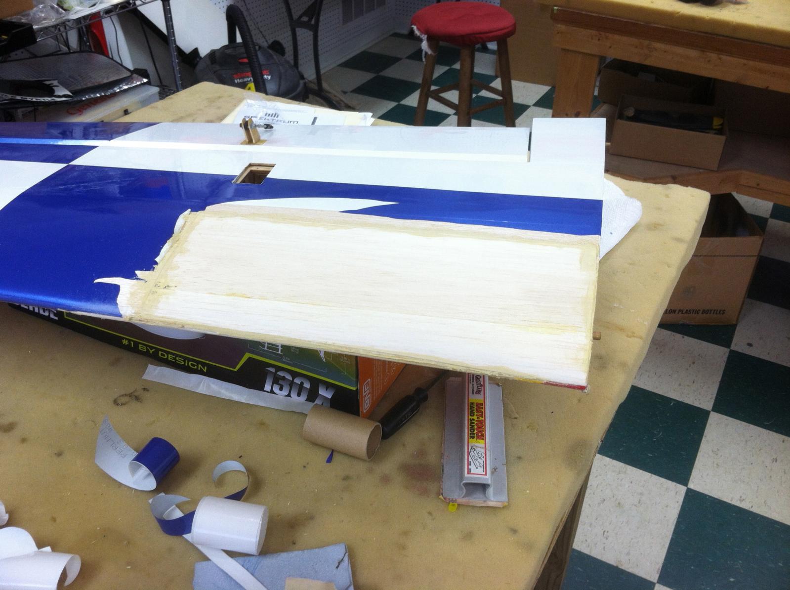

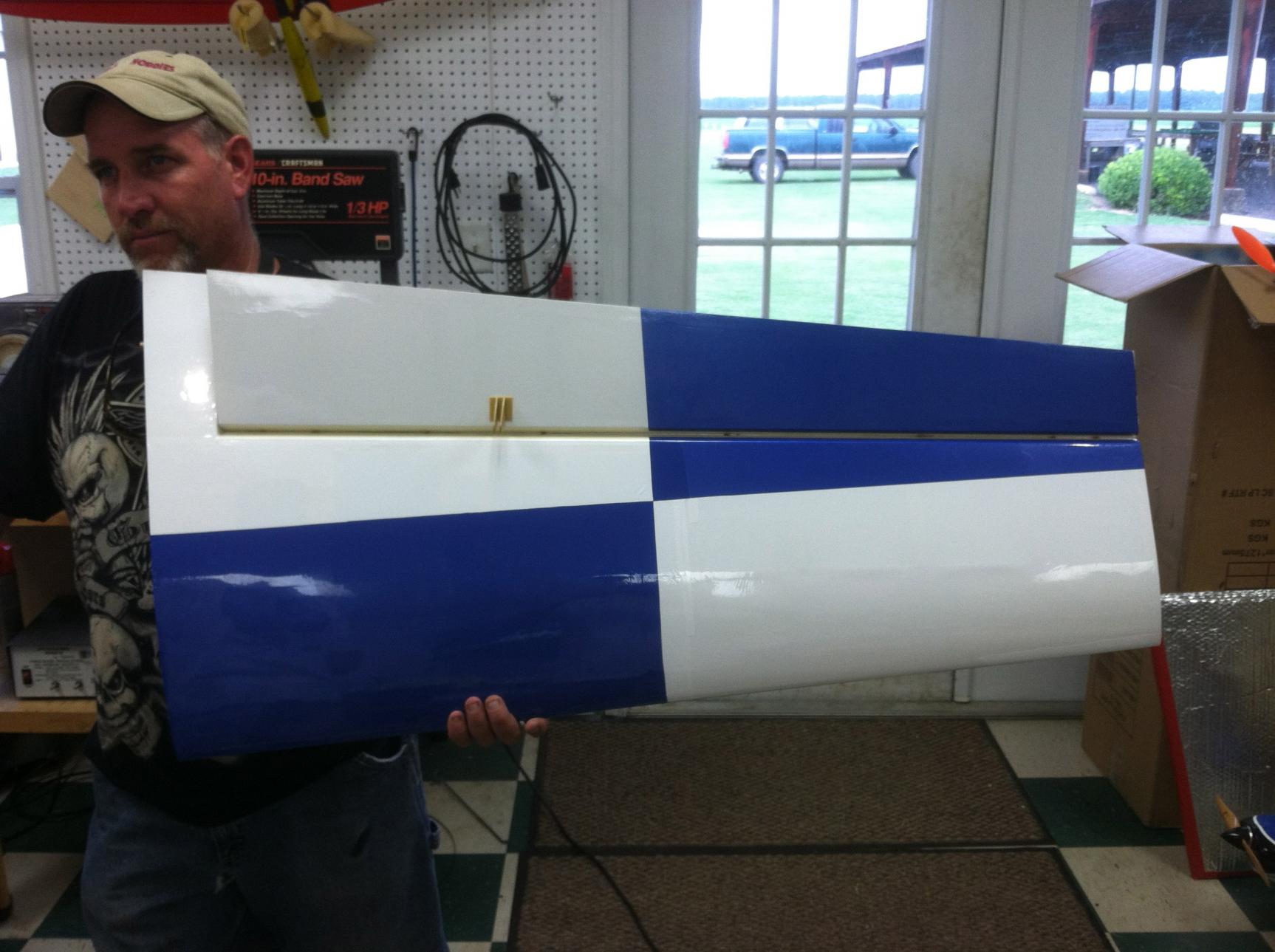

more pics.The wing ribs were a neat thing to build. I made them out of ply and used a piece of cardboard to make a template out of the very outside of the wing as to get the curve right..LOTS of sizing,fitting,then more sanding..Then more sanding..and again,more sanding loll

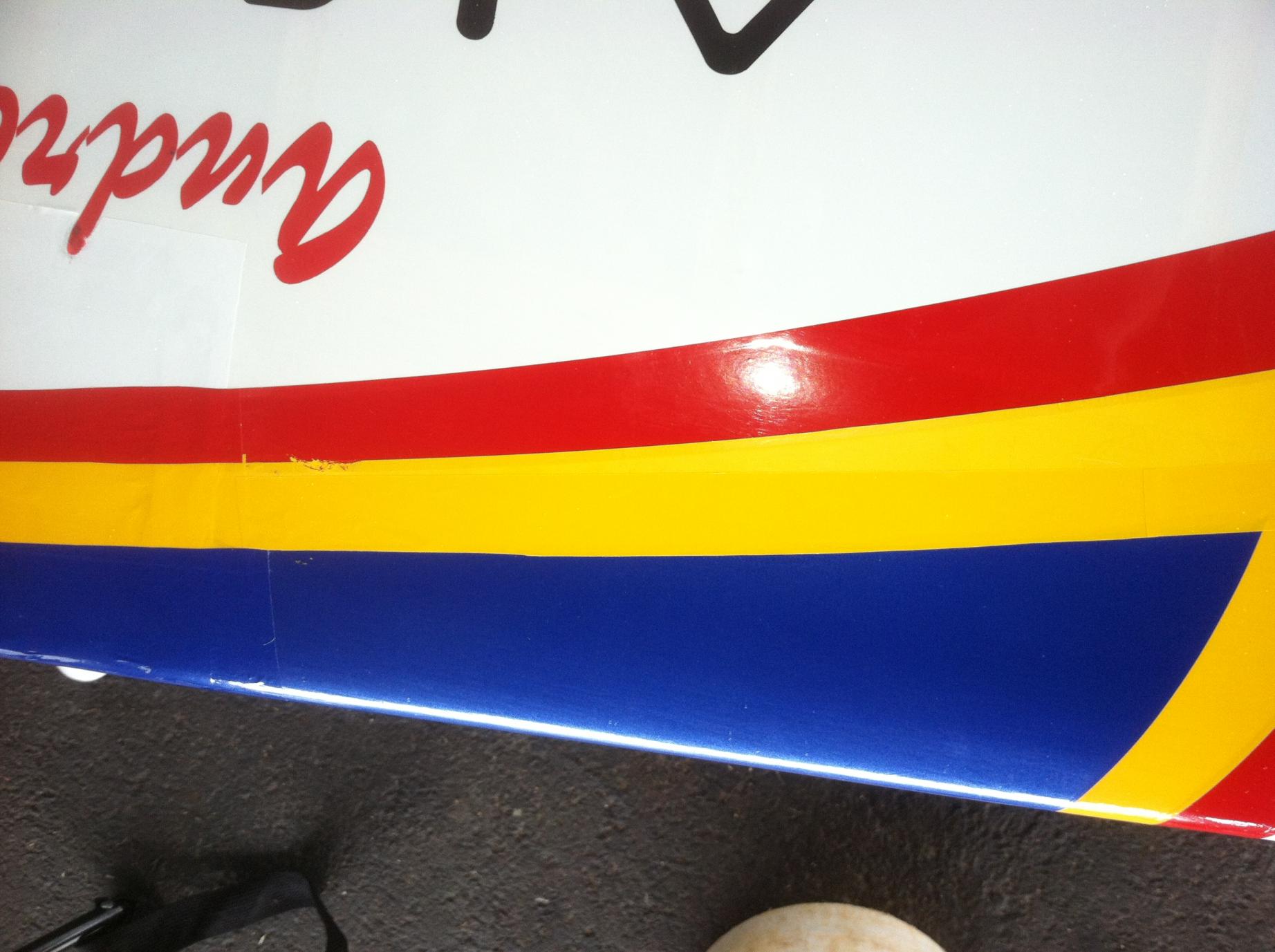

So I Didn't get pics of how i installed the sheeting.Was a neat (to me)process shown to me by Mel Scoggins. Would cut out small pieces and glue them on the underside of what was there already,to make a "shelf" or bracket so the sheeting would match up and be somewhat level..Sanding,sanding,sanding.. Then I used that hobby putty to fill in the small gaps from adding the sheeting patches.Wait=(rum and coke,repeat) for the putty to dry,then sand.;)
The "BEST" way for the covering would have been to pull all of the covering and start over I know. I couldnt afford to do that so I just made do,and learned the art of patching.
Thanks for looking! If any questions,comments,etc just drop a line. Go easy on me :)

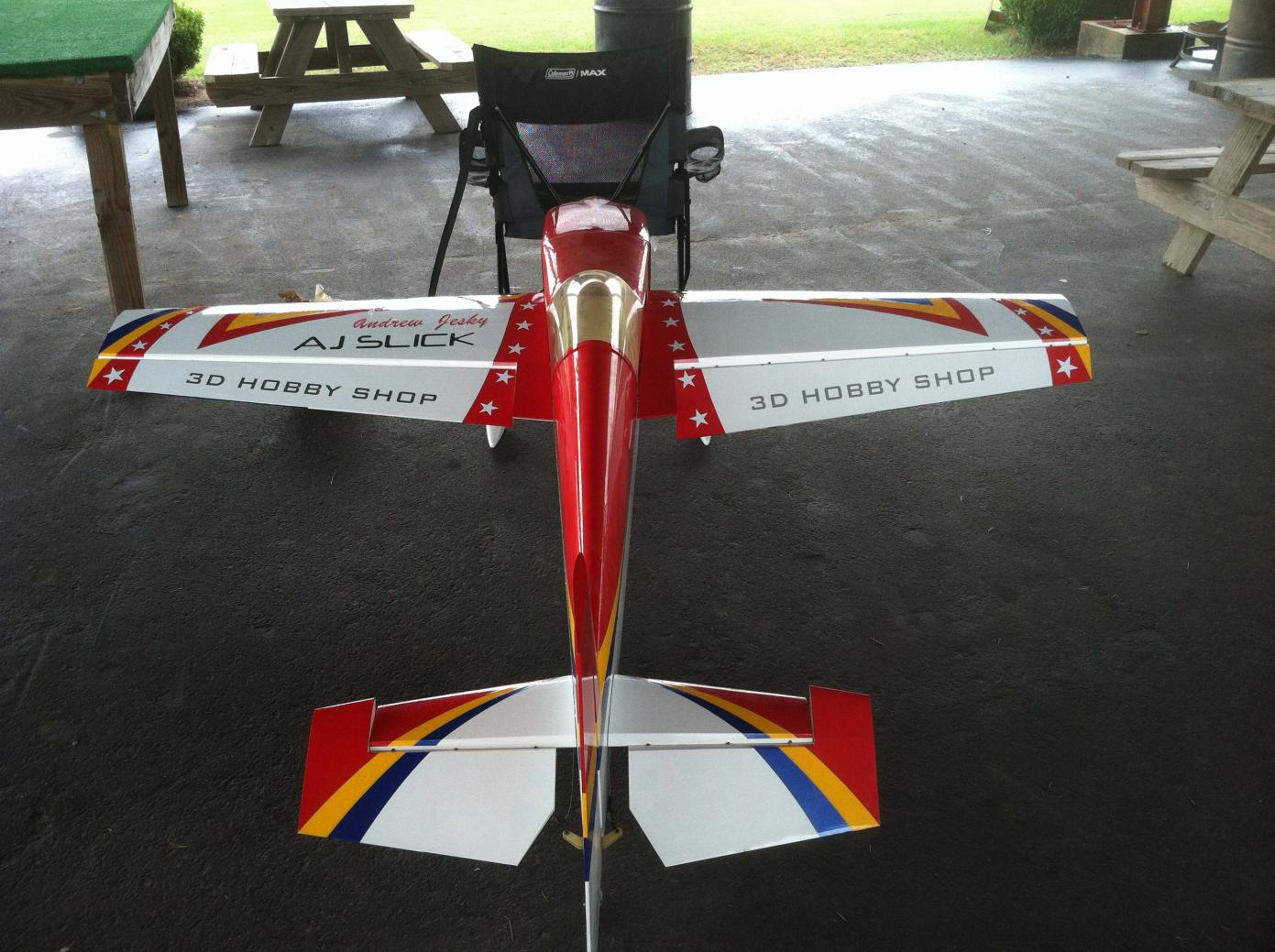

Nice job Manta.............looks really good! You'll be the only one that knows.

Thanks guys! I'm glad I done it and very glad I had lots of help..lol. Hope it holds in the air. :) Think it will.
