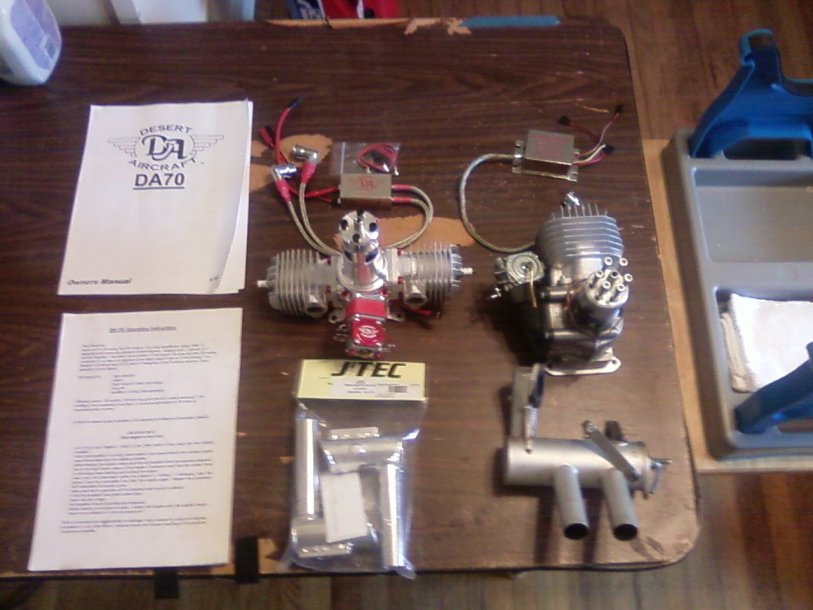

@stangflyer hooked me up with my 2015 projects (Thank you brother!) No radial's but AWSOME non the less.
