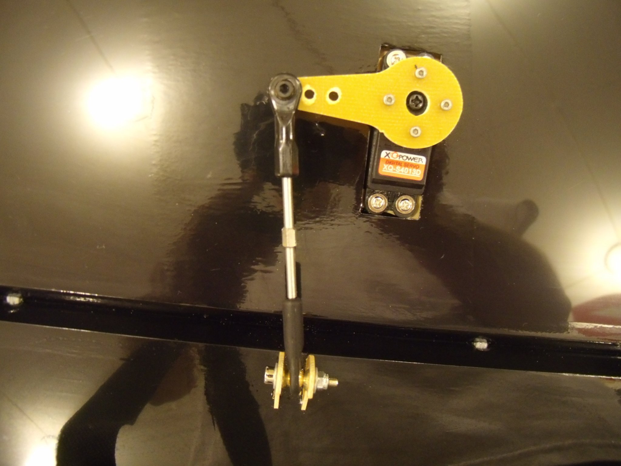

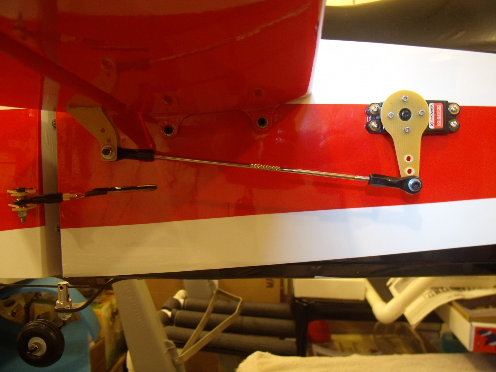

Control rod installation... I found the aileron rods to be a bit long, but they will work. Just means I have less thread to work with for adjustment. Not an issue though.

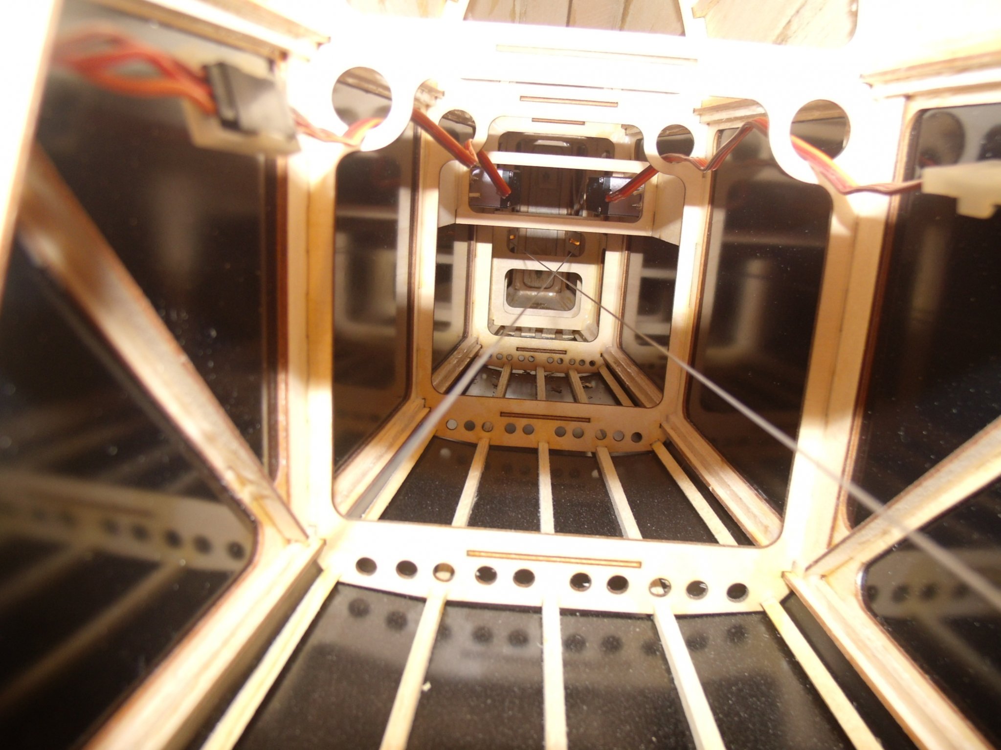

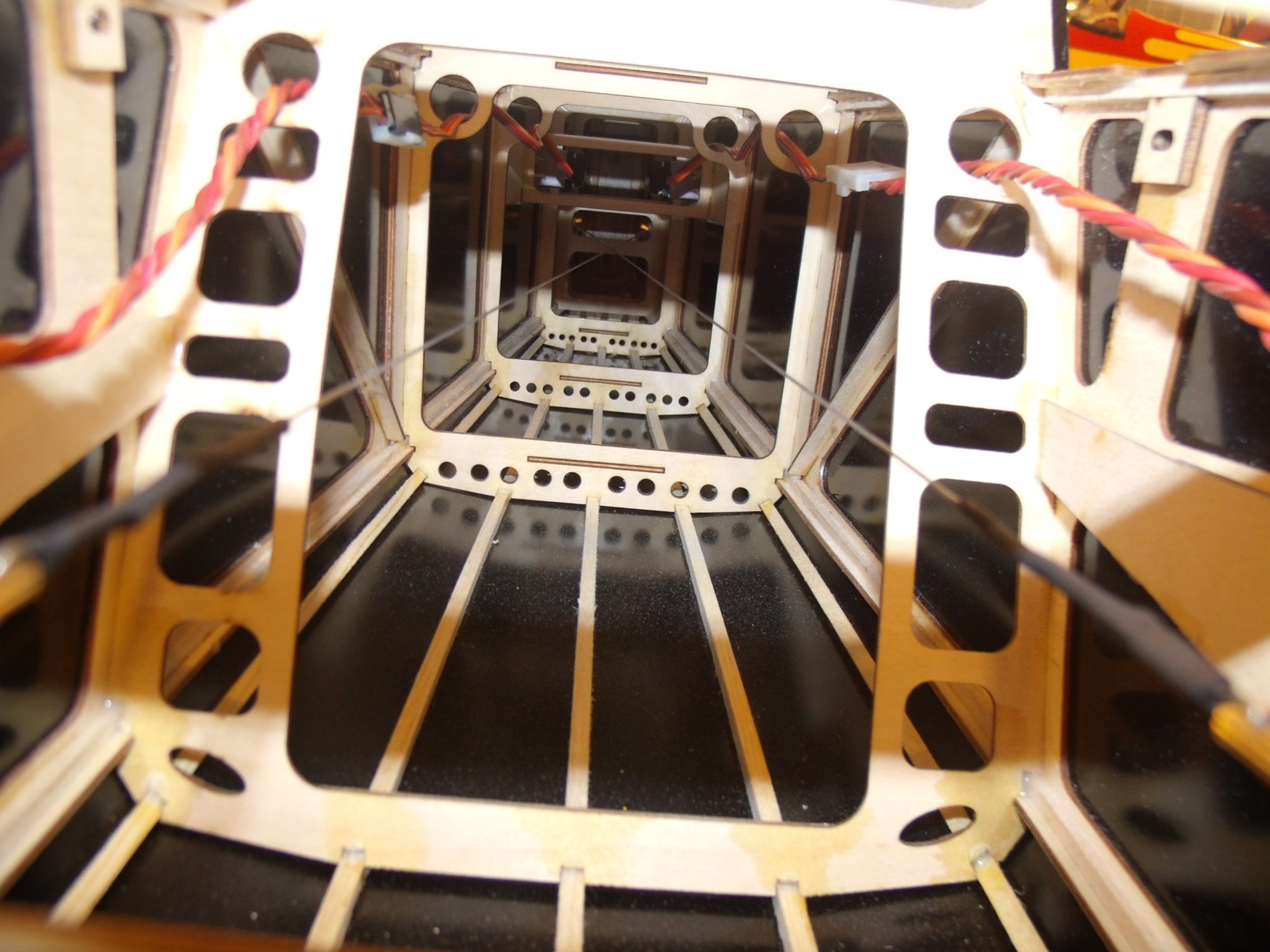

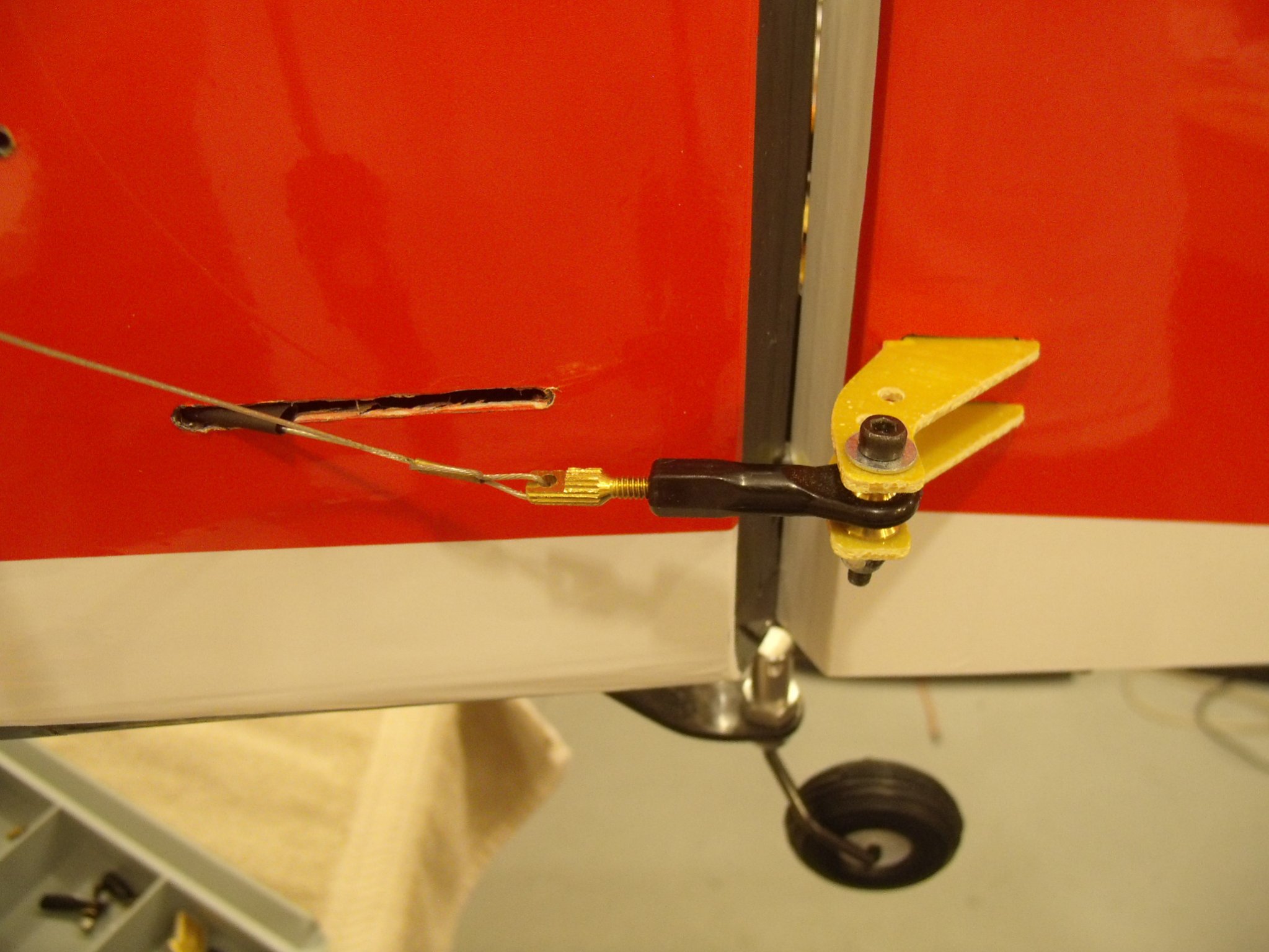

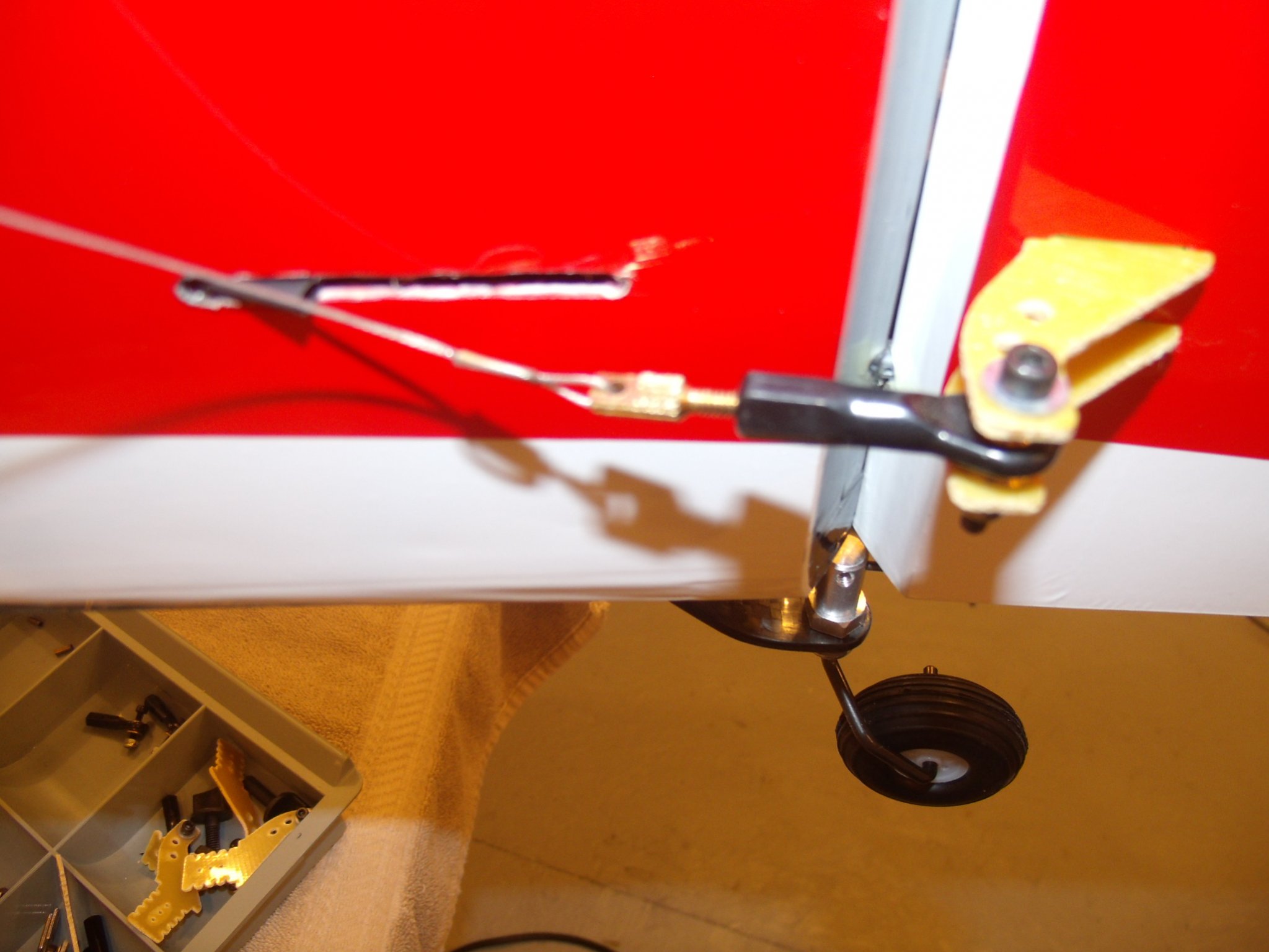

Rudder cables all installed.

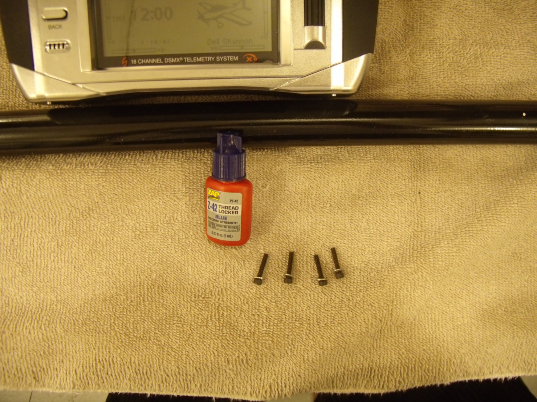

Elevator rods were perfect. I installed the stabs with some blue loctite as I will not be removing them. I have a trailer I haul my planes with, so room is not an issue at this time.

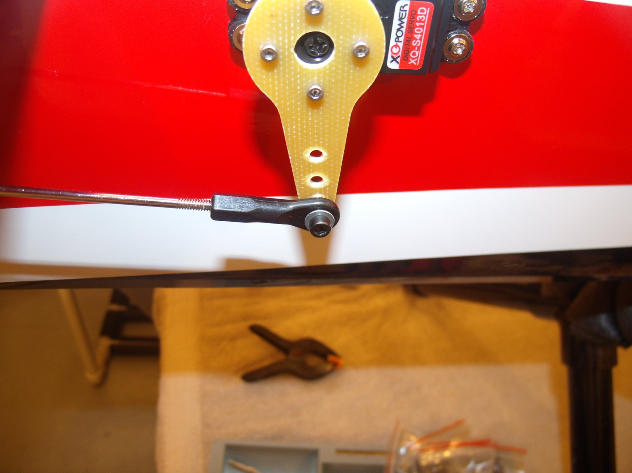

As you can see I added a #4 washer under the head of the cap screw on the servo horn, to give added security should the ball joint fail, at least there will still be some control.

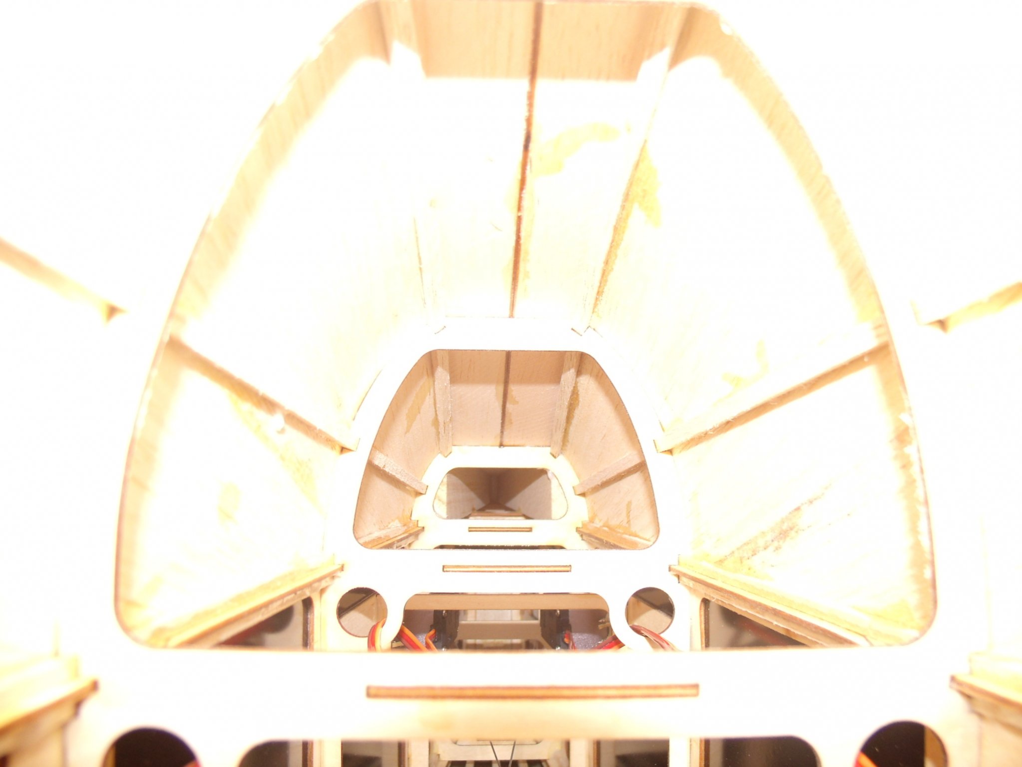

Everything is going fairly straight forward. I am taking extra pictures to let others fully see inside this beautiful bird. I can praise it enough, as I know I will be buying Aerobeez planes in the future.
