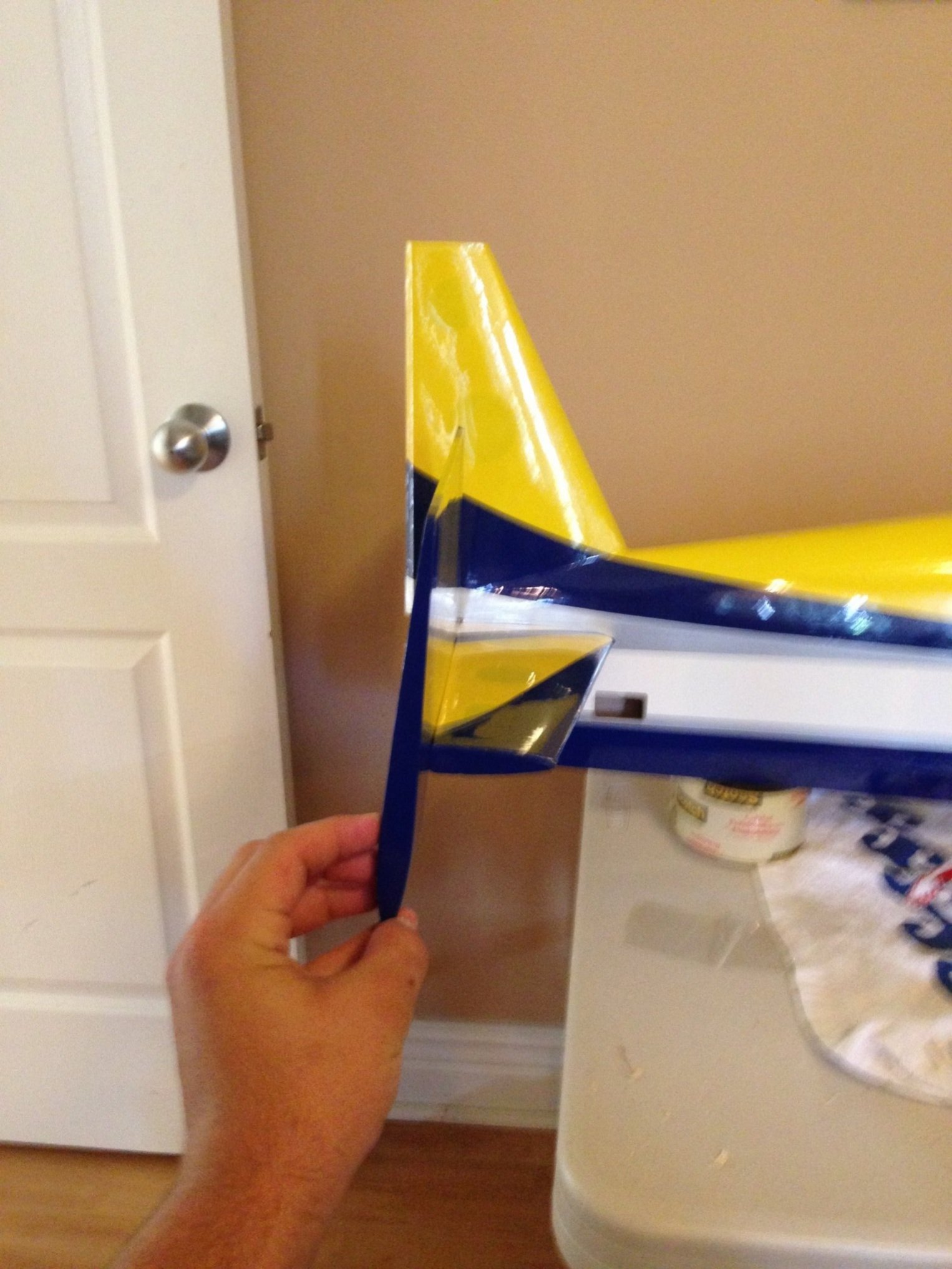

I also ran into the same issue with the elevator joiner hitting, except I had to carve a lot more wood out(1/4" on each side).

I think i need more throw :D...

I agree, it is a non issue. I actually couldn't move my elevators at all without carving it out though, I guess my preference is control surfaces that move :p
