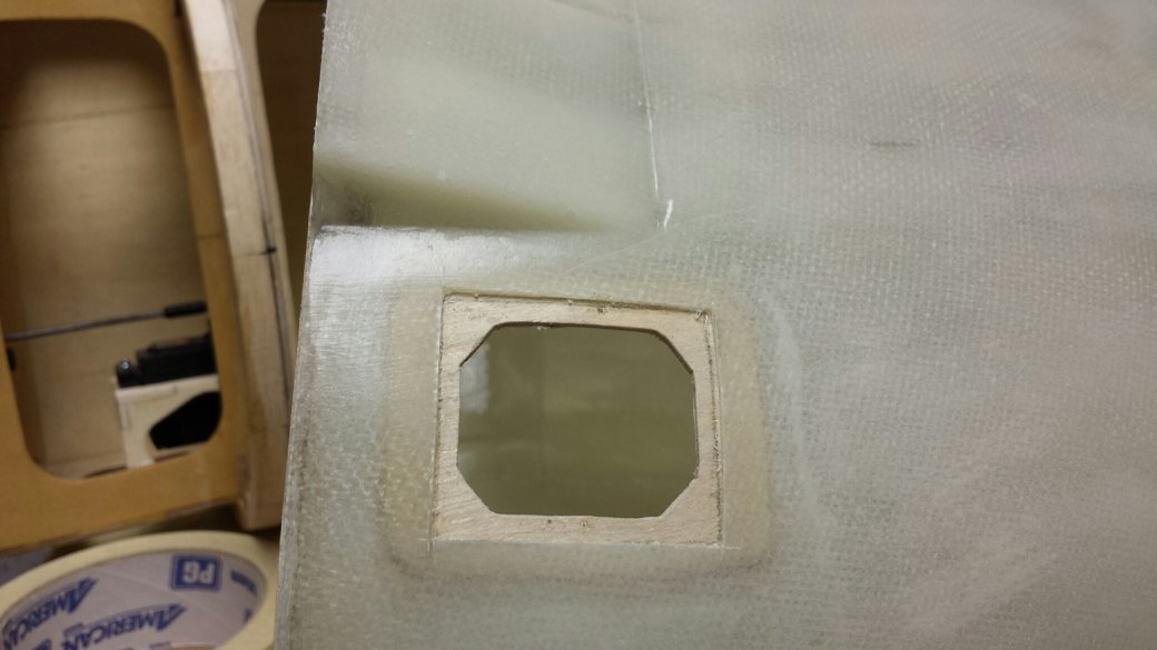

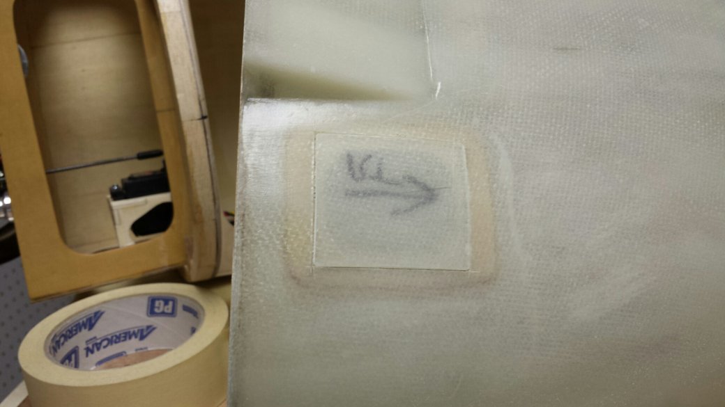

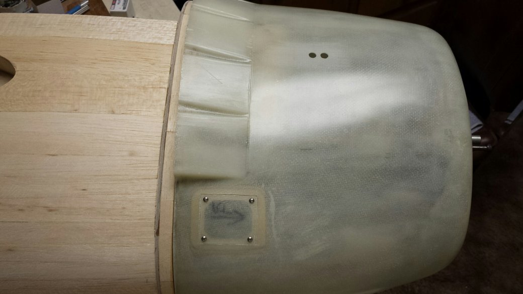

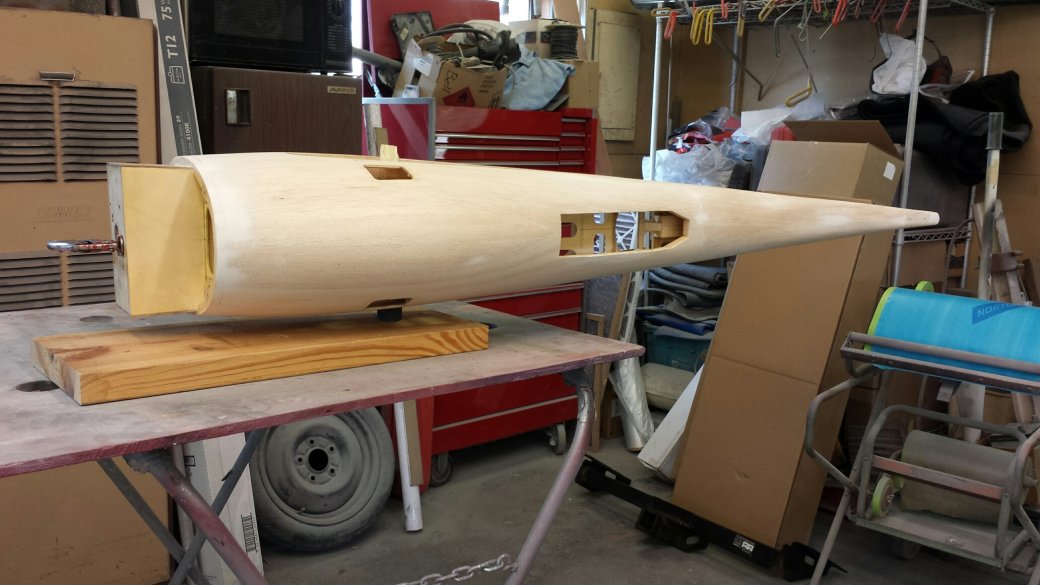

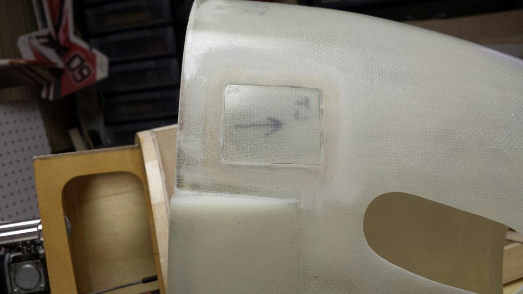

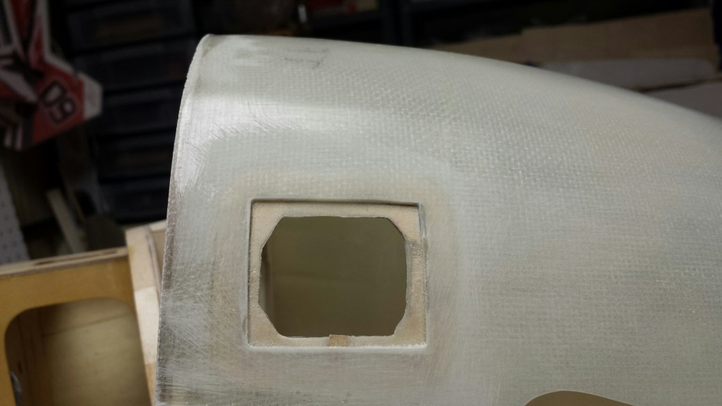

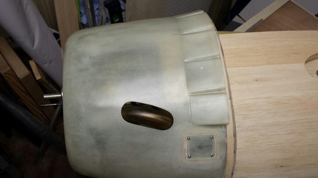

I finished the cowl bolt access hatches tonight while I was waiting for batteries to charge. I'm going flying tomorrow for the first time in a month. The hatches turned out pretty nice. I'm going to change the screws to a countersunk style once I get some. That should give it a better finished look.

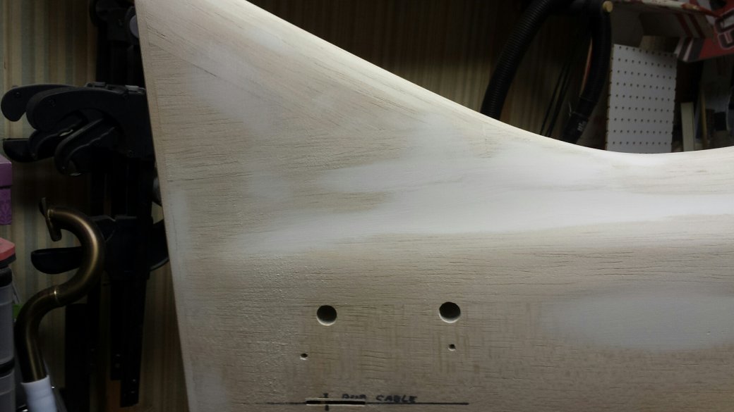

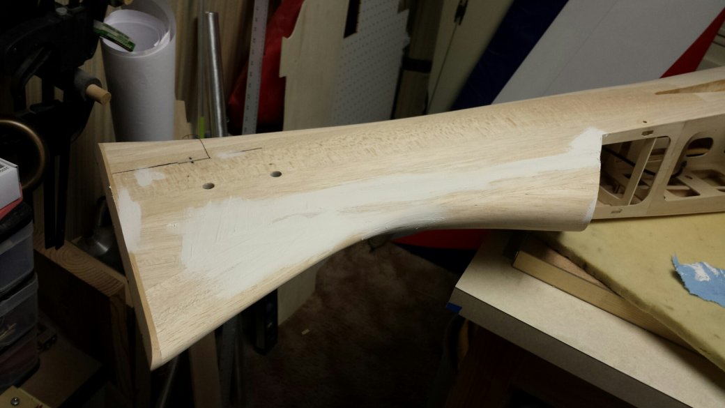

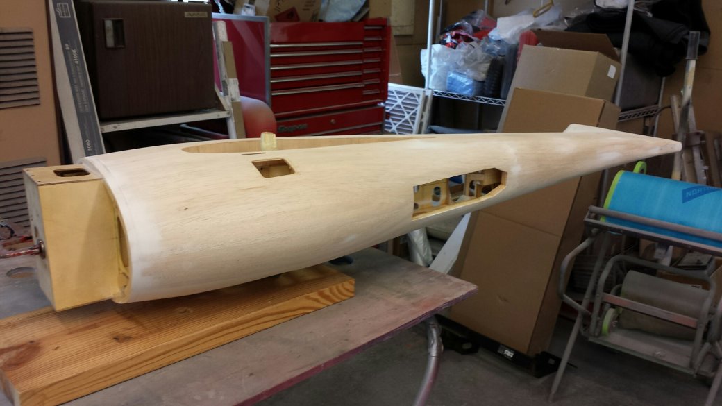

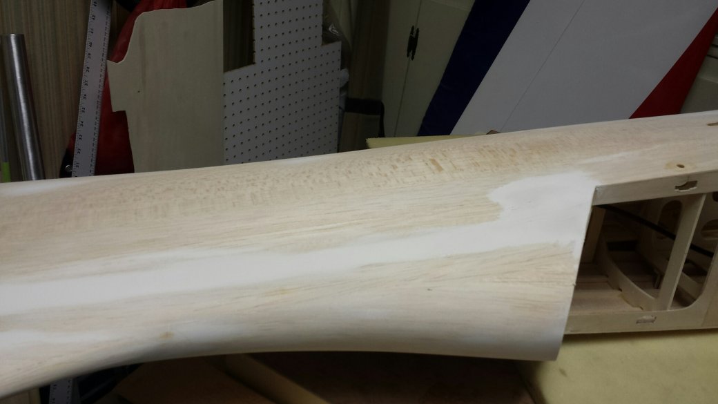

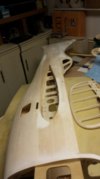

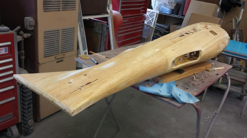

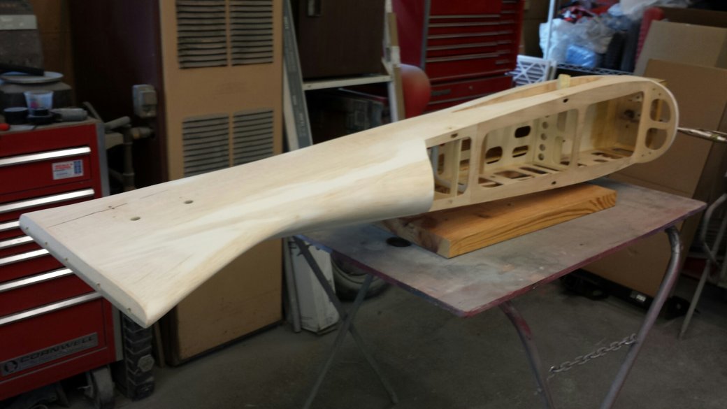

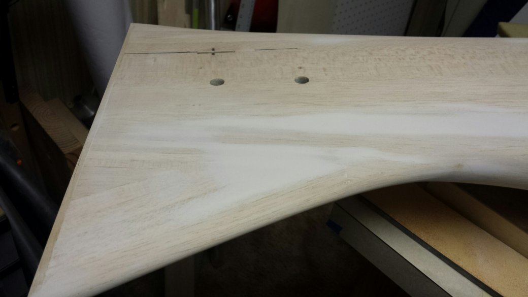

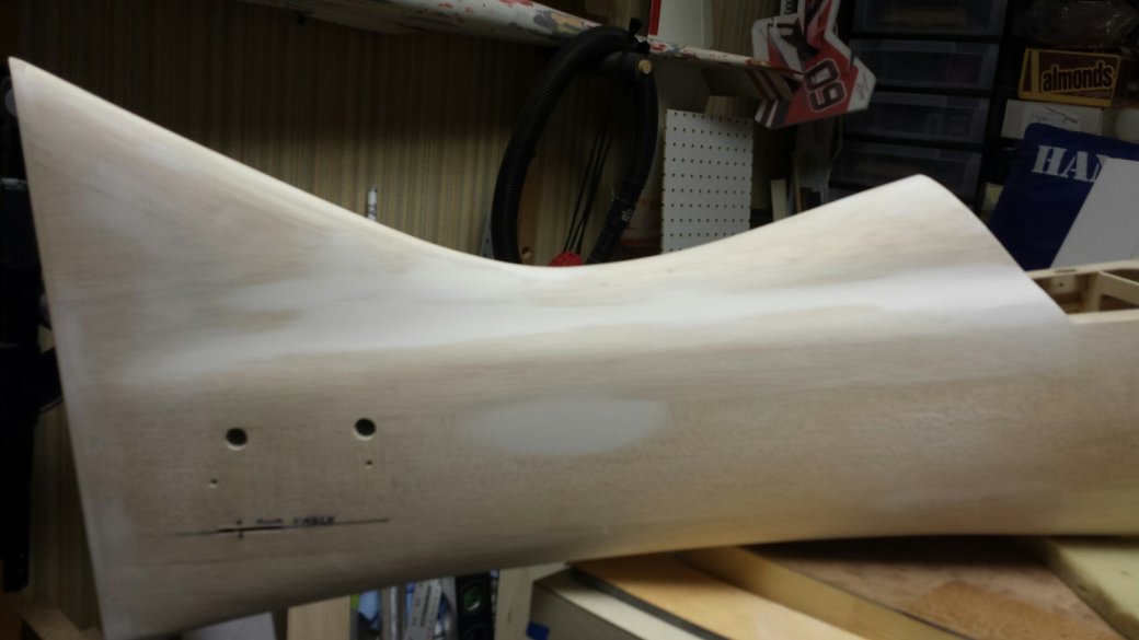

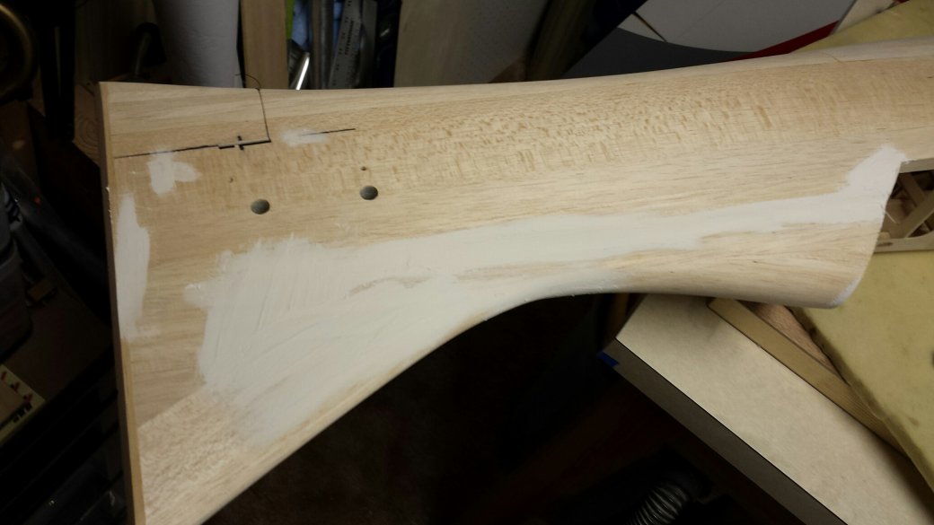

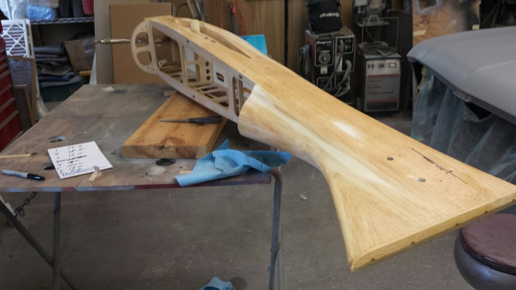

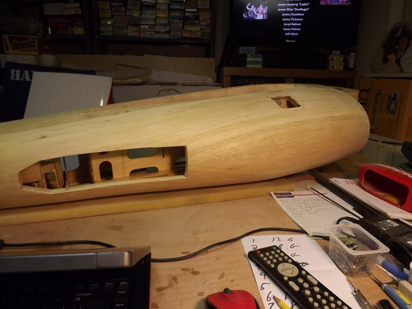

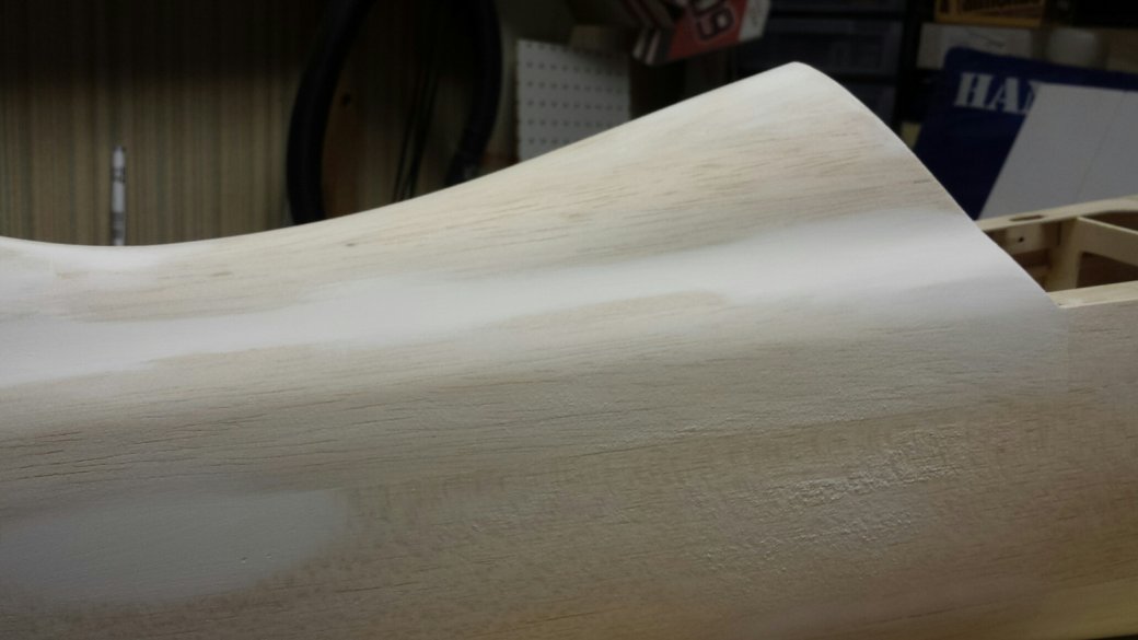

I've been doing some filling and sanding on the fuse using the lightweight drywall joint compound. I'm almost done with that so I'm hoping to glass the fuselage this weekend.
My .5 ounce fiberglass cloth came today, and I was pretty disappointed to see it was folded in a bag instead of wound on a roll like they said it would be. That is going to make the handling more difficult. I hate the creases that folding the cloth gives you. It all comes out, it's just more work.

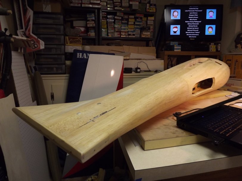

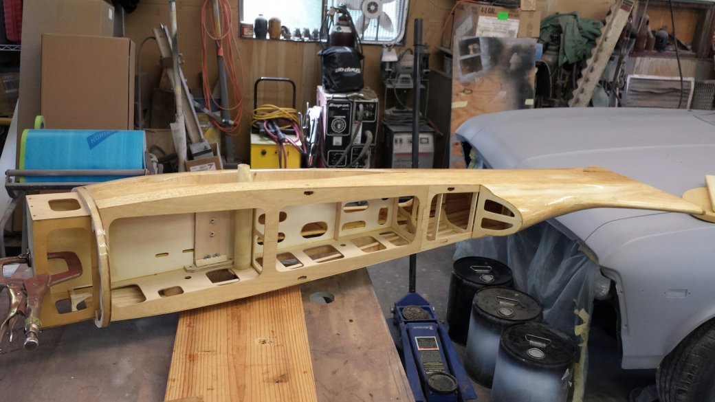

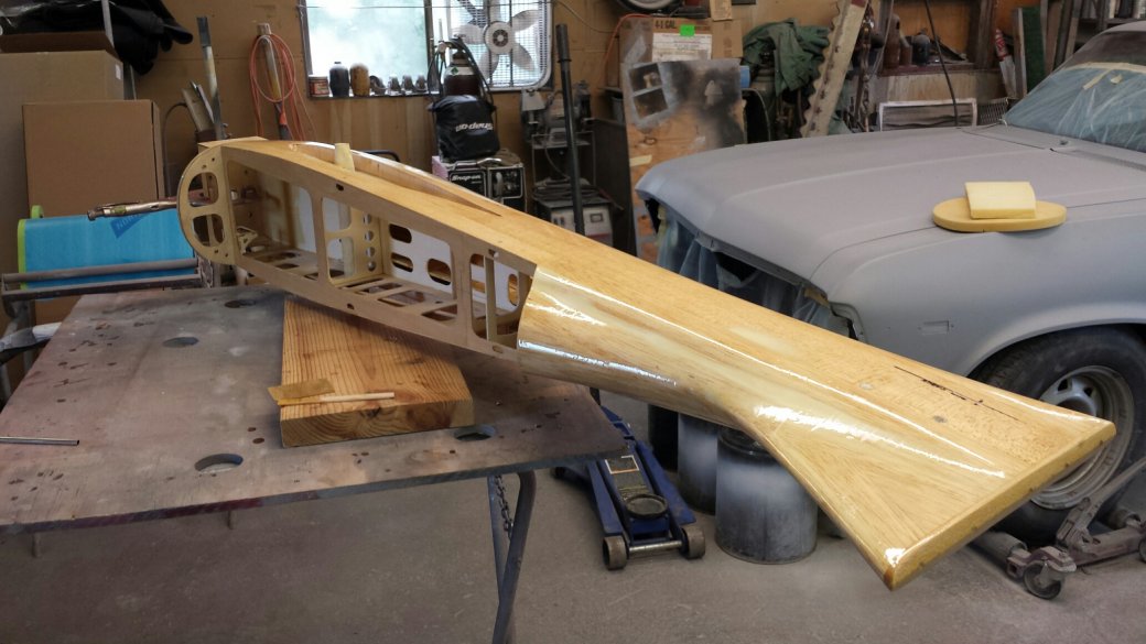

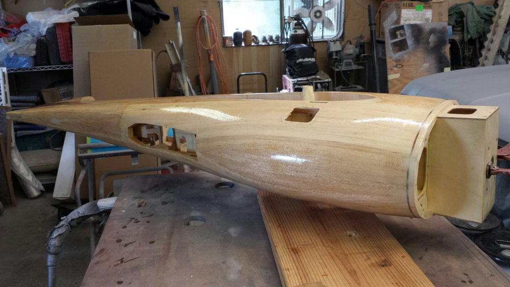

I'm planning on glassing the fuselage today. I made up a stand that goes through the wing tube hole and keeps the sides off the table, plus I can spin it around to work on it. When I need to flip it I just grab the engine box and the wing tube socket and I can flip it without touching the glassed area.
