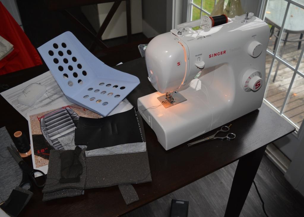

getting aquainted with the world of sewing, the basics is not all that hard , buuuuuuuuuutttttttttttttttttt, now to make things look right, will be a steep learning curve.

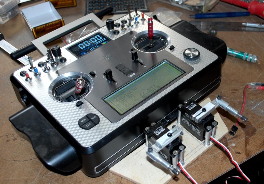

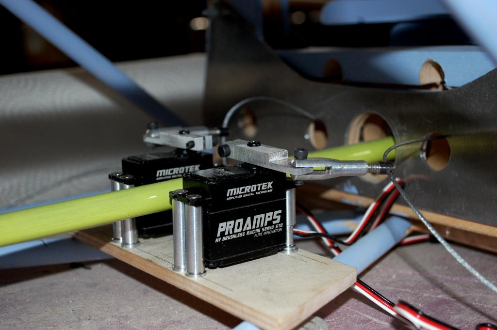

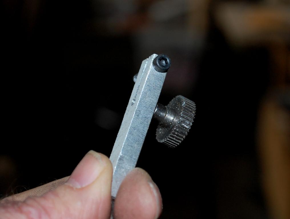

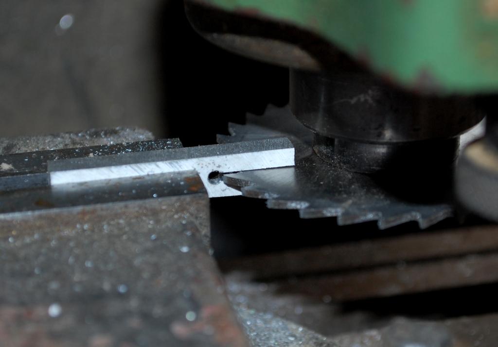

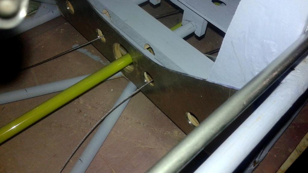

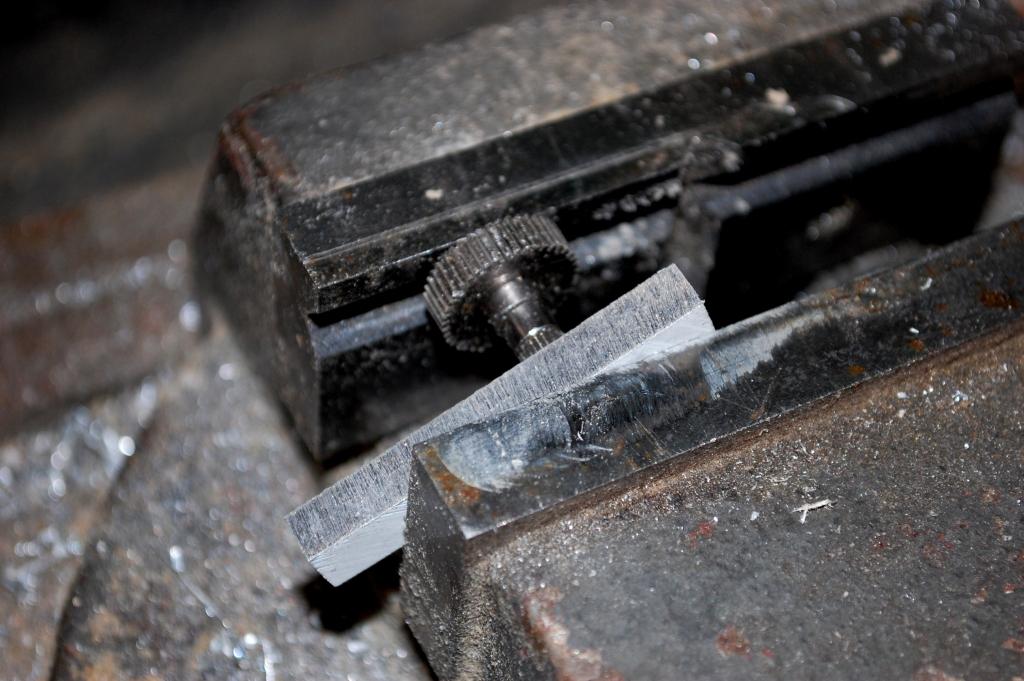

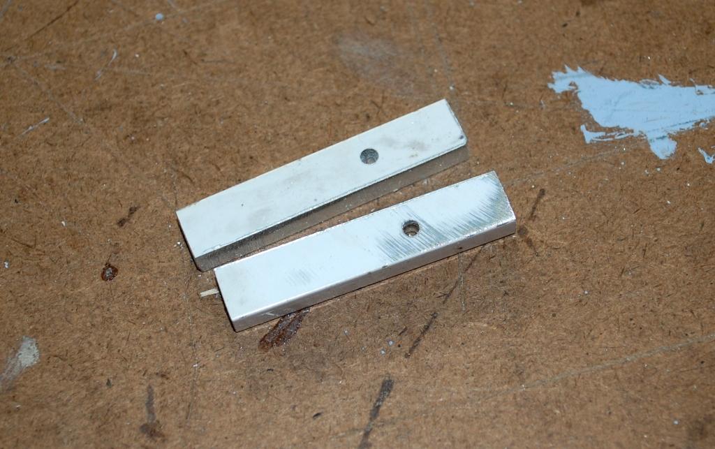

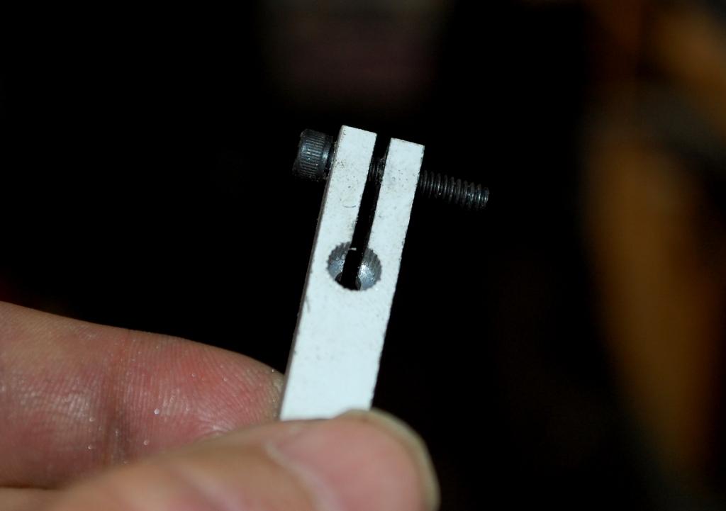

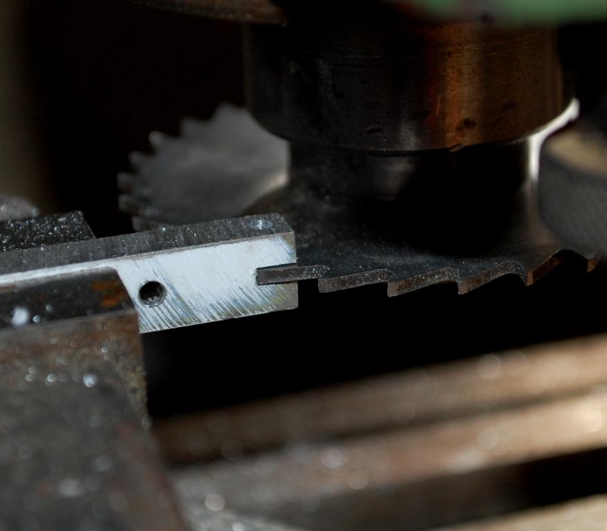

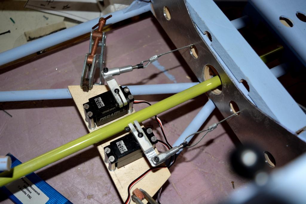

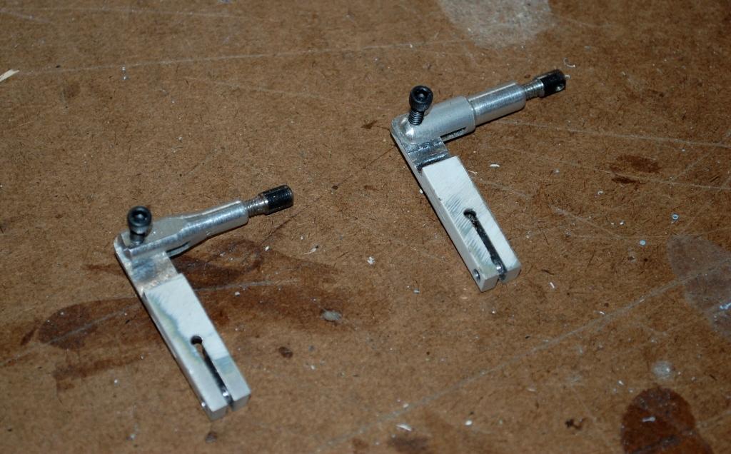

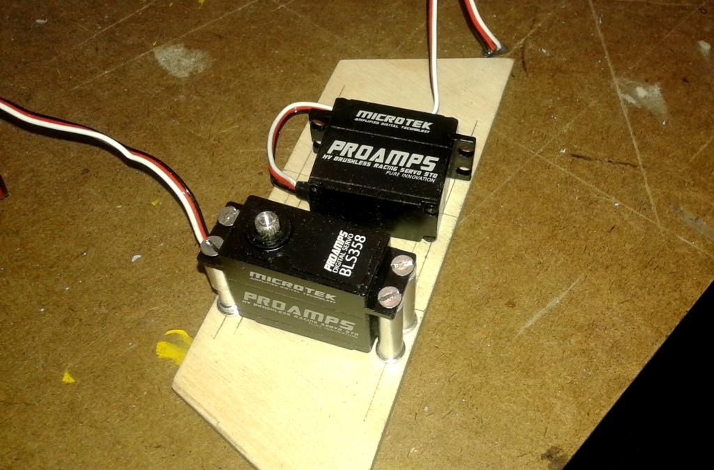

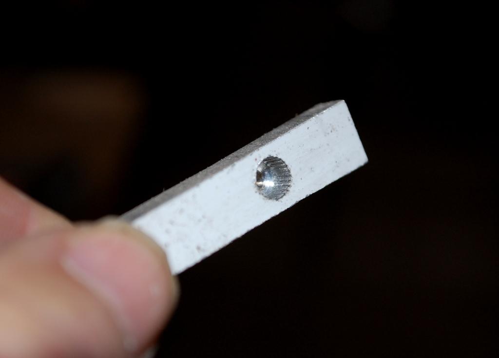

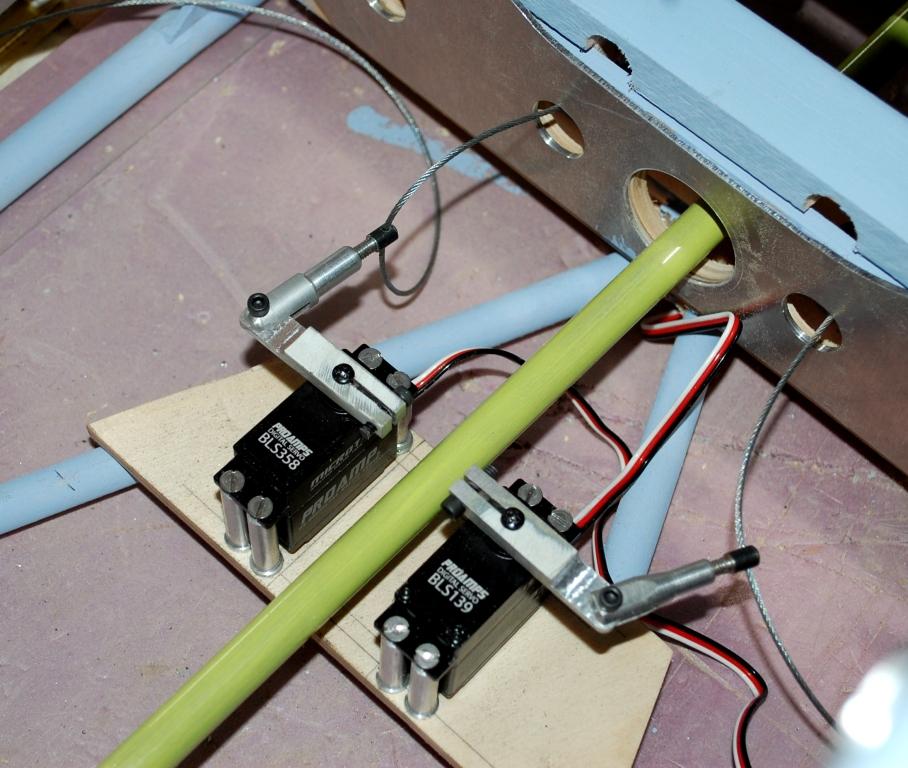

today working on the twin Pro Amp servos for the rudder, these each have 70 kg of torque

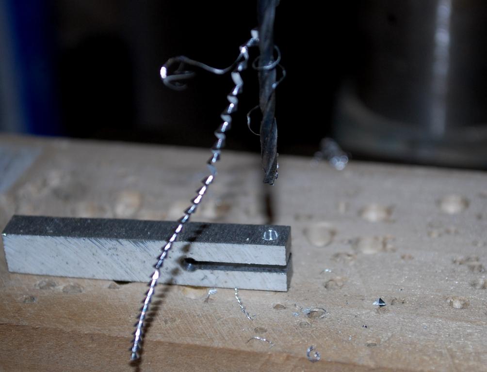

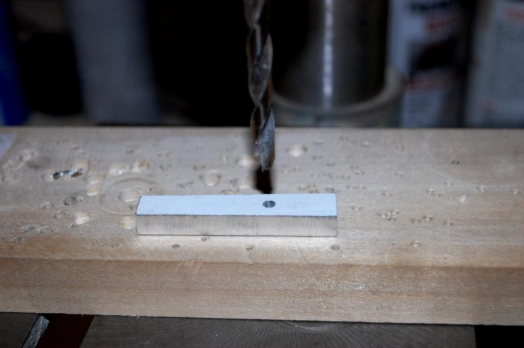

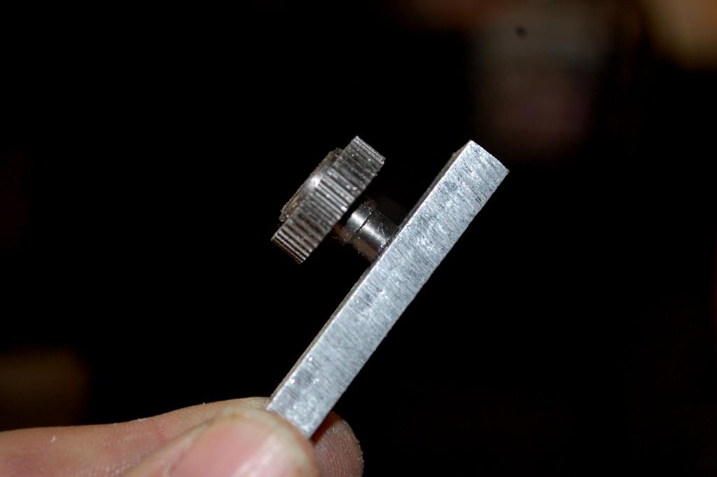

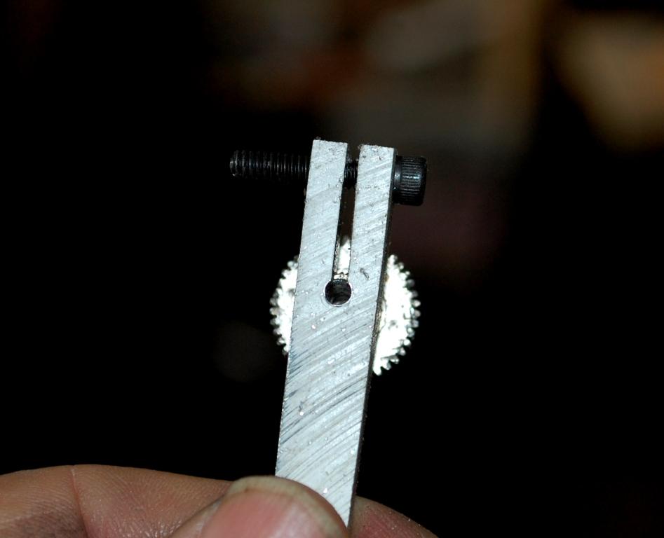

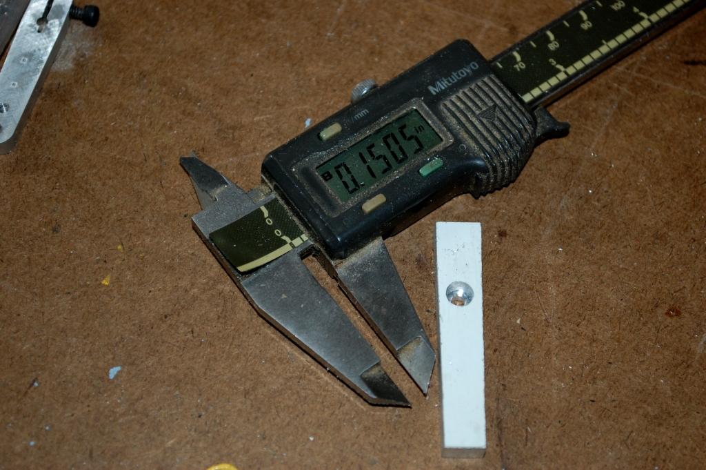

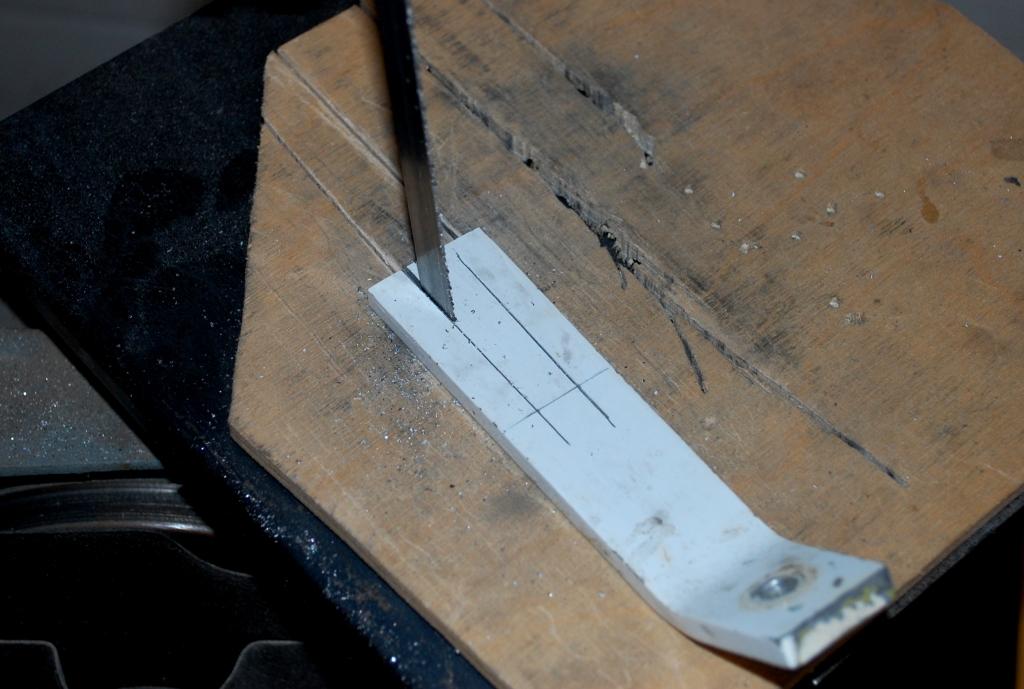

custom making servo arms and clevis, you will also note on one of the pictures the two servos are not the same number, my mistake , this will have to be changed

HRRC Flyer
Mounting the servos side by side....one driving each cable seems like you lose the combined power of both servos if ganged together in the common fore & aft arrangement???
Hey Earl,
I thought the same thing, but on the other hand, I don't know how many ounce/inches are in a 70 kilogram servo.
