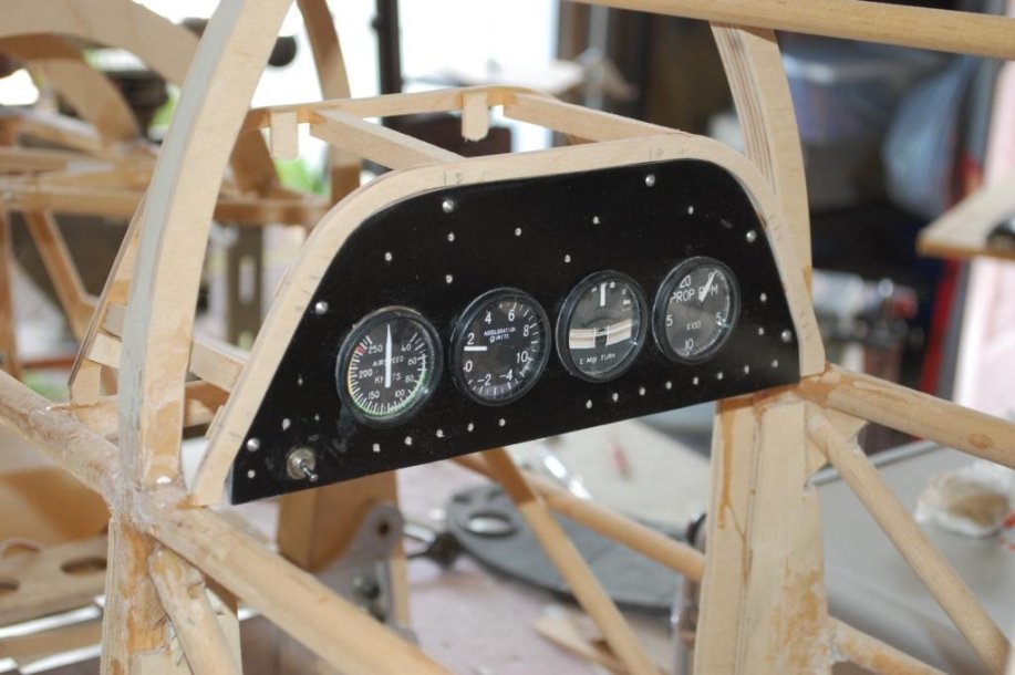

while waiting for some glue to dry, I started toying with the rear instrument panel I still need to find French instruments since this is a French airplane

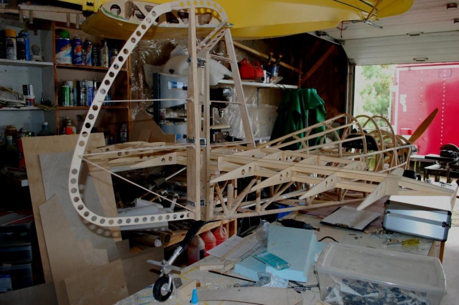

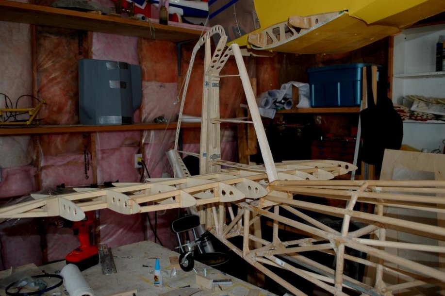

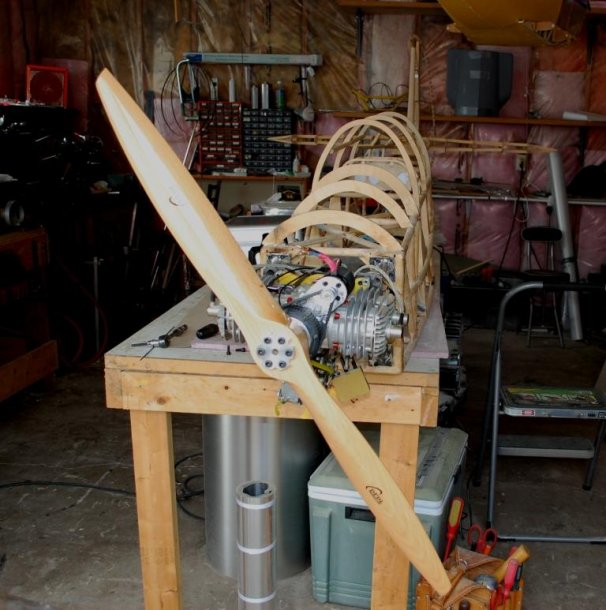

fitted the 38 X 18 propeller, might have to go to a smaller one, and mounted partially the stab, but still need to make the front of the stab adjustable , since I need a stab incidence of about 1.5 degrees positive, but not sure exactly how much.
