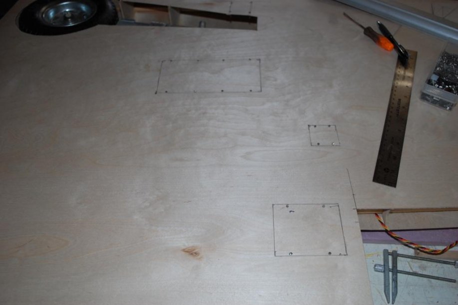

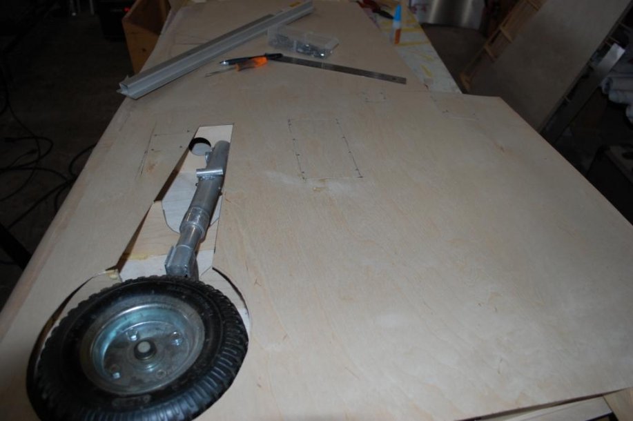

hatches are done still the gear half door to go

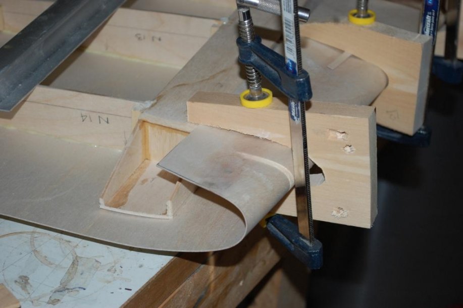

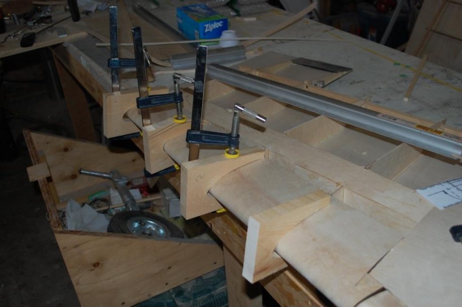

very tight radius towards the wing tip so I made these and they seem to hold, while the glue sets over night

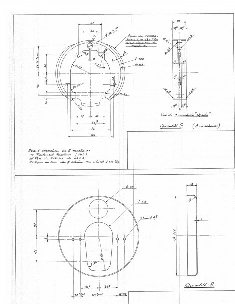

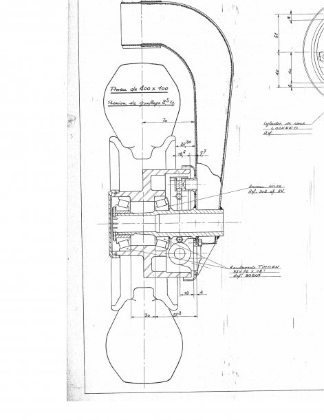

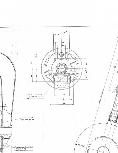

and while the glue sets, I have been analyzing the brakes drawings to see how I will go about it, looks very doable
