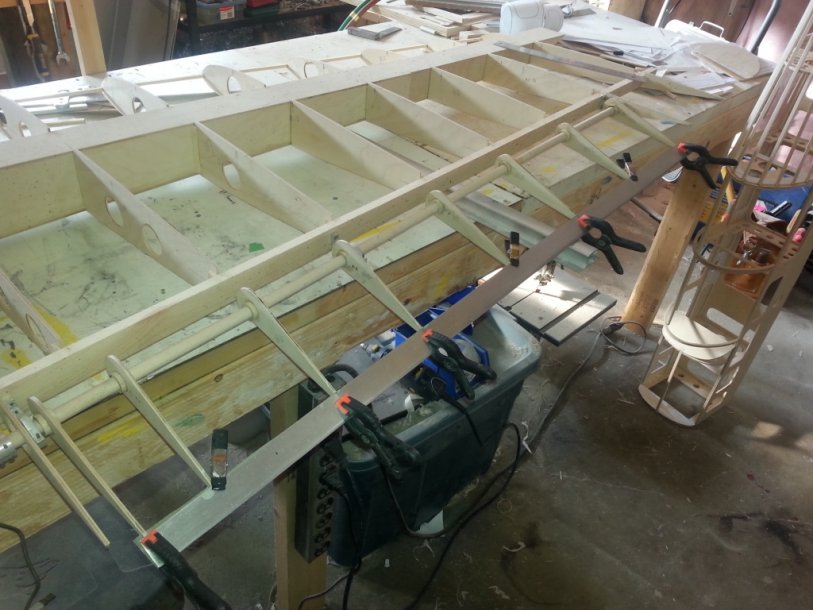

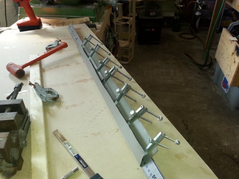

working on aluminum trailing edge,
Please bare with me for being late in new postings, I have been concentrating more on the junior Dalotel because this one must fly at the beginning of the season, it is my practice airplane , also waiting on plywood sheeting material for the wings,
