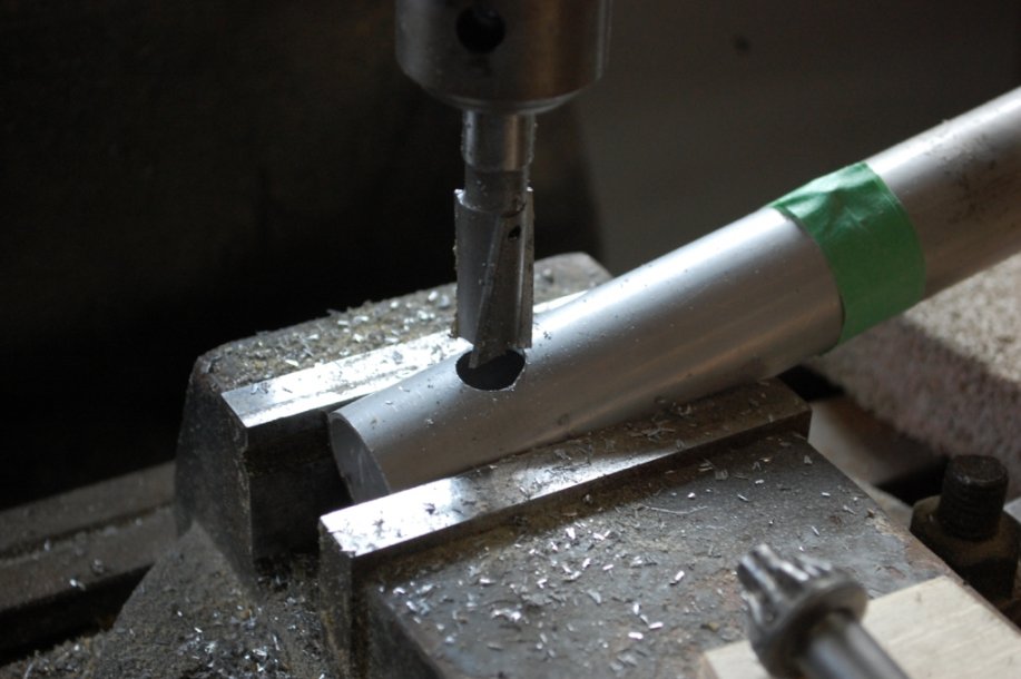

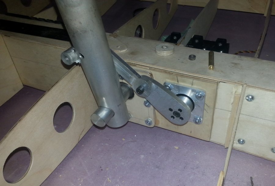

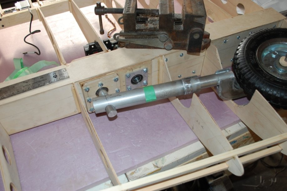

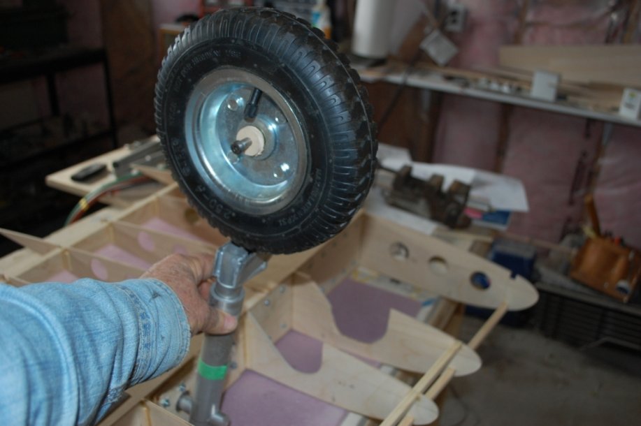

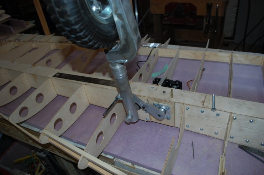

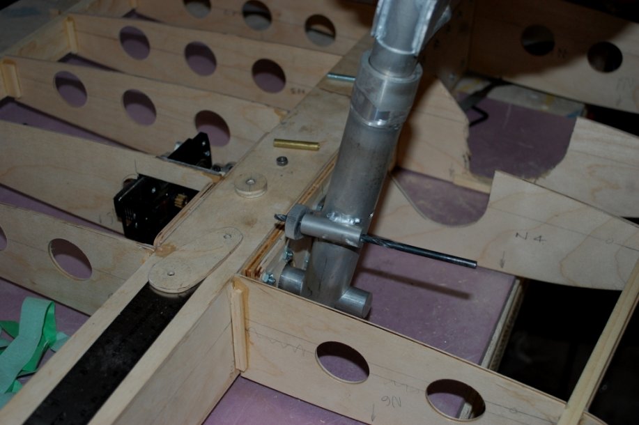

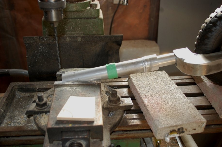

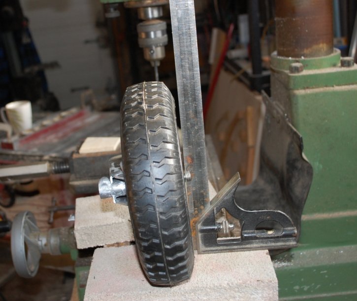

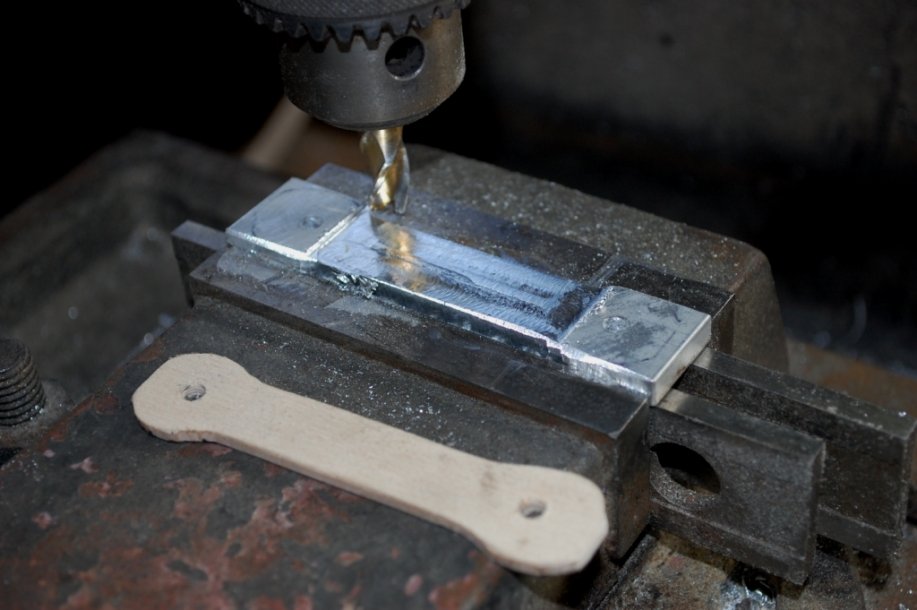

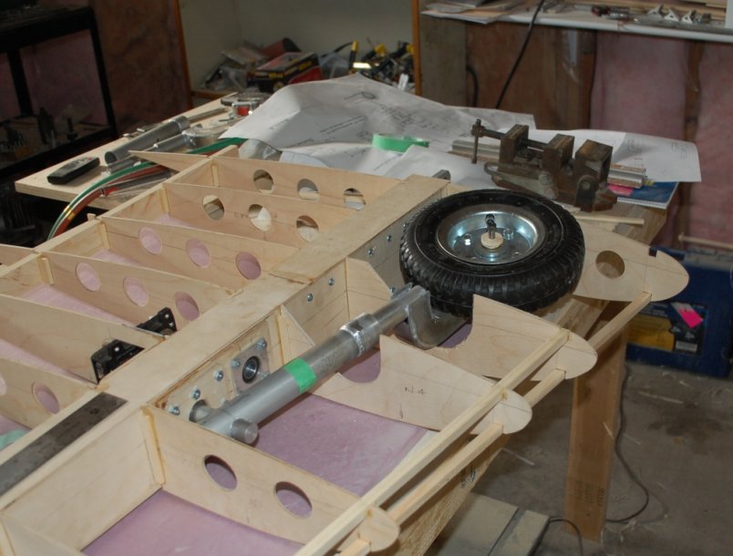

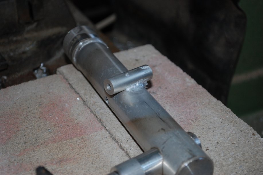

a bit more work done on the landing gear, measure 10 times before cutting LOL
You will notice with the wheel, its not at 90 degrees, this is because I needed to make sure I had a bit of toe in when the wheels were retracted.

Wow....It finally dawned on me how big this plane is going to be. The sixth picture of you holding the gear with your hand is a clear indication this is no tinker toy airplane. Once again I must restrain myself from gassin' up my truck to make the little jaunt to your shop just so I can behold the massiveness of this awesome plane. Lovin' it!
