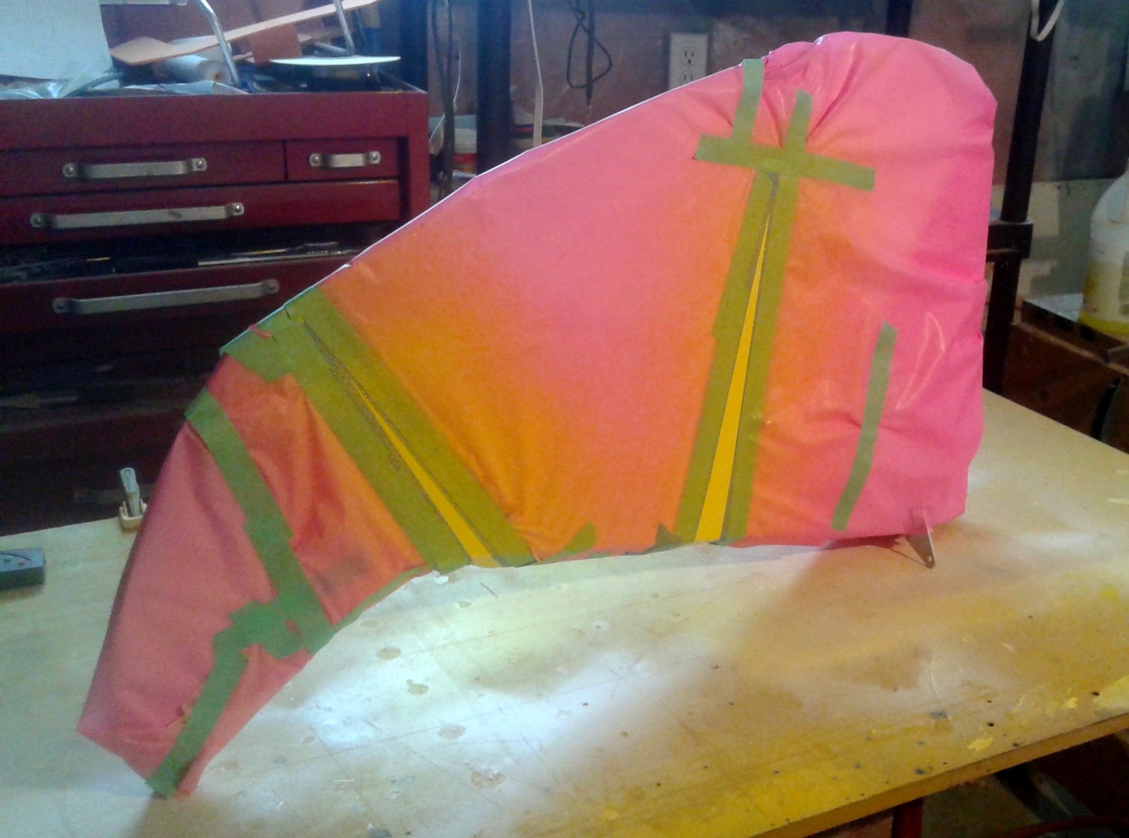

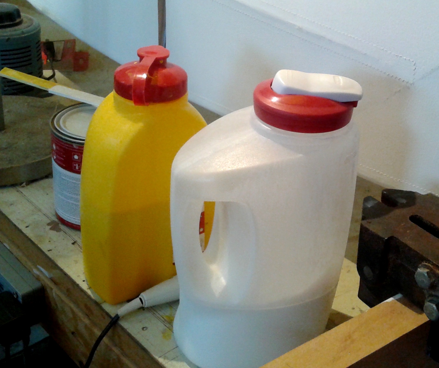

Since I will spray paint the Dalotel I wanted to do it with Latex paint , so today did a test piece, with the gloss latex paint mixed with windshield washer fluid, first mixing is easy , just put a bit at a time and see how clear it gets, . I am sold on it, no toxic fumes, no spray fumes at all
I used an equivalent to Floetrol, here in Canada. and seems to be working great, So I have spray painted the elevators, now to dry. At first look , I am very pleased.

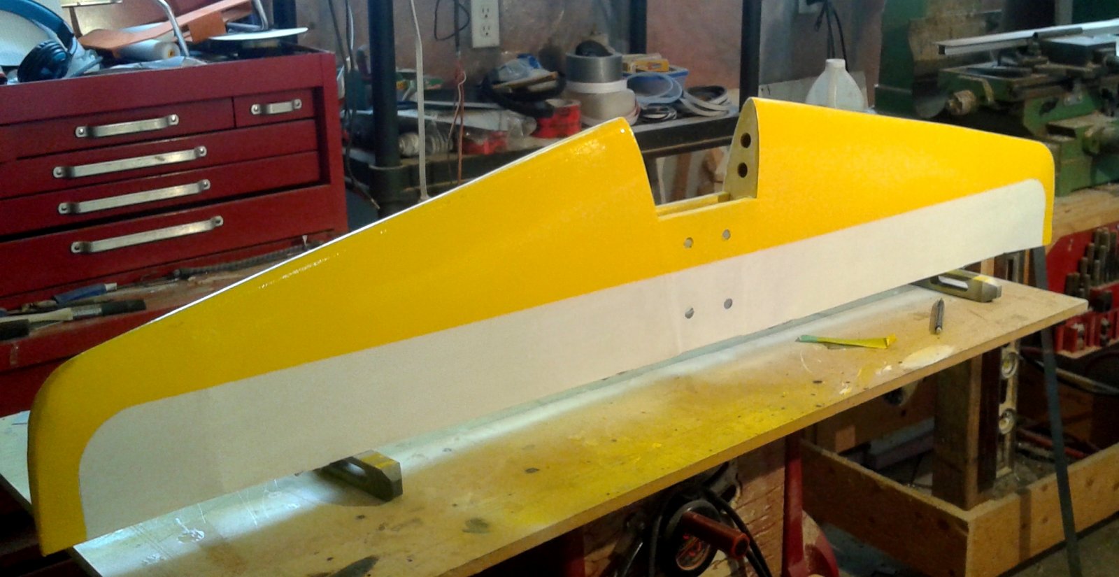

I don't know, I followed the guidance that recommended using it. I used gloss paint and able to buff to a shine like enamel paint.
added the yellow on top of the stab. much better this time around
