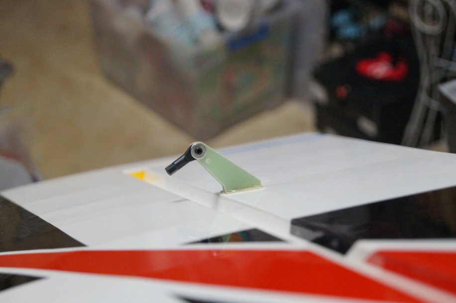

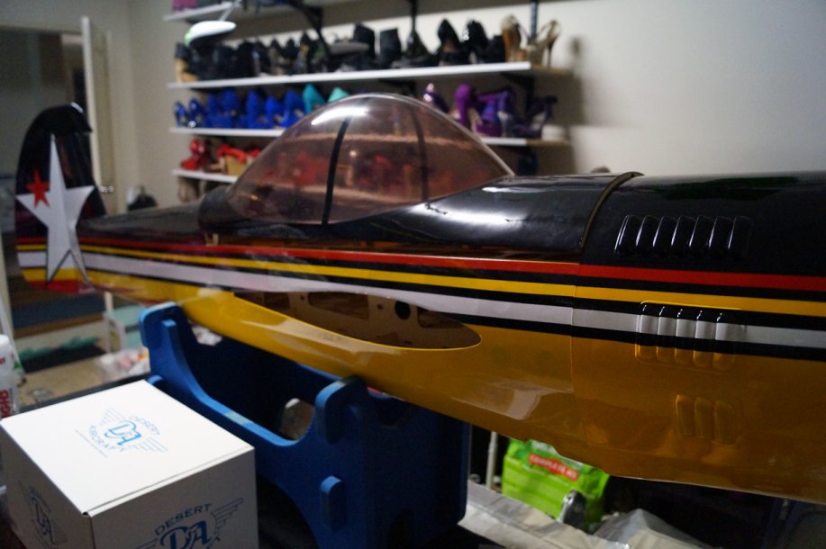

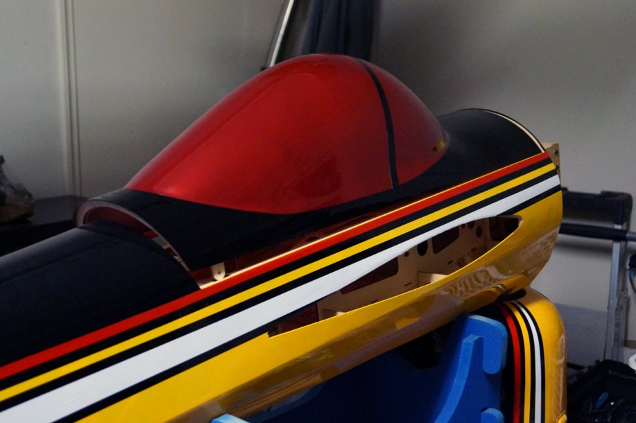

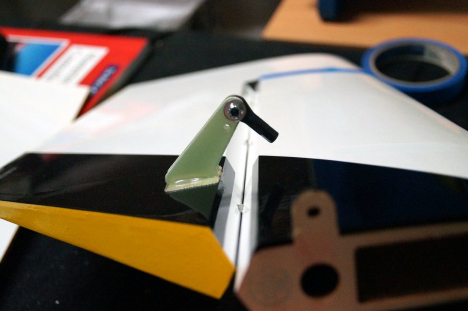

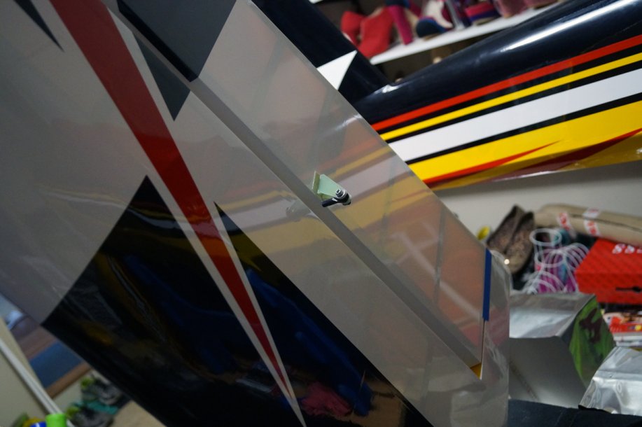

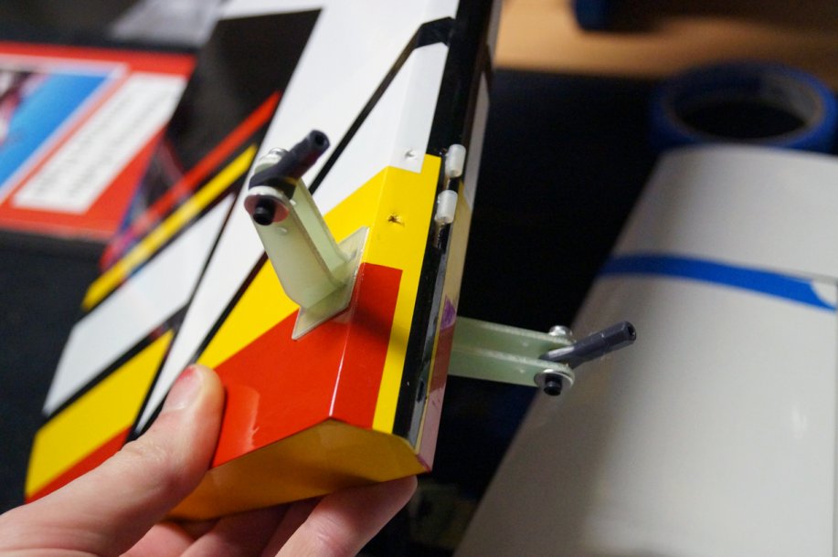

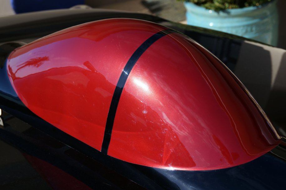

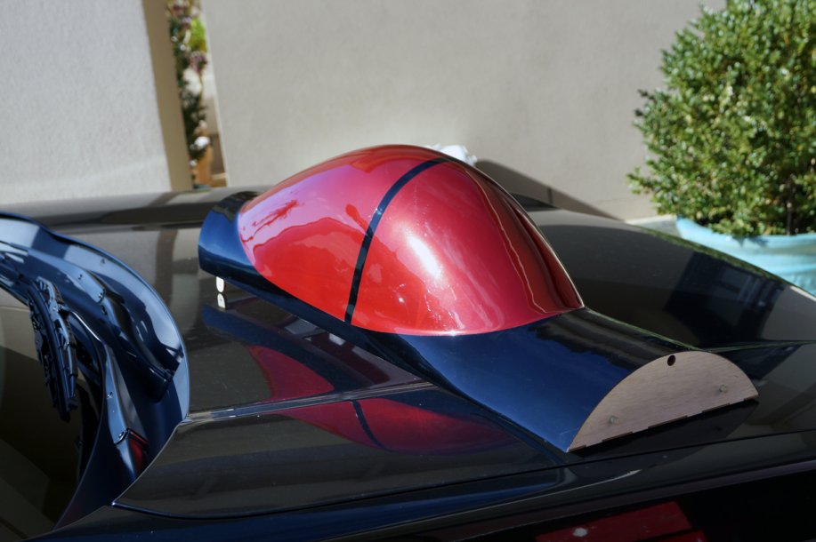

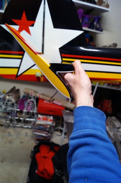

Did some more work on it today, Took some photos of the completed horns, they all went in super smooth and came out great, I also finished off my canopy today and took some shots in the sun while it was out, it came out better than expected, next time though I'm going to order some reverse vinyls so i can spray my pilot name directly into the canopy

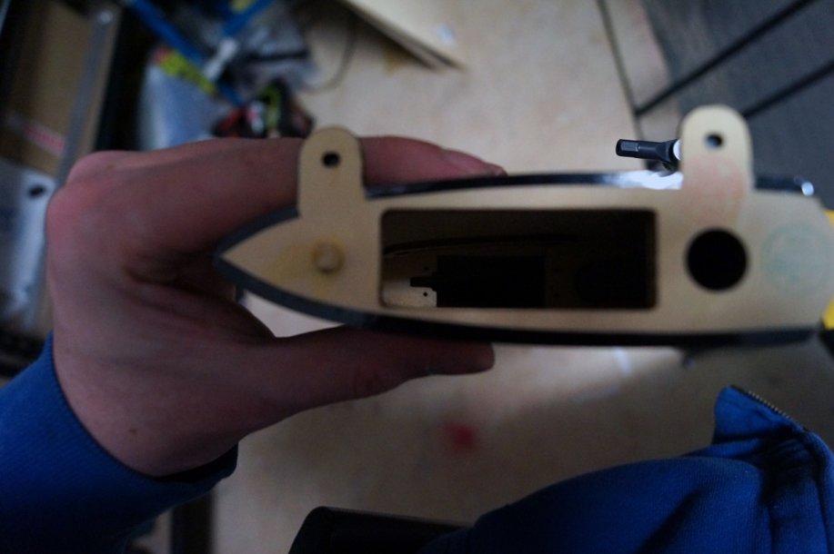

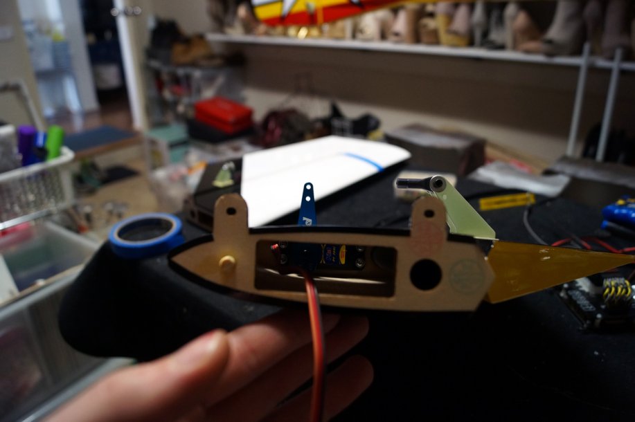

Worked on the servos for the elevator today, damn those slots are far back, I needed to do a minute bit of filling to get the Pilotrc servos to slot in and I also pushed out the wire hole a tad so it wasn't so squashed up in there, once they were in I dropped a few drops of thin ca around the edges of the screws just for comfort and to ensure they don't back out
Overall elevator servo setup was pretty simple, nothing too hard

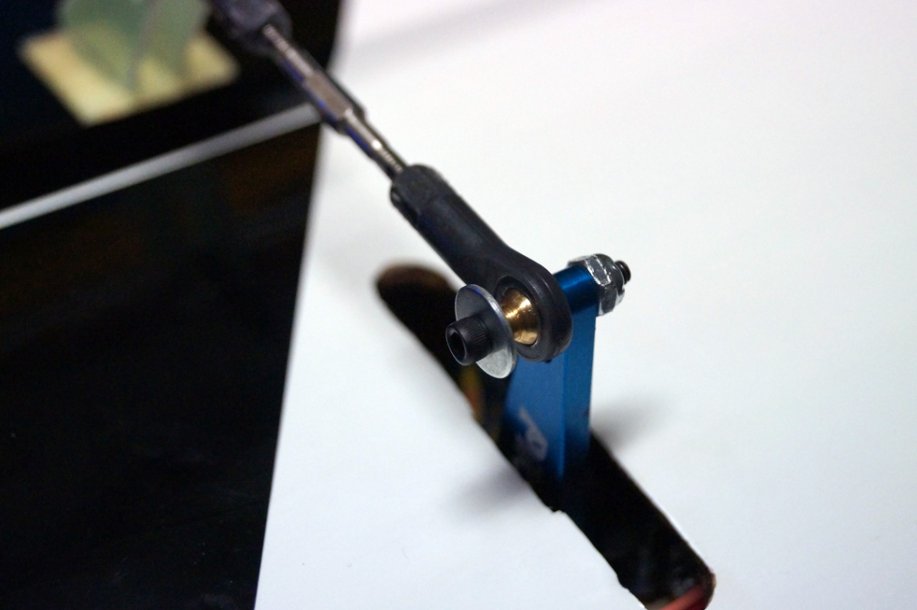

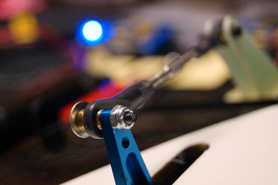

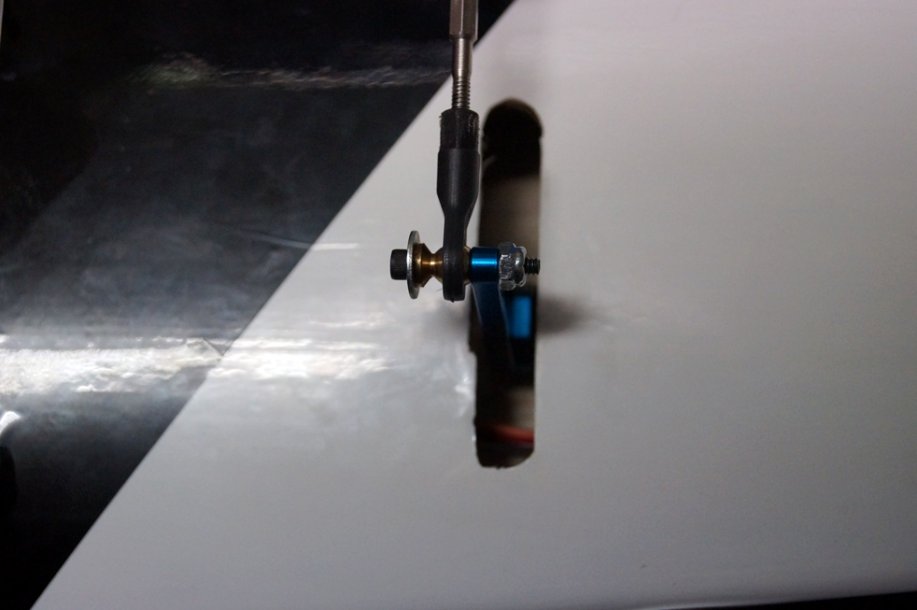

Had some spare time today between family stuff so i decided to finish one of the elevator halves to see how the setup would go, I ended up with this, its not your standard setup, servo side is essentially reversed but with the loctited thread inside the metal arm and the washer in place as well as a lock washer I don't think its coming off, I did this as the geometry was all wrong when connected the normal way, too much angle for my OCD to cope with, this way its a very nice angle, almost 90deg.
with the pilot arms and maximum throws without binding i get a good amount of travel, not crazy but looks plenty for this aircraft.
