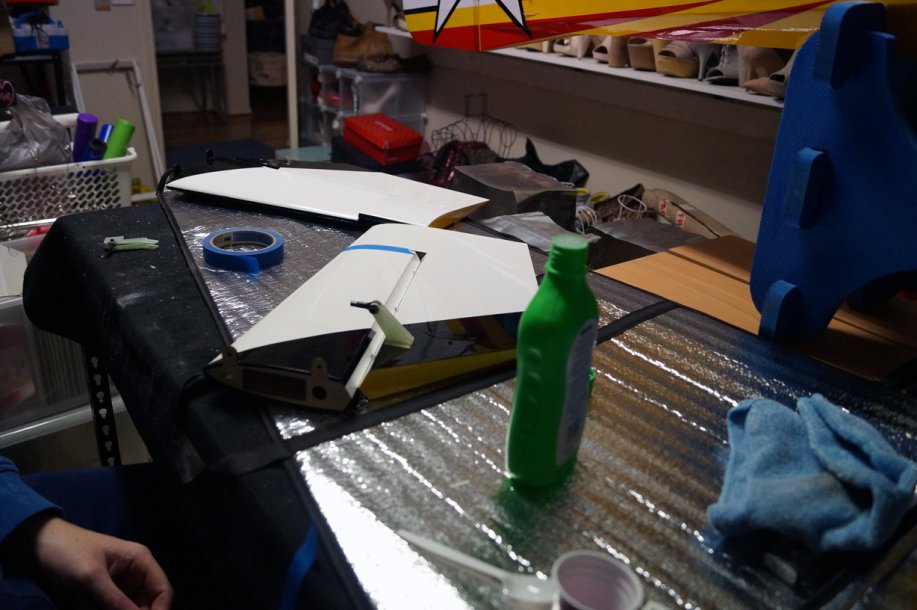

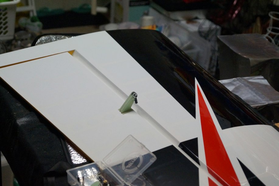

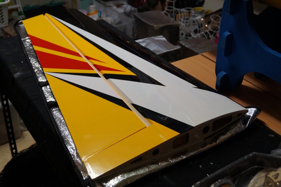

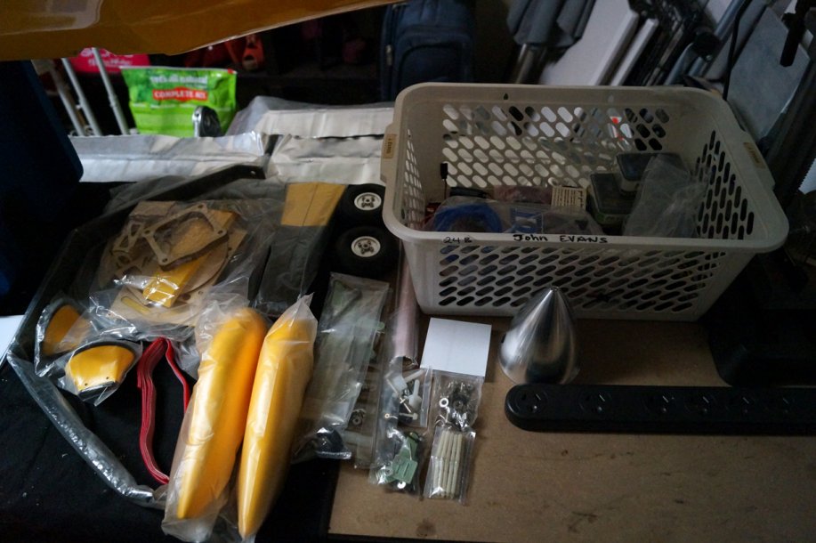

Well, I've started... I don't build fast, sorry, kinda work too long hours, but I am planning to get the servo's all done this weekend and maybe even start the firewall and engine mounting, some pics below, will try to get more done as I go
So far:
Kit is the usual 3DHS quality, gear is all usable, nothing I can see that makes me feel at unease
The canopy decking on the fuse side is a little flimsy for my overly large man handling so I am going to glue some spruce strips in places that will stiffen that up, this isn't a mod for overall strength just more to stop unwanted splitting in the plywood due to my general clumsiness :)
Just for personal preference and my own comfort I am going to hysol another plywood plate onto the firewall for the DA70, I know it would probably survive without it but our heavy model inspectors here are pretty strict on firewall thickness for engine size and the stock thickness is too small for a 70 twin in au, should be an easy mod, just remove the screws, trace or mark the center lines onto the new plate then hysol and screw it back in place, little bit of stock on the top and bottom and it should be sweet as for the DA70, with that much power on tap I highly doubt a few 100g's of extra strength will hurt
I started on the control horns for all surfaces today, everything went in super smooth, only the rudder needed a tad bit of filling to get a smooth entry, everything lined up perfectly and is currently drying, will take some shots tomorrow of the completed horns
I am going to do my trademark thing on the canopy, spray paint it :D - I will post some comparison shots when its done but will let the color be a surprise.
Will try and keep the thread updated as I go, so far so good.
