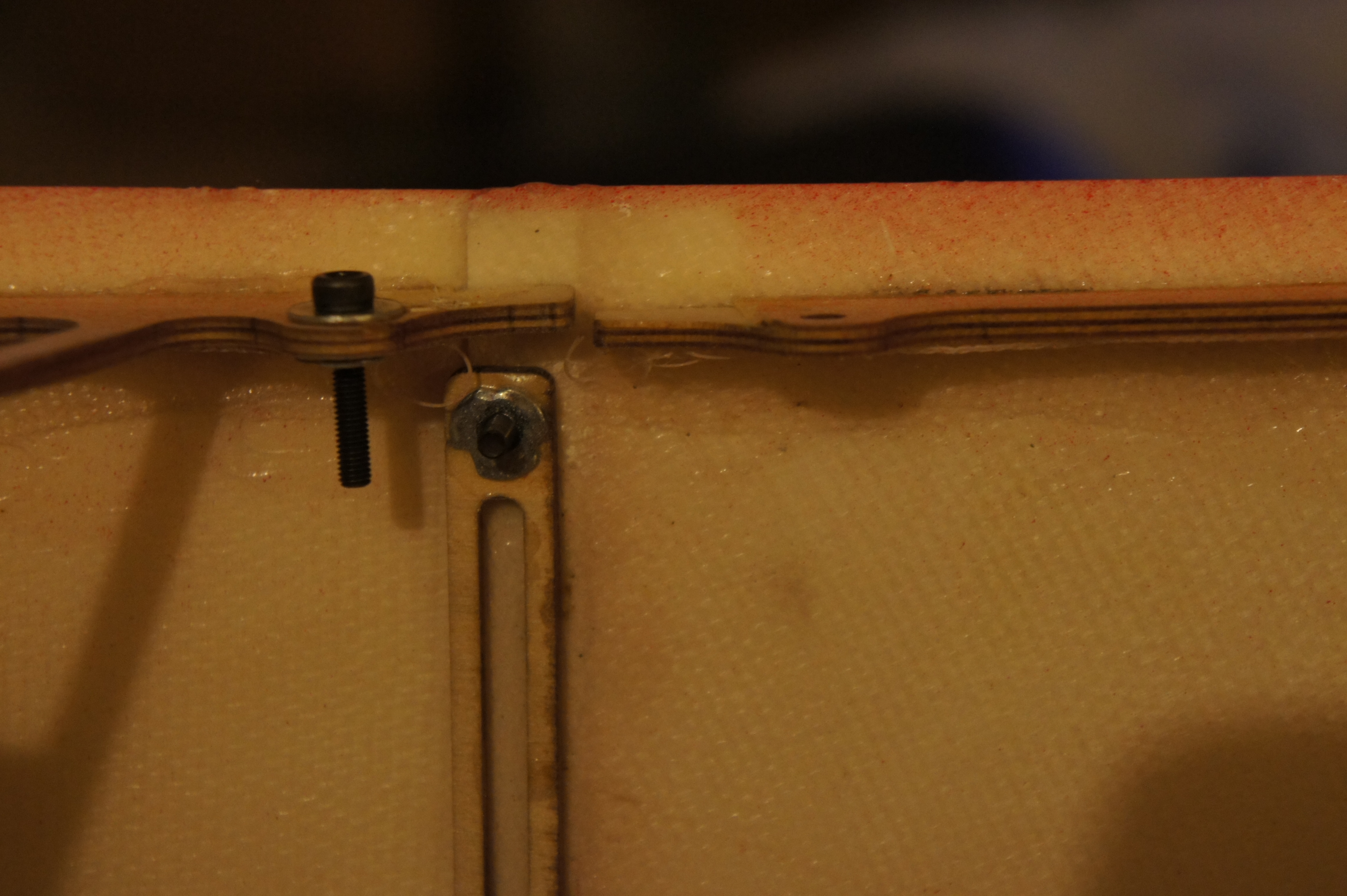

I just used large washers and needed to cut down two...You can kind of see in the pic below.

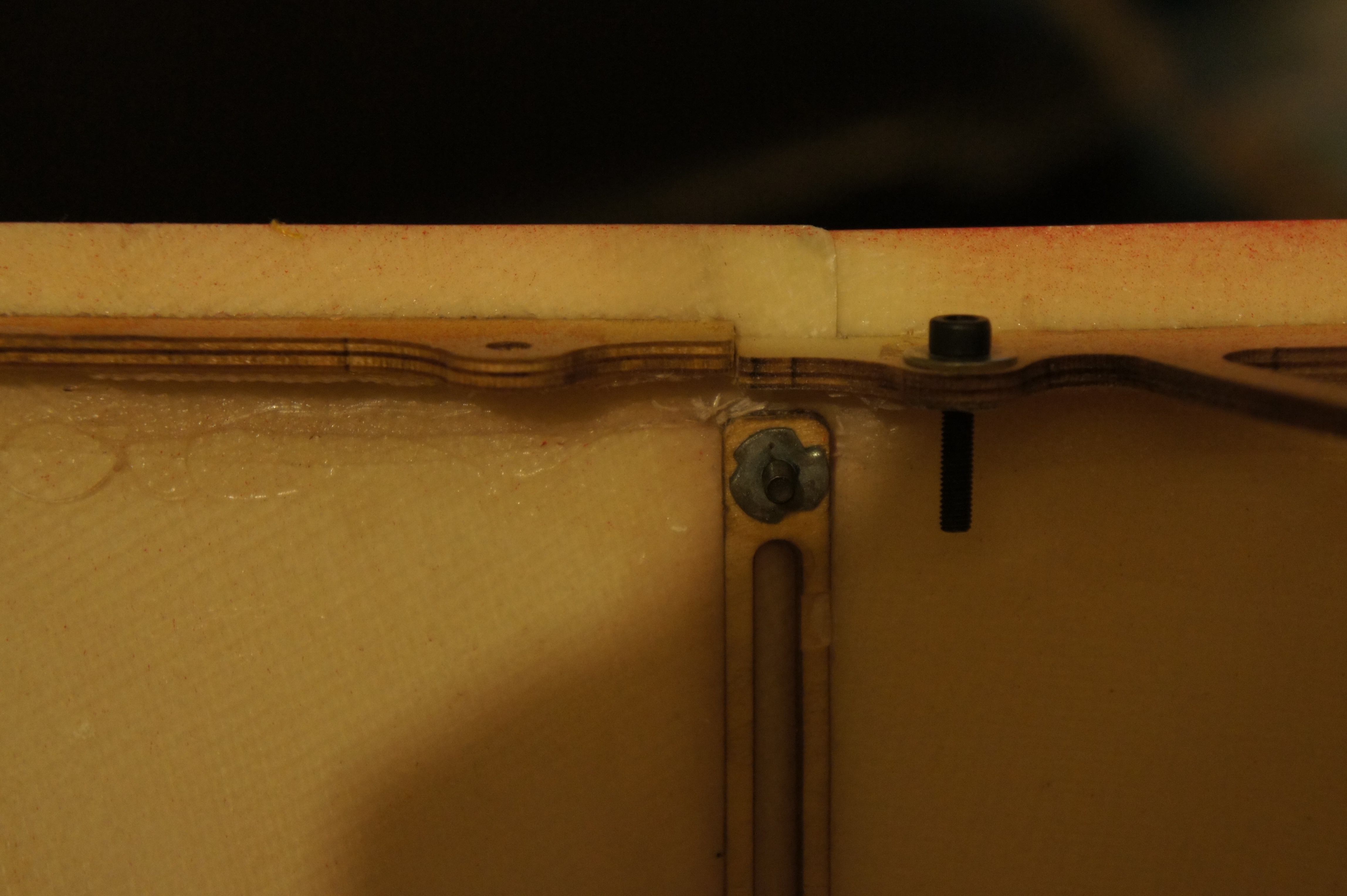

Did anyone have problems lining up their cowl? I tried mounting it up the other night and couldn't get the holes to line up between the two halves.
I sent an e-mail to 3DHS Tues night. Still haven't heard back from them.

Yes, I had alignment problems with the cowls on both of the 92 Edges I've owned. Both times the issue was related to poor cowl ring installation and/or alignment at the factory.
During a phone call with Noll from 3dhs on a separate topic, I mentioned this issue, and he said, "mine is the same way" and it wasn't discussed further.
I suspect both planes I've owned were from the same production run, and I hope it's something they can improve on in the future.

What did you do to fix it? Just shim it?

Your easiest and quickest fix would to be shim it like everyone else has or to cut the ring loose where needed and glass and glue correctly.

check out the used pop sickle sticks on the right side. This got me within 90%...
I think 3DHS needs to list pop sickle sticks in required hardware to complete the build...
