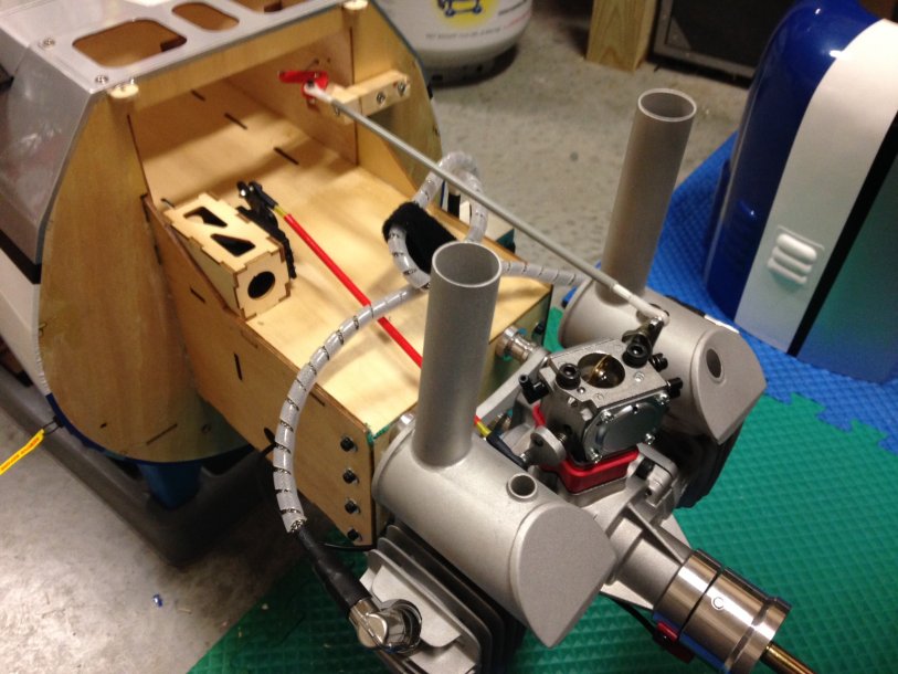

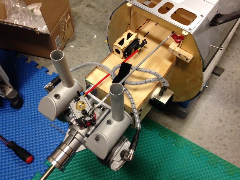

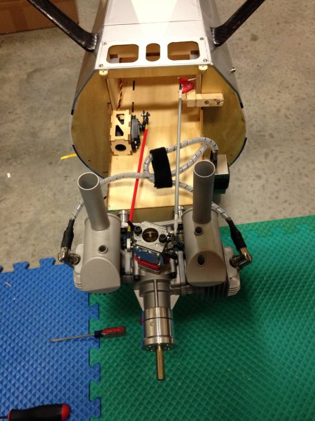

Bit more progress on the Yak the last few days. Choke linkage done, throttle servo mounted and connected up. Fuel tank got mounted and connected up last night. IBEC installed. Need to grab a grommet or two to secure my vent line in the cowl, figure out the battery mount place to balance it and she will be done.
Once I get the motor test fired and verified I'll mount the cowl and get a final all up weight on the plane with the EME70 installed and post that up. Should fly this weekend weather permitting.
Choke linkage was done with a bell crank and pops out the side of the plane, near the bottom. I didn't see many other easy ways of doing it, the way the choke arm mounts on the plane there wasn't any leverage to just drop it straight down in the cowl. Would have been extremely hard if not impossible to open and close it. And once the spinner is mounted it wouldn't have been accessible from the front either, so this worked out pretty well.
I've got some additional vent holes a bit further back in the fuse, don't worry.
