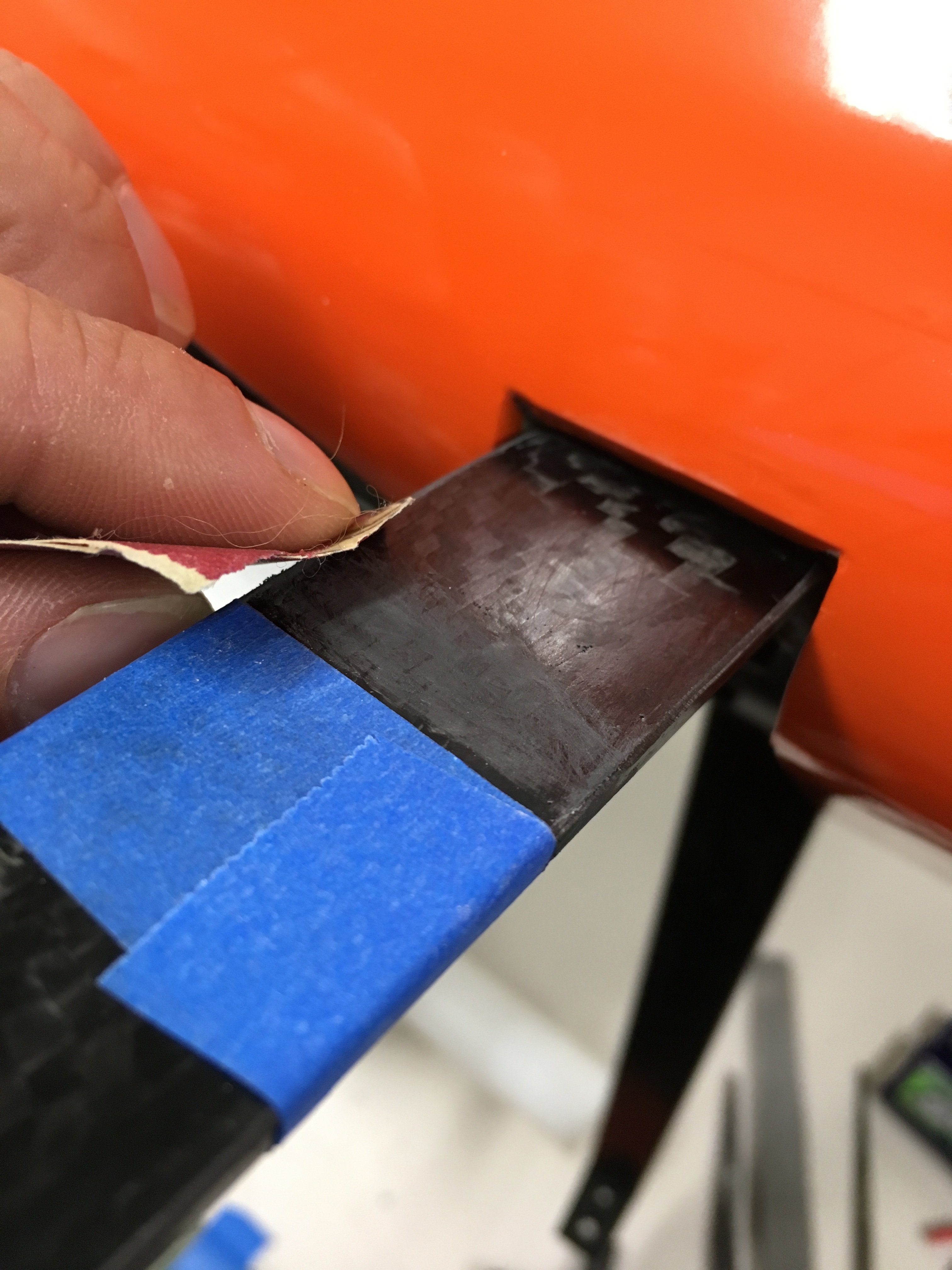

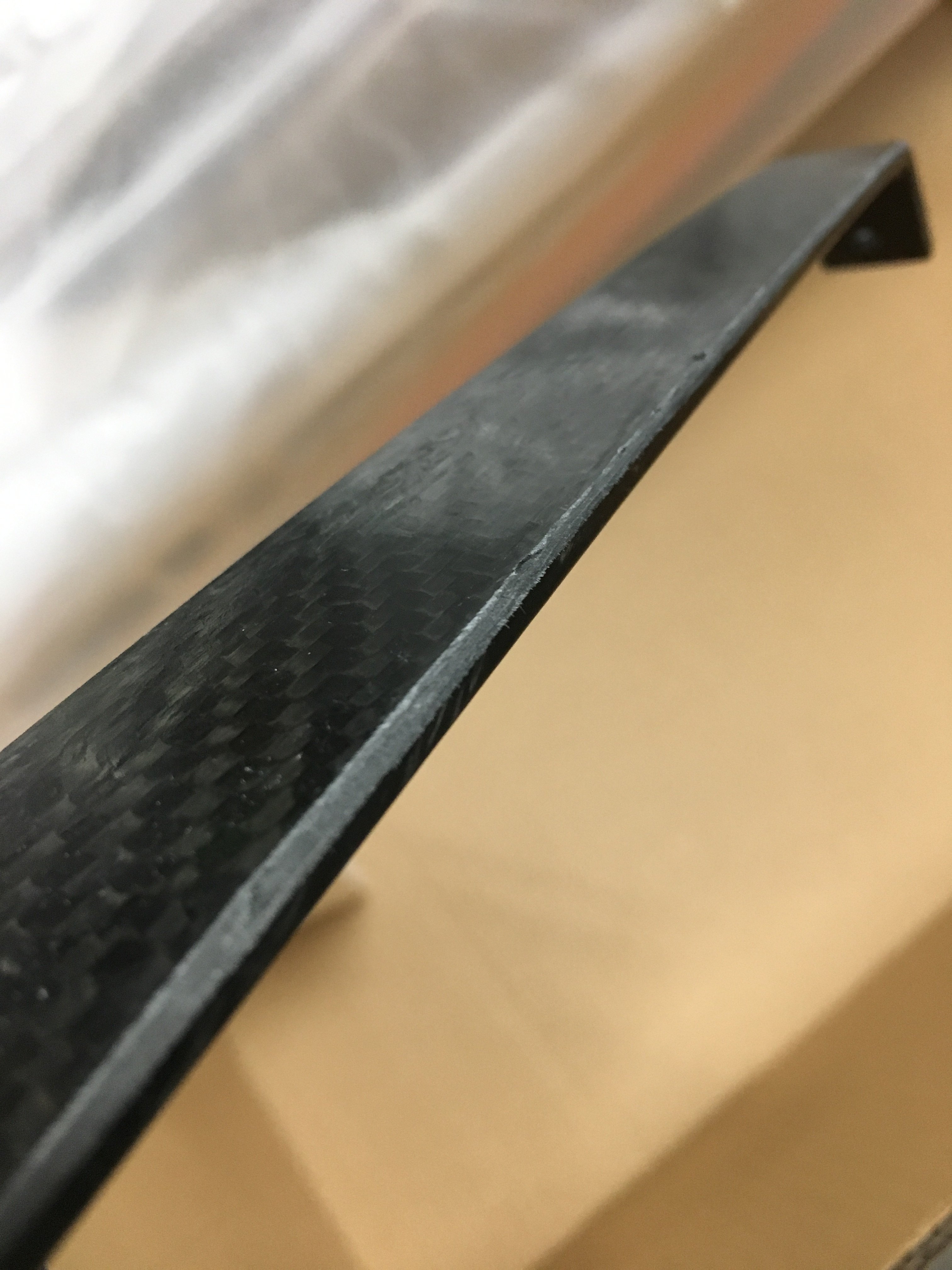

This gear is STOUT. Mine has a few imperfections, but very thick and robust- only cosmetic.

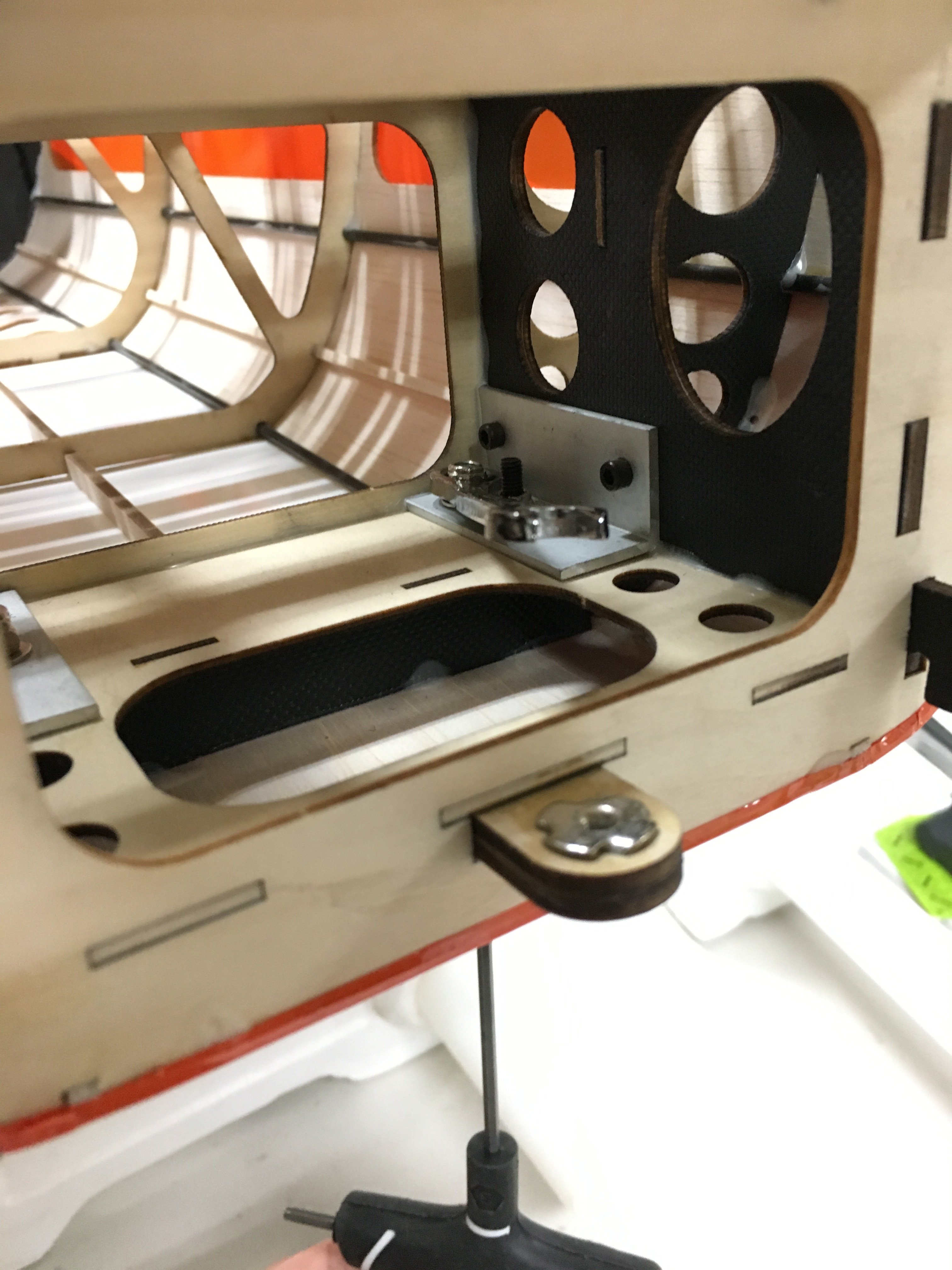

The gear is bolted through the fuselage onto some aluminum angle, no blind nuts here!

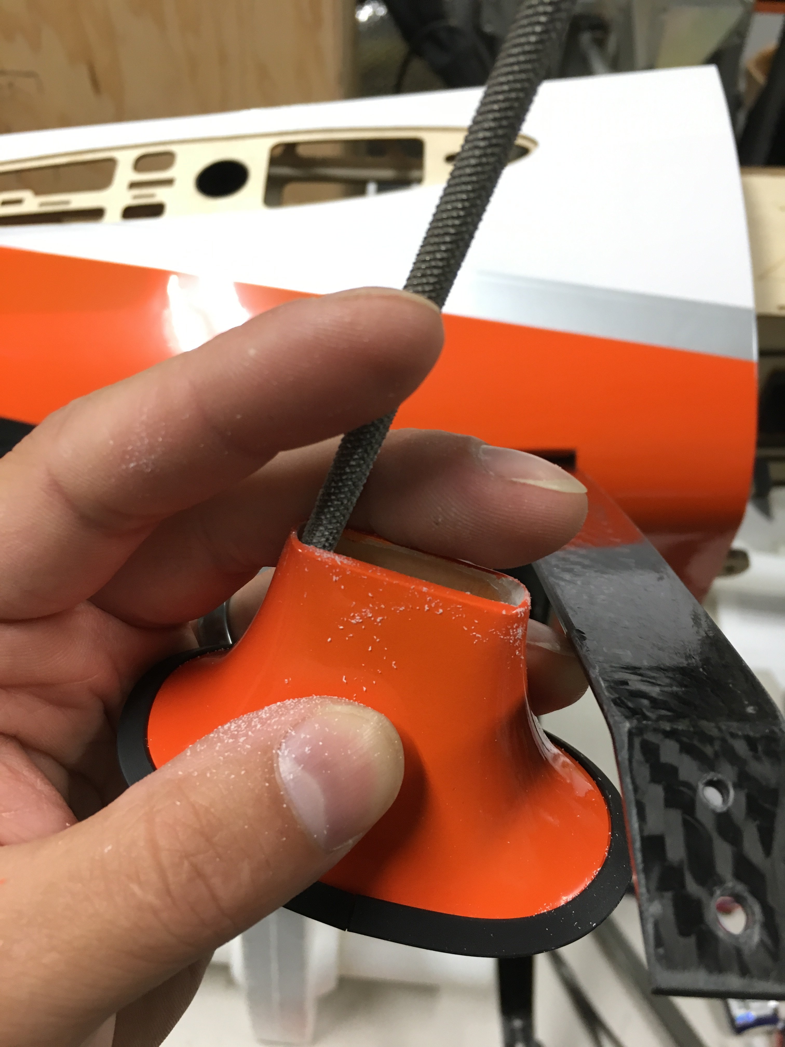

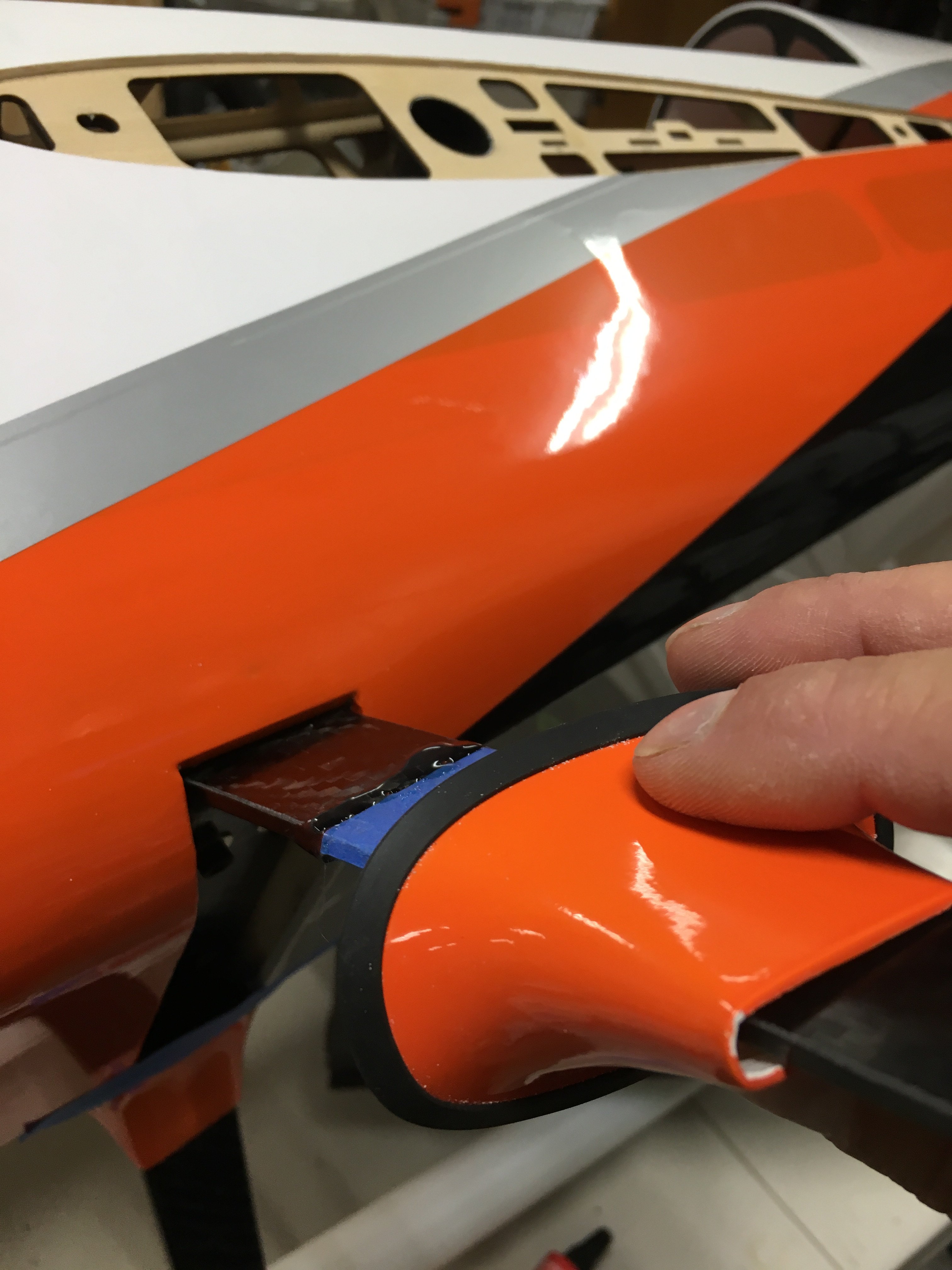

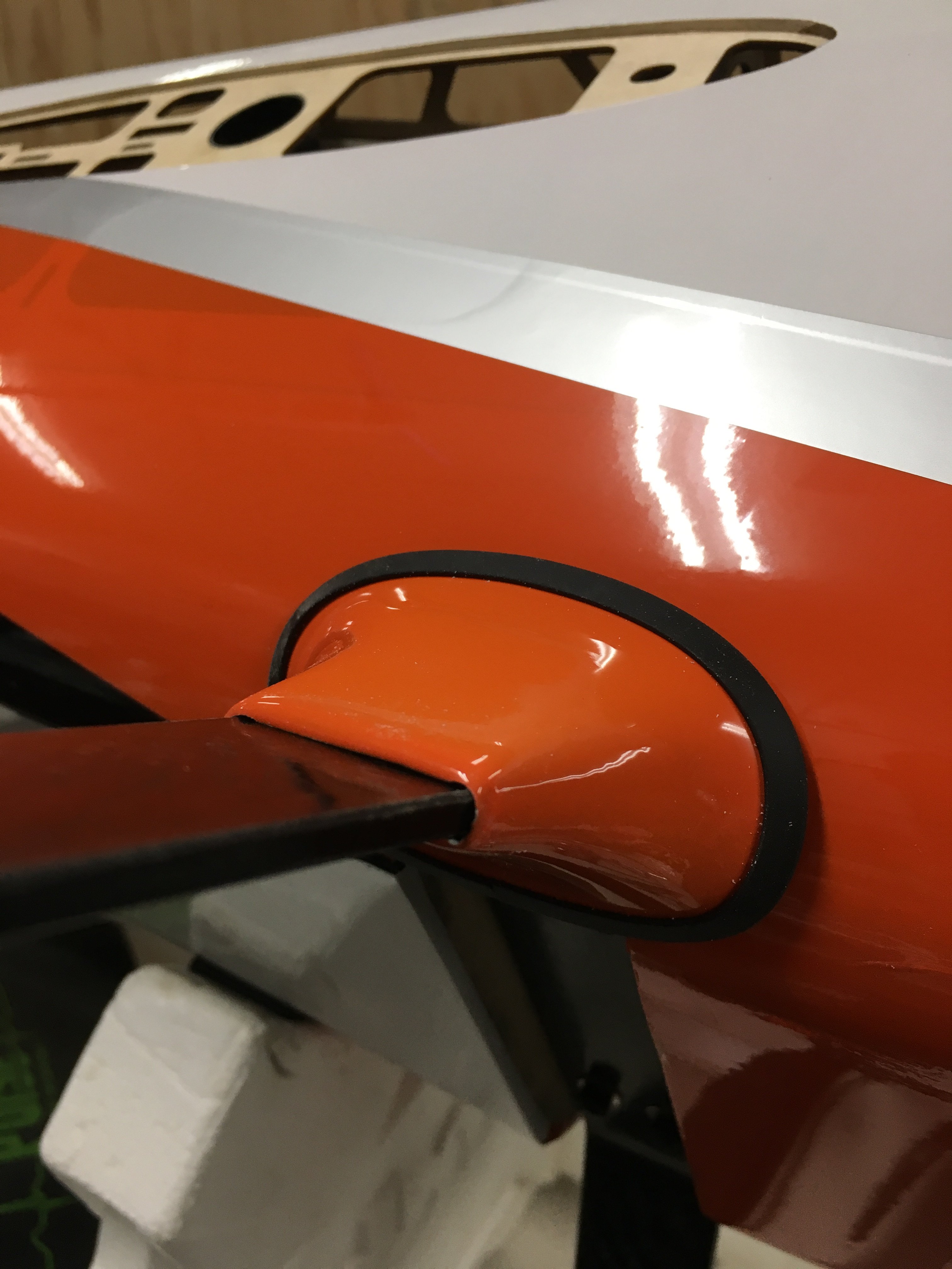

To my surprise the landing gear cuff rubber grommets are U shaped and pre-installed. I've always hated gluing those on, they never seemed to stick either. So thanks design team!

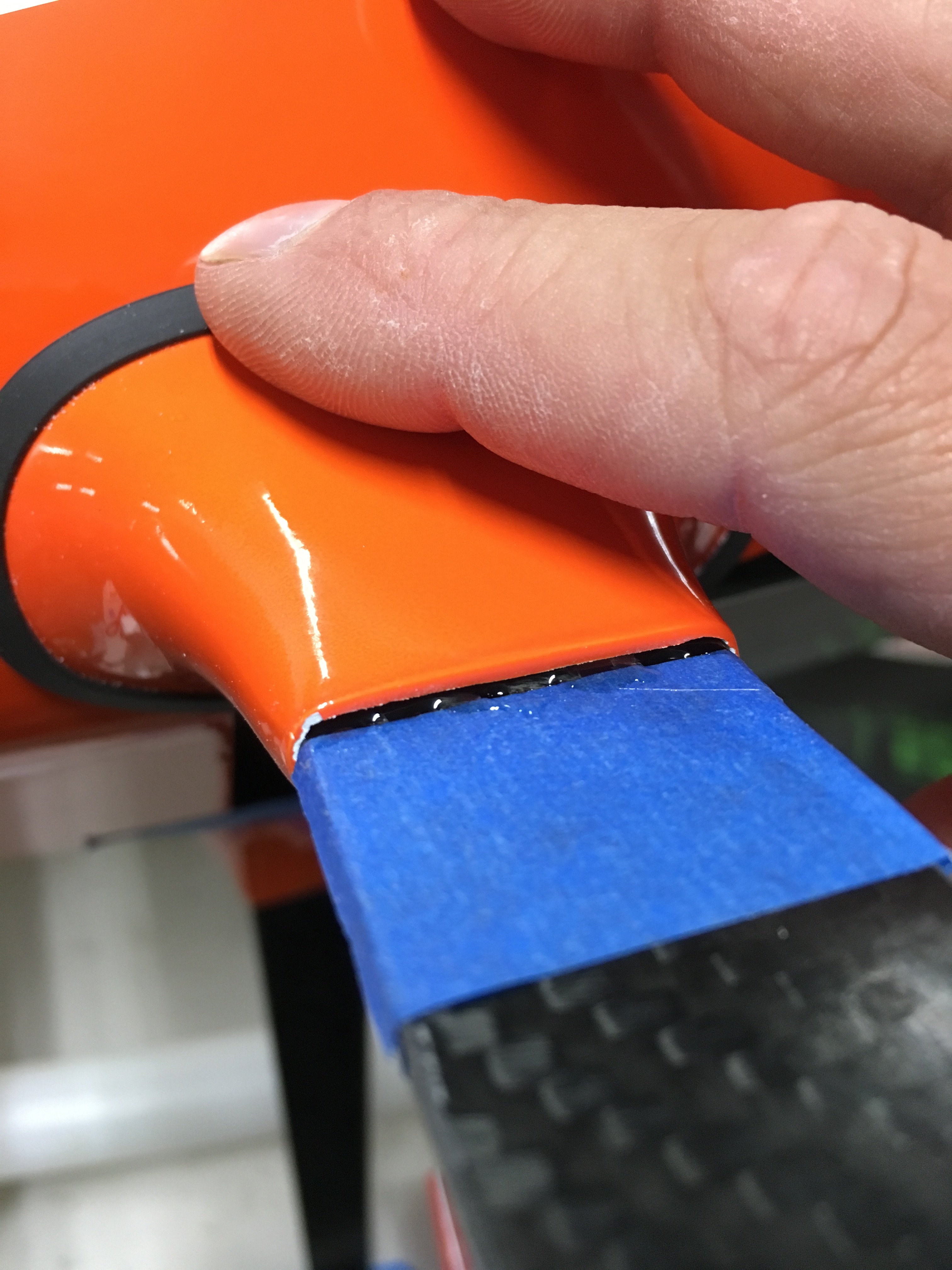

File them to fit the gear leg without cracking the cuff is the key to success.

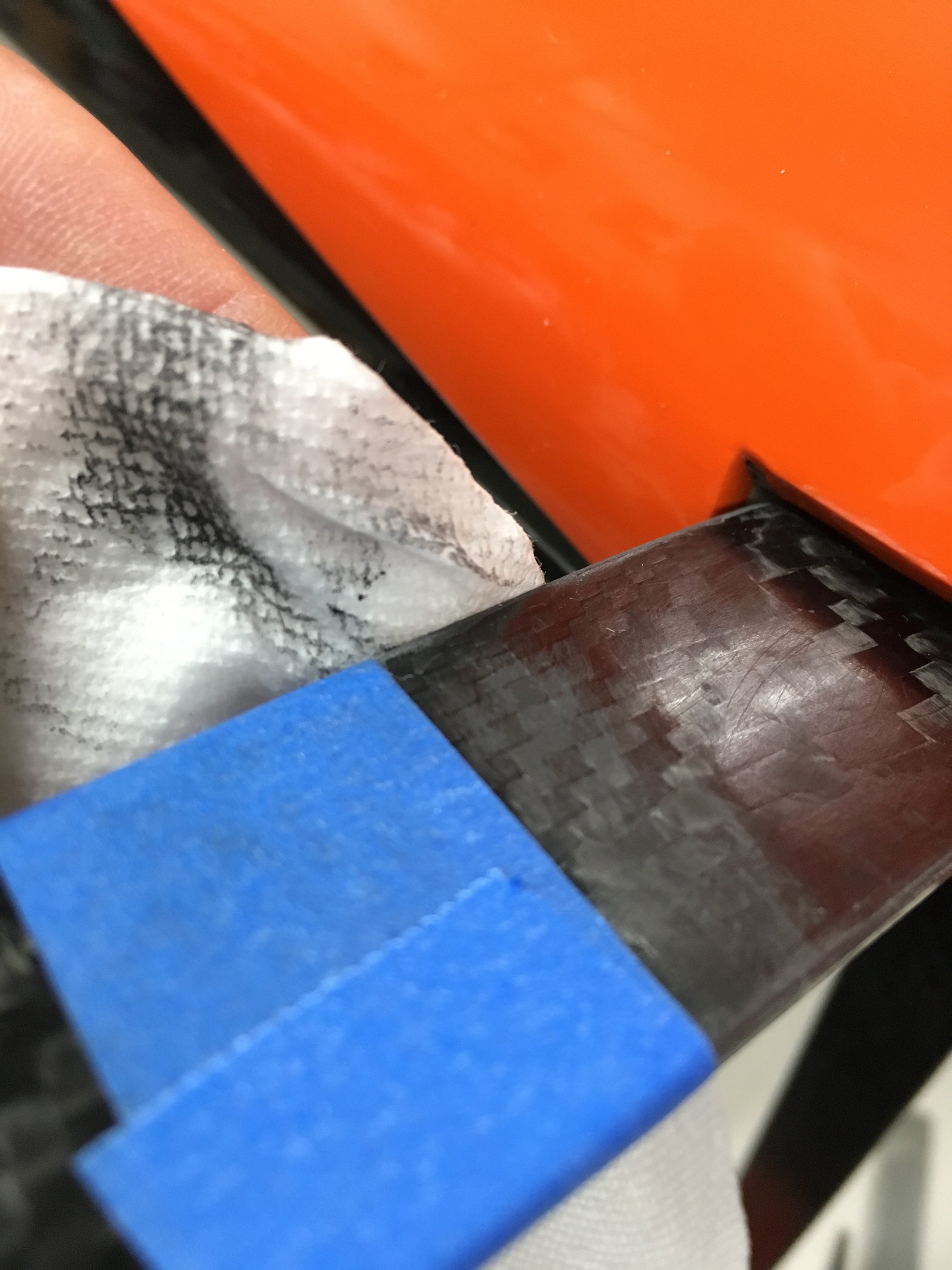

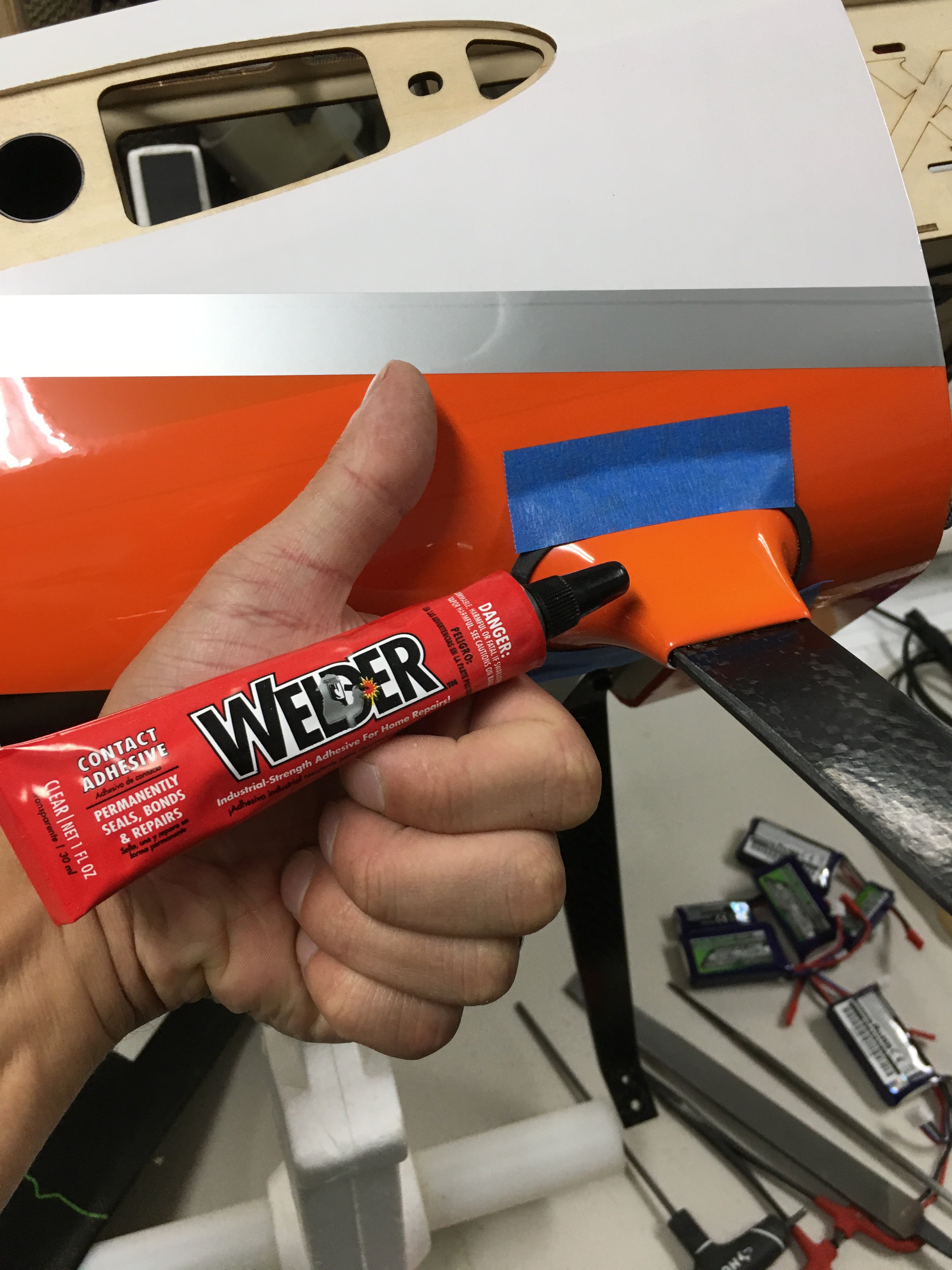

Once it's fitted, use blue painters tape to mark where the cuff stops and scruff up the gear leg lightly so the glue will stick better.

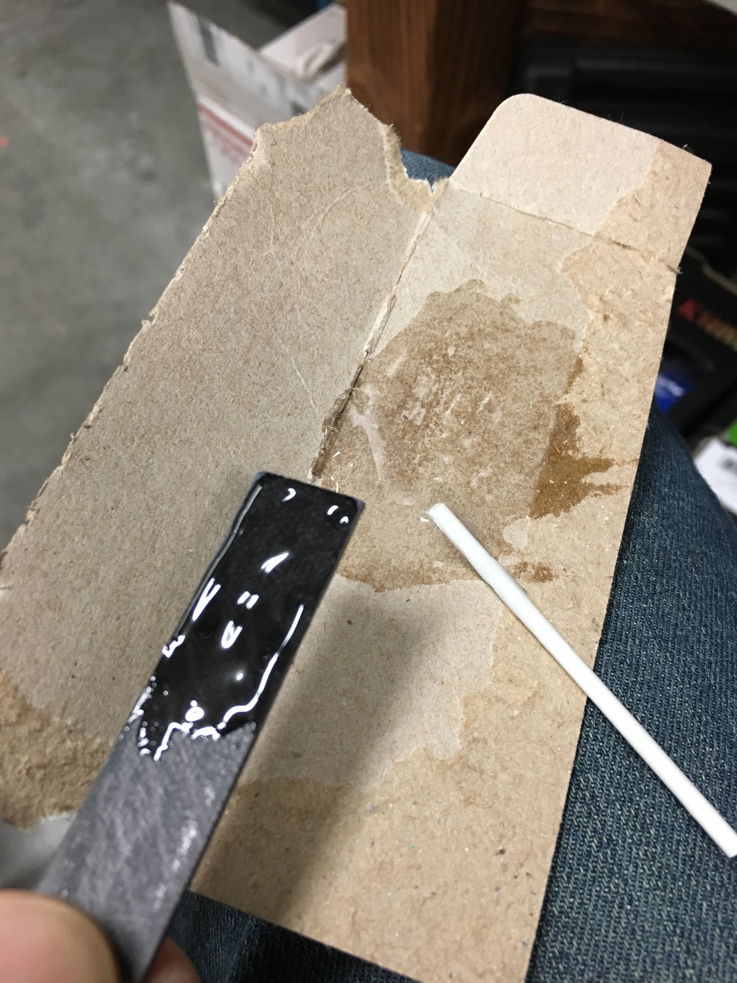

Add the glue (I'm using my trusty welders glue). I'll add a bead of glue around the circumference of the cuff were it attaches to the gear for some extra support.

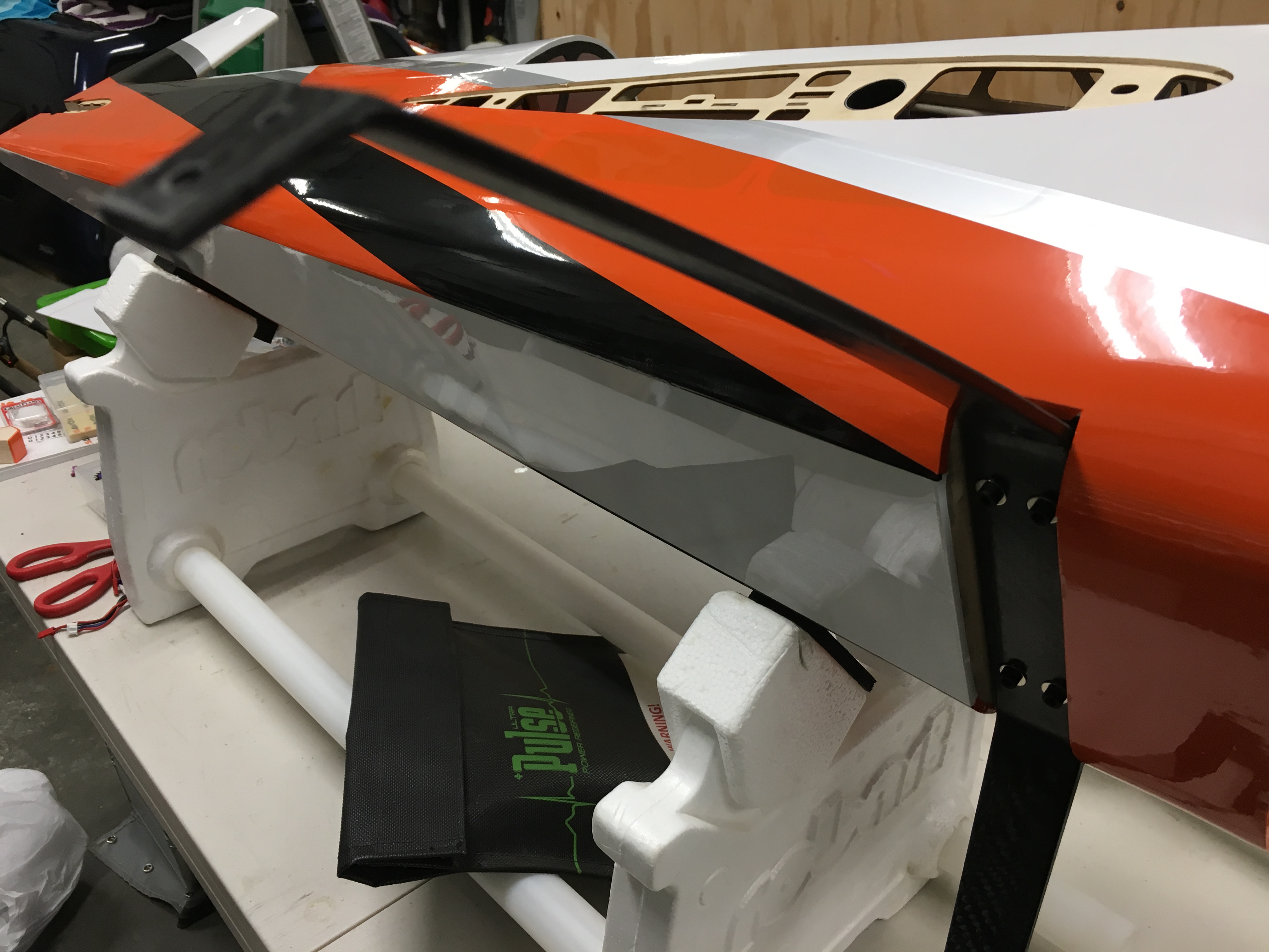

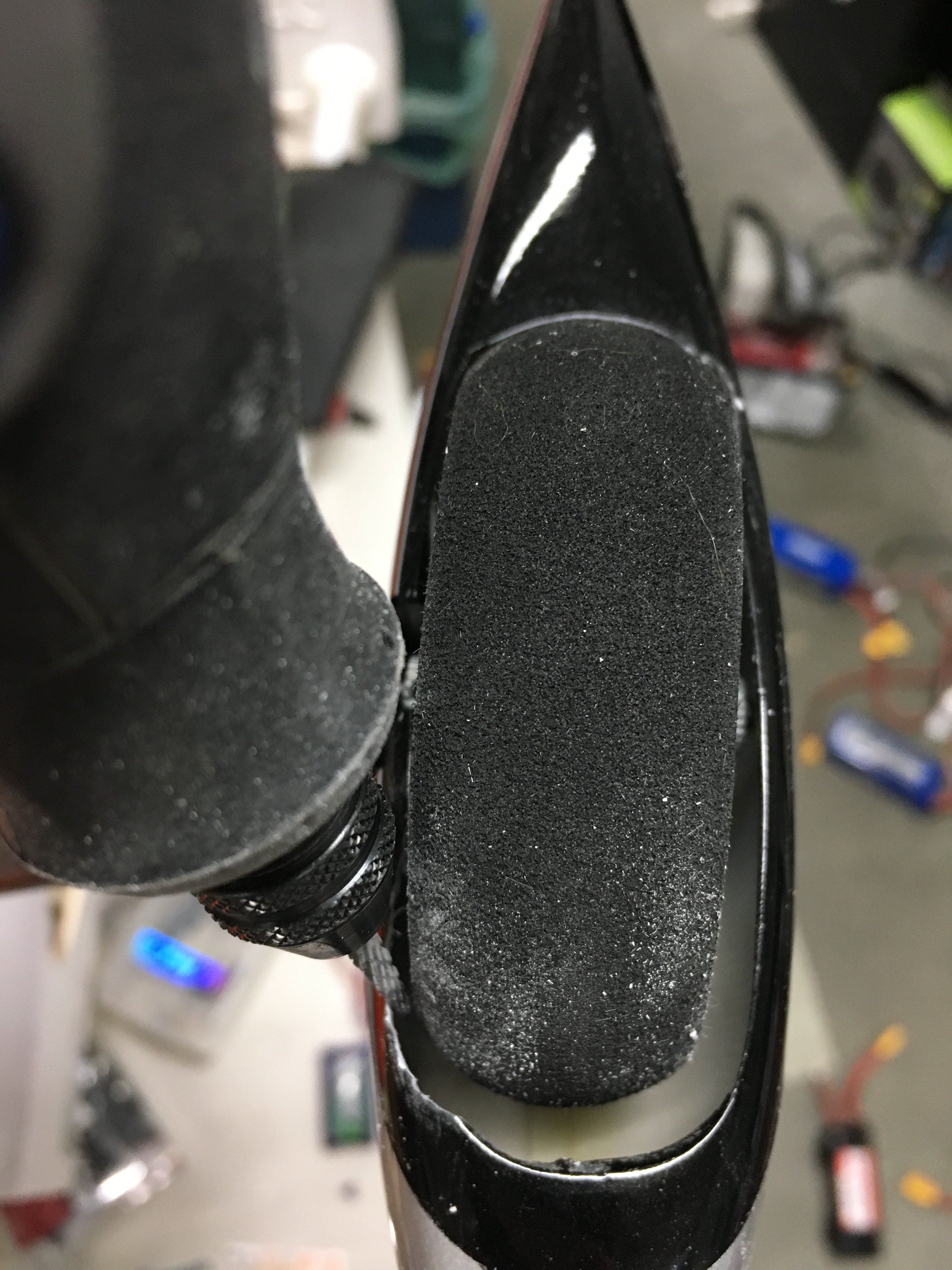

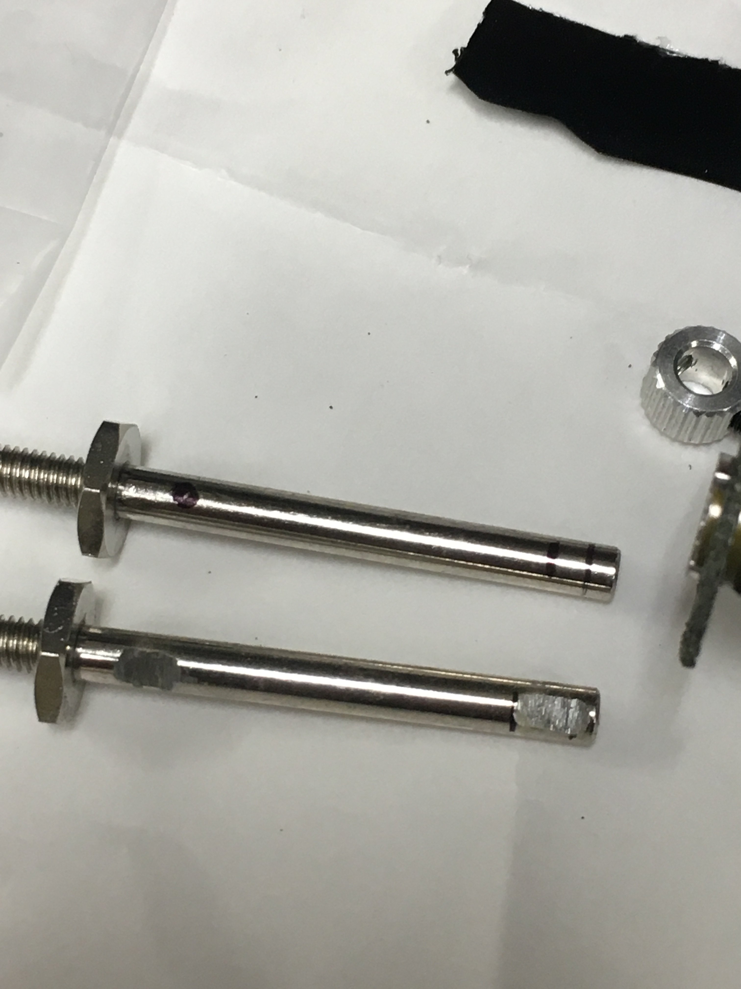

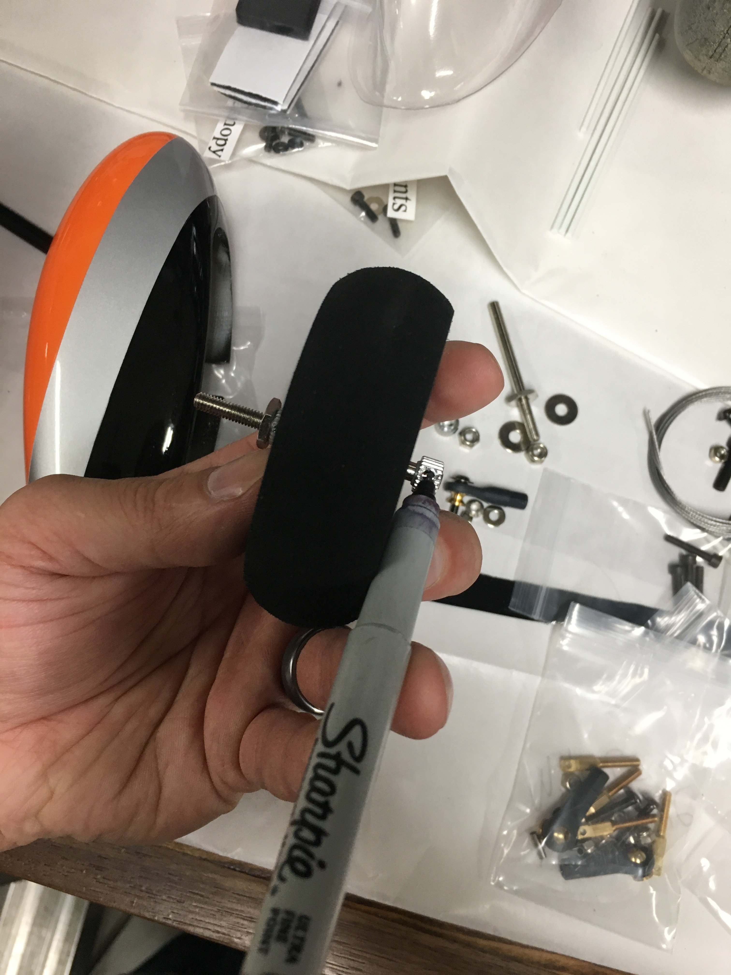

As for the Wheel and Pants. I like to fit everything together with the allen screws out of the collars, use a fine point sharpie to mark where to dremel a flat spot. Then put it on the gear leg, add the pant and trim any areas of concern.
