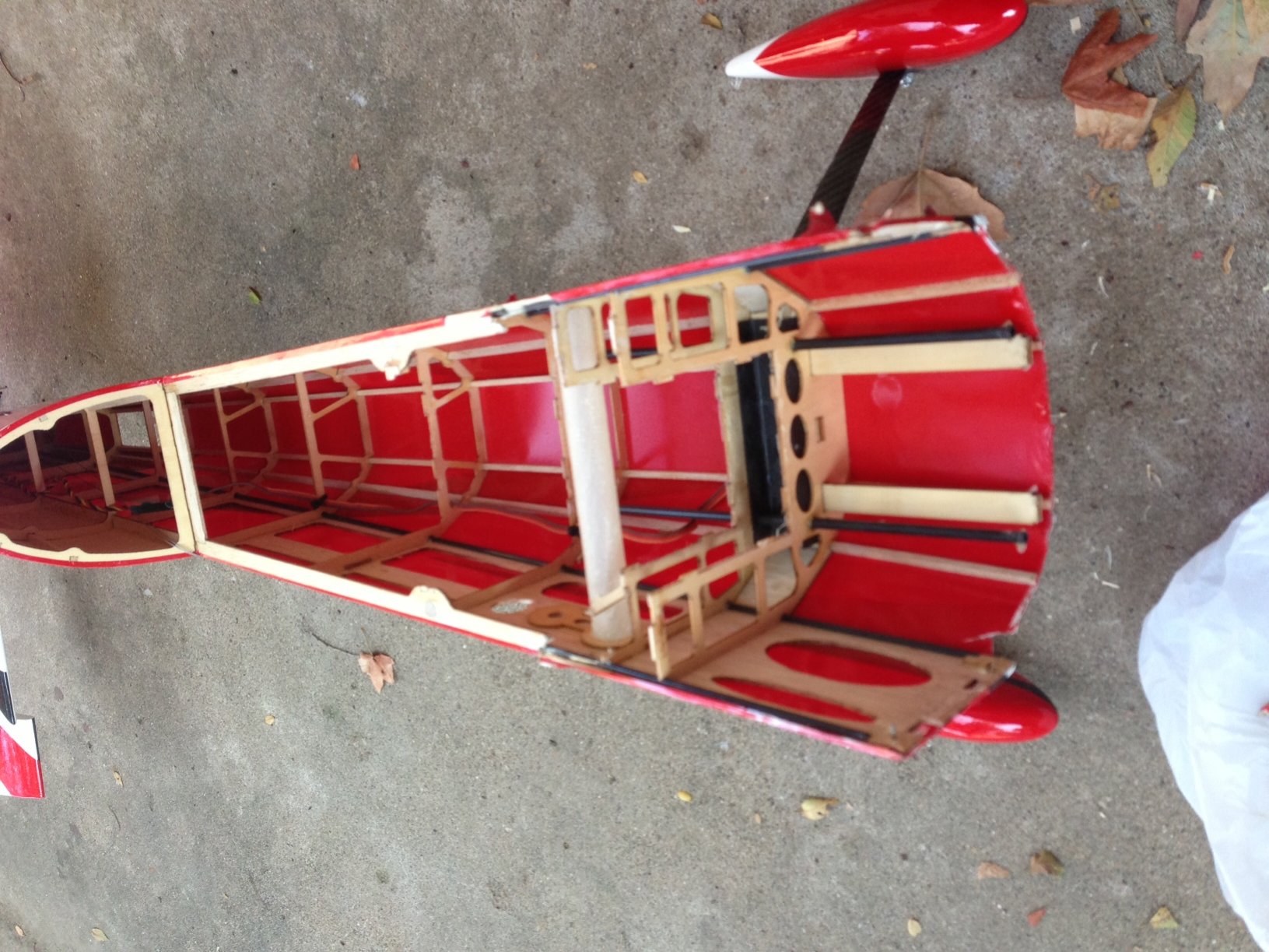

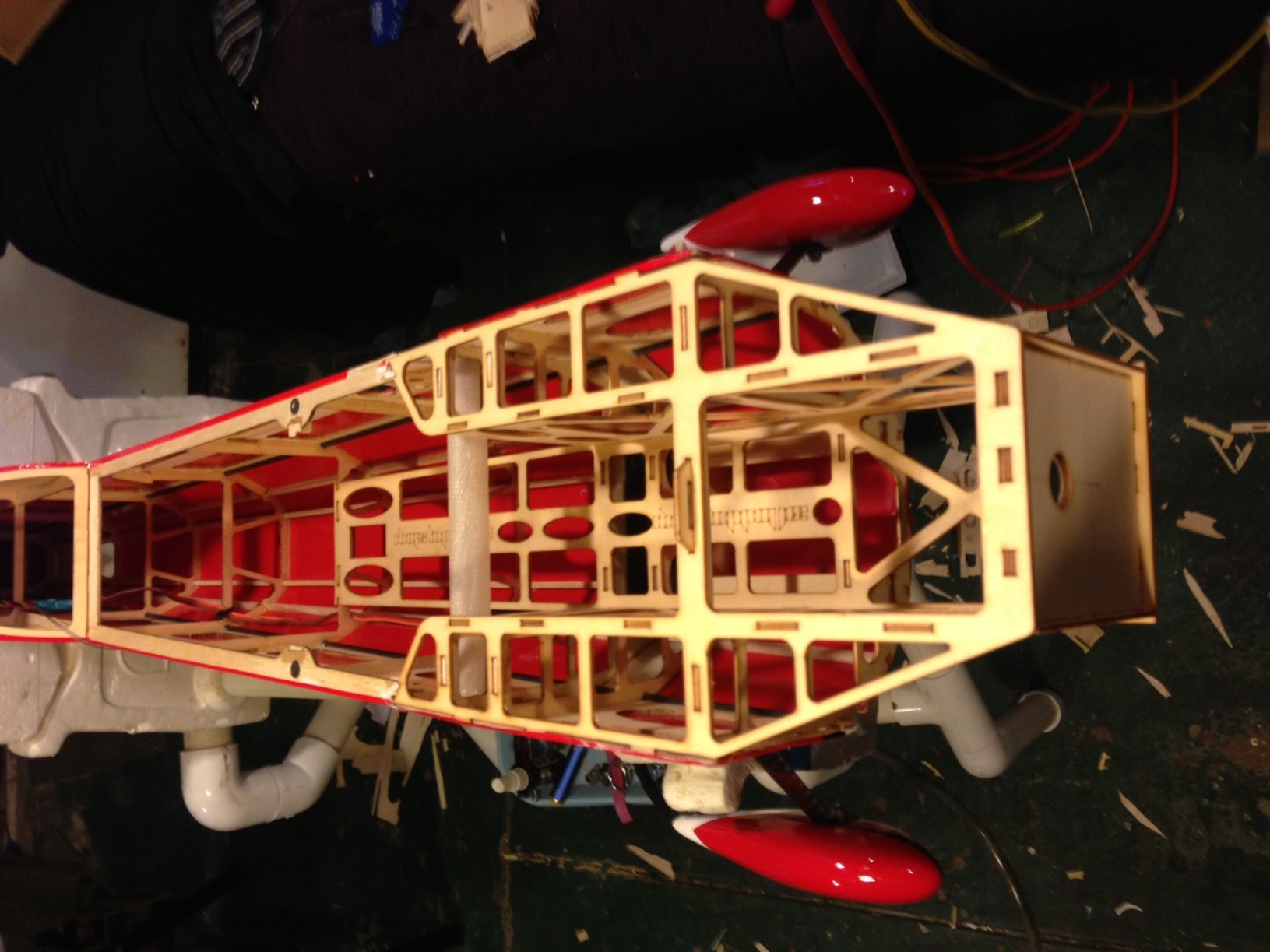

Started working on mine, today!
Got the wrecked box out, and the new box in.
