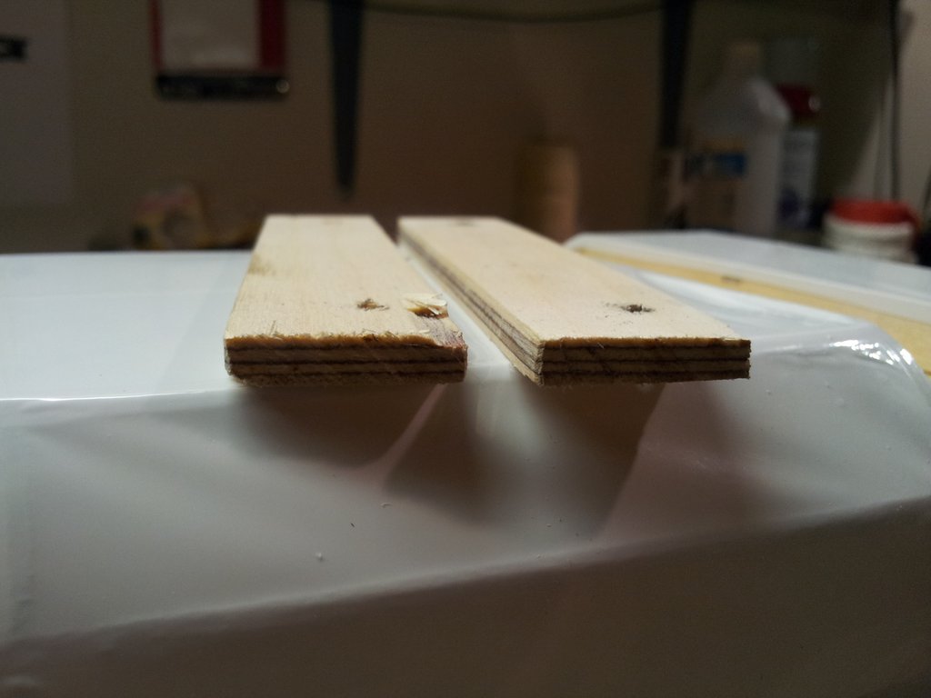

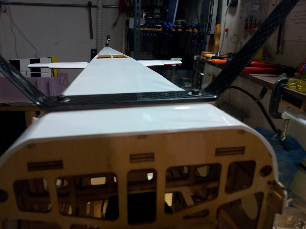

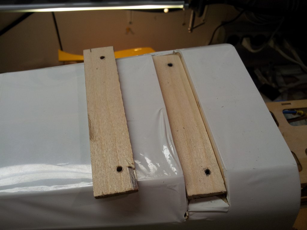

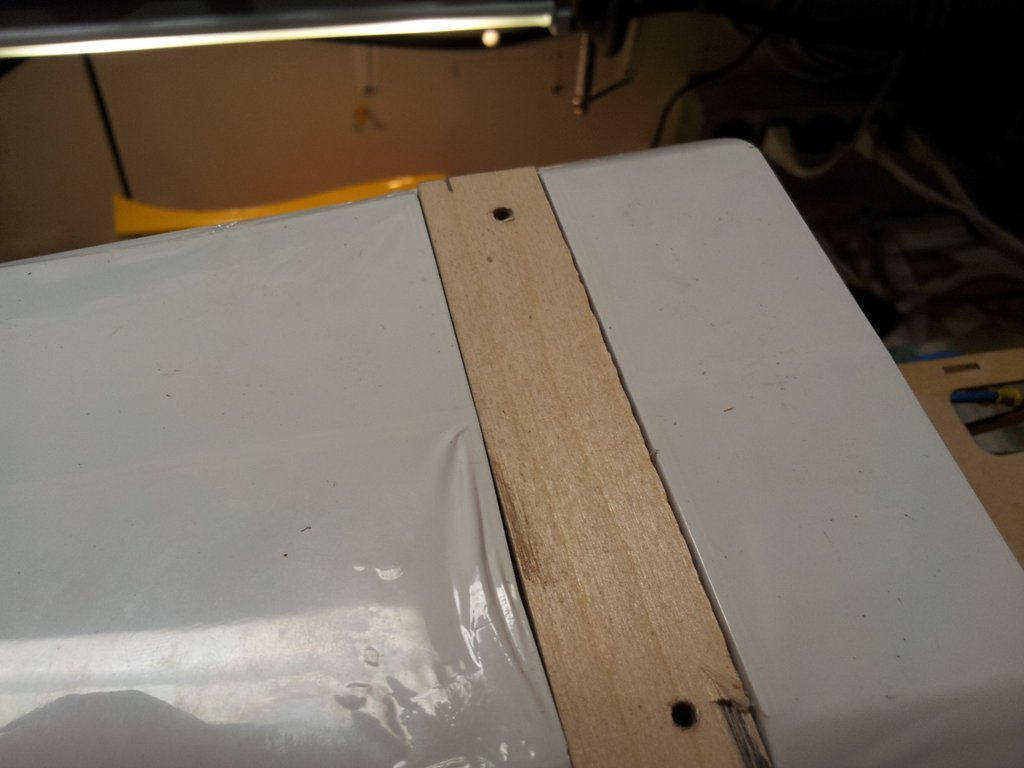

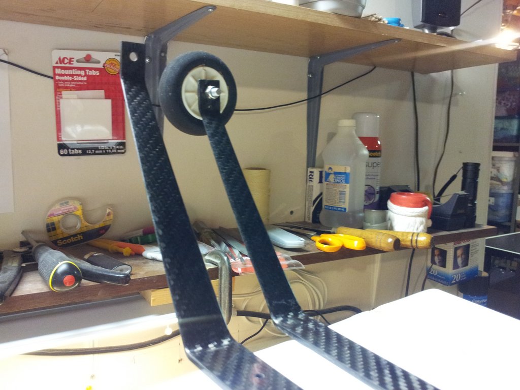

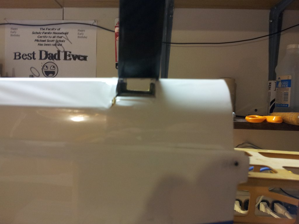

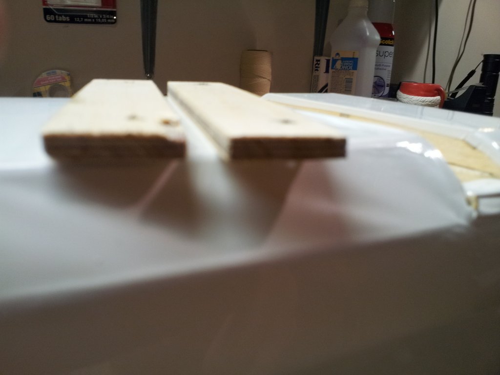

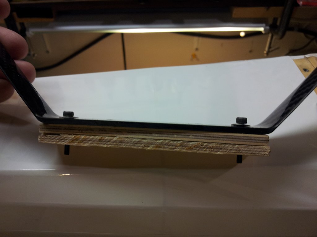

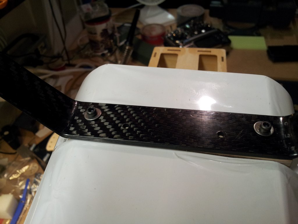

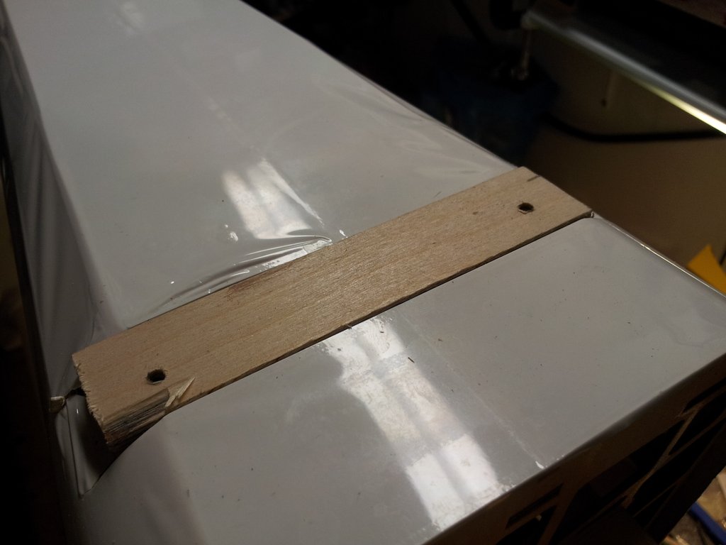

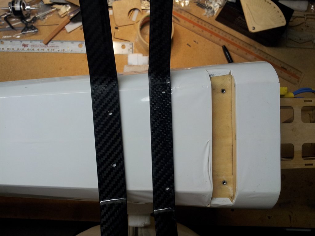

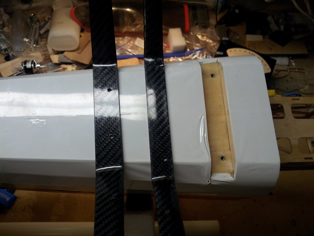

Here is my post from earlier this year regarding the 55" Edge LG on the 51" Slick:
So here's my report on the 55" Edge LG fitting the 51" Slick: it works. Not too much to mod. The 55" Edge LG is just a bit wider than the LG bay on the 51" Slick so I cut two pieces of lite ply to function as a spacer. Also had to measure holes in the 55" Edge LG to match the holes in the 51" Slick LG block. Pictures tell the story. Let me know if you have any questions. This sure beats waiting until the 51" Slick LG is in stock. The standard 3mm SCS cap screws were too short, so I used 3Mx20mm SCS screws instead.
FYI, www.TrimcraftAviationRC.com is a great place to get these kinds of screws and other hardware for really good prices and reasonable shipping.
