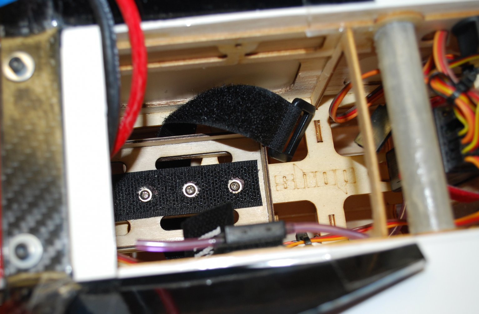

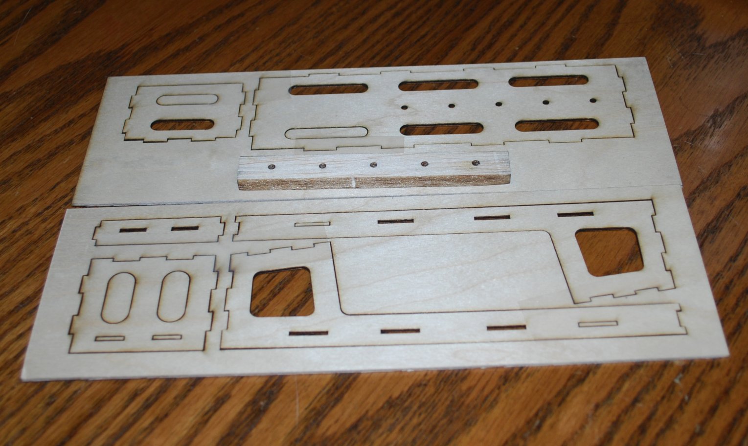

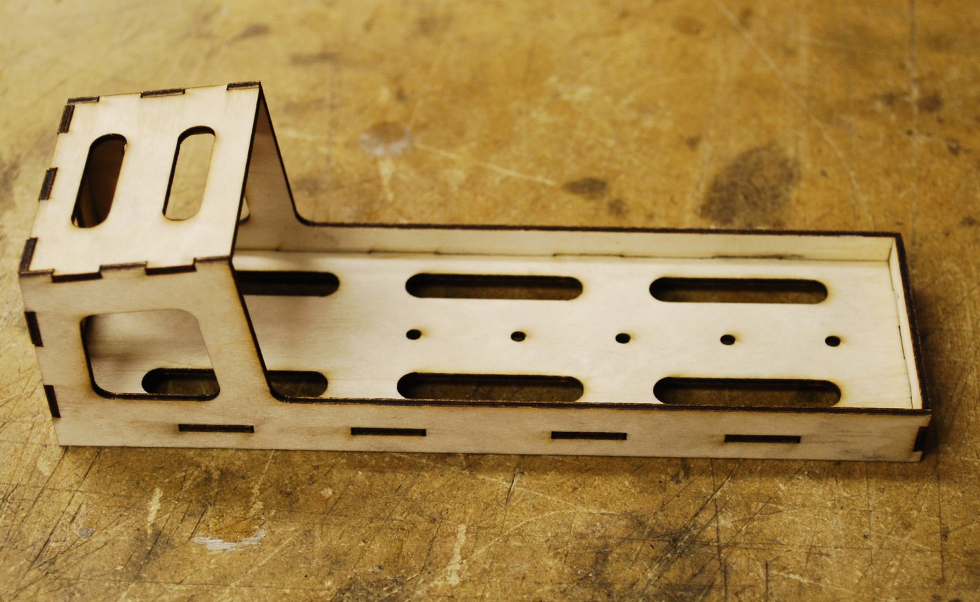

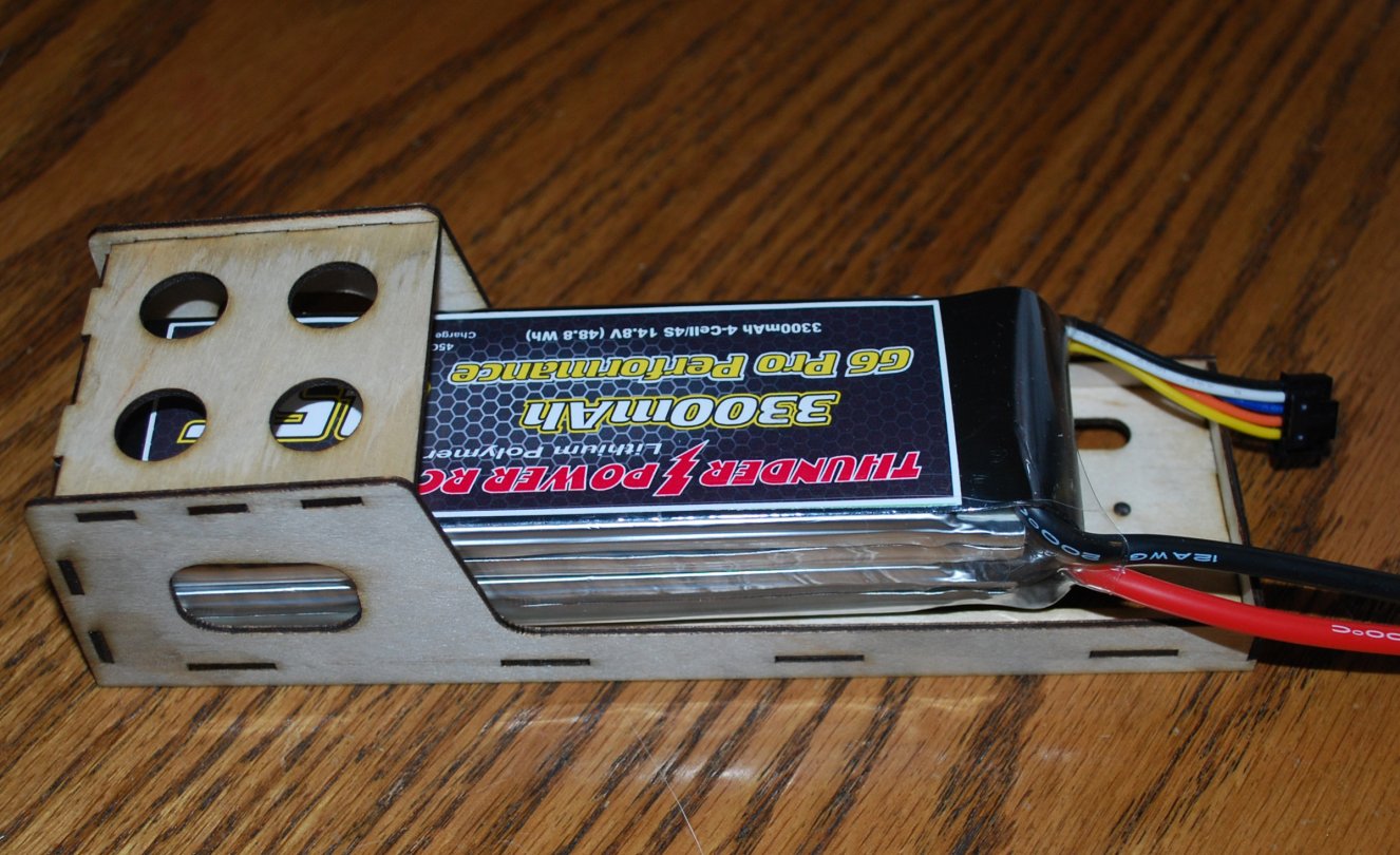

As those of you who have the 51" Slick, may have found out, if using lighter batteries in it, it can be a bit of a bear to strap them in well......So, I have re-designed my existing battery tray for the "Byper" to accept larger batteries (up to...1.4" High X 1.9375 wide X 6.125" long). and am going to have a few cut. I will sell them for $22.00 including shipping via USPS Priority mail in the conus....These will screw down on the existing tray, and allow you to use only one strap to hold the battery in. It will be similar, but not exactly the same as the one in this picture... If you want one, PM me...

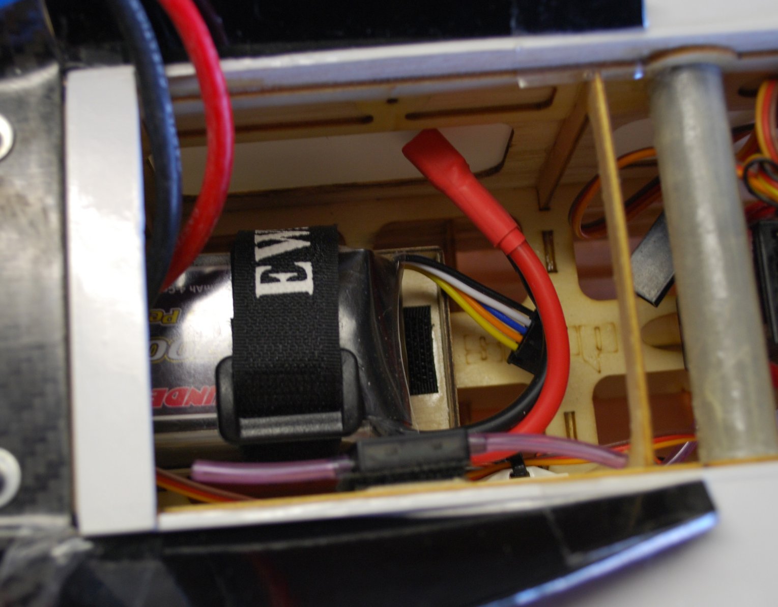

I have received the first test batch of these battery box/trays, but I had a slight flaw where two pieces do not overlap as they should due to an incorrect measurement on my part, but have ordered new pieces to correct this.... I will have them for sale in about a week if anybody is interested in them....$22.00 shipped via USPS Priority mail in the conus... The last two photos are from a similar box installed in a "Byper", but as I have not yet built, my 51" Slick, this will give you an idea of how they work.
