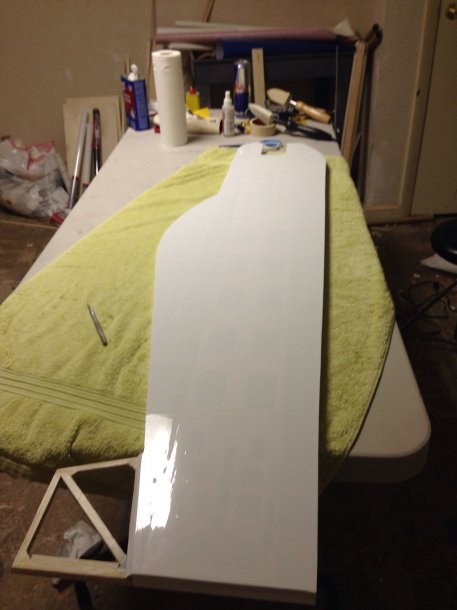

One side down. Took three hours. Came out goodish. Iam getting better and better at covering. Learning little tricks.
BalsaDust
Looks good brotha. Don't be affraid of it. You will make mistakes here and there and the more you do it the more little tricks you will find that work for you. And just remember soemthing that works really well for me may not be what works for you it's all about finding what's easiest for you.
