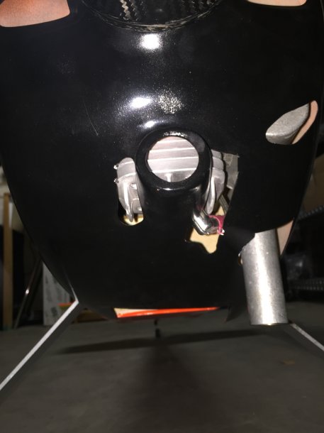

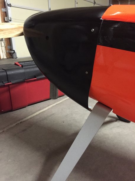

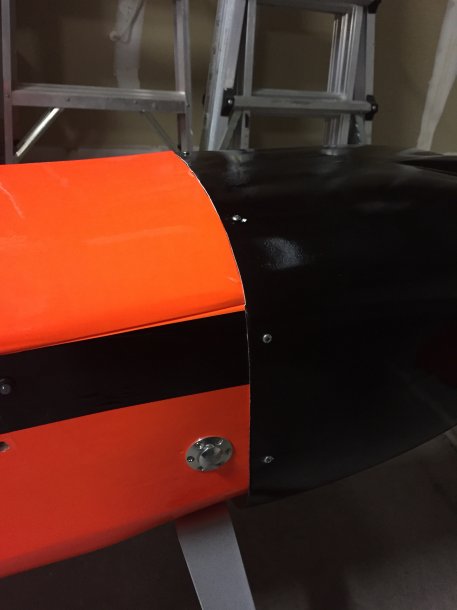

Here are the pictures of the cowl. I took out the plywood cowl ring and secured it with basswood blocks and screws. The fit on F-1 was good in the top and sides with a little coaxing. You can see that it is taller than the fuselage by seeing the extra about 1.5 inches on the bottom. The most problem I had was the front part. The cylinder head was hitting the front of the cowl before the front of the engine was sticking out of the cowl. That's what prompted the holes in the front so nothing on the cowl was hitting the engine with it placed properly. So I am not sure what the difference is between this and the Pilot Edge with a DA up front. It seems to me that fitting would be identical.
