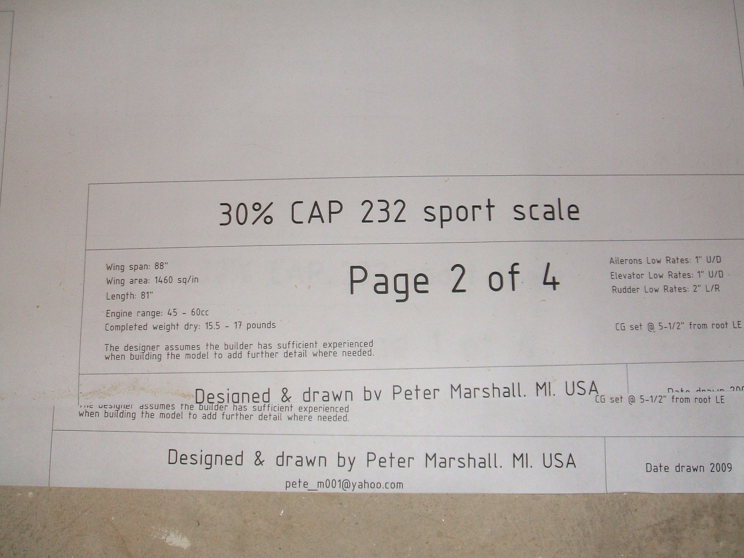

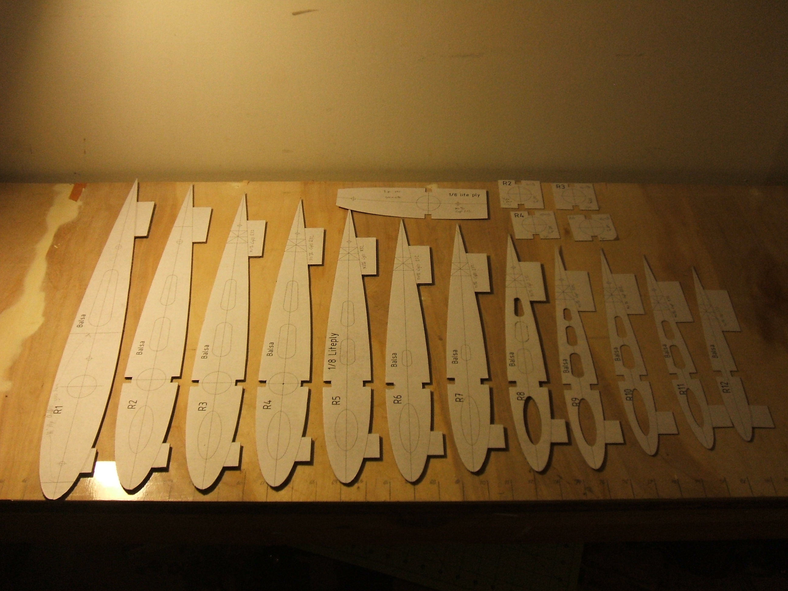

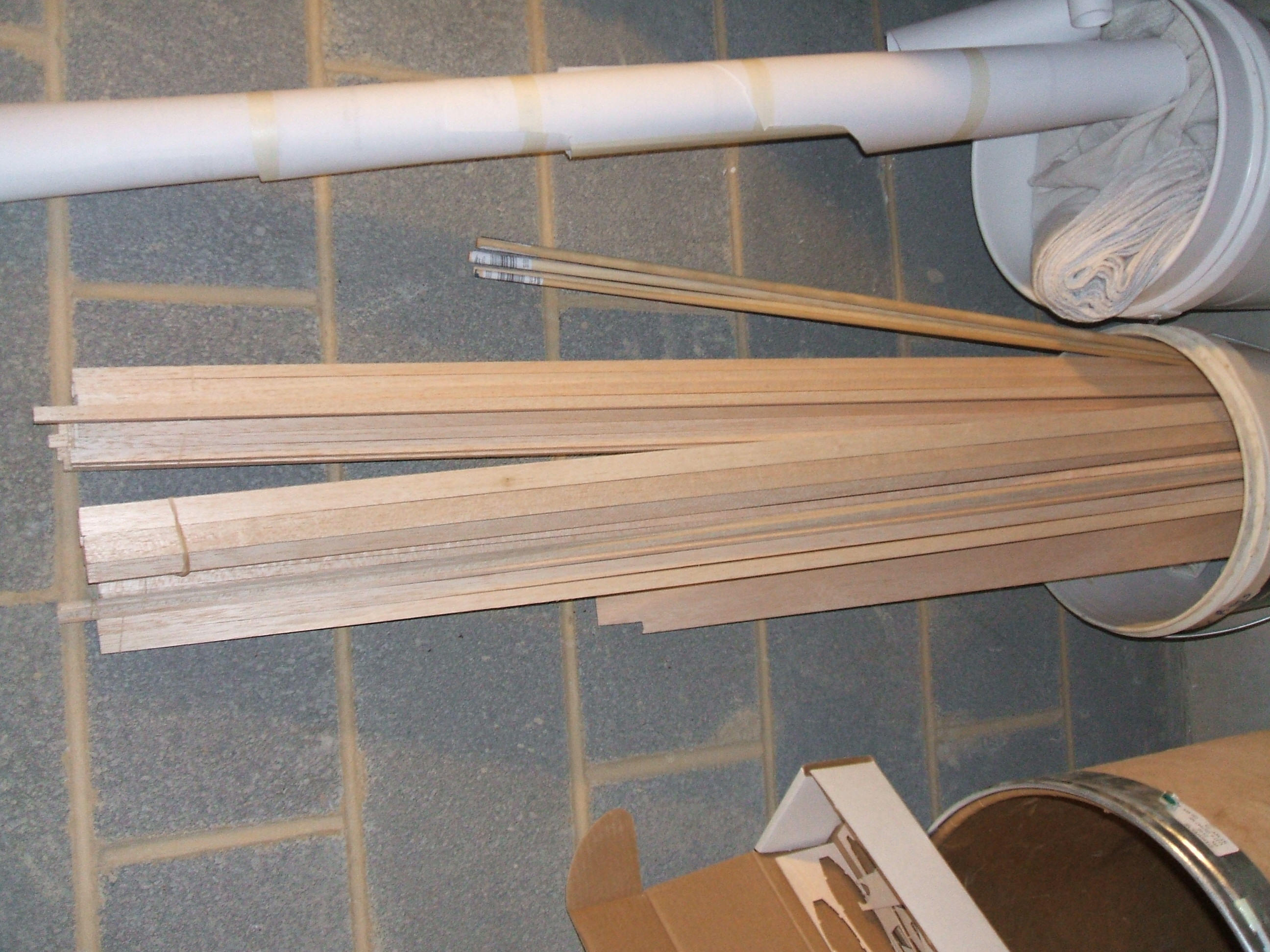

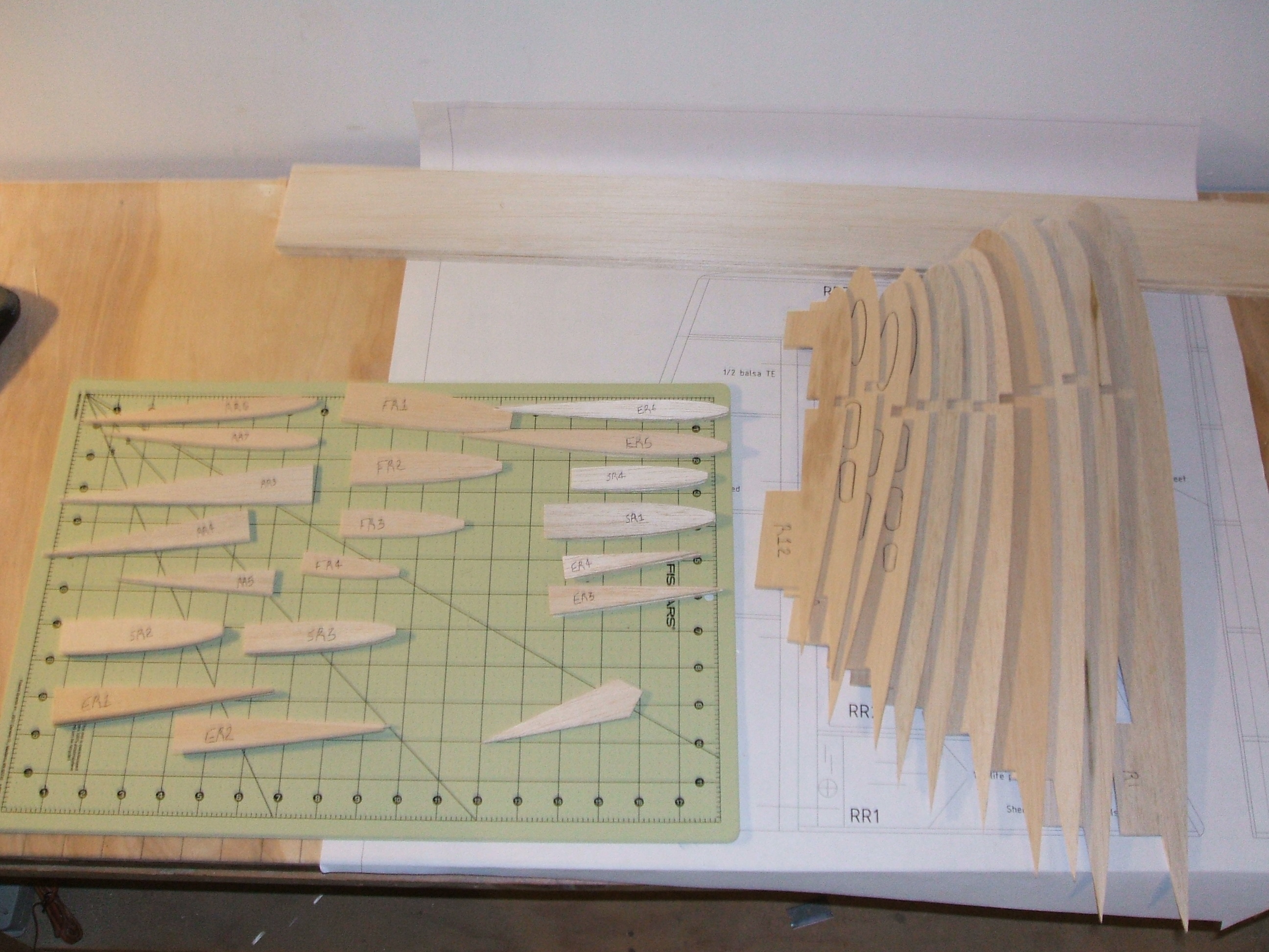

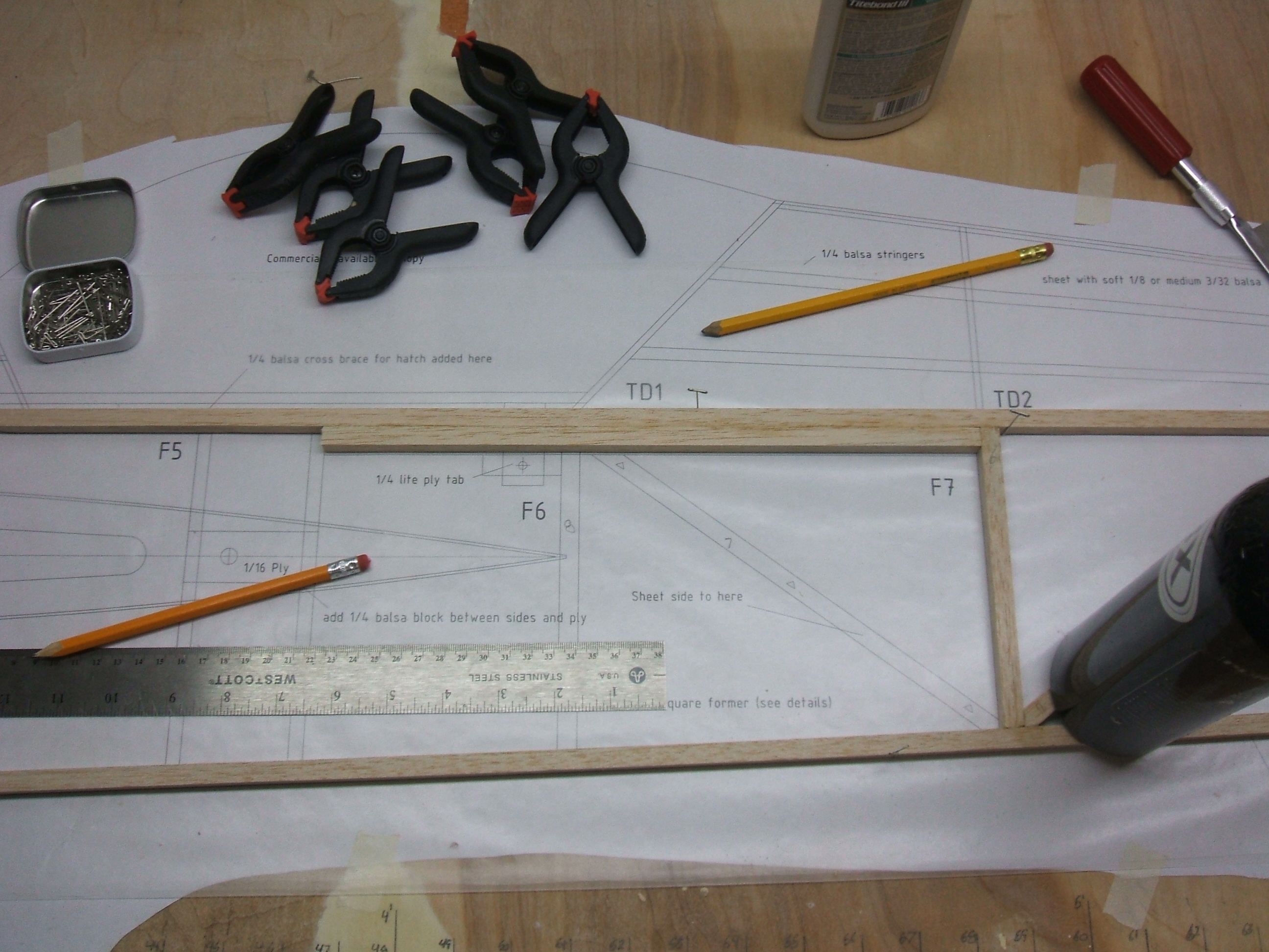

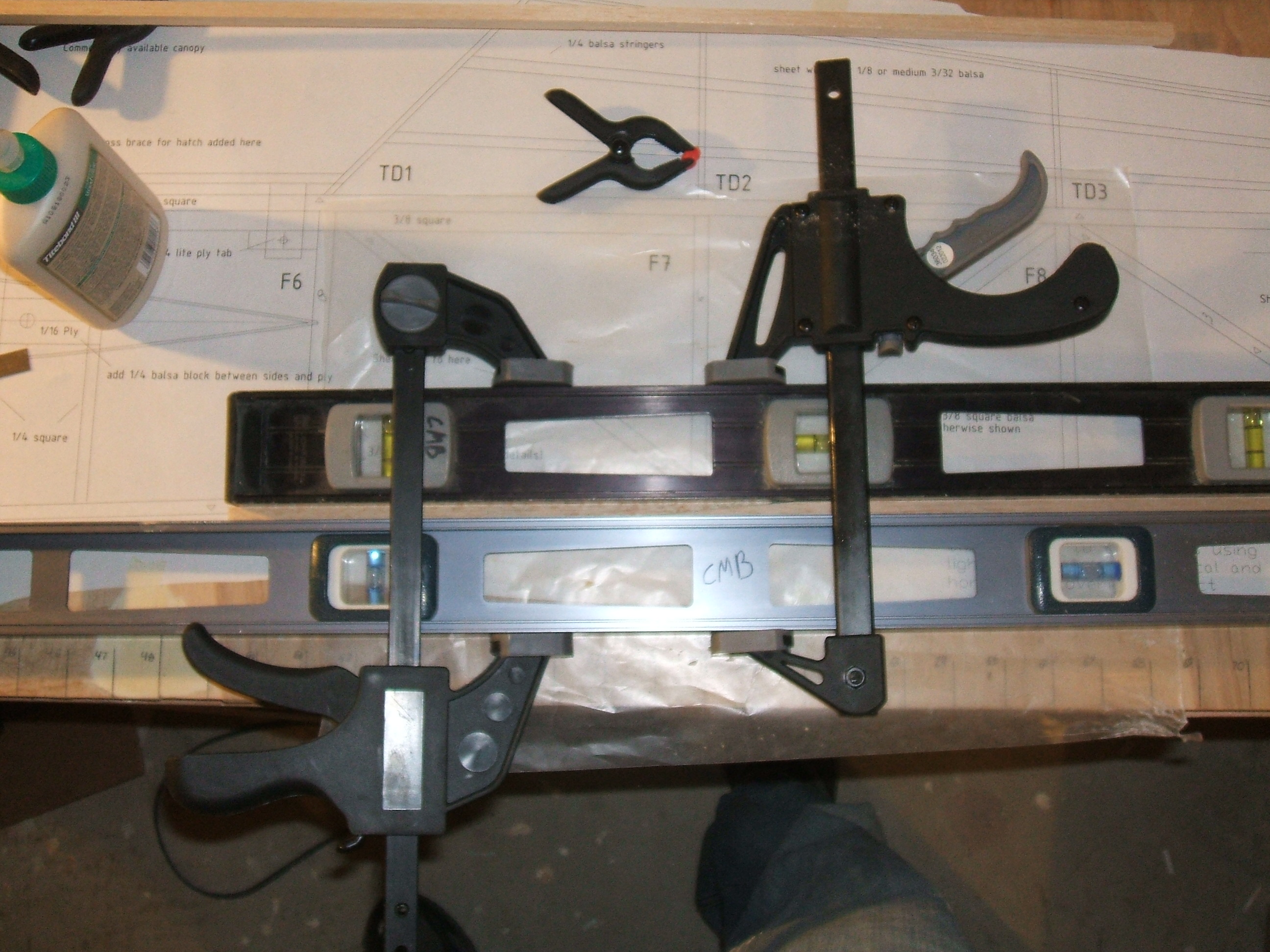

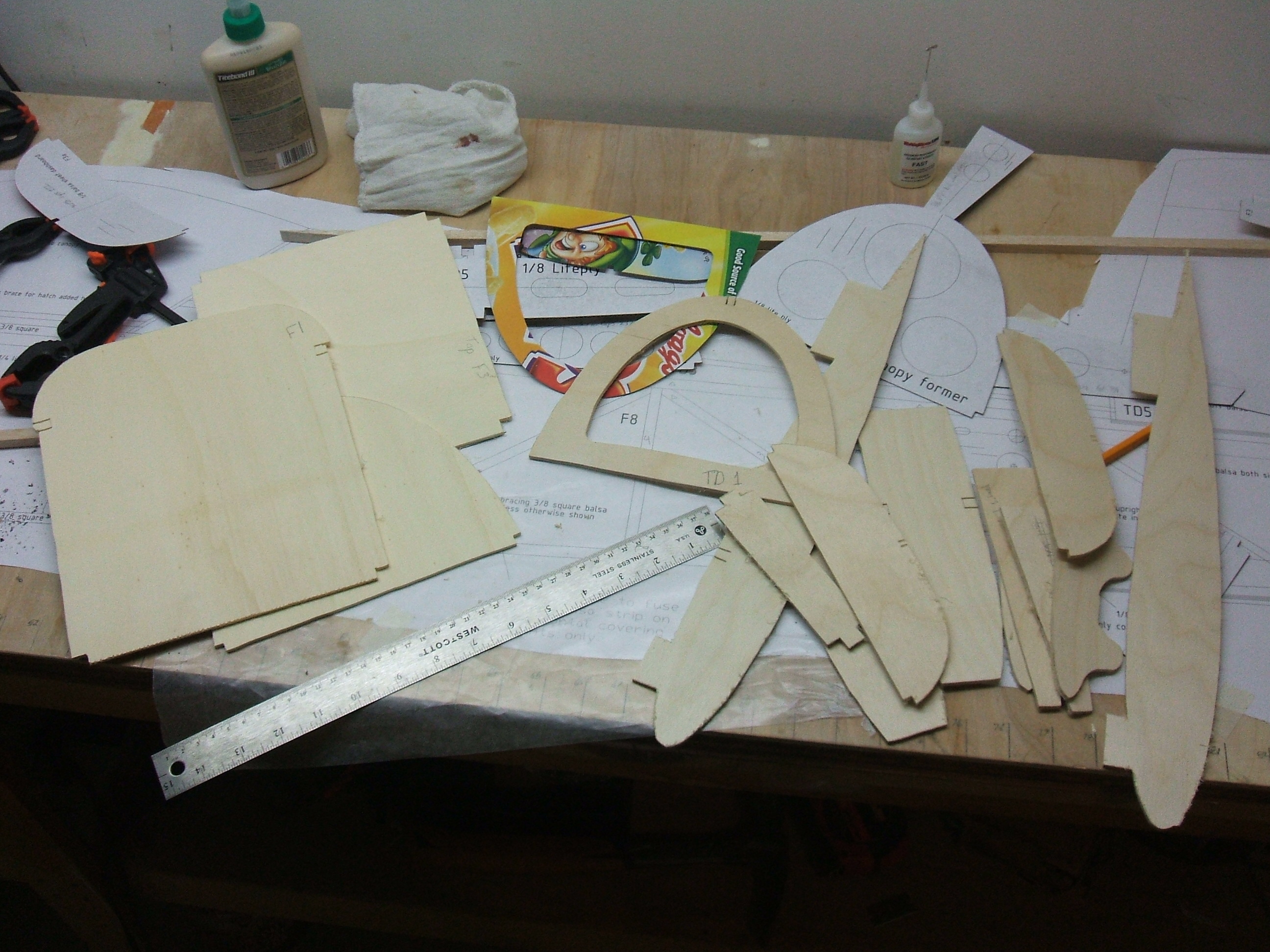

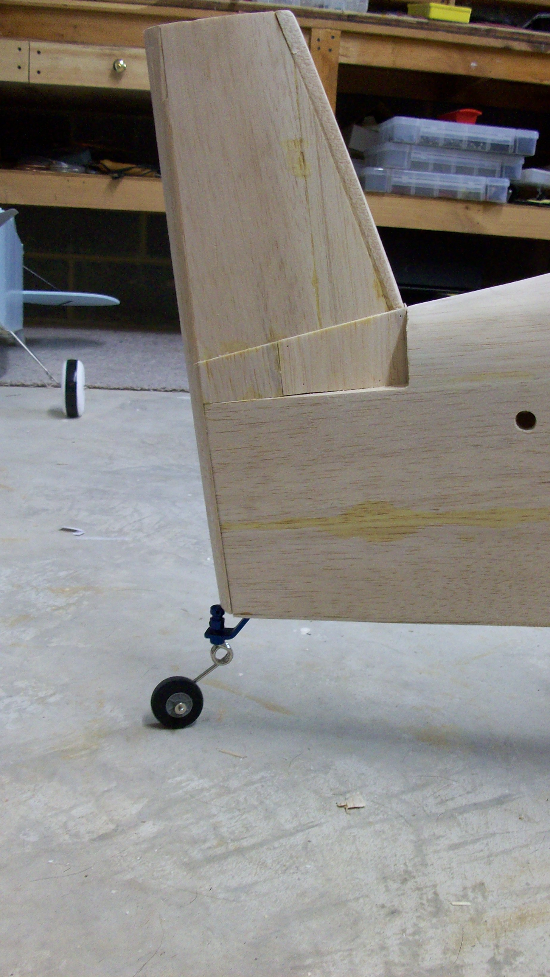

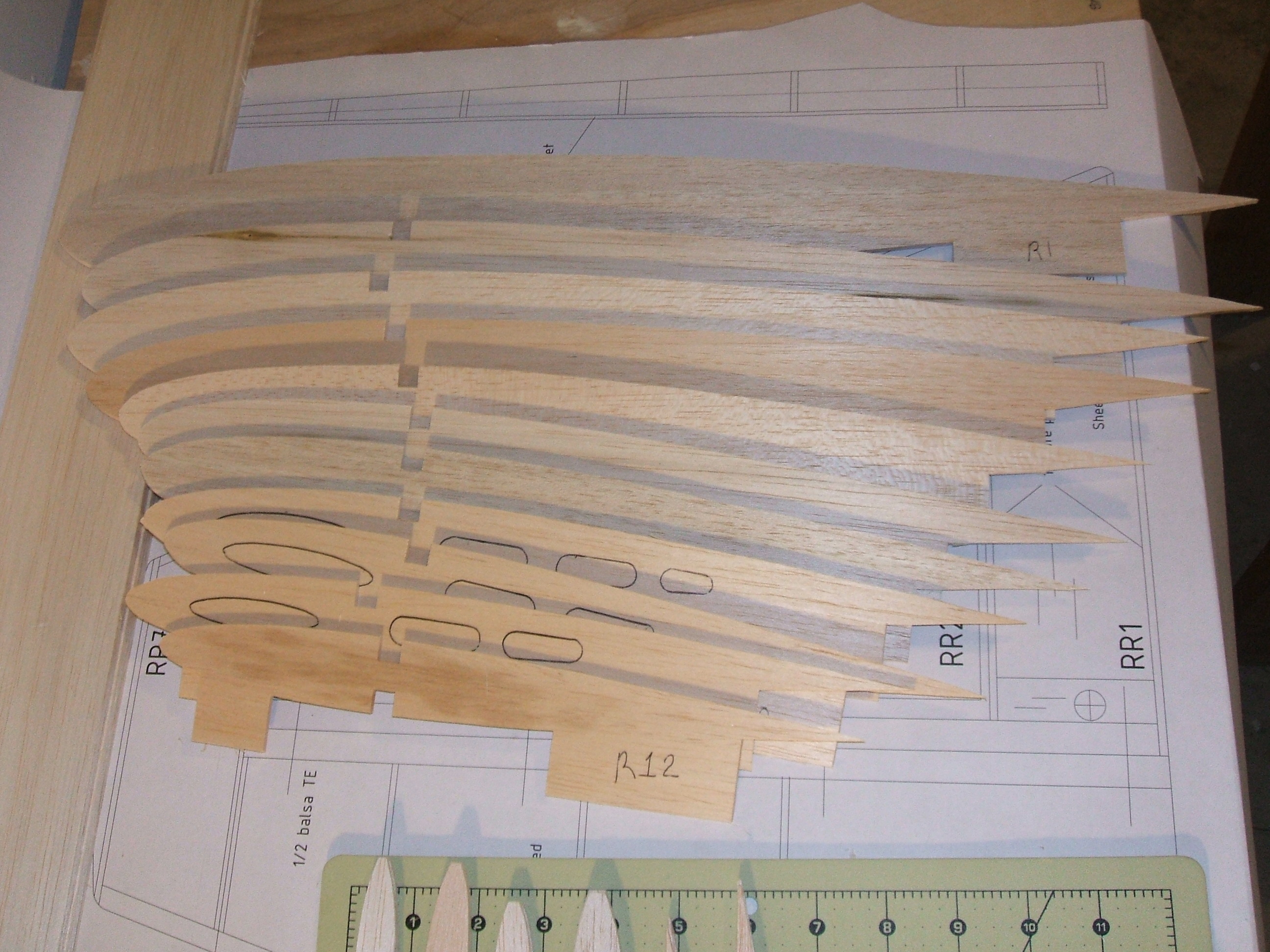

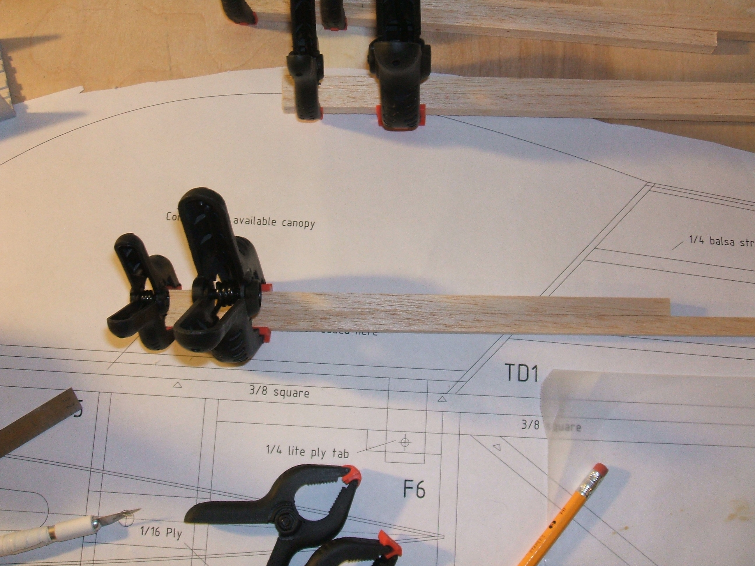

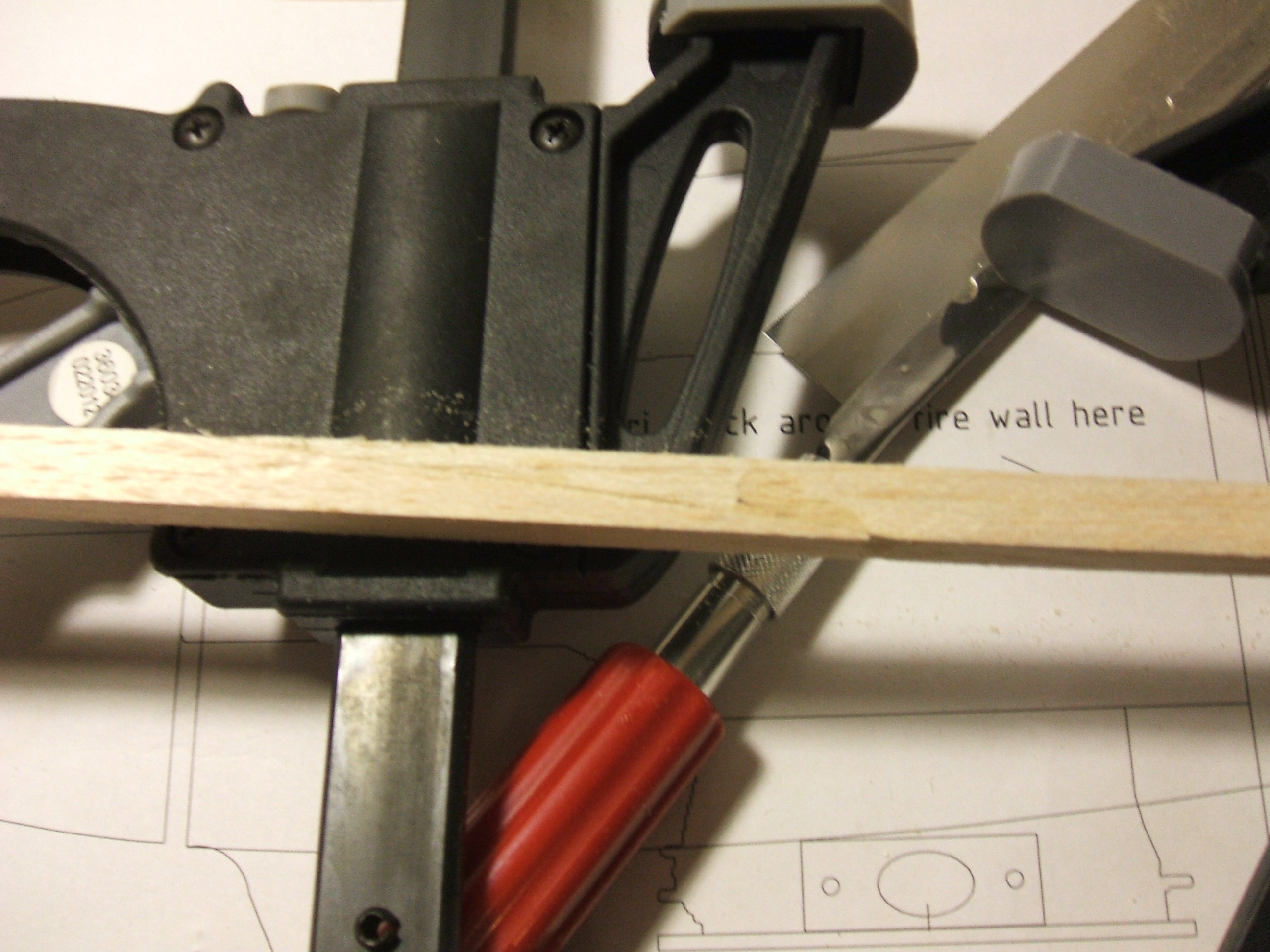

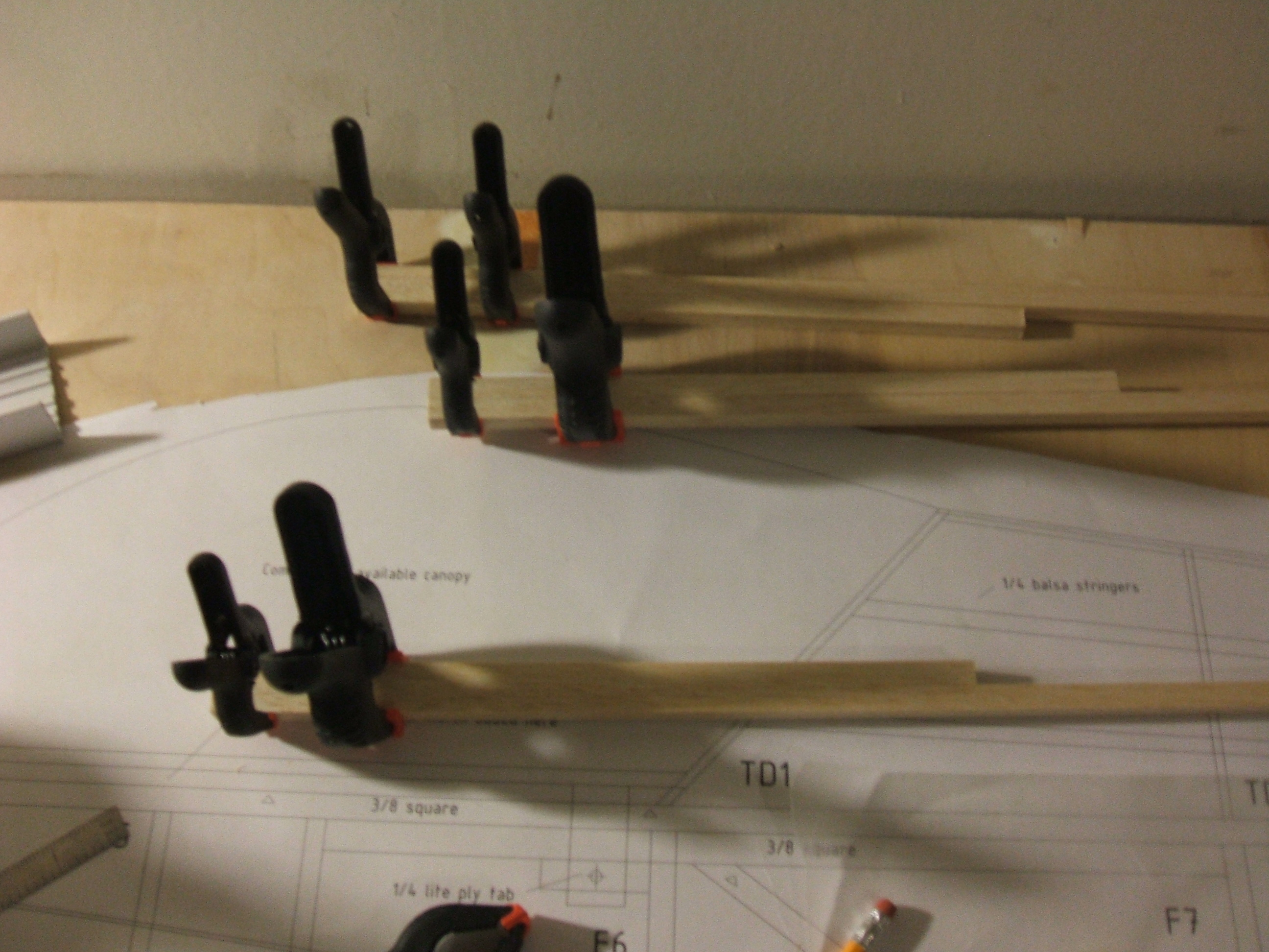

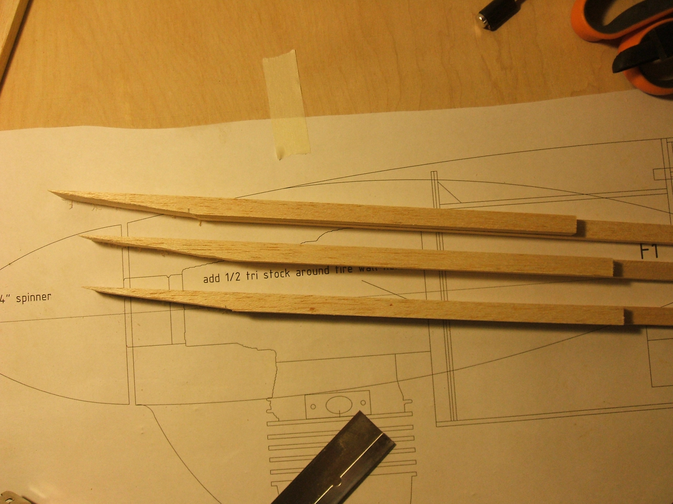

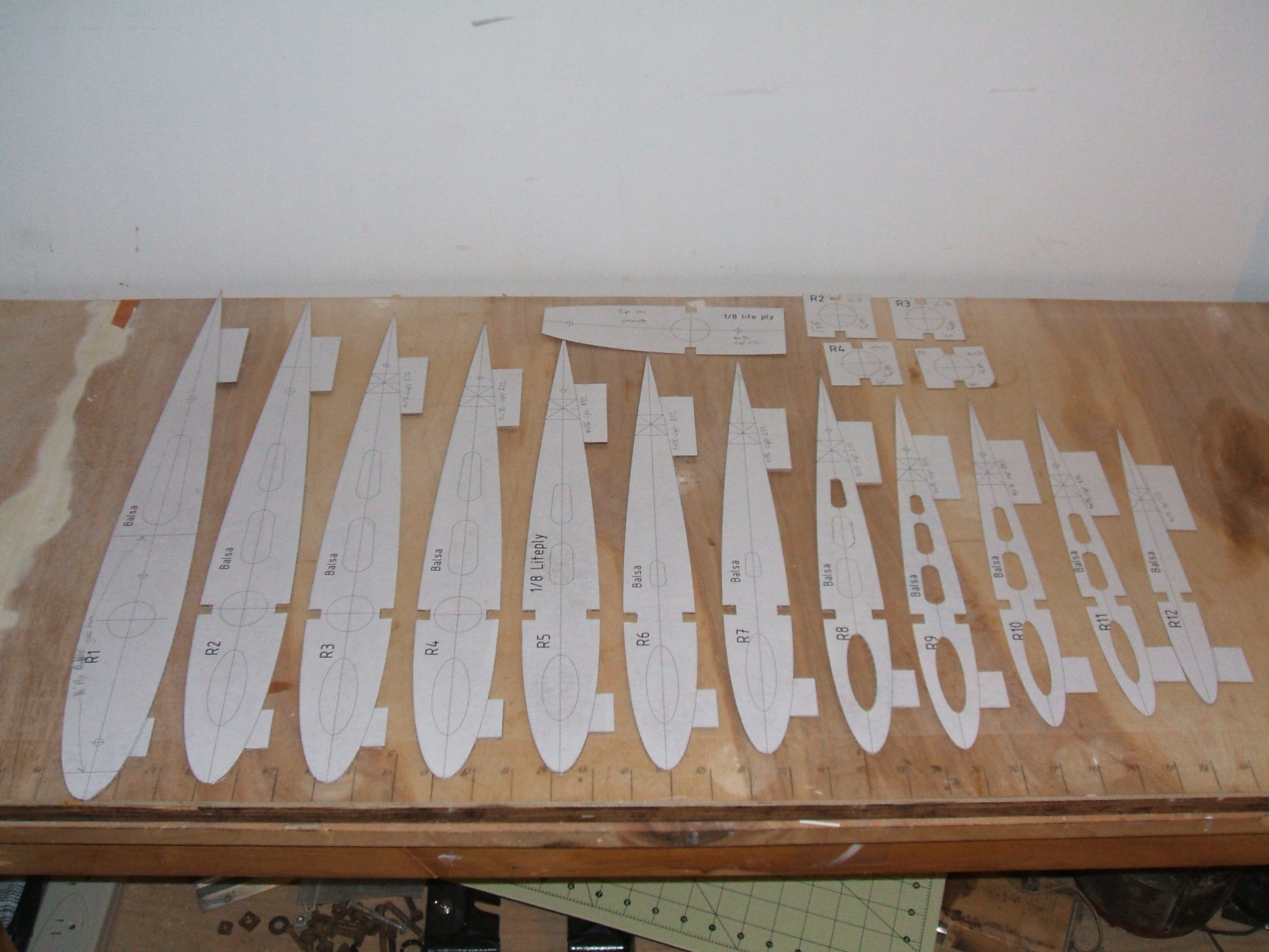

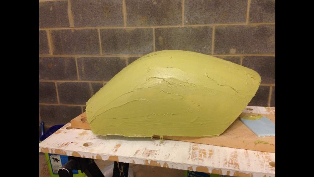

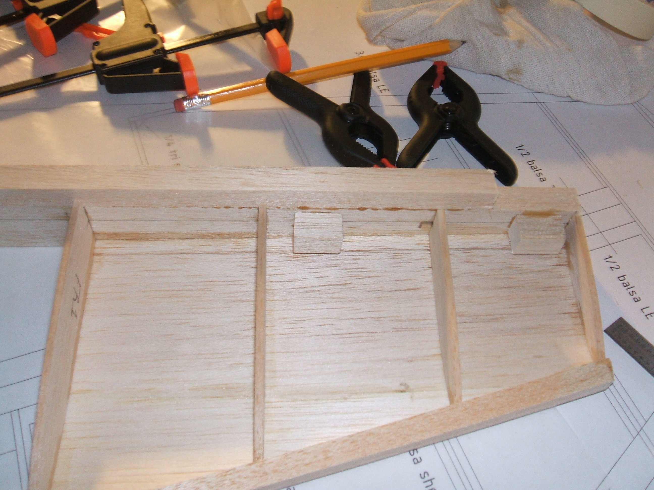

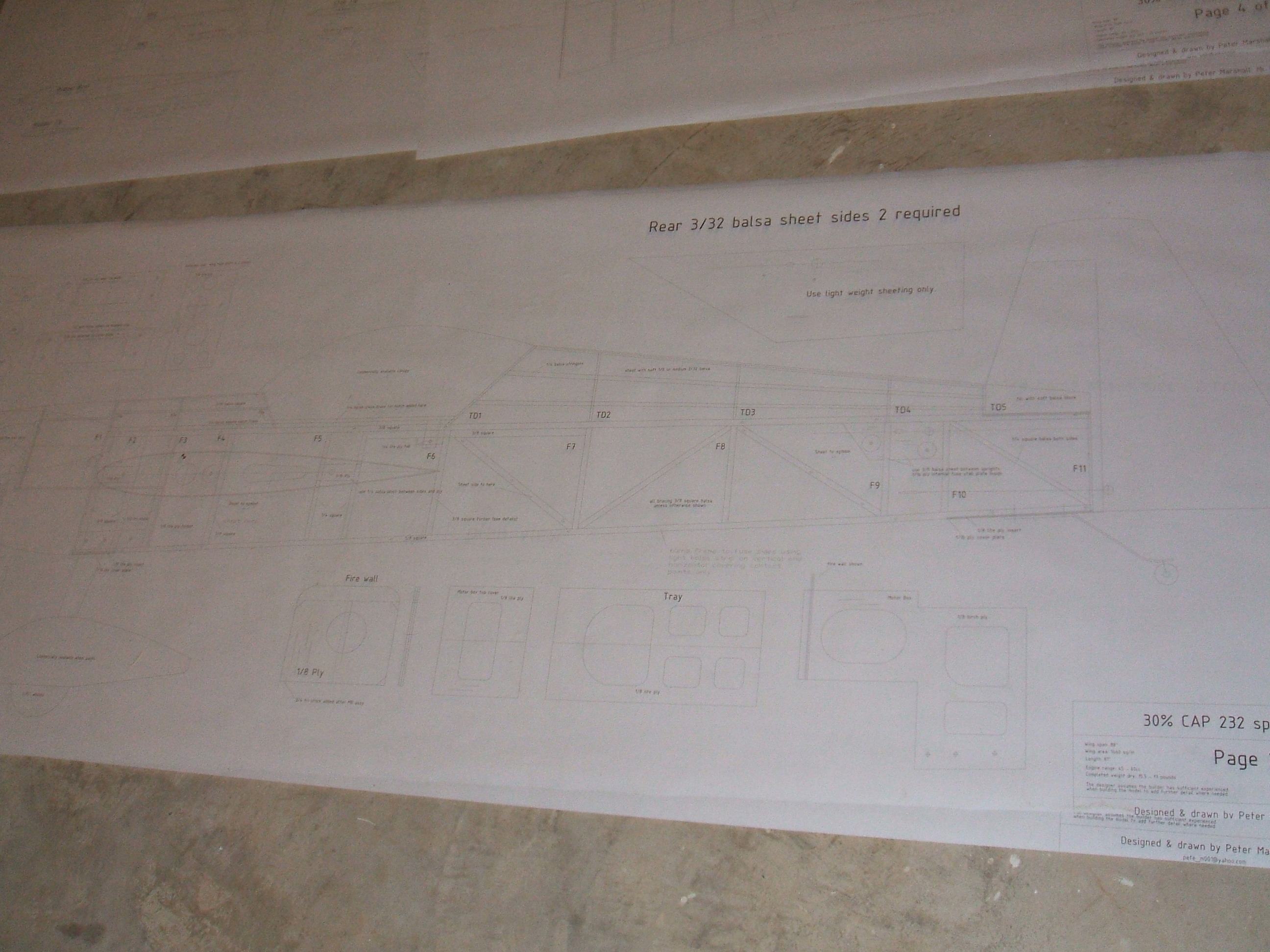

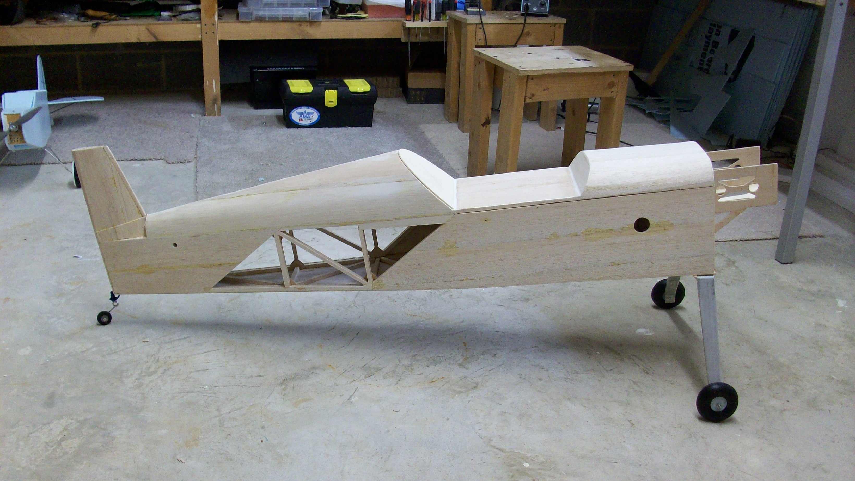

This is my 30% Cap 232 I have been working on for a couple years now. It will be powered by a DLE 55. Right now it is looking like it will come in around 17 pounds. Pretty much the only thing I have to do on it is finish making the plug for my cowl and pull some parts off of it. Then I can glue the canopy on finish the last couple of linkages and final balance.
