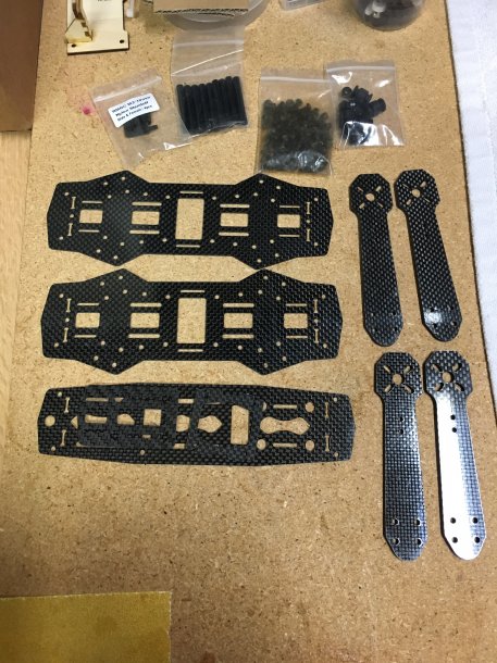

Sooo.... I've been itching to do a FPV 250 quad.. It will more than likely be strictly for messing around and flying for fun, I probably won't get into racing with it. (I said probably! )There are a ton of RTF available now but I'm wanting to piece one together picking my own components. I've started buying the parts already and kind of started some assembly today. I bought a ZMR 250 frame from readymaderc. I ordered an Overcraft PDB from team-legit RC. It's not here yet I thought it would be here today but according to tracking it won't be here until Saturday. There's a local quad parts shop that I went to yesterday, multirotormania and the guys helped me pick out a flight controller, motors, and props as well as an minimosd board. I figured I'd get the quad up and flying and then go back and add the FPV gear. Would anybody be interested in following along the build if I posted some info here? I'm kind of at a standstill until the PDB board gets here though.

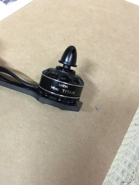

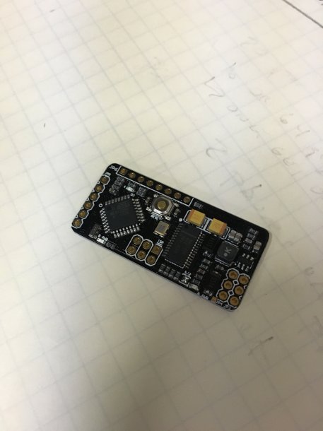

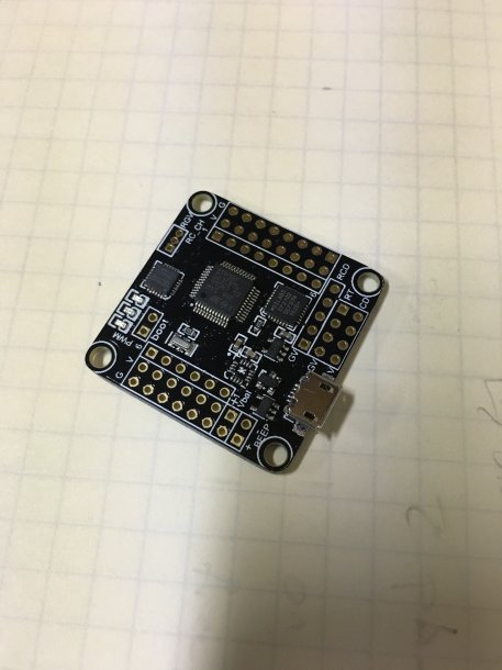

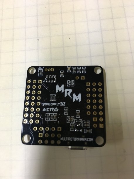

I'm running some MRM house brand stuff...
MRM Mini Titan 2204-2300 motors.
MRM MinimOSD
MRM Dragonfly 32 Flight Controller (Naze32)
I'll be running Cleanflight firmware in the FC.

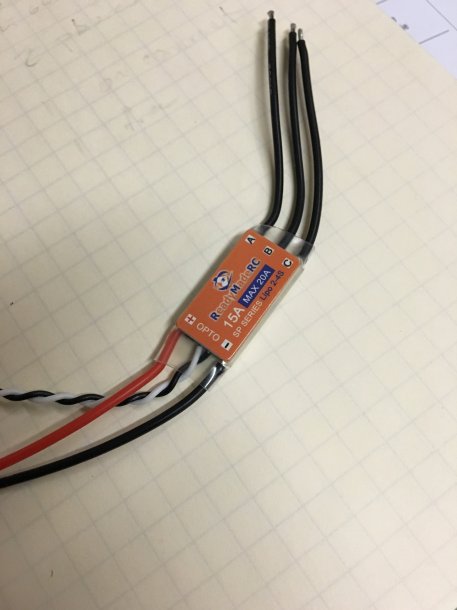

I'm also running some Readymade RC 15Amp ESC's. (should have got 20Amp to be 4s ready). These are running BLHeli firmware with Oneshot and Active Dampening.
These parts are Tiny!! This is also kind of out of the normal for me, I have 3 projects going on at once. I'm going to try to have this flying by the end of next week and then I'll be looking at getting the FPV gear for it.

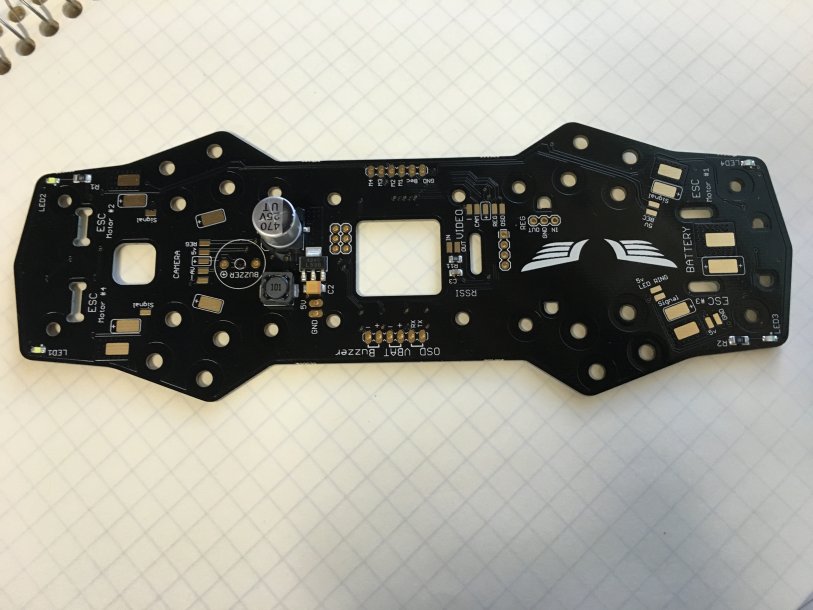

The Overcraft PDB showed up today, should make for a nice clean setup. Built in LED's in the front and back, on board 5v regulator, OSD support, pretty nice board.

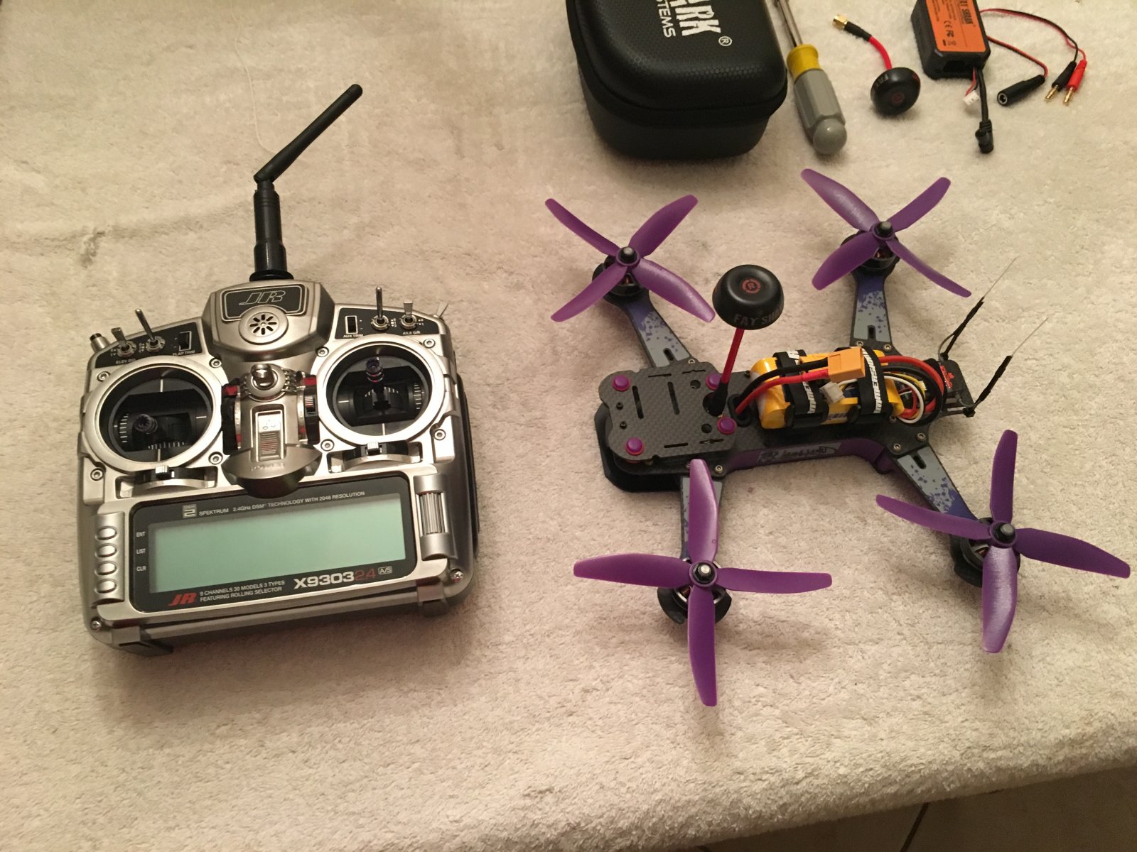

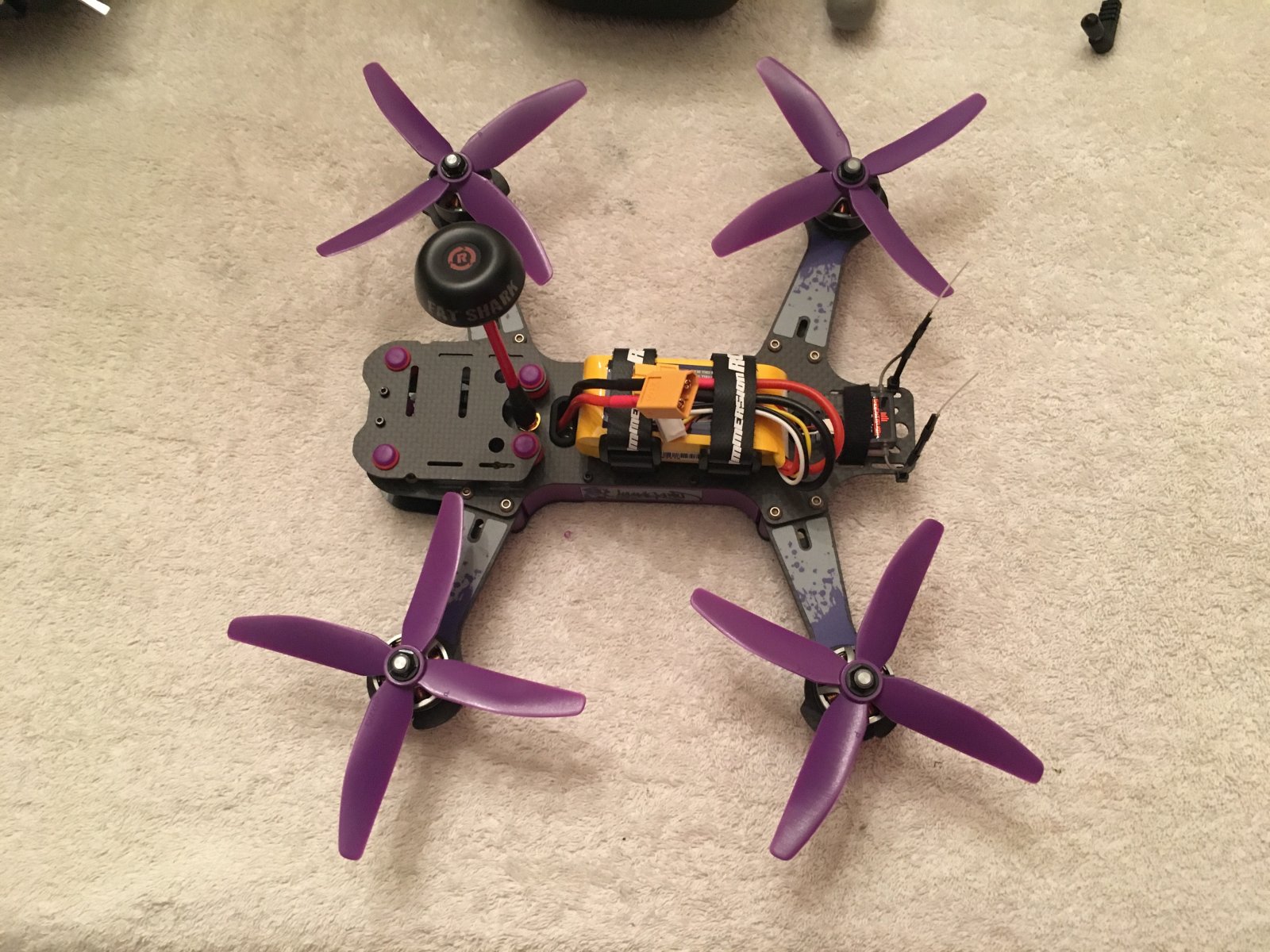

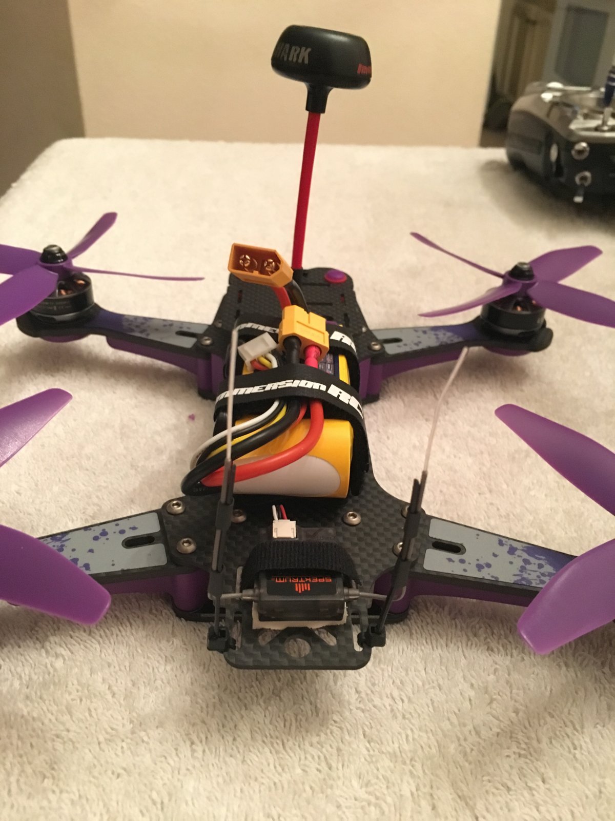

I still have this project and have started working on it again. Buuuutttt I was telling a guy at work about these and I got his kids into RC. They built a couple and got them flying so I decided to go the quick route.. I bought a Immersionrc Vortex 250 Pro Ummagawd edition with a set of Fatshark Dominator SE goggles. I figured why not just go all in... the Vortex even if you aren't into quads or FPV or any of it are still a pretty amazing product. The build quality is very impressive and list of features and customizeability... well like it or not, it's the pennical of technology in the RC industry right now. New products and updates to existing products are released almost daily. Don't like the way it flys? Plug your laptop in and adjust until your hearts content. Although the vortex comes with "pro-tunes" which are tunes setup by pro flyers you can just load into your vortex and instantly have yours setup like theirs. The thing flys pretty damn good right out of the box.
Anyway here's a couple pics of my setup, it takes a few flights to get used to FPV but is sure is fun and refreshing to do something different with RC. Interestingly enough, I thought after buying the ready to fly Vortex I wouldn't be interested in finishing my built up quad but now I seem more motivated to finish it.. so back to the front of the line for this project.

The zmr is a good first build and should give you plenty of enjoyment-- make sure when you are soldering you have a good iron and some flux does help.. figure out what pins you need and try to only install them to keep it smaller and cleaner. Also some liquid tape from Walmart is good to cover the exposed solder pads..I have gotten away from using the integrated PDB that is the full size of the frame as after a few good crashes I was having traces in the board break and cause issues.. I use the smaller PDB boards now that will fit into a stack with the flight controller. Also good video filter is a must if you go to higher amp setups and start using the features of BLheli such as dampen light..Also recommend using the lemon diversity satellites with the longer antennas over the spectrum ones.. Readymade is a great vendor They were good enough to send our group a set of gates a few months ago! I really didn't think I would like building my own but after 3-4 builds and figuring out BLHeli programming and cleanflight and going out and hitting 100mph on the first flight with no further adjustments needed was a huge rush!
