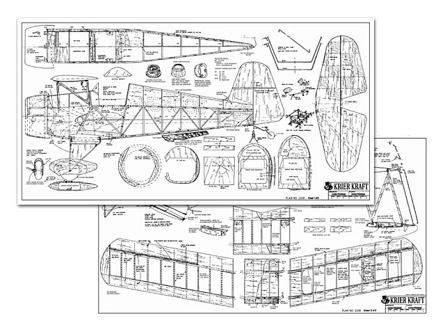

Have a look at these, maybe be a little help.
Bipeguy03
Yep, I have a set of those. Matter of fact I had my tips drawn to match the Whitehead plans until my dad saw them lol, he said and I quote "I may not remember all the details but his wingtips didn't look like that" lol. And because I'm trying to match grampa, I changed them ;)

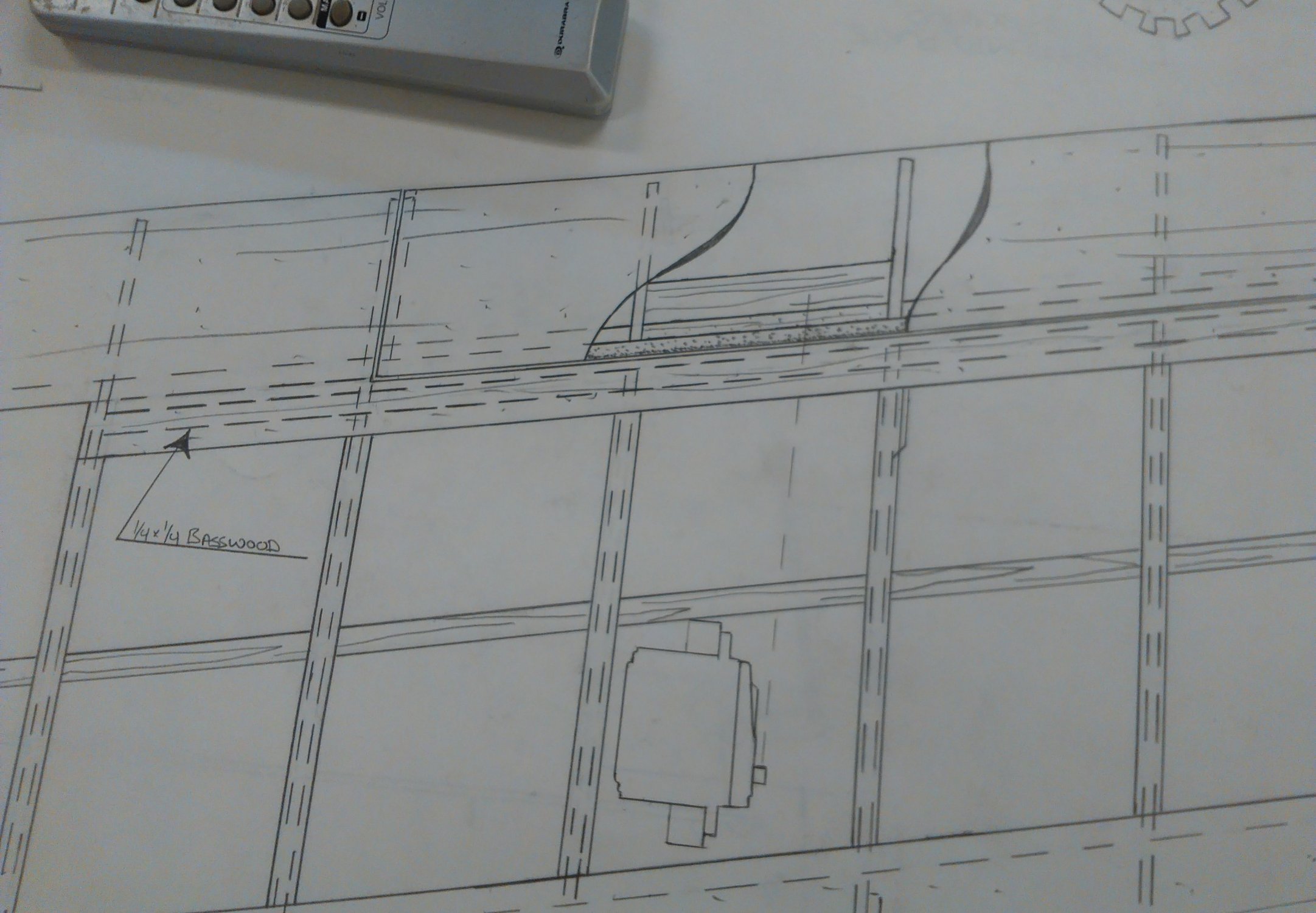

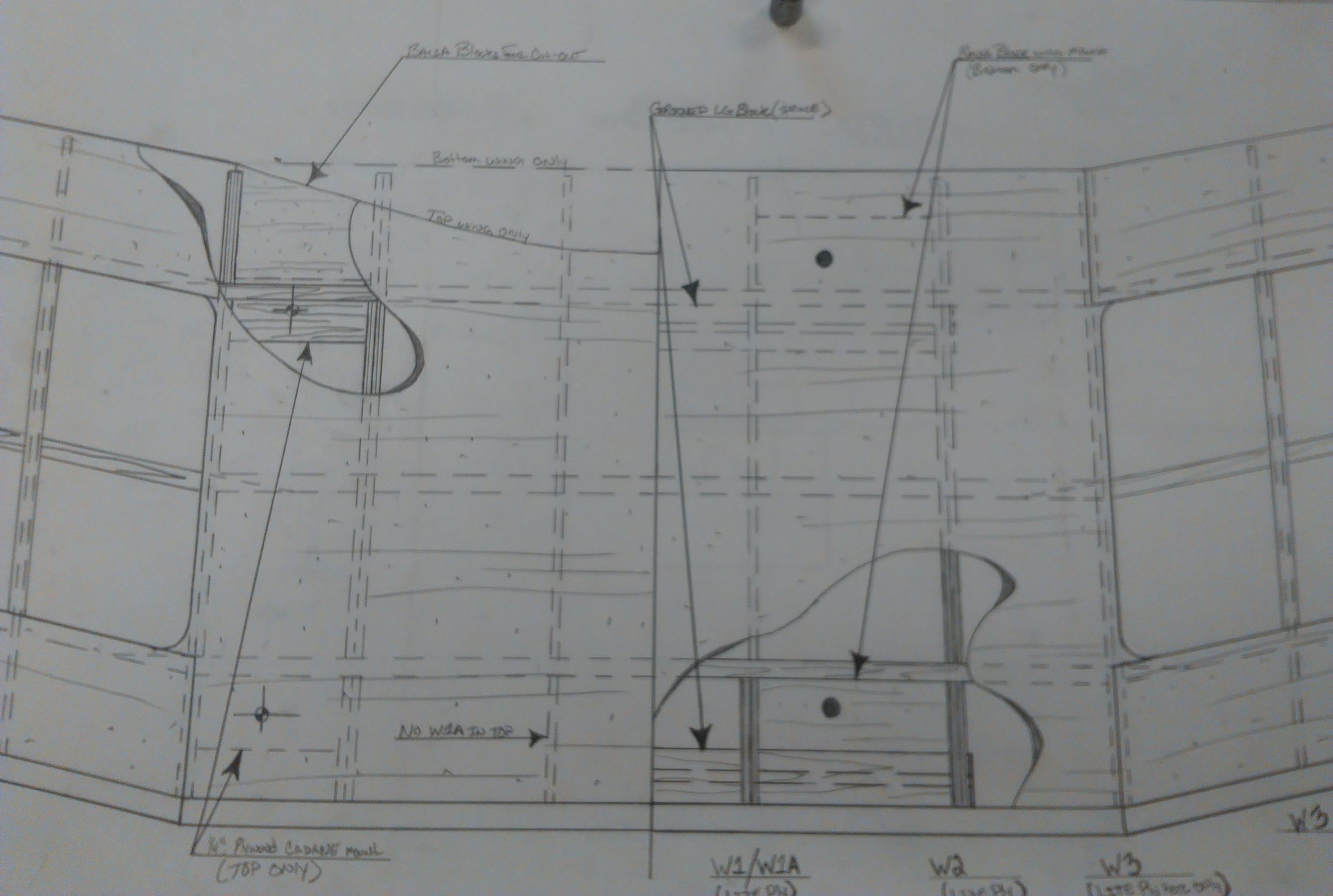

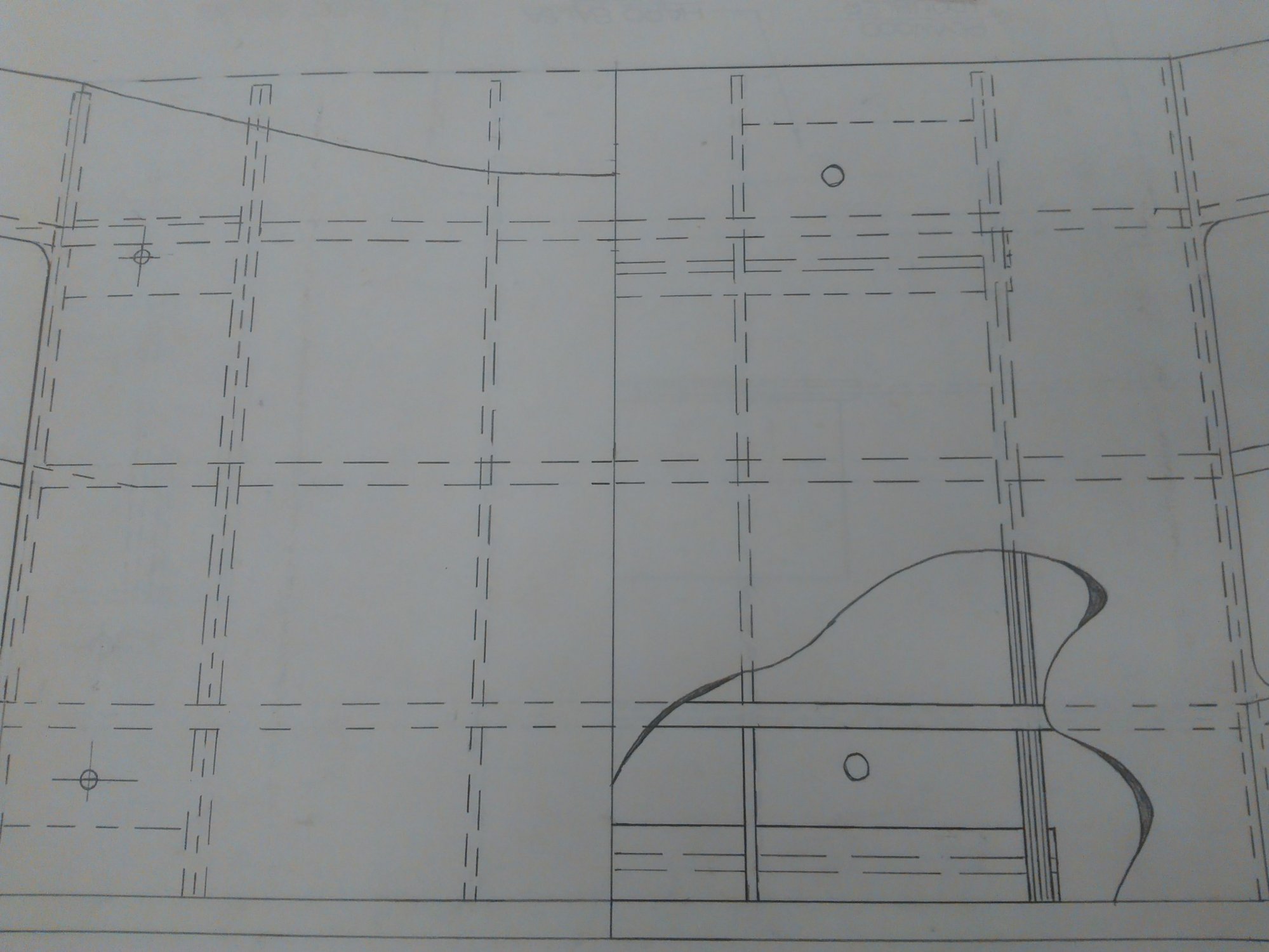

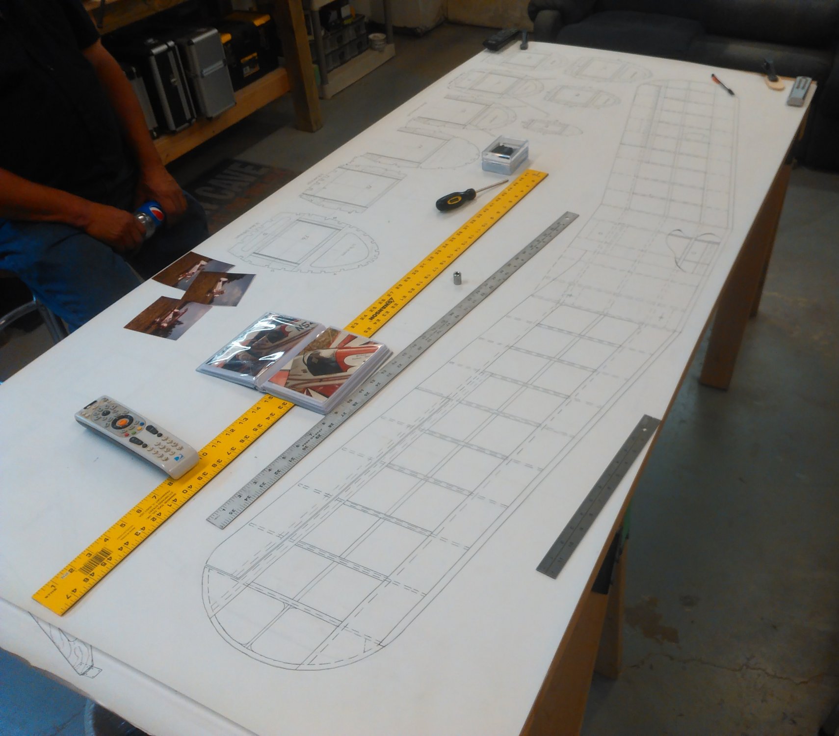

Been feeling a little under the weather this weekend so I didn't get to fly much or work on my Krier plans anywhere near as much as I wanted to but I was feeling a little better after lunch today so I got to drawing in some detail on the wings before the Cavs game starts this evening.
Drew in some cut-away areas to help keep the all the different lines going on in the center section from getting confusing. And because that's what the professional designers do ;)

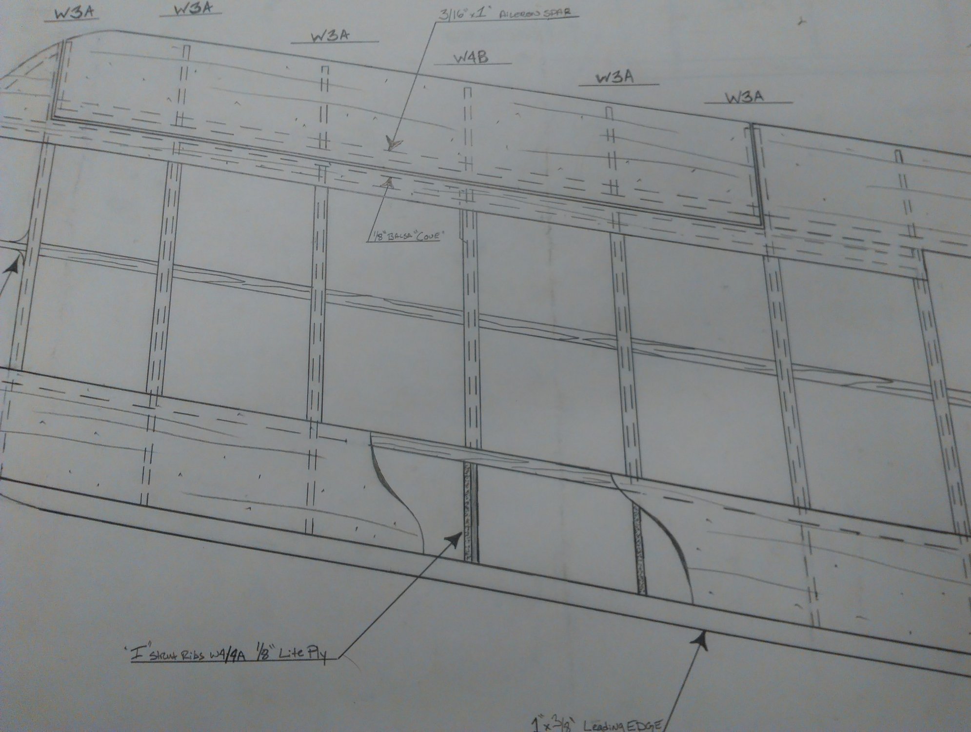

W4 is the rib that the inner plane stuts (N struts) will mount, so I am doubling it up and making it out of 1/8" lite ply.
Servo in the bottom wing is going to be mounted on it's side to a removable ply plate.
Ready to draw out some rib detail, and "N" struts. Then on to designing the horizontal stab and elevators. Also while I've been sitting around feeling sick, I've been pricing balsa and basswood. Seems like it is pretty much a wash between National Balsa and Sig. I'm leaning toward getting it from Sig because well, it's Sig and that's were Grampa would have bought it. lol
