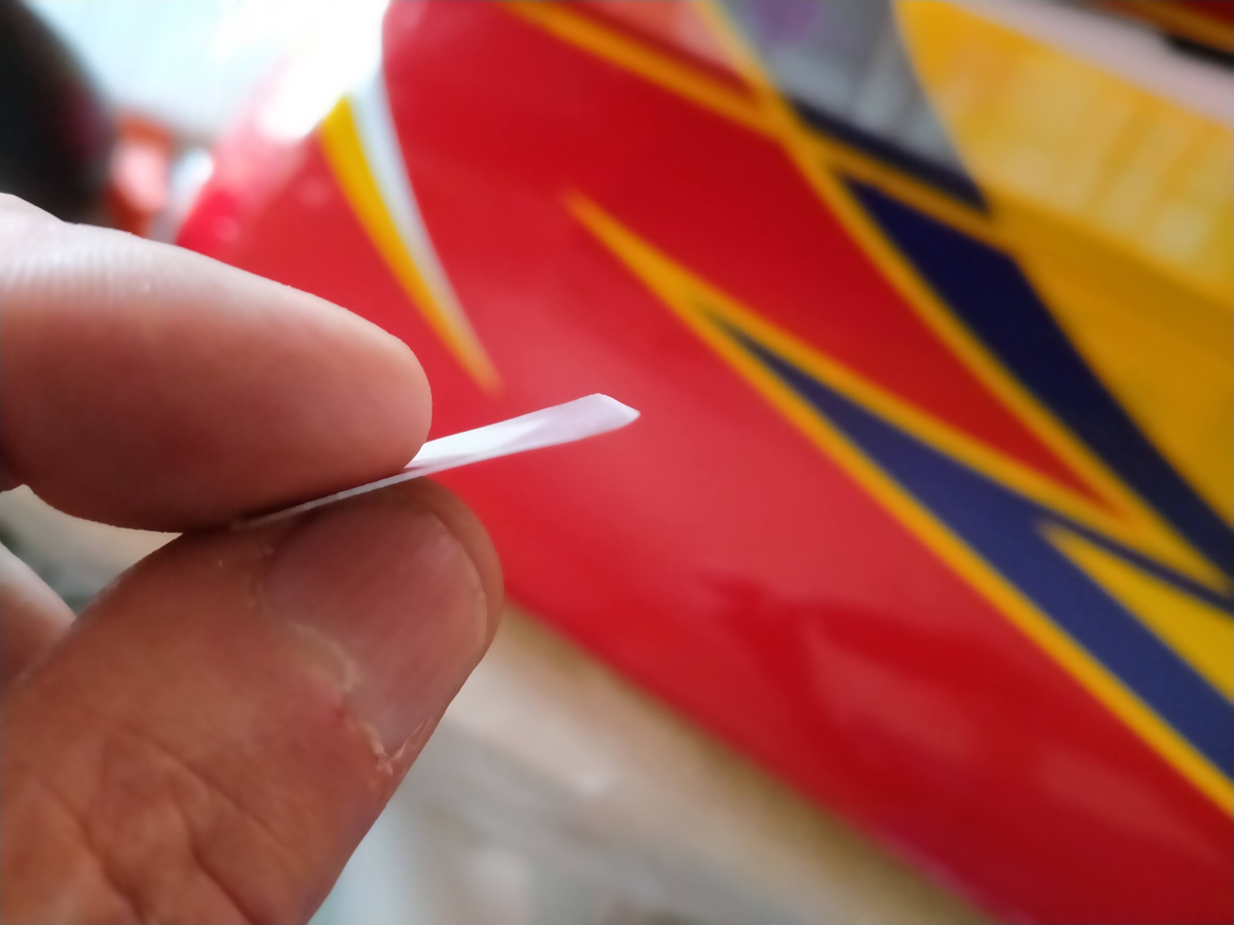

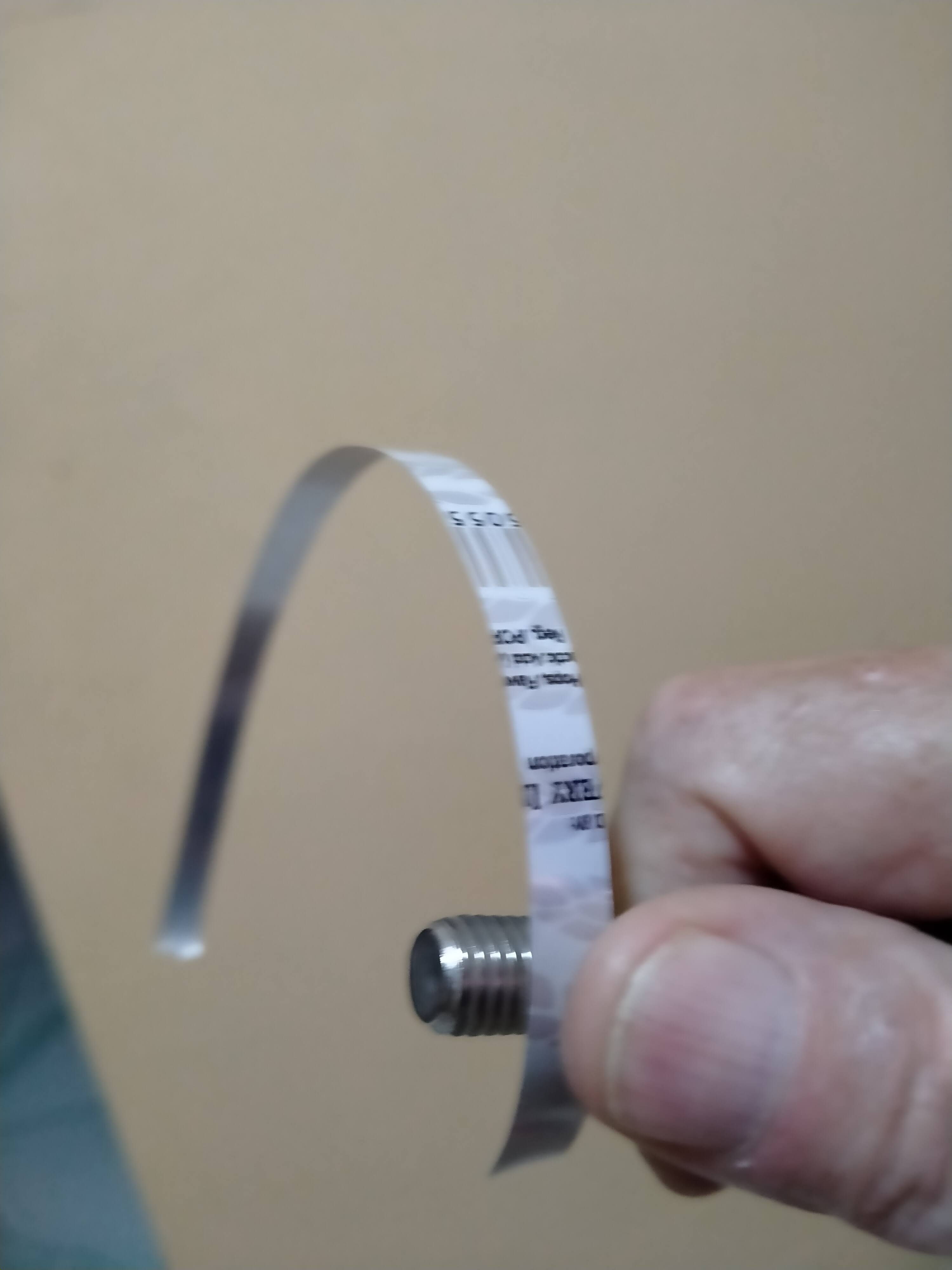

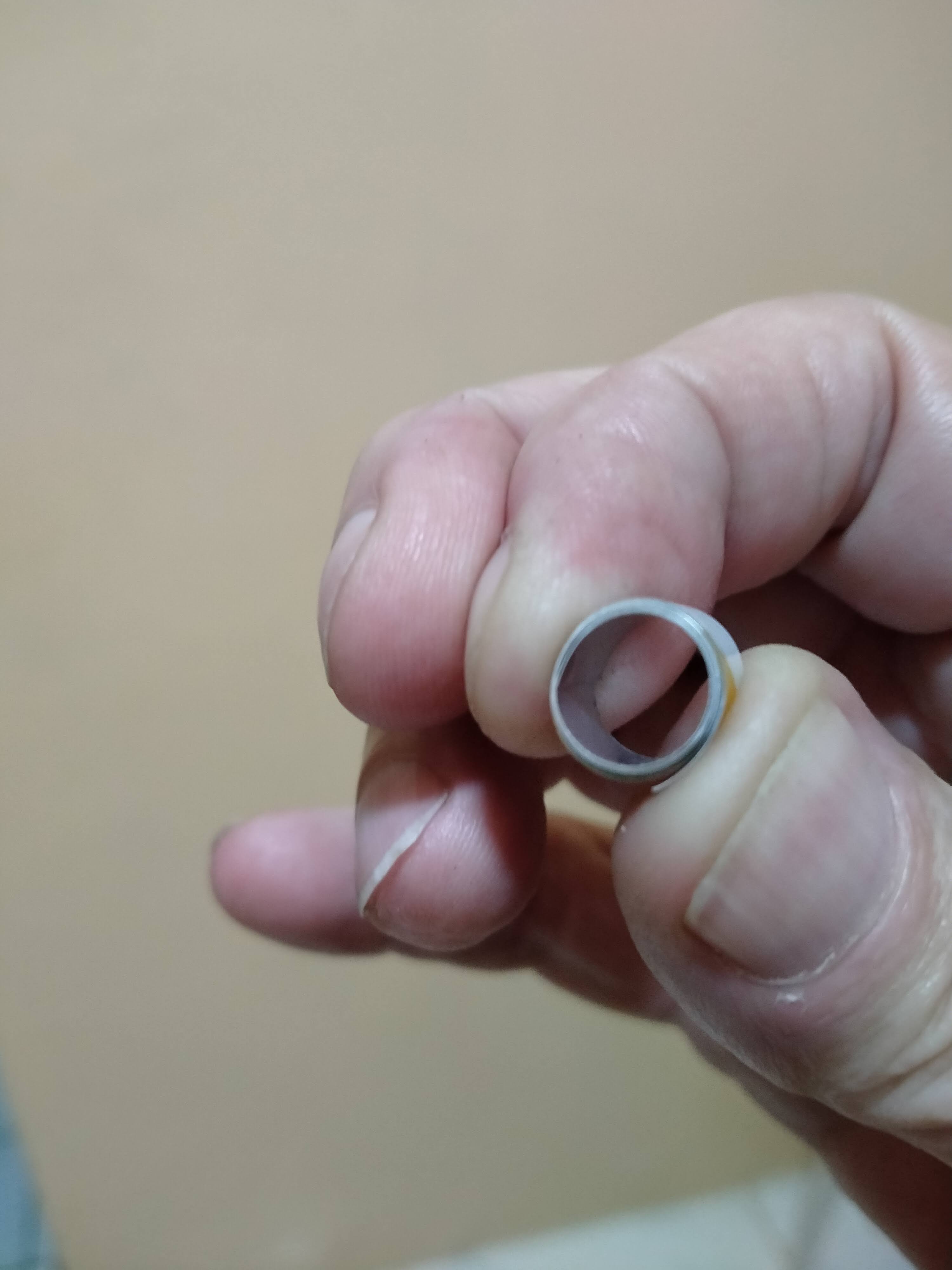

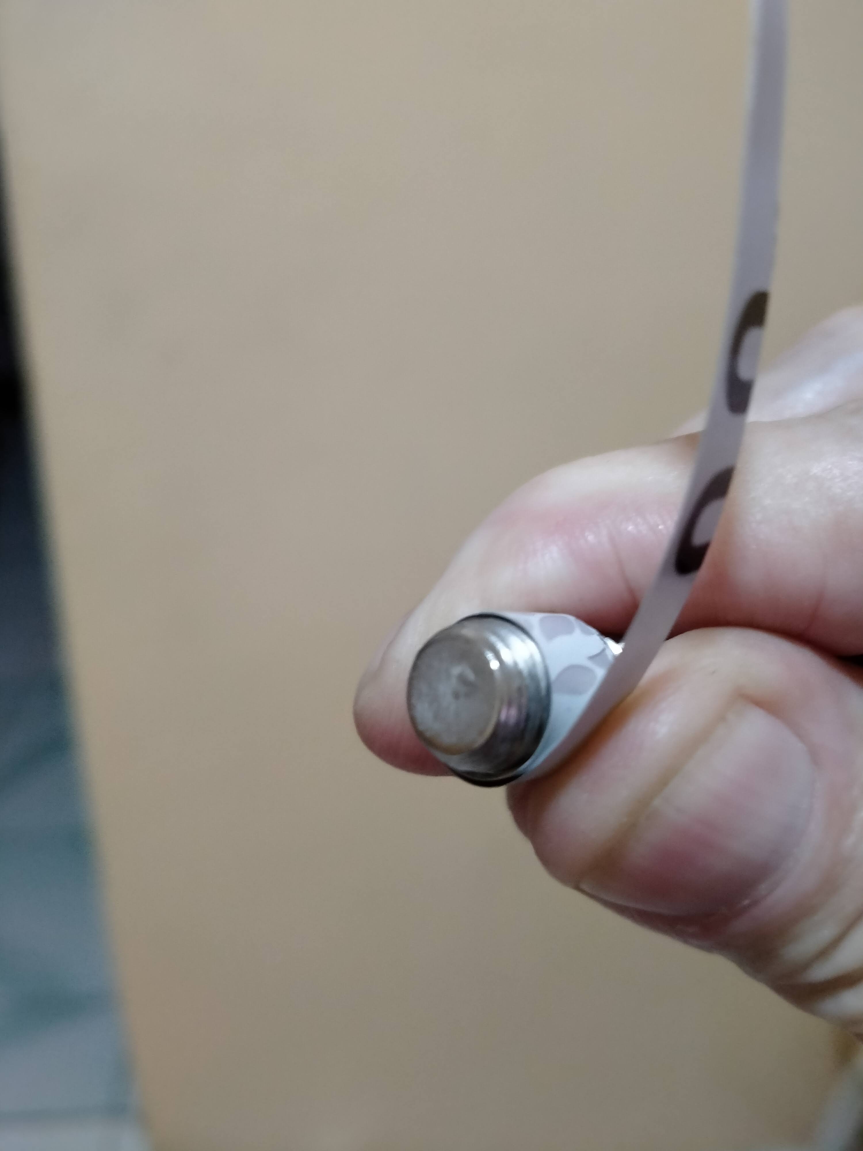

    Can you explain the aluminum shim I do not understand how it was used.?
  2. 3 pics are worth 1,000 words :) coil the aluminum strip around the bolt, remove, hold it in your fingers, tighten it so it becomes compressed insert in the 10mm hole in gear (plus in my case the strap), let it uncoil, insert bolt and tighten, helps to leave it slightly proud so it is forced to expand as you tighten the bolts.

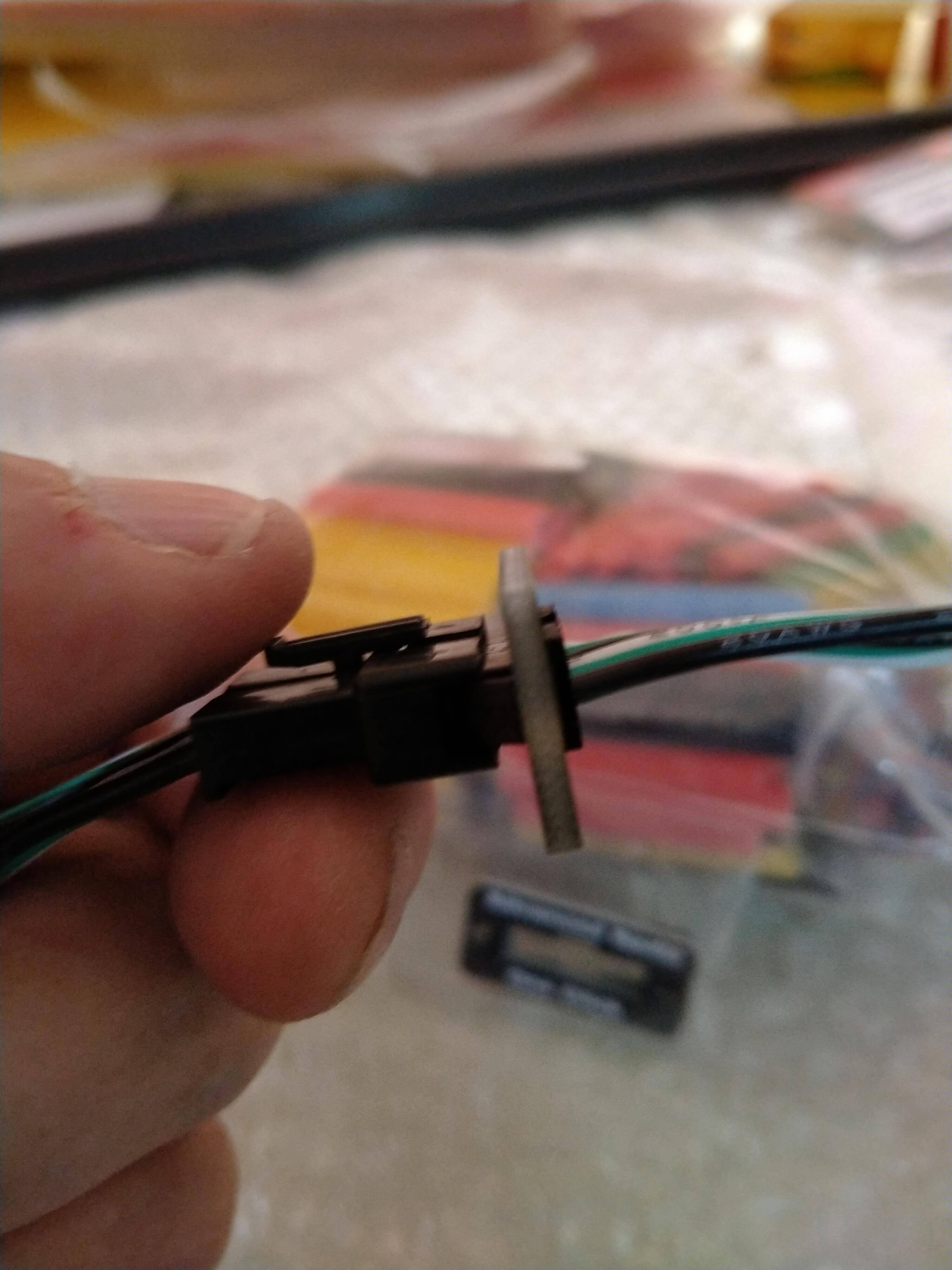

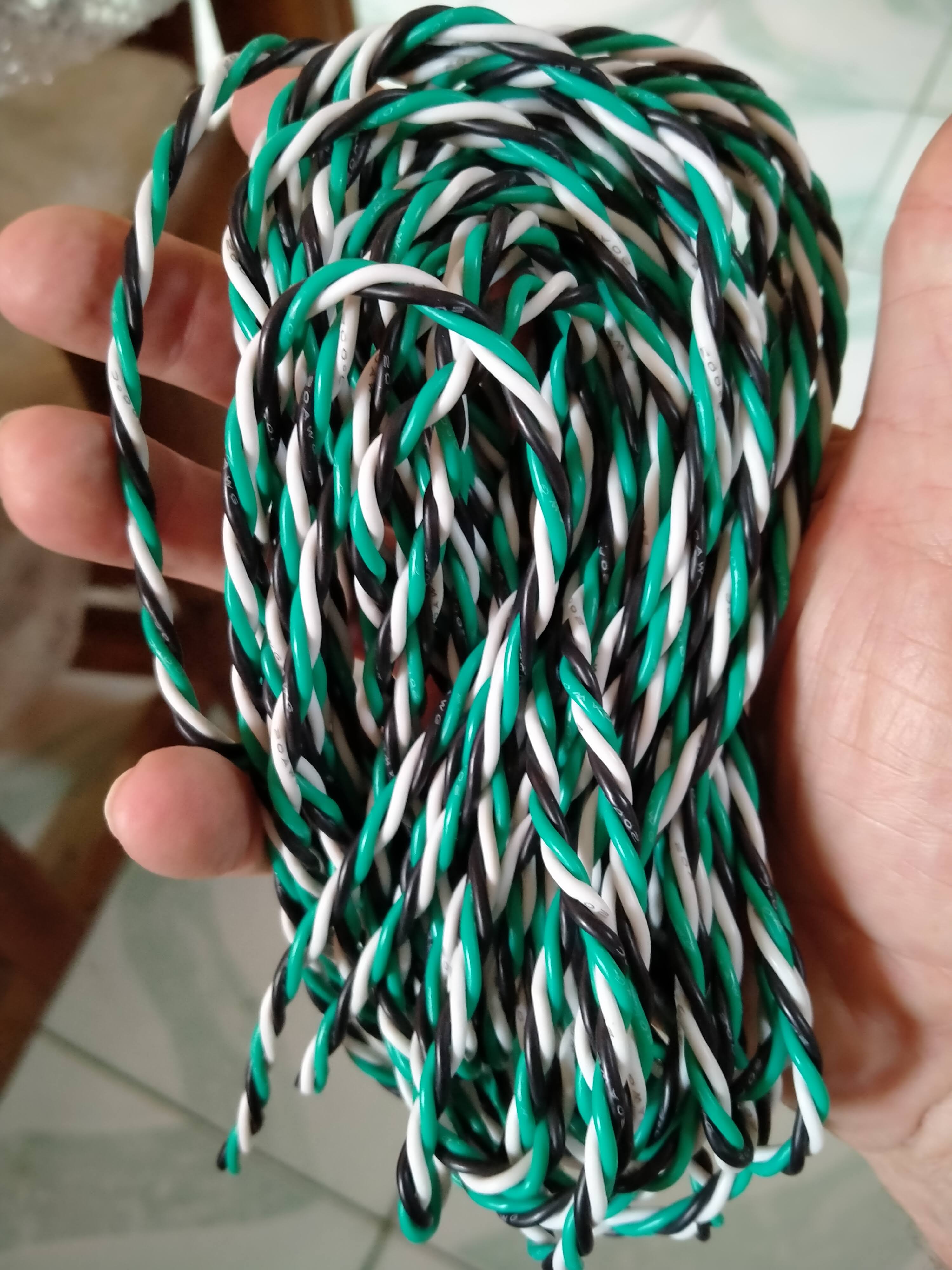

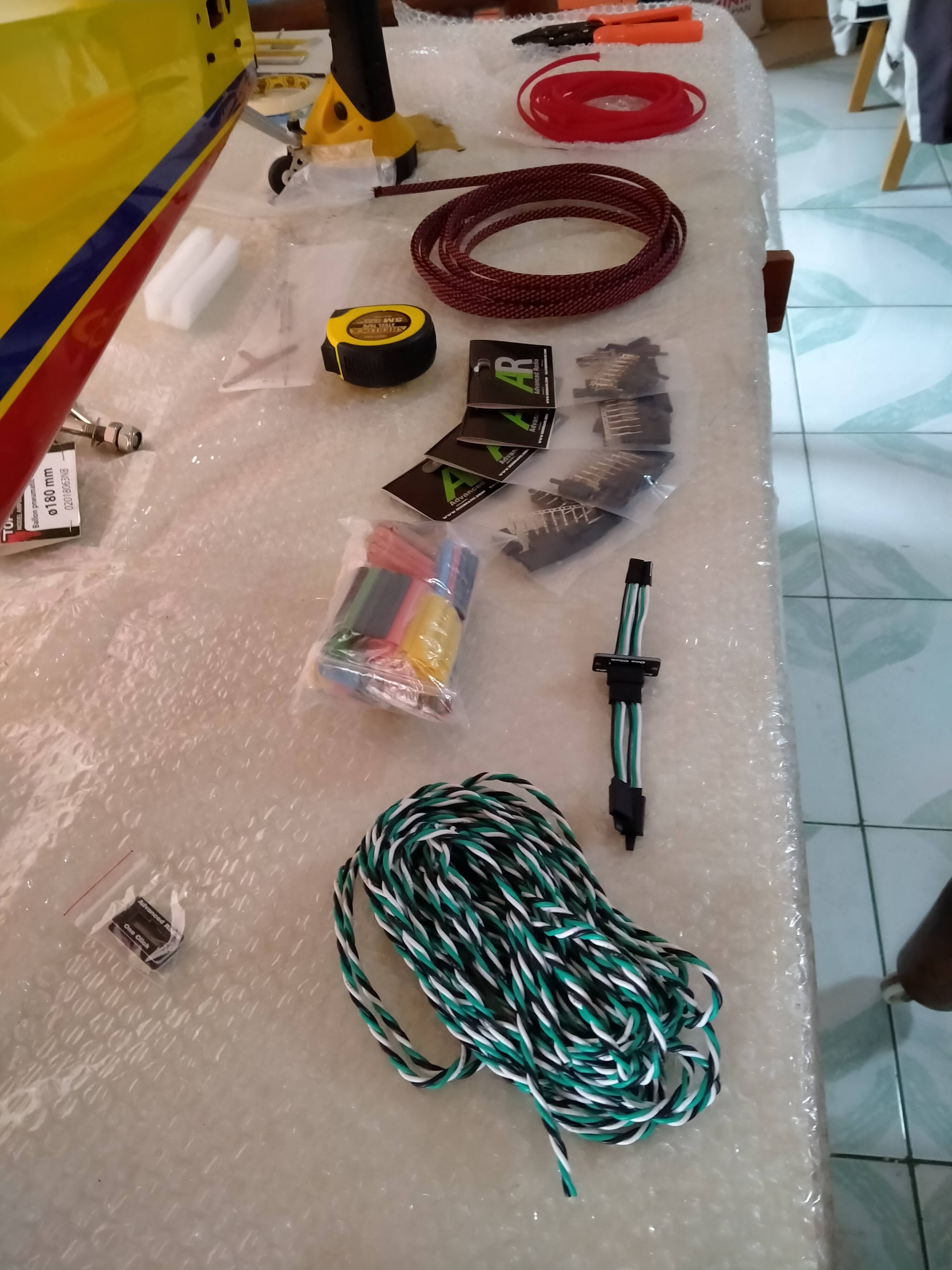

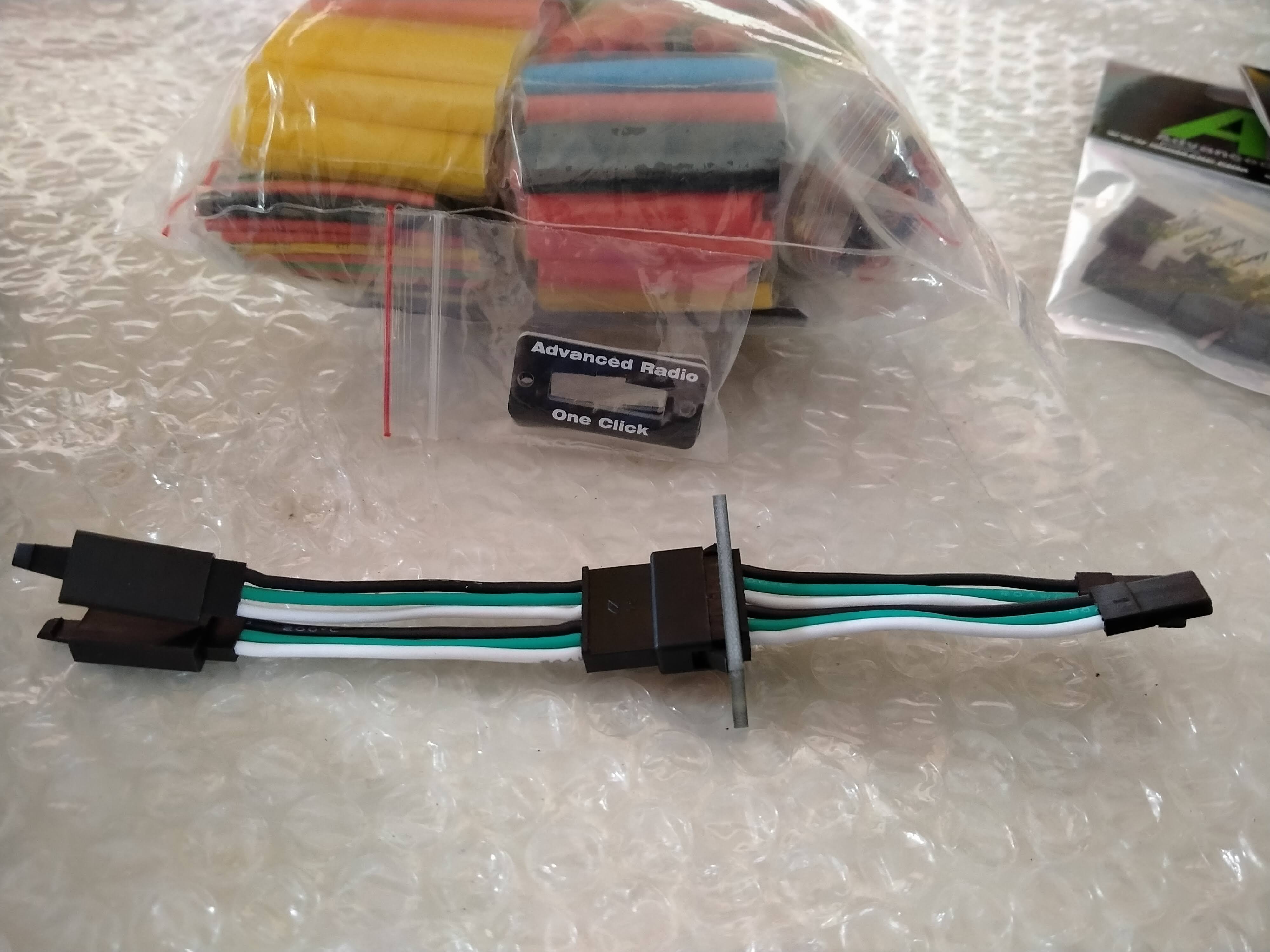

  4. Not doing much the last week, still waiting on servos, a long sad story but some will be here next week. Good news is my Booma R/C order arrived so I thought I'd share some of the nice stuff they sent, minus the most important thing I ordered from them, the ultra switch dual battery backup module, out of stock for three weeks.
    Got 10 meters of their new 20 gauge wire which is super supple and very high quality, although Initially I wasn't thrilled with the bespoke AR color scheme, it's growing on me. other stuff is connectors and a pair of their really nice wing harnesses. I was going to solder my own, but these are really nice and the come with nice back plates for mounting the plug to a surface. they feature two locking mechanisms, one to lock the plugs together, and one to lock one end of the pair to the phenolic mounting plate. Not sure, but I may try to engineer a plug in wing system. So I will be busy as soon as servos arrive making leads etc.

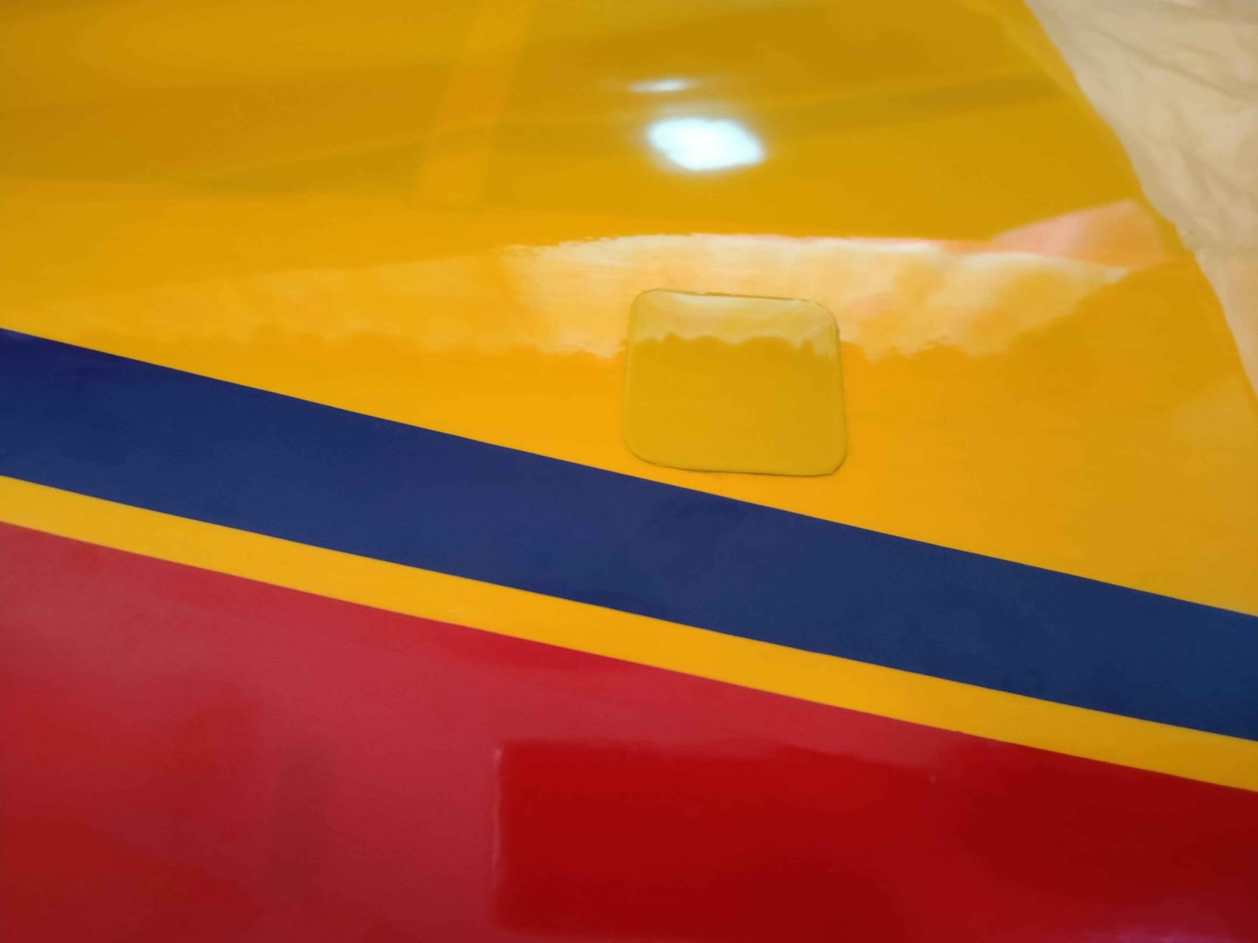

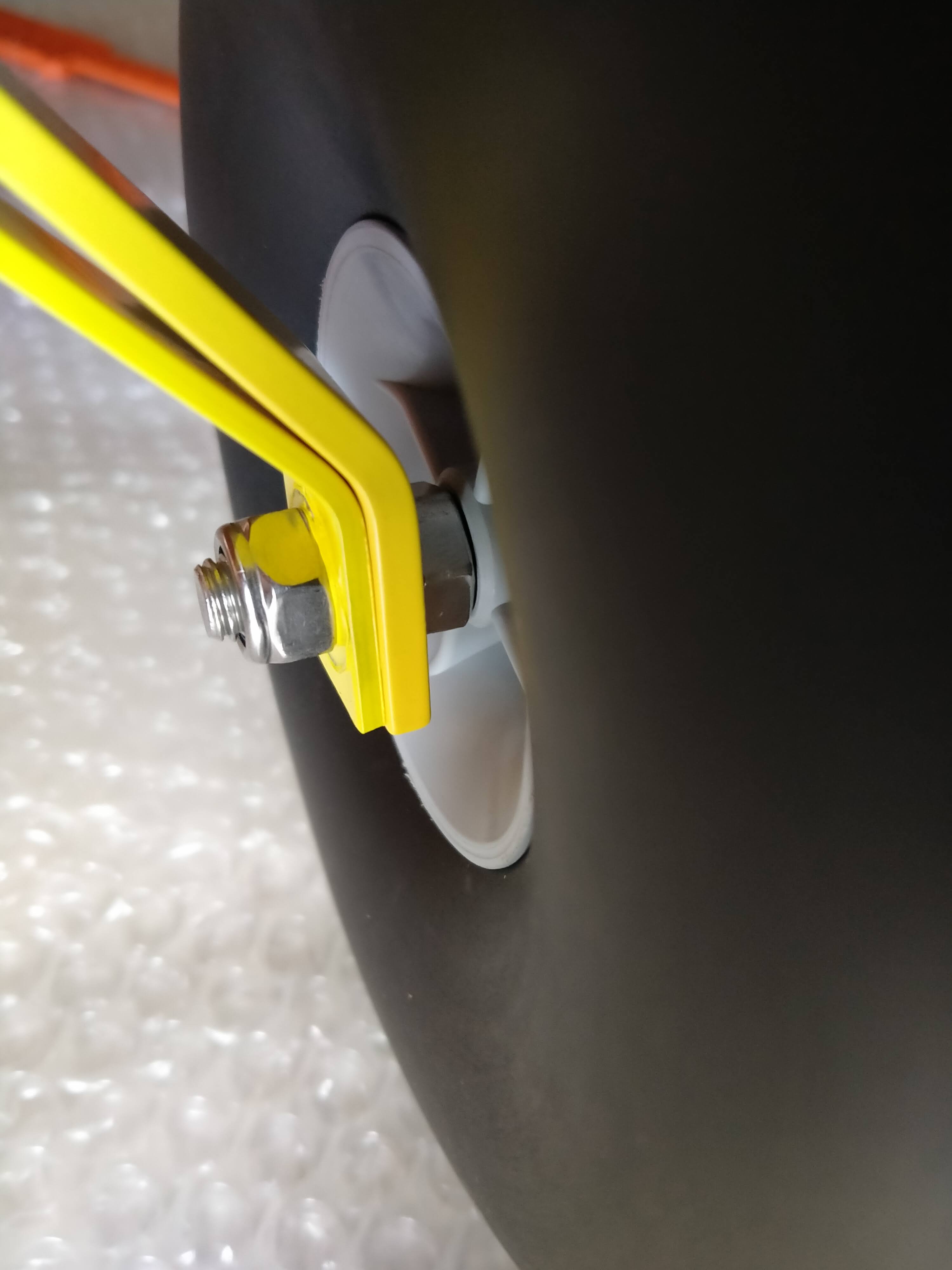

  5. One thing I did last week was to cut the covering on the wing and reinforced the strut attachment with balsa stock and Hysol mixed with chopped fiberglass for strength. I used some more beer can aluminum to cover the holes, I really don't drink much beer, it was the same can I used for the bushings, honest. Anyway not much choice as the nearest roll of yellow covering is 3,000 miles away or more. Also reinforced around the wing tube and the ply cross member in there (in the fuse). more thixotropic glass and epoxy adhesive used. H9 missed a real opportunity when they designed this plane to tie the wing tube to the cross member, it is just about 1/8" away.
