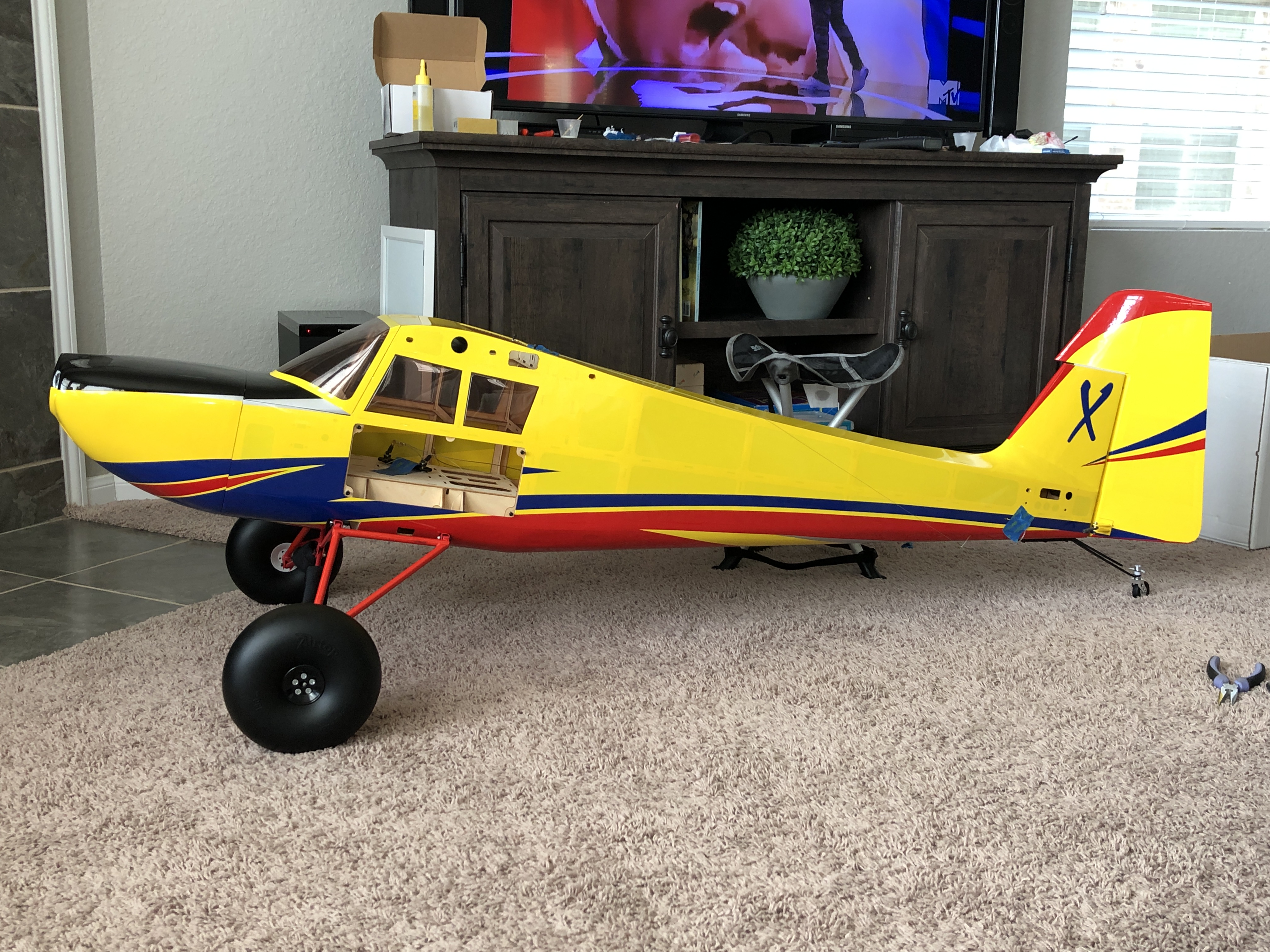

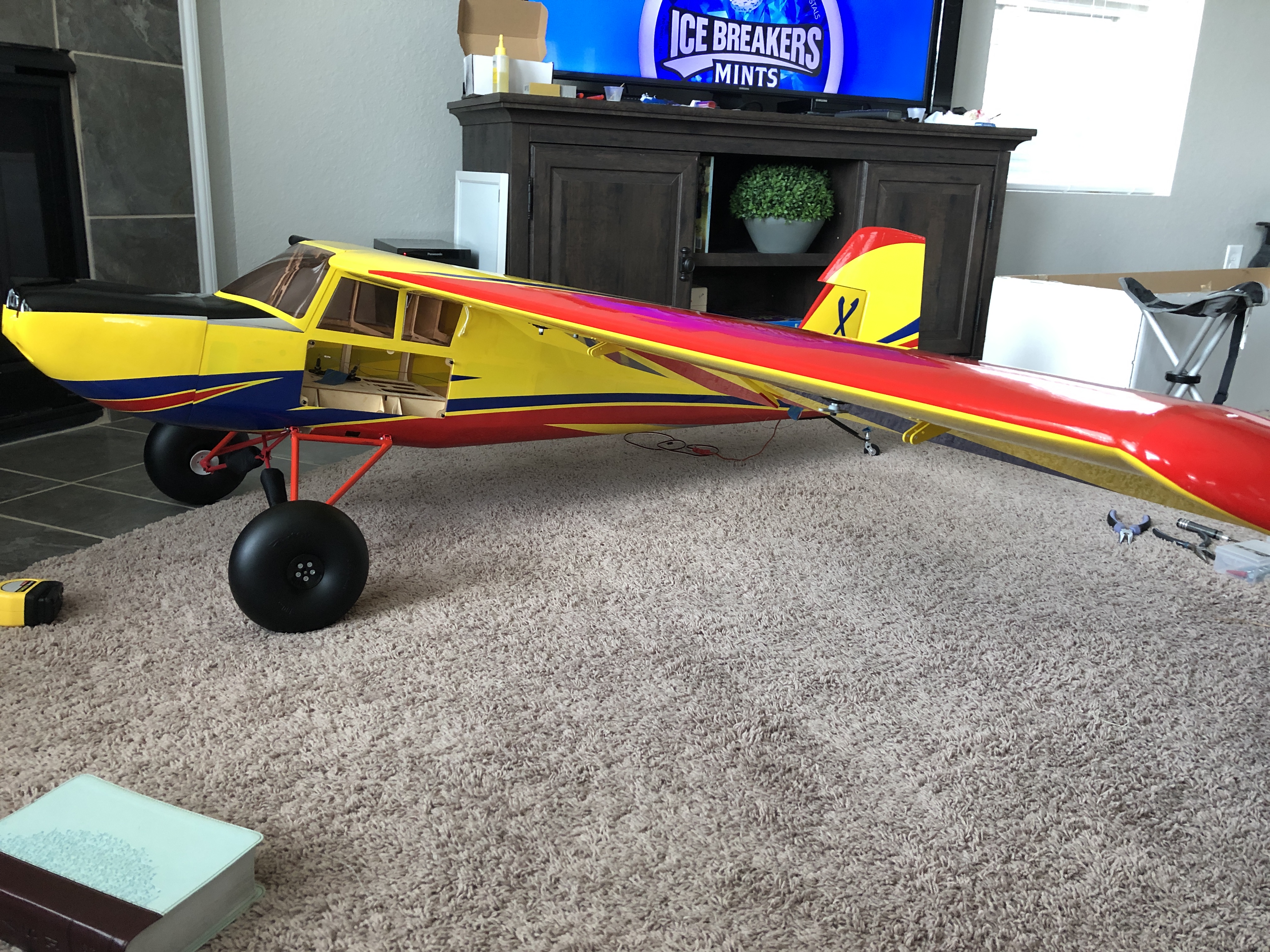

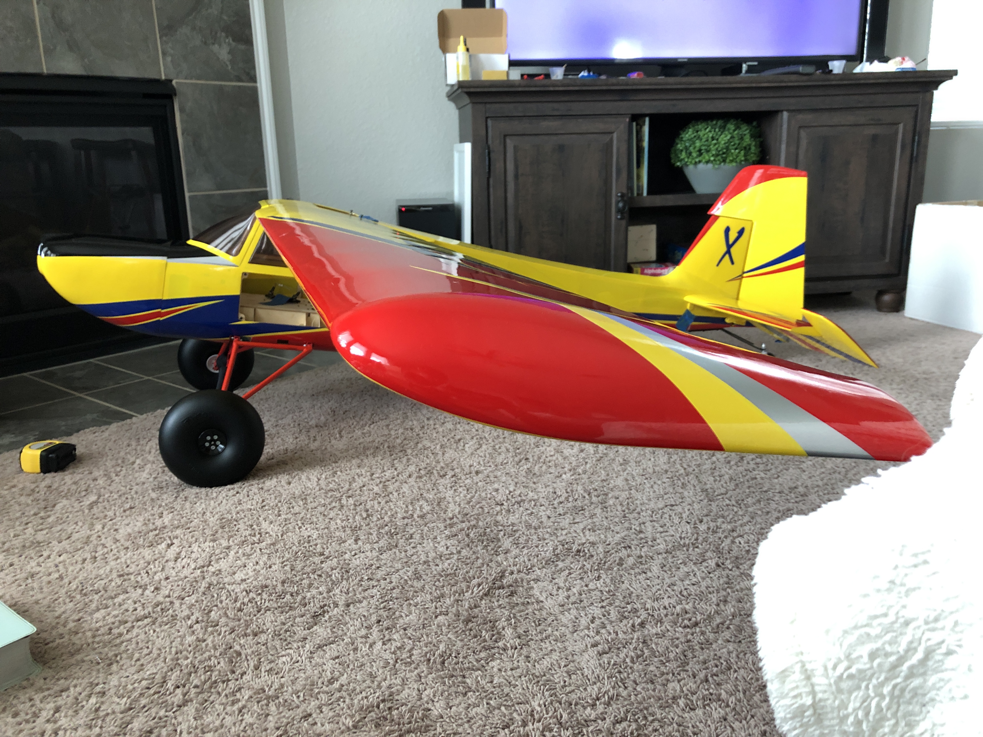

Happy to help!! Below is my original post about my gear fitting, so yes, just like yours. The welded cross brace and the left spring strut I had to bend to fit. The struts where they attach together inside the bracket I had to file to fit so they wouldn't touch in the middle. The forward bracket inboard bolt I reamed to a larger bolt like the stock gear uses - looks like yours is smaller? I had to elongate the bracket holes so everything could line up. keeping the bolts loose while fitting was key along with taking everything apart and back together several times. Major PITA. Heck one of my gear axel brace isn't even true so it sits a little funny - Tires point in the right direction though. So when you are bending your parts to fit, double check which side you need to bend/elongate in a better direction in case they are not true. . . you'll end up with a better finish. I don't know if it's the gear or the plane.... Also be sure to hit those blind nut retainers with glue!!! I had one pop loose with my rear gear bracket, frustrating, but was able to re-glue it.
Thanks again so much for your reply! Ok, I guess I will just keep messing with it. I just never thought it would be this much work and frustration with the Xcub gear to get them to work with the Timber.
