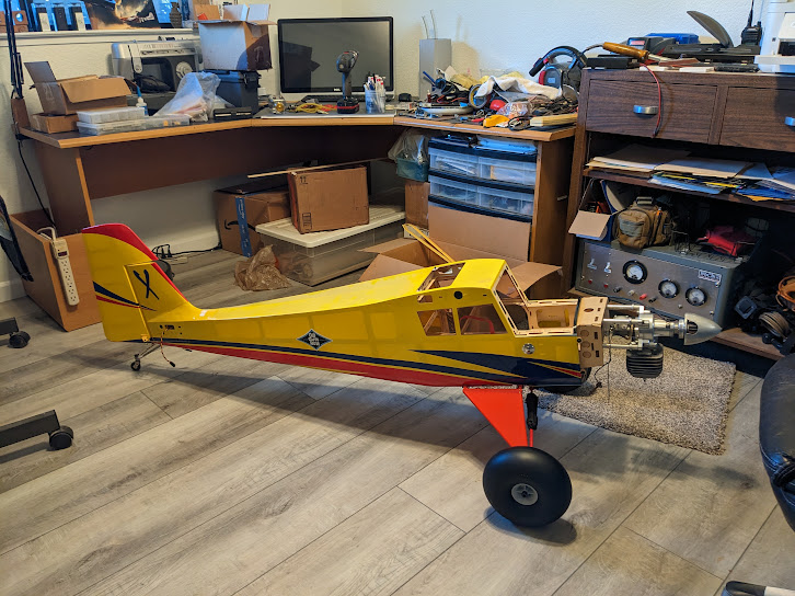

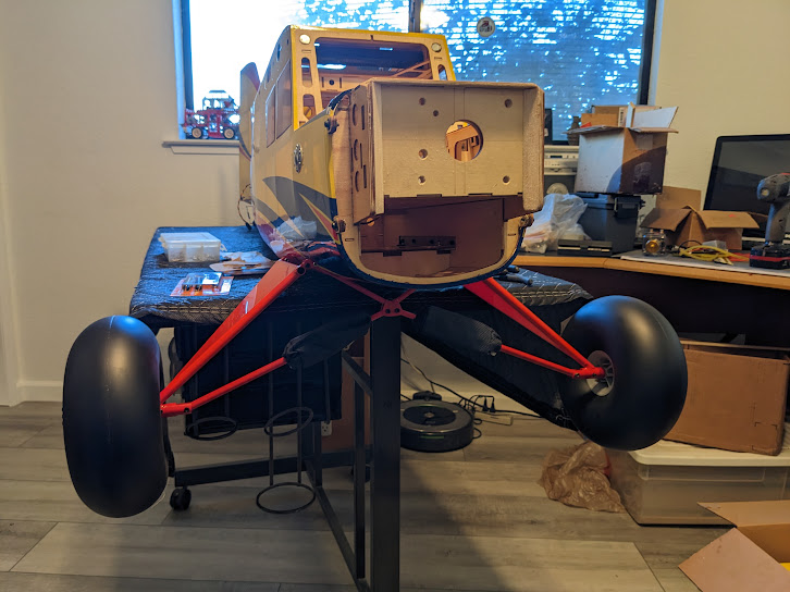

Rebuilding my Timber (New fuselage) powered by an RCGS 60cc, with the X-Cub LG (resprung for proper weight) and fitted with 7 in Airtop tundra tires. Due to being pulled from production I am having to scratch build a new windshield/hatch cover and source some sort of engine cowling possibly radial as I think that would look cool.
@Snoopy1 Lets do this! As mentioned before, The "Super Timmy" barge has landed in the US, and the planes will be delivered at Horizon Hobby tomorrow morning with an estimated ship date of this Thursday or Friday.
My LHS has one reserved for me from this first shipment!!! Wohooooooooooo EDIT: actually ended up ordering online due to shipping cost issues.
I'm going with (Edited):
DLE55RA w/ bowman ring, and VVRC ext throttle arm.
3" Center Bolt Carbon Spinner (Falcon Spinner will not fit the falcon 23X8 CF Prop!!!)
Falcon 23X8 CF Prop
XCub Sprung gear add on
Savox 2274 + 2270 rudder (used)
ProModeler DS305CLHV on the throttle.
PR 8.75" Bushwheels
Custom 3D Printed tail-wheel bracket on the stock tail gear w/2" wheel. Ask if you need one :)
TechAero IBEC
Booma PinFlag Switch
Two Pulse 2550 2S Batteries
Fiji 17 oz fuel tank
Futaba 18SZ w/R7014SB rx

AKNick
I am interested in your 3D printed tailwheel setup. robertshowse@gmail.com please.
I'll send you an e-mail. I rarely printed this for anyone, just made the file so others can print it. The cleanup and prep took a while back then. I've since refined my slicer abilities and I'll see if I can do it again.
I was beginning to make a cowling in CAD for fun, but that has its own challenges for 3DPrinting a mold of that size. I had thoughts of using plaster of paris and using my own cowling as the mold form, but I could risk destroying my own cowl in the process. Overall, I believe it's achievable if it was worth my time. Shoot I even contemplated to silicone the outside of my cowl, using that mold to pour plaster into, wax that. then make the final mold with glass mats. Then I could recreate the timbers cowling and sell the cowls. All in the name of fun with hopes of getting my money back... but who wants an unpainted cowl? Hmm
