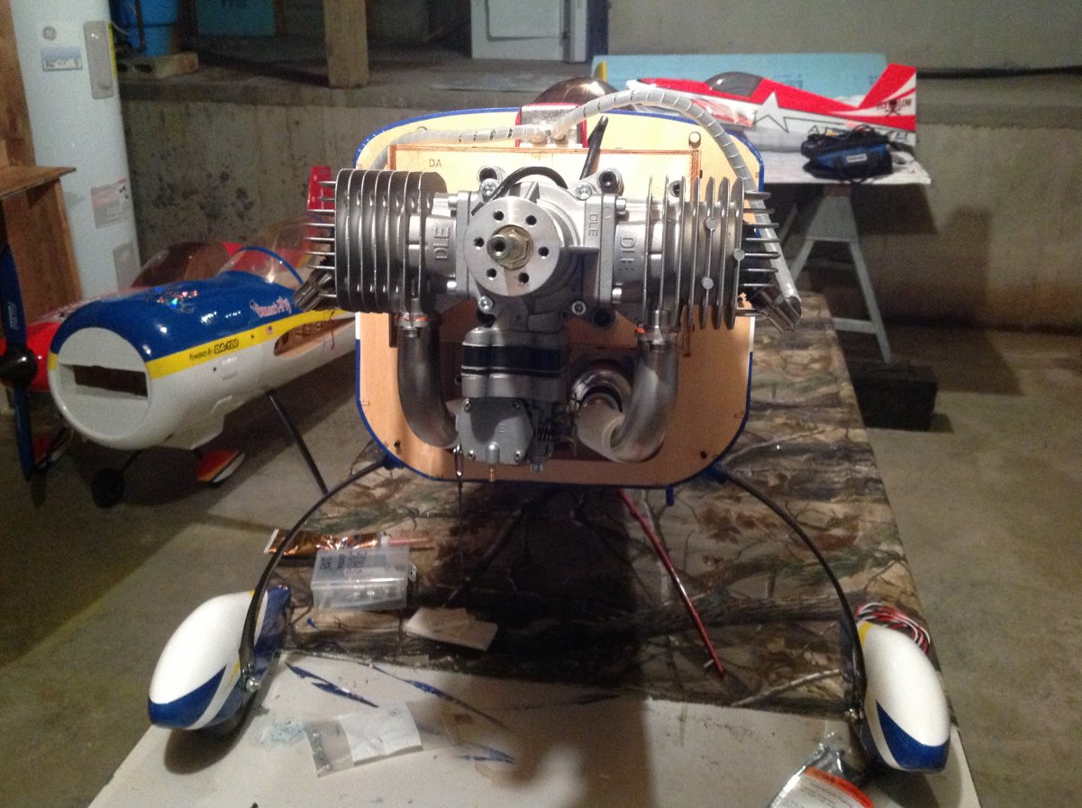

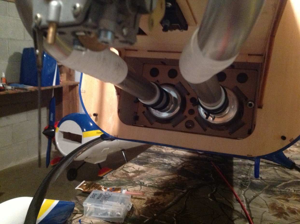

Also, I'm curious if I should vent out underneath the cowl for my canisters? My pro flows are fully contained inside the cowl.

I would vent for sure, the last thing you want to do is have your cowl pressurize in the air. Trace the angled slits from 1 of the removable plates underneath then grab your trusty dremel and get to work...

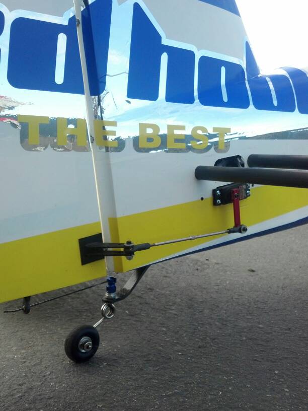

Headed to the field to sneak in a few last flights on stock mufflers before I follow your lead and bolt on my Pro flows. I'll snap a few pictures of my rudder setup if it helps, I'm running dual rudder servos and love it!

Thanks for the info....I'll trace that removable plate up and get cuttin!

I had pro-flows on my 103 extra. I just vented the openings in the bottom of the fuse. It worked very well for me.

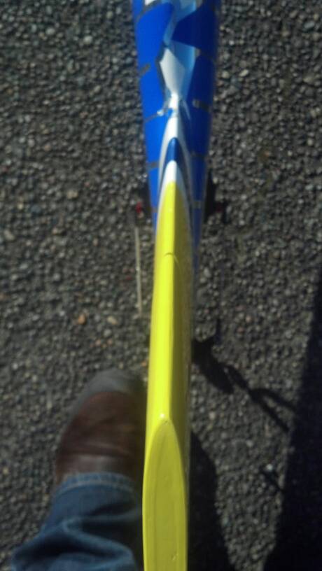

Here you go! Let me know if you need anything closer or particular.
