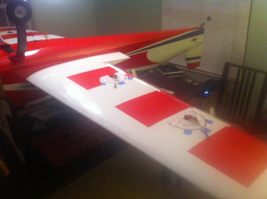

Spent last night setting the pushrod length or each aileron servo. That's done and will be programming the servos next.
make sure the pushrod lengths are identical in length. Are you using your transmitter to program the servos or a servo programmer? The reason I asks is because I use the Hitec servo programmer and I have become very formiliar with it. If you have one and need some help let me know. No disrespect if your a pro at this already. I just know how a pain in the aarrrss is was for me when first starting to program servos.
djmoose
Yes, using the Hitec programmer. What stinks is how it programs center for 1500us and the Futaba 8FG centers at 1520.
Diggity
I use JR/Spektrum, so I didn't run into that issue. I did program each servo with the programmer powered to the reciever. YOu might try it this way, so center isn't off by 20 each time

This is my first time using ganged servos and my 2nd time using the programmer. It's also my first time with an 8FG so now I have to compensate for the difference in centers. Example:
If you set the center with the hitec programmer...plug the servo into a Futaba radio....the servo will not be centered and abour 3-4 degress off. (The Hitec programmer sets center at 1500us and Futaba radios use 1520 as a center)
So, for EACH servo...you have to re-program with a estimate, and then plug back into your rx...until you get it right. (If I was going to use my Aurora 9, it would be easy peasy) I just wish you could use the hitec programmer to get the PWMs from your radio....and then program the programmer to use those exact center and endpoint values...example: you should be able to set the programmer to use 1520us as the center point.
Diggity, to answer your question, I'll be programming the servos only and will not be using any matching units or subtrim on the radio and I'll be using 2 aileron channels total, with each servo Y'd to it's partner.
I'll keep this updated as I mess with it.
