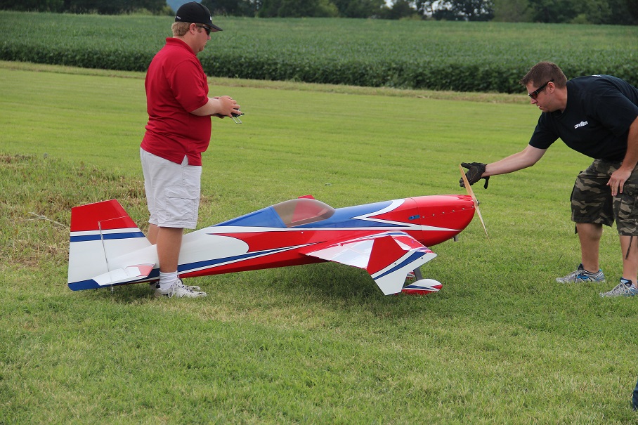

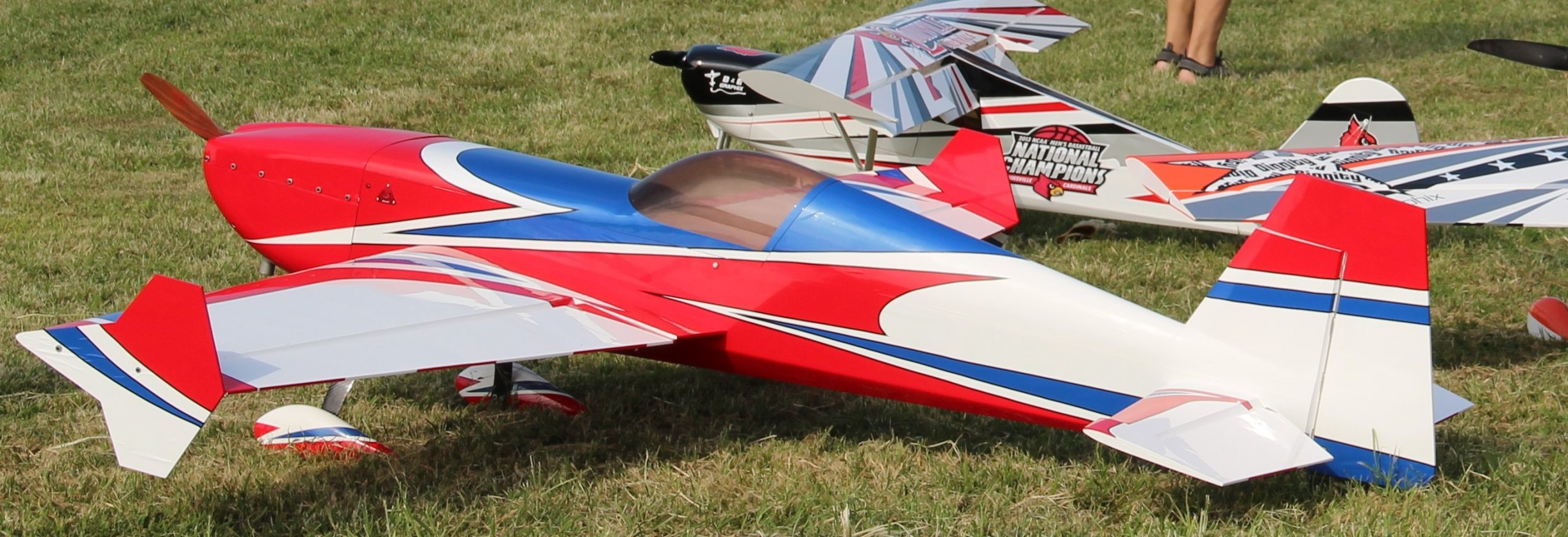

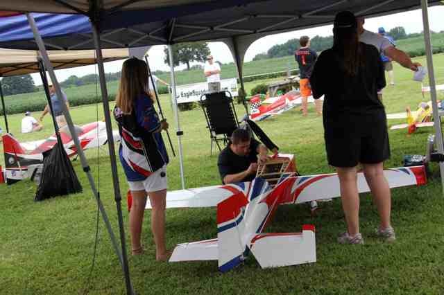

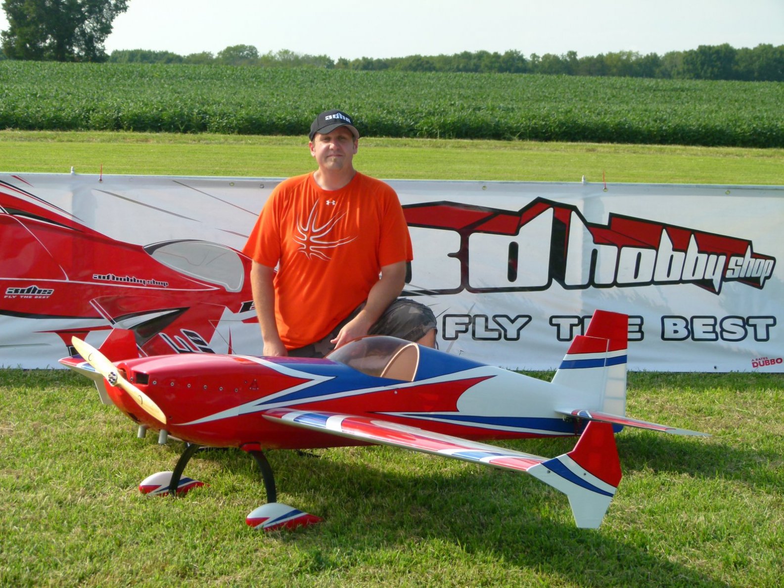

Thanks to Jim and Joe Smith for helping me get my 111 running correctly in my 103:
