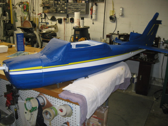

I just take the wing to the autobody supply house and let them match the actual parts. I pretty sure latex goes on heavier than automotive paint so I don't think bleed through will be a problem. Make sure you let the primer flash off for a least seven days before putting the latex on, don't ask me how I know this, I thought 5 days was long enough. I might even let the primer dry for two weeks if I use latex again. The fine line tape pulled the base color off down to the primer while the remaining masking tape did not. I had the whole fuselage covered with tape. I had previously painted the wings without issue however there was a longer time between primer and color.

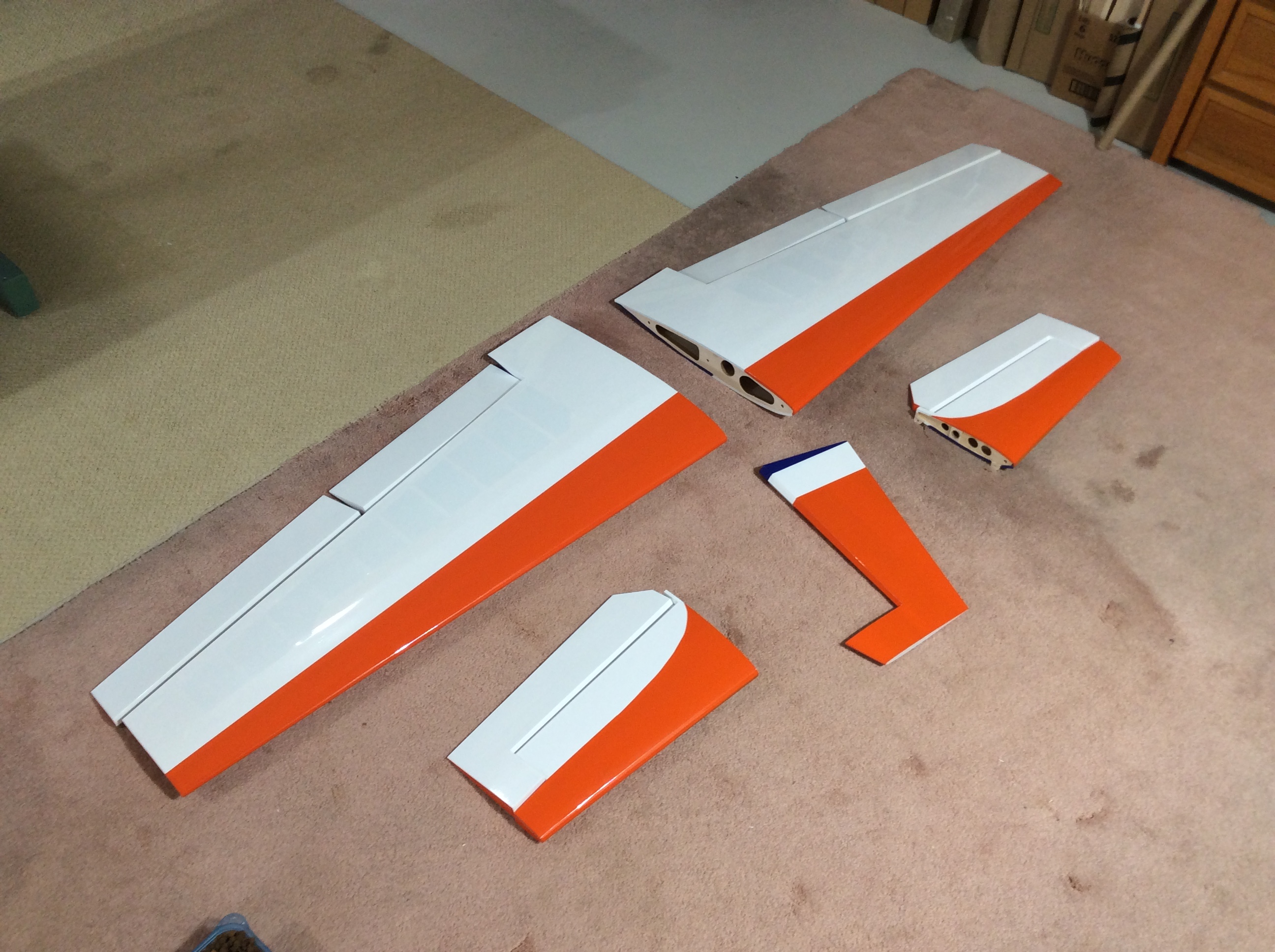

I used Rustoleum gloss latex, thinned about 25% with windshield washer fluid with Flood Floetrol added. A photo of wings after buffing.
View attachment 116889 View attachment 116890

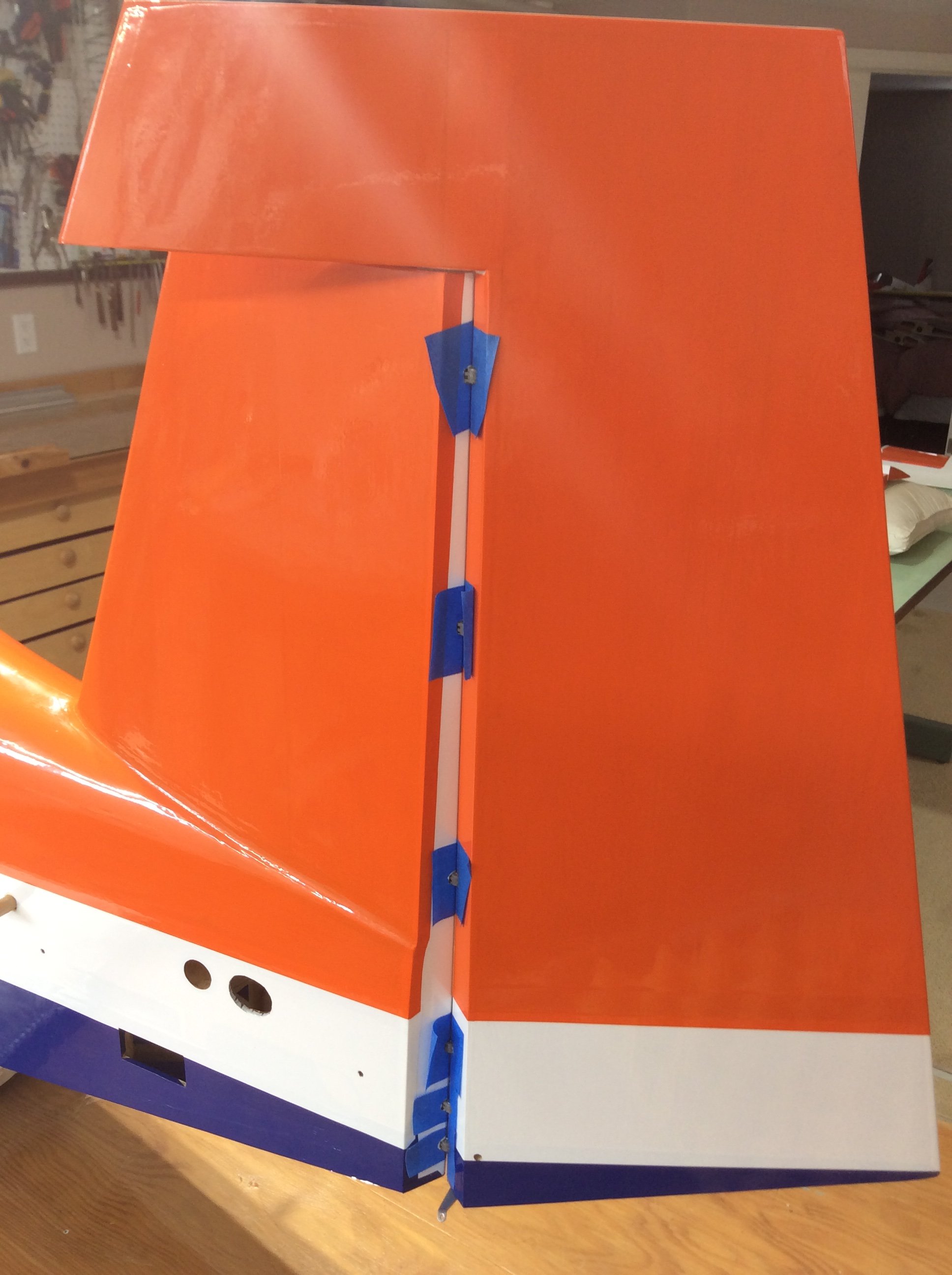

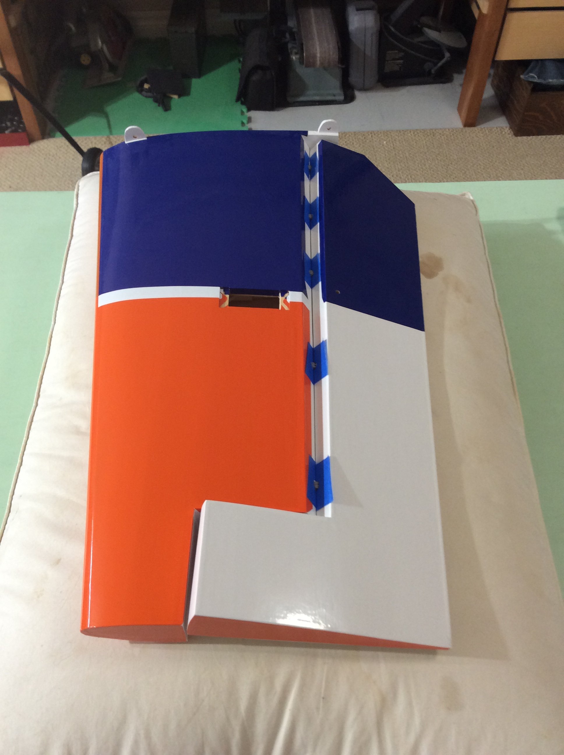

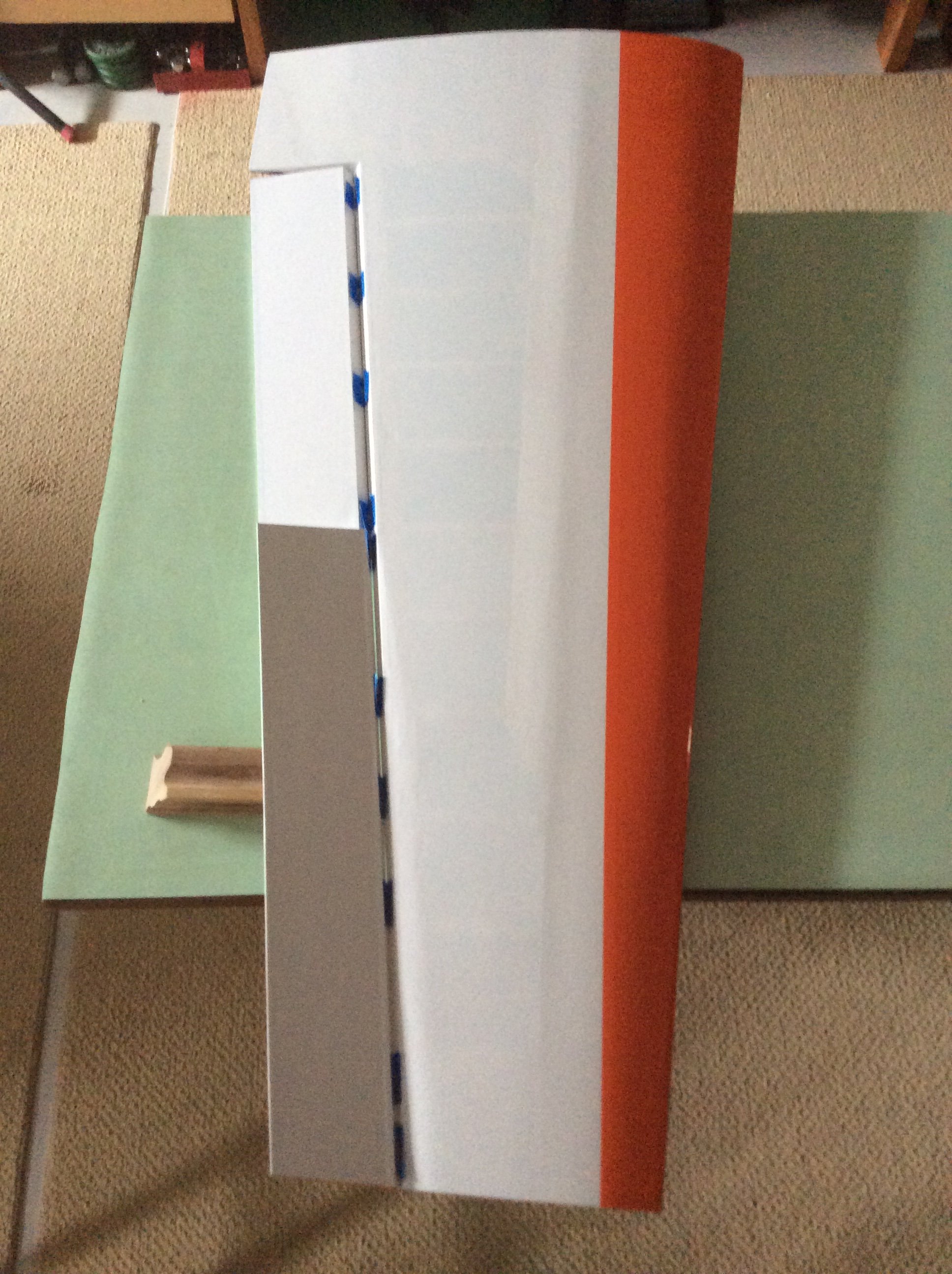

The covering is done, now on to a part that I do not really like doing and that is gluing hinges in. Will first do a cleanup and then do an assembly and see how it looks and see if I need to add something.
Well did some weight checks today. The plane weighed 14 lbs 2oz. Everything else to make it fly 10 lbs 4 oz. that gets me to 24 lbs 6oz. I am happy with that it is Scale plane and not built for 3D, but I must say I did try to keep it as light as possible. That puts it at a WQL of 10 which is good for a scale plane.
Big milestone for me all the hinges are done. Had no problems this time around all went well just have to let it sit for awhile. Cleanup the hinges and remove the tape and then on to the next job. All the hinges were installed with Gorilla glue.
