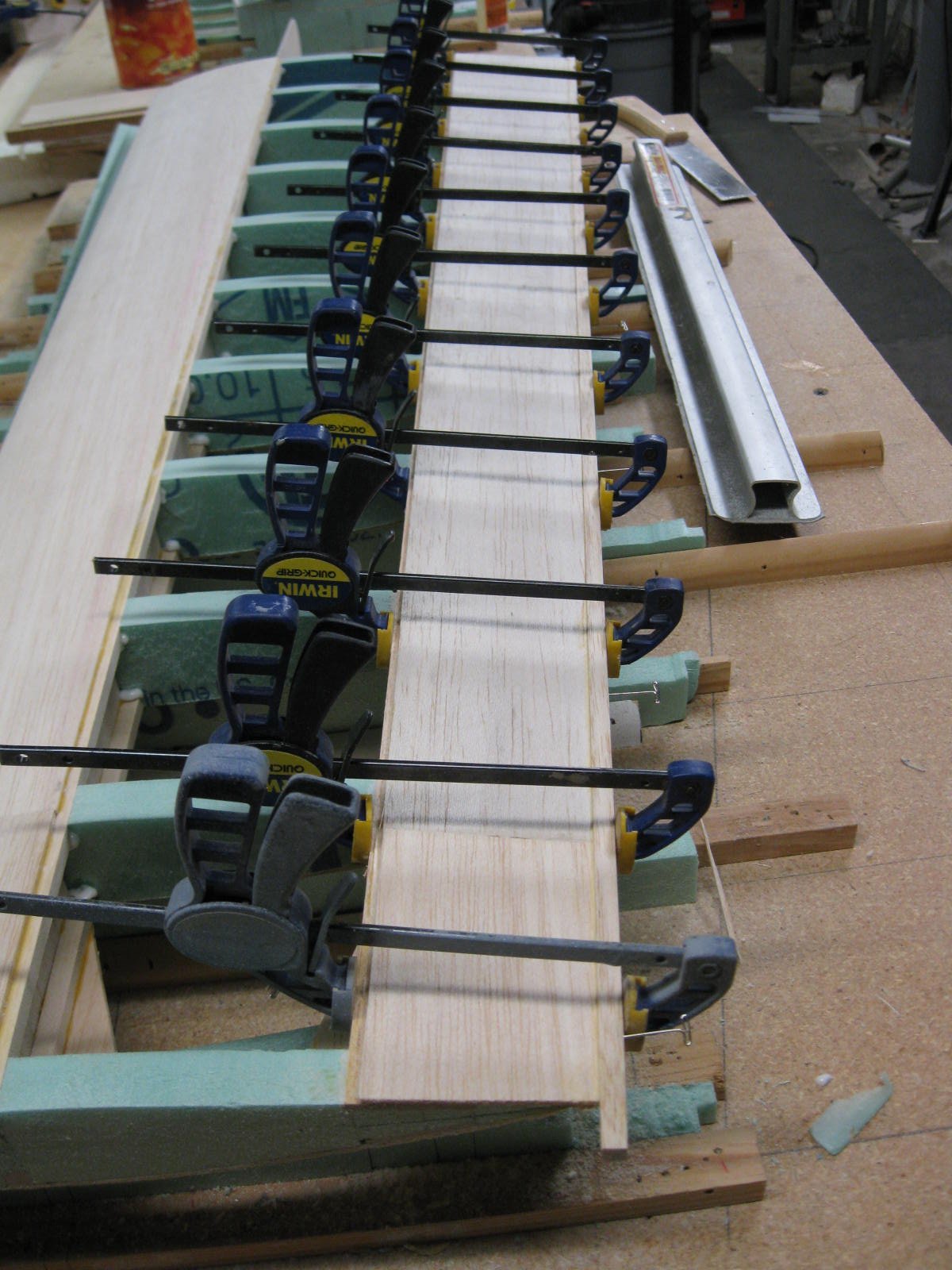

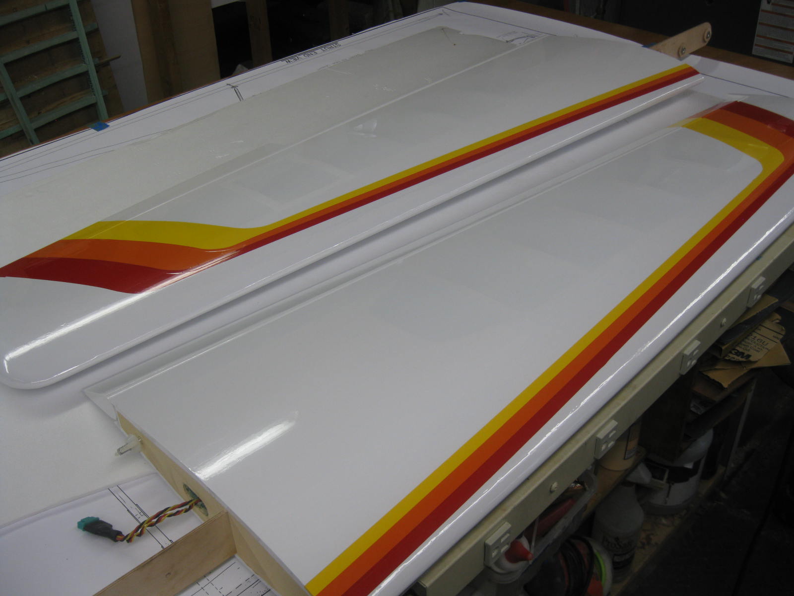

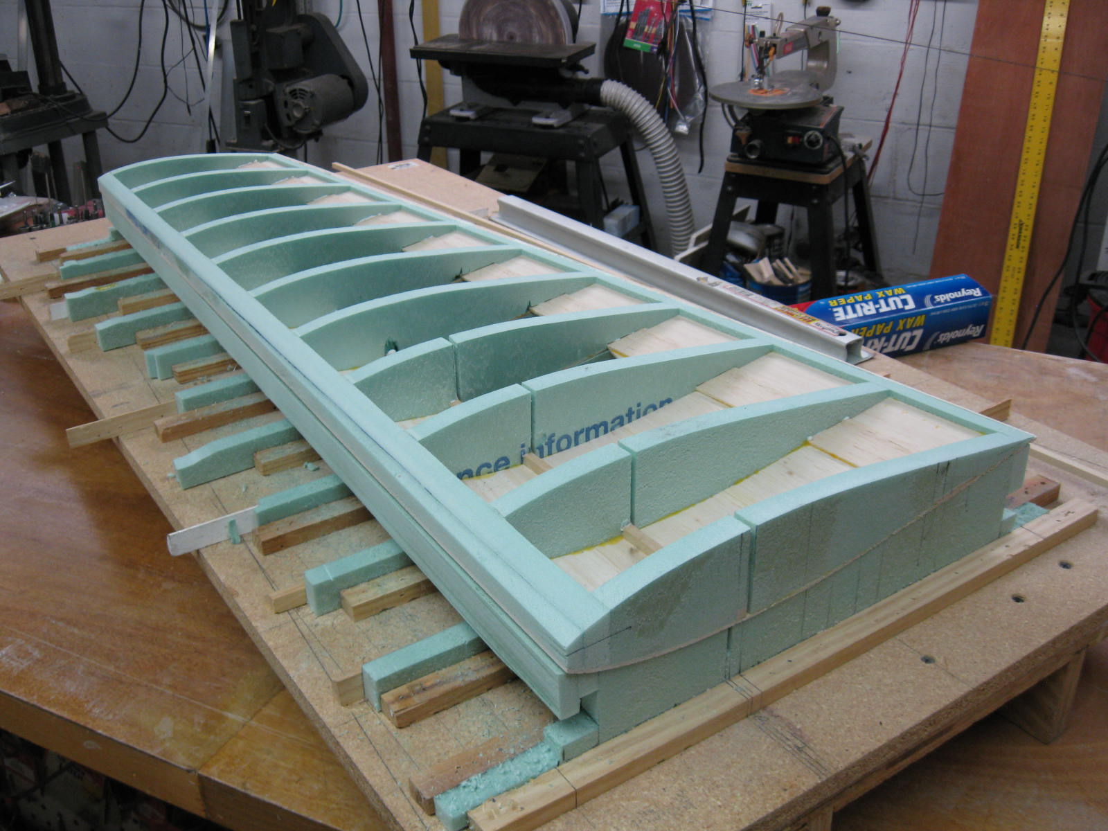

1/16" sheeting is fine for foam if you are going over 1# foam, I would use 3/32" over foam ribs, my favorite wing construction. Here's a foam rib wing that I just finished before starting the Champ.
Wow that looks good that surely is not your first go at it.

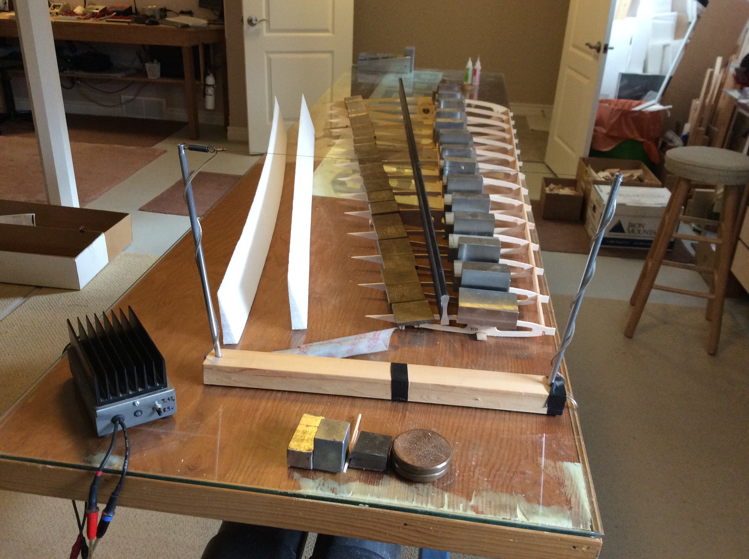

Ok after a little experimenting I found the voltage required to cut foam with out making a mess of it. Spent more time setting up the hot wire to get to cut straight. The picture shows what was made and the power control box I had from my previous hobby 1/12 scale - 6 cell carpet cars.,
